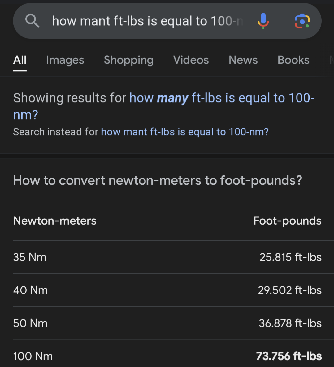

Zero Knievel Posted March 30, 2024 Author Posted March 30, 2024 (edited) Well, it’s back together. The manual I have says the pivot bolt is torqued to 100 nm. No way…I suspect that’s what caused the damage. I went to 35 nm and stopped…using thread locker on the bolt. Attached is a PDF of the repair job. https://app.box.com/s/75lxnruz1hy0lm63v5mgvux0cspznz9e Edited April 1, 2024 by Zero Knievel Quote

Zero Knievel Posted March 30, 2024 Author Posted March 30, 2024 (edited) 1 hour ago, SwampNut said: Can't wait to see the post about it falling off. Did you at least add Loctite? What size is the bolt? What reason do you have to believe you are a mechanical and materials science engineer? Yes…clearly you didn’t read the PDF. The inside spacer was crushed…this led me to believe I over tightened the bolt. I’m consulting with other BMW owners, but the bolt should not need 100 nm of torque. The only source of information I have is the Haynes manual…which, at times, is a bit lacking in accuracy. Indeed, it says NOTHING about working on the rear drive aside from changing the fluid. It’s very possible I was using the torque value for the wrong bolt. BMW is a tad notorious for not putting out DIY resources for repairs. Other than routine maintenance, they want you to take it to a shop. You can no longer buy service manuals, and aftermarket manuals are not comprehensive. Bearing failure is inevitable, so why the manual addresses the front wheel but not the rear is troubling. Well, I do have a bootleg repair DVD, but I’m not sure how current it is (whether it covers my model year…although many models for several years used the same parts in this case). *** Checked the DVD. The bolt does call for 100 nm. Not a biggie. It’s easy to tighten it more with the bike reassembled. Edited March 30, 2024 by Zero Knievel Quote
blackhawkxx Posted March 31, 2024 Posted March 31, 2024 14 hours ago, Zero Knievel said: Checked the DVD. The bolt does call for 100 nm. Not a biggie. It’s easy to tighten it more with the bike reassembled. It is a biggie now that you have thread locker on the bolt. Quote

SwampNut Posted March 31, 2024 Posted March 31, 2024 I attached the steering damper on my head with red loctite at 287nm. If the bolt size and grade were answered, it would be easy to look up the normal torque range for that fastener as a backup check/sanity check. Quote

Zero Knievel Posted April 1, 2024 Author Posted April 1, 2024 Okay...removed the bolt and redid it to 100 Nm. Quote
