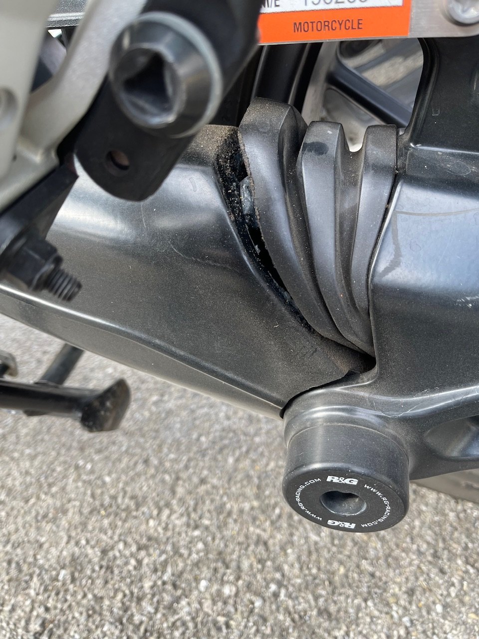

Zero Knievel Posted March 16, 2024 Posted March 16, 2024 This has been going on at least since I removed the driveshaft for inspection. The front of the boot keeps popping off. Grease and grime. It’s right above the rear universal joint of the shaft. Any ideas? I’m thinking I need to remove the shaft and reinsert it…if only to thoroughly clean the boot. Quote

superhawk996 Posted March 17, 2024 Posted March 17, 2024 My best guess is that you're not getting the boot fully over the lip that retains it. You may need to use a pick or bent wire to pull it over. Quote
tomek Posted March 17, 2024 Posted March 17, 2024 Try to spray offending areas with soapy water. 1 hour ago, CBR-RR-XX-CESS said: Why? BMW. German Engineering. Quote

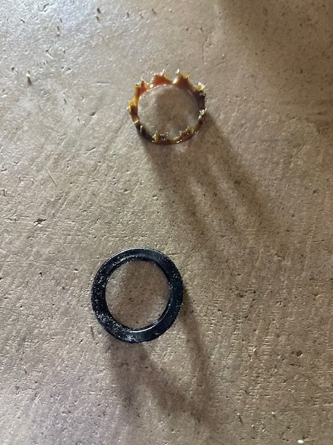

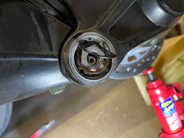

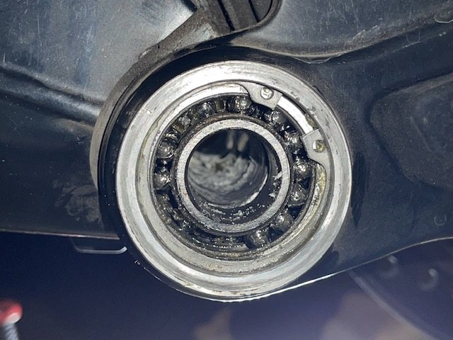

Zero Knievel Posted March 17, 2024 Author Posted March 17, 2024 Oh well, this was a productive morning. I decided to remove the rear drive and inspect/clean the boot. The driveshaft wasn’t fully seated, although I don’t think that was the issue. It takes a good shove to fully seat it, and it isn’t much extra distance. What I did discover is that the left side bearing for the rear drive was disintegrating. Thankfully, I caught this now, and there doesn’t seem to be any damage to associated parts. I’ll have to take it into BMW and have both bearings replaced. I hope I can just carry in the rear drive as it’s already off the bike. Quote
superhawk996 Posted March 17, 2024 Posted March 17, 2024 Looks like a mechanic/DIYer induced failure. 2 Quote
Zero Knievel Posted March 17, 2024 Author Posted March 17, 2024 40 minutes ago, superhawk996 said: Looks like a mechanic/DIYer induced failure. Possible. Maybe I didn’t keep things clean enough…or maybe I over tightened the bolt? Quote

superhawk996 Posted March 17, 2024 Posted March 17, 2024 36 minutes ago, Zero Knievel said: Possible. Maybe I didn’t keep things clean enough…or maybe I over tightened the bolt? If it was induced, my guess is that you did something that damaged/dislodged the cage, the thing that keeps the balls separated. It appears that the balls and races are ok, no obvious metal destruction, but it's hard to say from the photos. If that's correct then you probably did something that hit/pushed on the seal causing it to pop the cage out. If you could flatten the seal I bet it could be reassembled and be fine, if there's no metal damage. Quote
