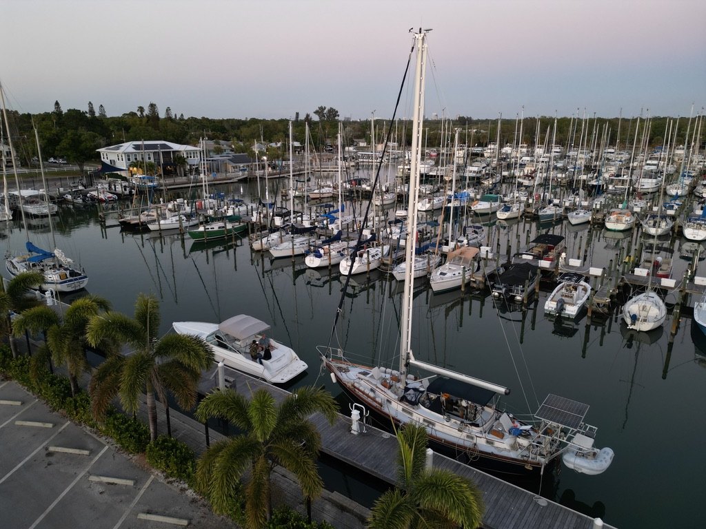

SwampNut Posted March 29, 2023 Posted March 29, 2023 1 hour ago, superhawk996 said: I might have suggested that he do some research to see if maybe his boat has an alternative source of propulsion allowing him to not use the engine. LOL. To be fair, it's a big bitch and that harbor was tight. I'm impressed he brought it through that. Probably made a radio call requesting a clear channel, and high tide, that inlet is small and has a crazy 90+ degree hook (which Tim missed, but, high tide). The 35' Formula is up front, so his boat is what, 60? Quote

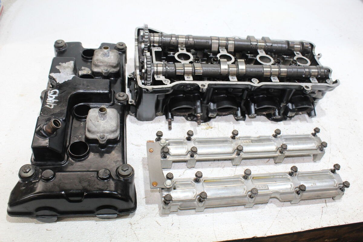

Zero Knievel Posted August 30, 2024 Posted August 30, 2024 7 hours ago, blackhawkxx said: Your Bird engine must be in great shape, thank Zero? 🙂 I used AMSOIl in the XX the whole time I owned it. Don’t know if Phil kept with that practice. When I took off the rocker arm cover to check clearances, the engine was spotless. Quote
RXX Posted August 30, 2024 Posted August 30, 2024 2 hours ago, Zero Knievel said: I used AMSOIl in the XX the whole time I owned it. Don’t know if Phil kept with that practice. When I took off the rocker arm cover to check clearances, the engine was spotless. I don’t recall. Maybe we could ummmm, look at the report. Nope, not Amsoil. You checked clearances? When? That is great, I would never have done that. In all fairness, Mike did a great job of maintaining the bike and was much more meticulous than I am. Quote
tomek Posted August 30, 2024 Posted August 30, 2024 (edited) 5 hours ago, Zero Knievel said: I used AMSOIl in the XX the whole time I owned it. Don’t know if Phil kept with that practice. When I took off the rocker arm cover to check clearances, the engine was spotless. Well, that's interesting. Are you sure that was XX engine because there are no rockers there? Maybe it was your lawnmower? Edited August 30, 2024 by tomek Quote
Zero Knievel Posted August 30, 2024 Posted August 30, 2024 54 minutes ago, tomek said: Well, that's interesting. Are you sure that was XX engine because there are no rockers there? Maybe it was your lawnmower? Whatever you call the damn cover at the top of the engine where the valve springs are located. Geez. 1 Quote

tomek Posted August 30, 2024 Posted August 30, 2024 1 hour ago, Zero Knievel said: Whatever you call the damn cover at the top of the engine where the valve springs are located. Geez. Facts matter. Quote
jon haney Posted August 30, 2024 Posted August 30, 2024 53 minutes ago, tomek said: Facts matter. Especially for dick measuring contests.🙄 2 1 Quote
XXitanium Posted August 30, 2024 Posted August 30, 2024 3 hours ago, tomek said: .... Are you sure that was XX engine because there are no rockers there? ... I had to go look. Quote
XXitanium Posted August 30, 2024 Posted August 30, 2024 Ima go look for the "I'm Not a Real Biker" thread. I guess I didn't think there were rockers, but I've never felt the need to know what the inside of theses engines look kike. They're a Honda. Quote
tomek Posted August 30, 2024 Posted August 30, 2024 (edited) Well, newer superbike engines do have finger followers, kinda like rocker in that sense lift on the camshaft is not equal to the lift of the valve. Cbrxx engine is from shim under the bucket era. Facts matter. 😁 Edited August 30, 2024 by tomek Quote

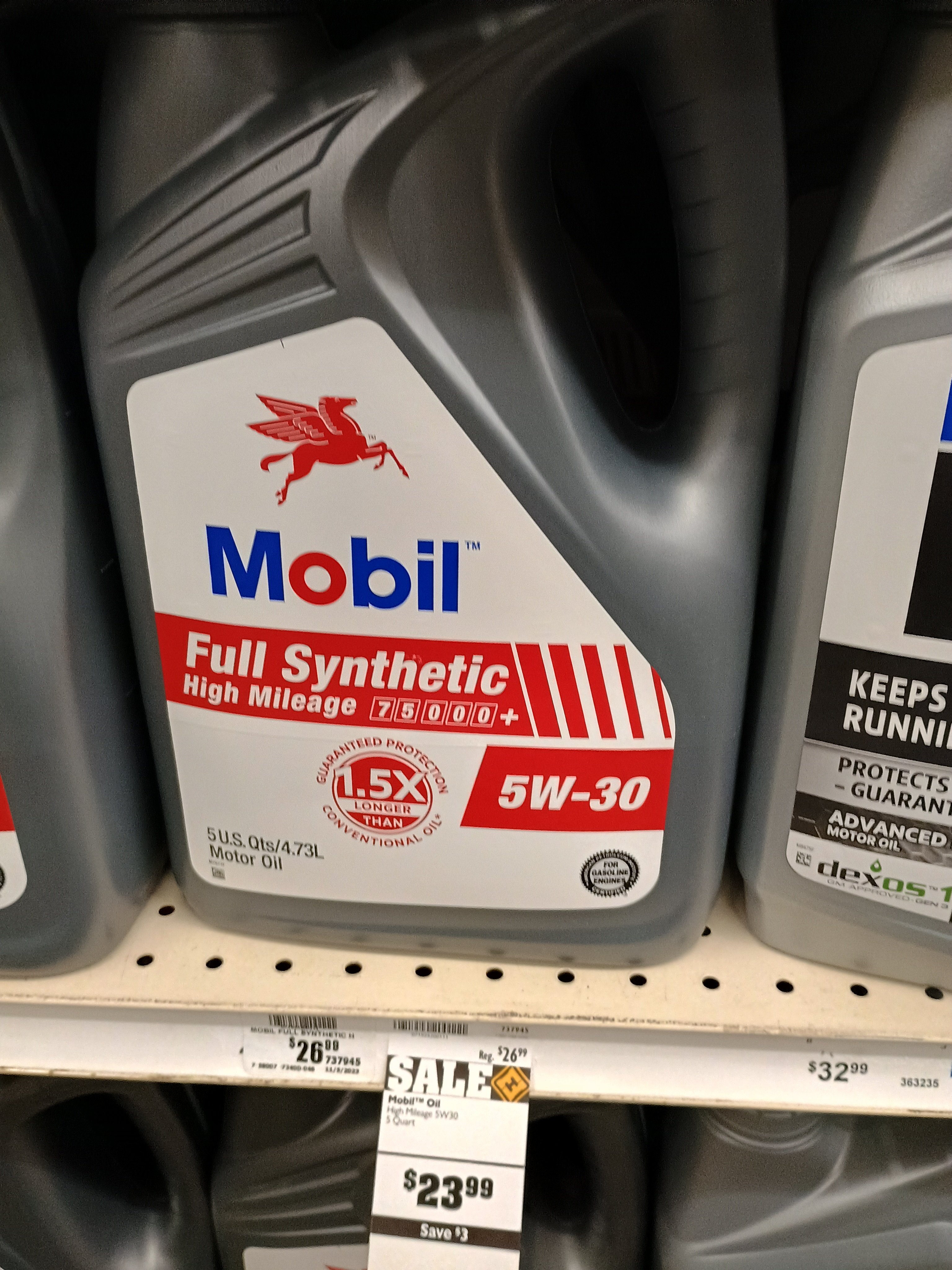

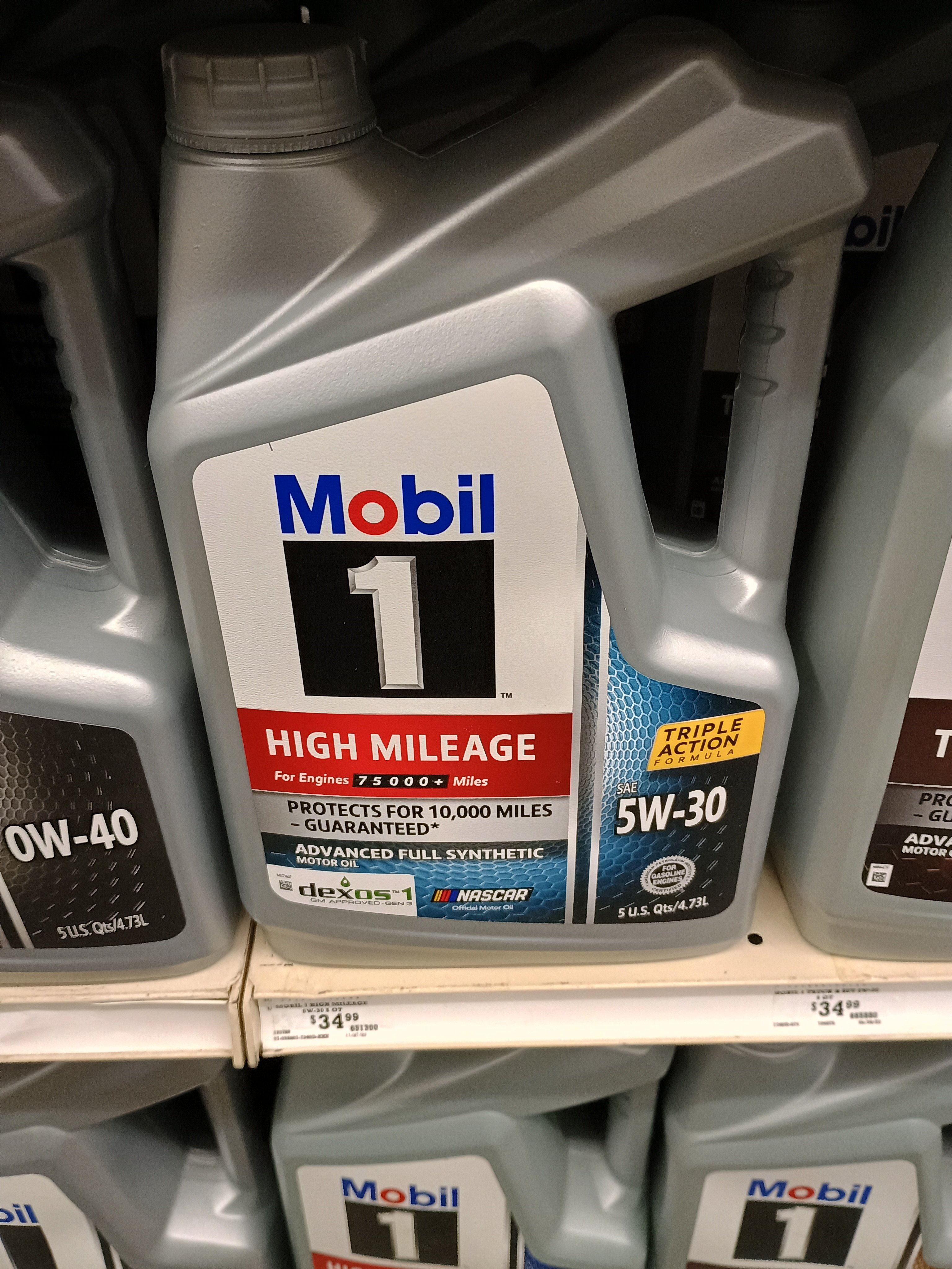

blackhawkxx Posted December 11, 2024 Posted December 11, 2024 I saw that Family, Farm and Home (just like a Tractor Supply) was having a sale on 5-qt. jug Mobil 1 full synthetic oil for $19.97 in the flyer. When I get there the jug doesn't look that same but they also have the jugs that look the same for $34.99. I have never saw this before and wonder what the difference is, additives? Didn't buy it but probably should have. BTW- Walmart has the normal kind for $27.97. Quote
poida Posted December 11, 2024 Posted December 11, 2024 i saw similar here in aus with castrol oil.reading the description they were the same oil but different looking stickers with a $25 price difference Quote
superhawk996 Posted December 12, 2024 Author Posted December 12, 2024 My understanding: Mobil1 is Dexos approved and regular Mobile isn't. Maybe Mobile is getting rid of the non-1 oil and that's driving the discount. It seems pretty silly that they'd keep making both, but maybe they don't and the non-1 might just be re-labeled oil from someone else. Dexos is a good thing and it 'should' be superior oil, but not something I'd spend much money for. I feel better buying 'generic' Dexos oil like Supertech which costs less than regular Mobile or any other name brand. My professional layman's take on how oils are produced: A vehicle manufacturer reaches out with a need/desire. A 'big name' oil company makes an agreement to create a suitable oil and spends a bunch of money to make it happen and sells it at a premium. Other oil blenders copy the formula and sell it cheaper. The copies might be slightly inferior in that they might barely meet the minimum spec instead of surpassing it. In some cases the generic might have some better attributes even if they only barely meet a spec, oil blending can be harder than rocket surgery. Many of the additives used fight against other additives so they have to be chosen carefully. Probably all additives have an upper limit where adding more creates a problem, but having too little is also a problem. Then there are additives which can be safely replaced with a cheaper one, but then other parts of the formulation need to be tweaked to keep them all happy. This is why you shouldn't use additives willy-nilly. It's also why one shouldn't do things that mix different oils: topping off, not changing the filter, etc. In an ideal world one would do a 'double drain' when switching oil types, but it's usually not a huge deal. This will likely sound wrong, but an oil can cause high friction and low wear or high wear and low friction. The goal is for both to be low, while also preventing sludge, preignition, etc. It ain't easy. The more I read about Valvoline Restore and Protect the more I'm considering paying the premium for a name brand oil. While I don't know if my engines "need" to be cleaned, there's little reason to not want them cleaned. 1 Quote
