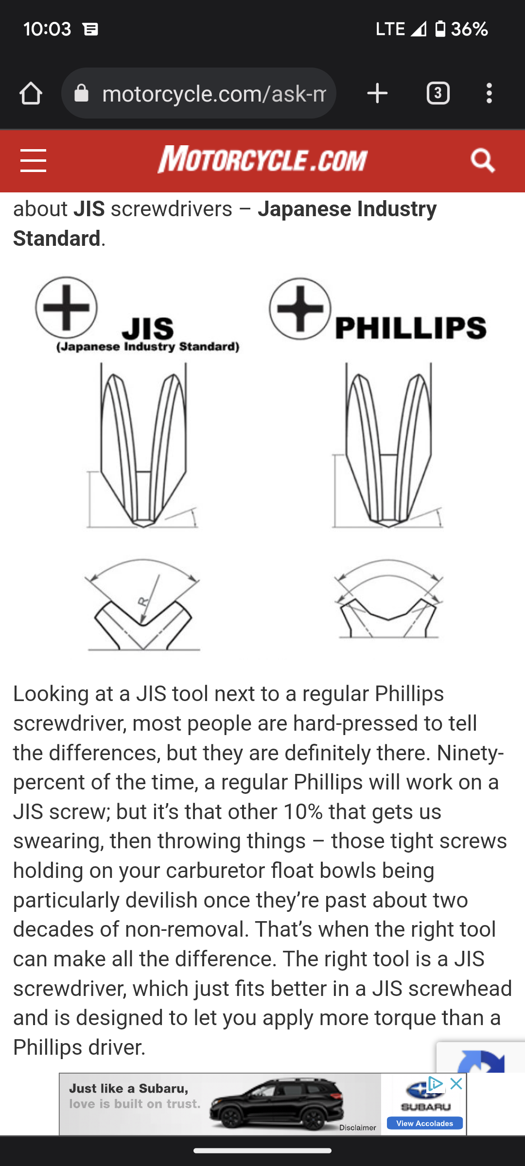

XXitanium Posted February 1, 2023 Posted February 1, 2023 Japanese Industry Standard screws... Not a phillips.... I looked around and didn't see an actual thread with this topic. I saw Swampnut had mentioned it in a garage thread. I don't know it I could discern one driver from the other https://chapmanmfg.com/blogs/news/phillips-bits-vs-jis-bits-whats-the-difference https://www.motorcycle.com/ask-mo-anything/difference-between-japanese-jis-phillips.html 1 Quote

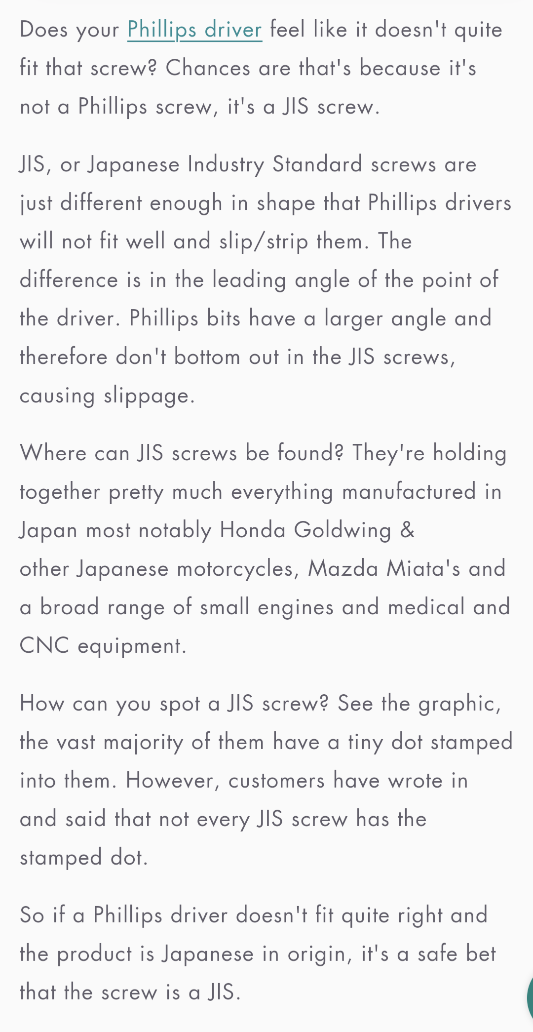

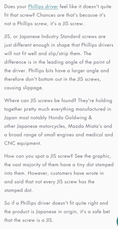

superhawk996 Posted February 1, 2023 Posted February 1, 2023 Oh, and to tell the difference on the screw; from my understanding the JIS screws always have a dot stamped into them. Look at any Phillips looking screw on a Jap vehicle and you'll likely see a dot denoting that it's a JIS. Quote
XXitanium Posted February 1, 2023 Author Posted February 1, 2023 Thanks, I did get the screw ID from the article above. https://www.agcoauto.com/content/news/p2_articleid/300 Quote

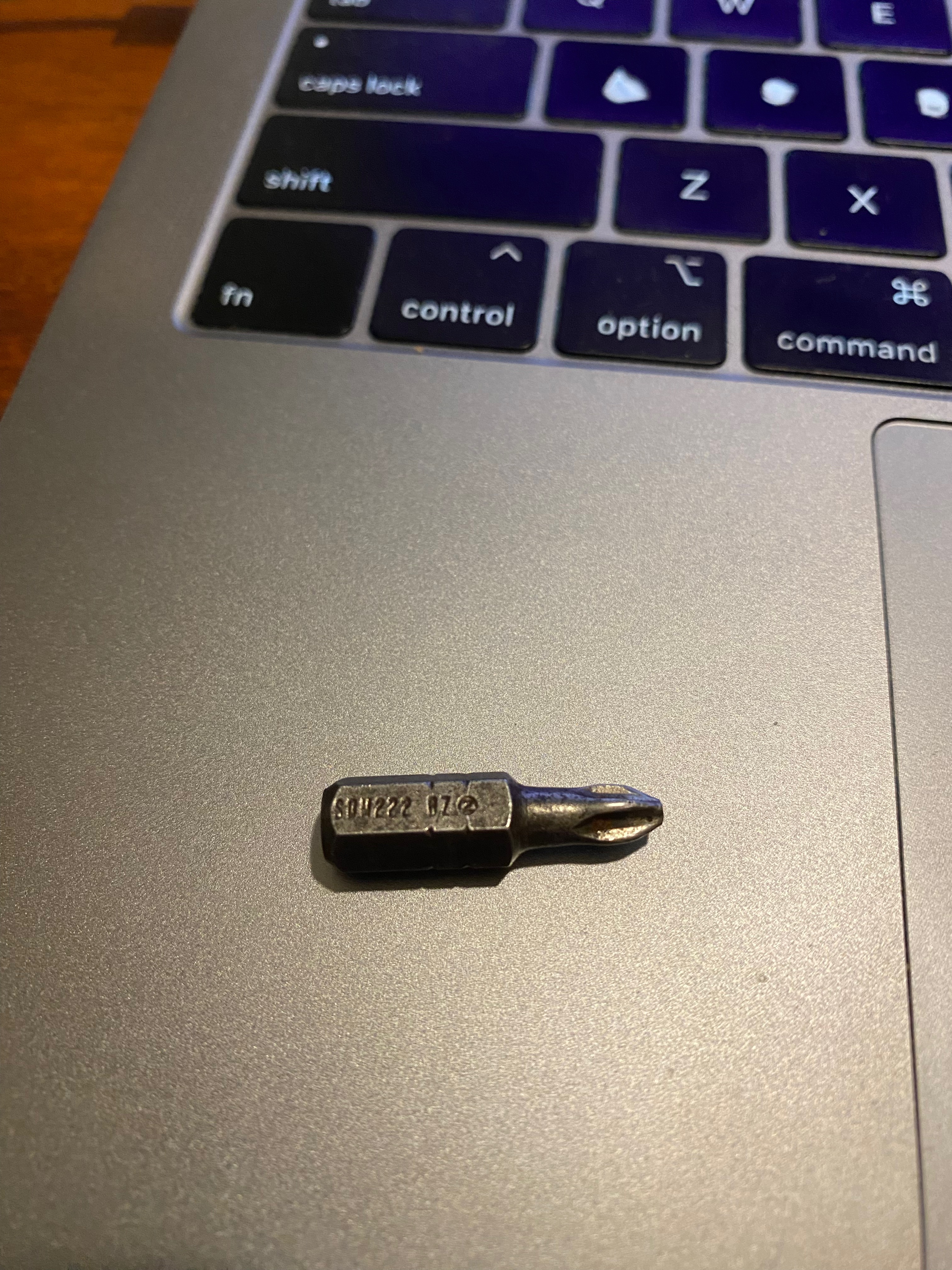

IcePrick Posted February 2, 2023 Posted February 2, 2023 I've had a Snap-On #2 Phillips bit for about 45 years now, it's #SDM222BZ. I can't find it online by that model number, but it is similar to their SDM222IRB. It once had little ribs that helped keep it from camming out of a worn Phillips screw, they're long worn off by now. It came in a ratcheting screwdriver kit that I bought when I was in the Coast Guard. I didn't have much money then, but it seems to have paid off buying the good stuff. I can also recommend their #EXDL10A left-hand cobalt-alloy drill bits with matching screw extractors - many times, when drilling a screw to extract, it would just start backing out without having to even use the extractor on it. I know it's remarkable to have such a tiny, easily-lost tool hang around for that long, but there's a reason; this is by far the most effective driver tip I've ever used. Other guys would wreck screws with poor quality drivers, this thing would take them out with no effort. It also for some reason is very effective on JIS screws, it never put sharp edges on the grooves of any of the fasteners on my Jap motorcycle - so I never found a need to invest in JIS bits or screwdrivers. I think I've got my money out of it, should probably get a new one. 1 Quote
superhawk996 Posted February 2, 2023 Posted February 2, 2023 13 hours ago, IcePrick said: It once had little ribs that helped keep it from camming out of a worn Phillips screw, they're long worn off by now. It came in a ratcheting screwdriver kit that I bought when I was in the Coast Guard. I didn't have much money then, but it seems to have paid off buying the good stuff. I can also recommend their #EXDL10A left-hand cobalt-alloy drill bits with matching screw extractors - many times, when drilling a screw to extract, it would just start backing out without having to even use the extractor on it. I've had both of those tools for about half the time you have. I got the screwdriver set as a company Christmas party gift, it came with a matching green Mini Maglight. My bit still has the ribs. I've lost track of the other bits it came with, but that one was special enough that it's still around. The cap for the screwdriver no longer stays, it was kinda loose fitting to start with and the threads stripped out. That bit lives in the driver, when I use it or the driver for something else they get reunited immediately after. More recently I discovered Craftsman screwdrivers with diamond encrusted tips, they grip quite well. I broke one of the drill bits from my extractor set years ago and never got around to replacing it. It's awesome when drilling for extraction and the extraction just happens. 1 Quote

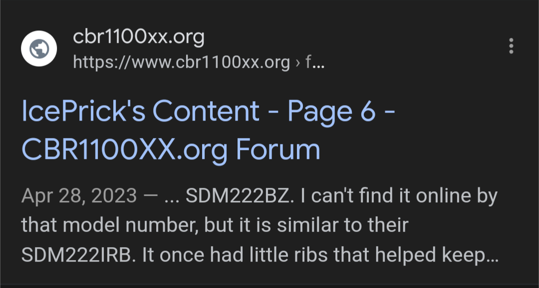

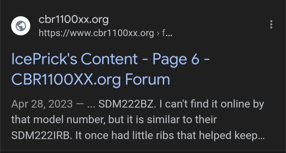

XXitanium Posted June 11, 2024 Author Posted June 11, 2024 On 2/1/2023 at 7:28 PM, IcePrick said: I've had a Snap-On #2 Phillips bit for about 45 years now, it's #SDM222BZ. I can't find it online by that model number, but it is similar to their SDM222IRB. It once had little ribs that helped keep it from camming out of a worn Phillips screw, they're long worn off by now. Life-the-universe-and-everything. https://nationalstocknumber.info/part-number/sdm222_00-595-8197 Google search: 1 Quote
