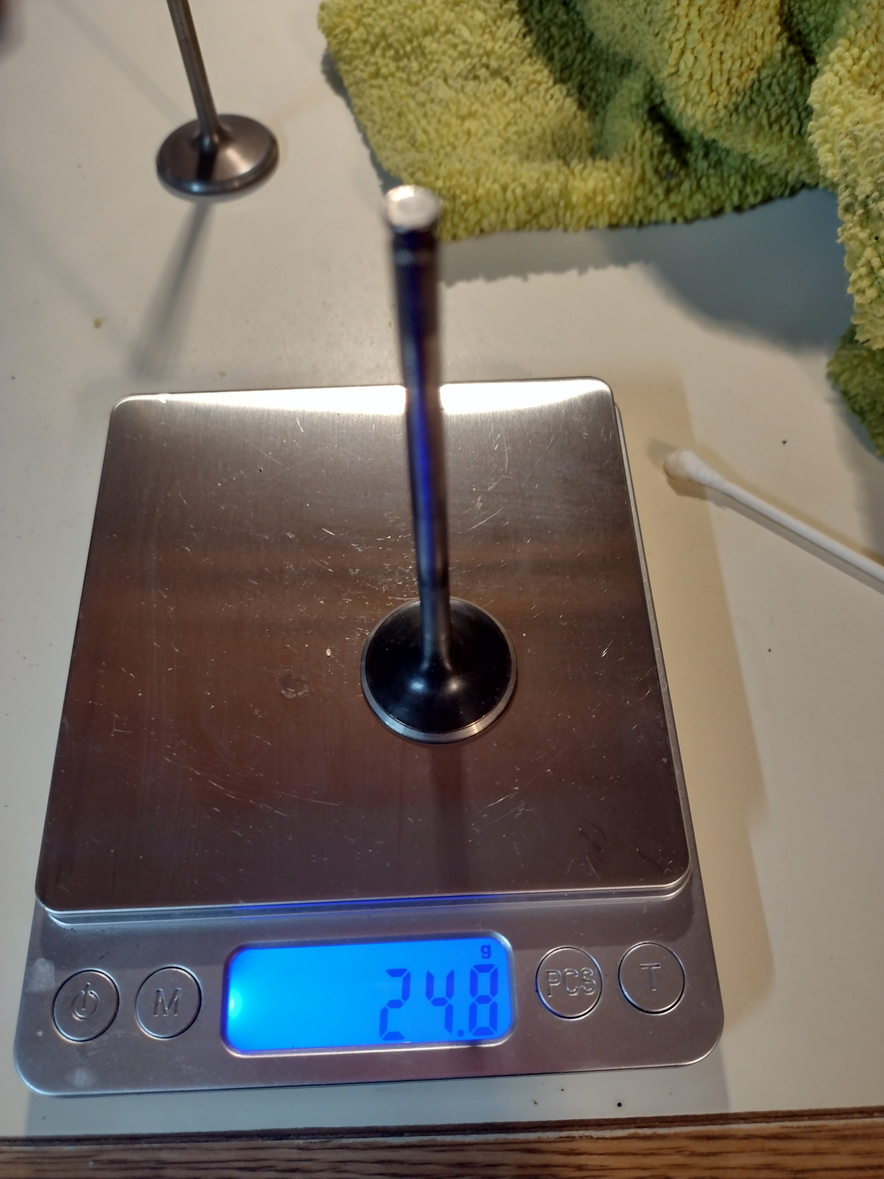

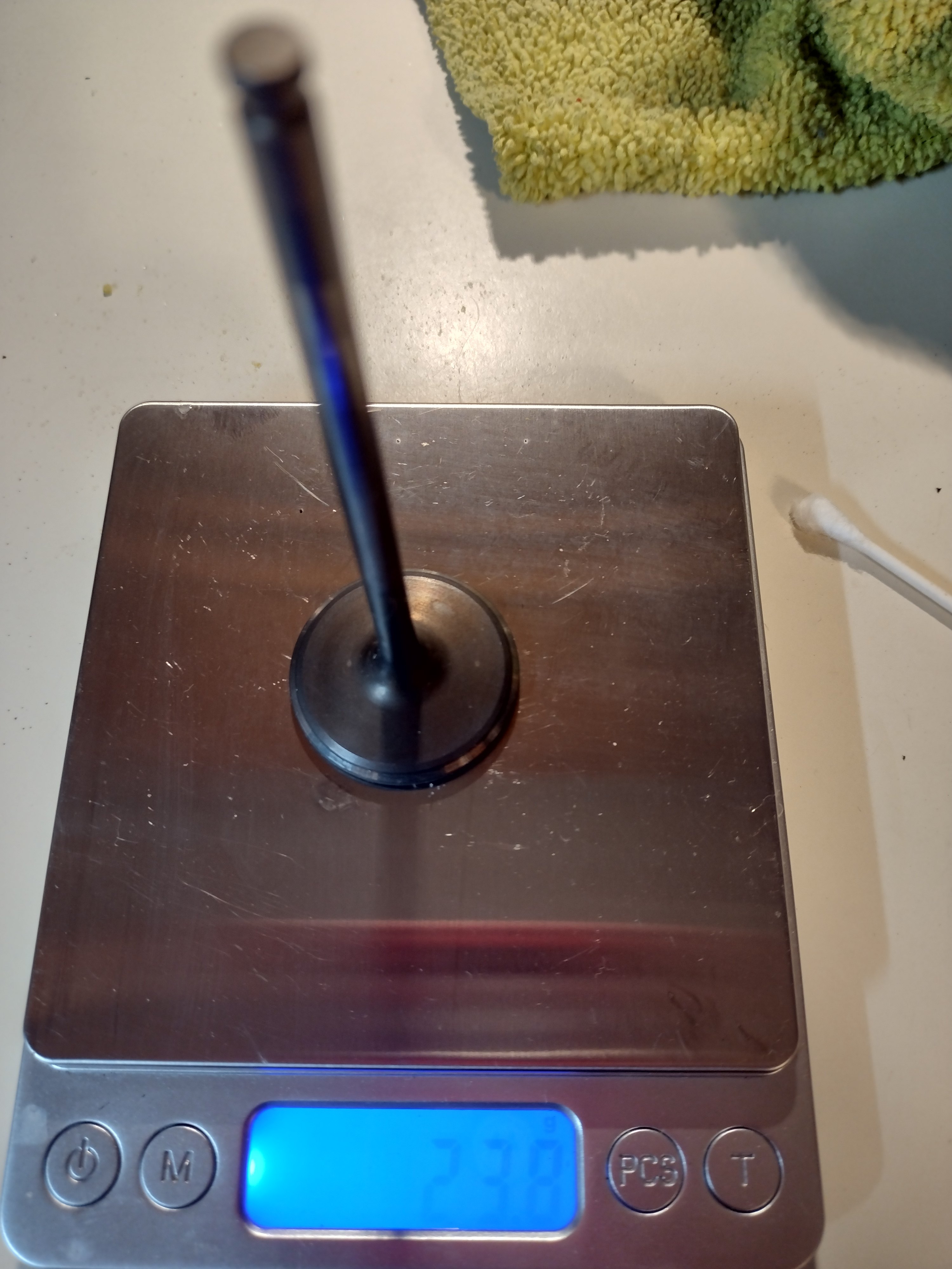

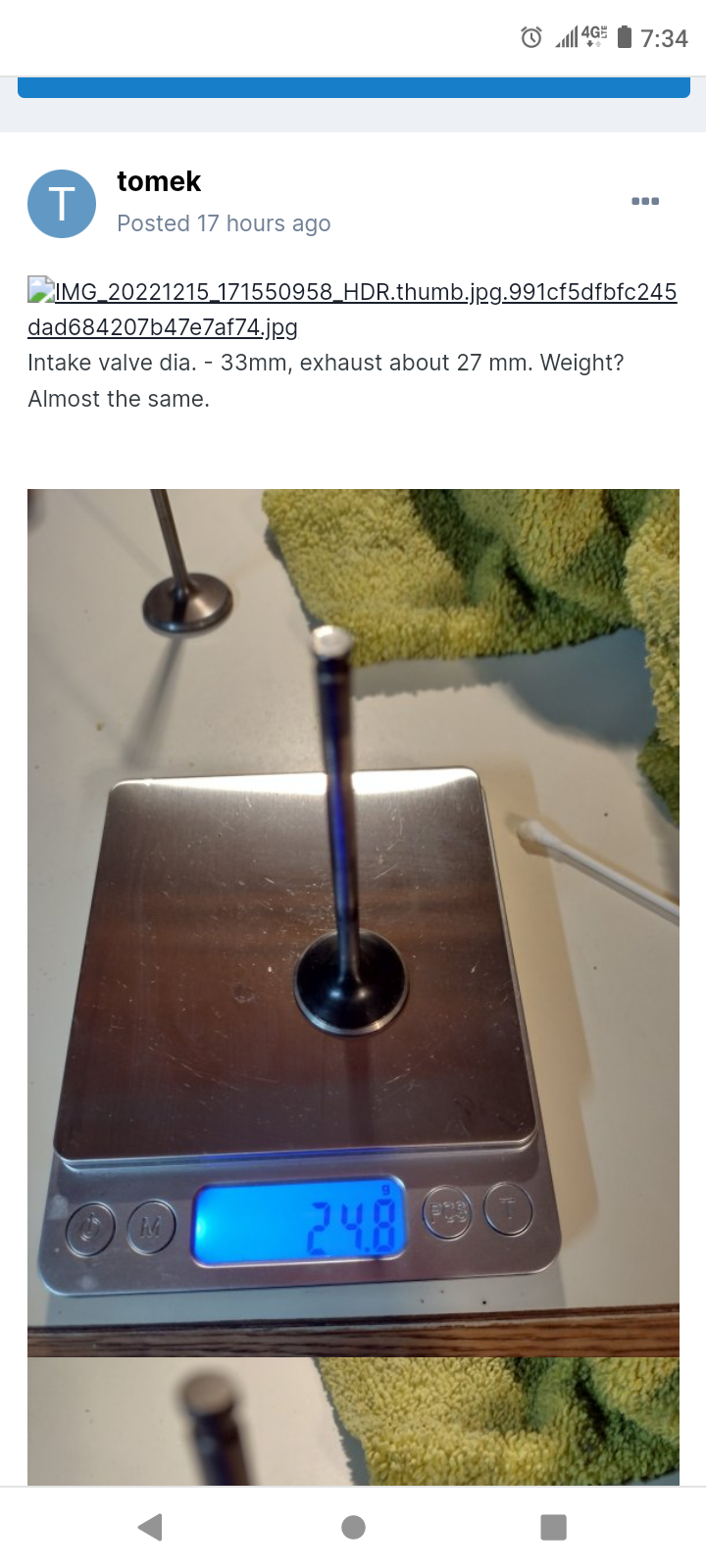

tomek Posted December 18, 2022 Posted December 18, 2022 Intake valve dia. - 33mm, exhaust about 27 mm. Weight? Almost the same. Quote

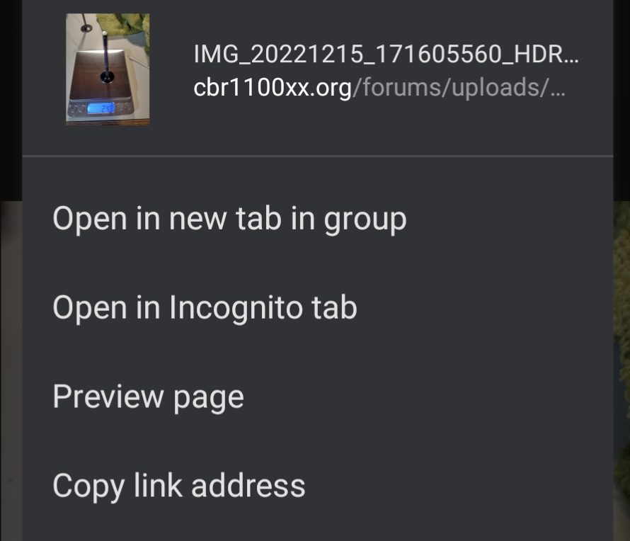

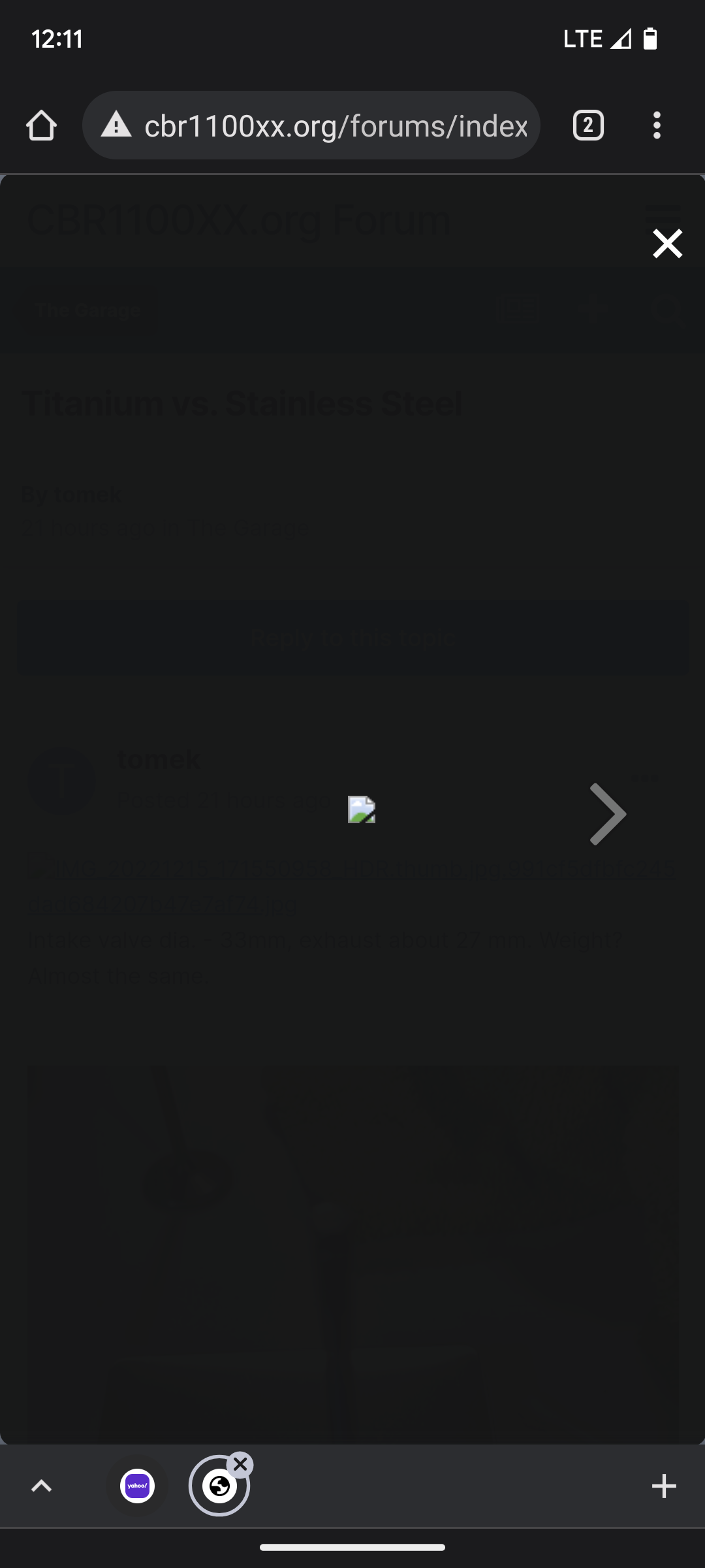

superhawk996 Posted December 18, 2022 Posted December 18, 2022 2 hours ago, tomek said: Intake valve dia. - 33mm, exhaust about 27 mm. Weight? Almost the same. The photo is non-existent. Quote
XXitanium Posted December 19, 2022 Posted December 19, 2022 I think that's aupposed to be a thumbnail of what's shown below his post. Quote
tomek Posted December 19, 2022 Author Posted December 19, 2022 14 hours ago, superhawk996 said: The photo is non-existent. Wut? Quote
XXitanium Posted December 19, 2022 Posted December 19, 2022 I hate it when I break a thumbnail... 1 Quote

jon haney Posted December 19, 2022 Posted December 19, 2022 (edited) Given the same stem diameter, stem length, and head diameter, how can the TI valve still weigh almost as much as a stainless valve? Is the head of the TI valve that much thicker? Personally, I would only use TI valves on intake, but I'm not a pro-stock engine builder. Wait. Is the stainless valve stem hollow, and filled with sodium? Edited December 19, 2022 by jon haney Quote
tomek Posted December 19, 2022 Author Posted December 19, 2022 Why do you say diameter is same? 33mm vs. 27 mm iirc. Intakes are titanium, exhausts - SS. Quote

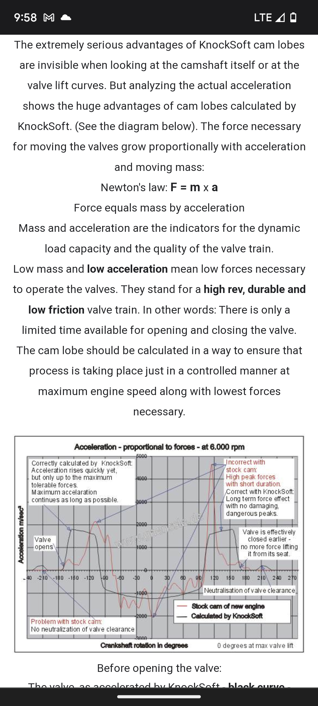

XXitanium Posted December 20, 2022 Posted December 20, 2022 http://www.gaenssle.de/Englisch/NocBeschlVerglE.htm Quote

superhawk996 Posted December 20, 2022 Posted December 20, 2022 I'd never heard of KnockSoft. It sounds impressive on the surface, but from reading their stuff I'm leaning toward calling bullshit. Quote
tomek Posted December 20, 2022 Author Posted December 20, 2022 Well, the goal is 16 minutes ago, superhawk996 said: I'd never heard of KnockSoft. It sounds impressive on the surface, but from reading their stuff I'm leaning toward calling bullshit. Why is it bullshit? Quote
superhawk996 Posted December 21, 2022 Posted December 21, 2022 8 hours ago, tomek said: Why is it bullshit? The language strikes me as infomercial type bullshittery. And unless it's being translated from a foreign language they lack English skills which always raises my concern. Quote
tomek Posted December 21, 2022 Author Posted December 21, 2022 11 hours ago, superhawk996 said: The language strikes me as infomercial type bullshittery. And unless it's being translated from a foreign language they lack English skills which always raises my concern. Nope. The text is perfectly fine and understable for someone who has a clue about basic physics. Not you obviously. Anyway, I briefly considered another engine refreshment thread with new rings, some bearings, cylinder head rework and Kent camshafts. But I had my reservations after last couple of times when some clueless idiot did his best to ruin it. So, this was basically test run. And sure enough the very same guy made his presence felt again. So, that thread won't happen, I don't have time to deal with that guy. Btw, Swamp will be here shortly. Quote
fizzy Posted December 21, 2022 Posted December 21, 2022 (edited) 50 minutes ago, tomek said: Nope. The text is perfectly fine and understable for someone who has a clue about basic physics. Not you obviously. Anyway, I briefly considered another engine refreshment thread with new rings, some bearings, cylinder head rework and Kent camshafts. But I had my reservations after last couple of times when some clueless idiot did his best to ruin it. So, this was basically test run. And sure enough the very same guy made his presence felt again. So, that thread won't happen, I don't have time to deal with that guy. Btw, Swamp will be here shortly. I agree with superhawk on the tone of that link. They compare their cam with the "original manufacturer" but don't say who or what that is. Also, don't say anything about power output, flow rates, etc. Also they show what looks like valve bounce at 5000rpm on the original manufacturer and none on theirs. This means nothing, for all we know this original manufacturer cam may have a max speed of 4500rpm. Edit: when designing and valvetrain, it is always good practice to keep the "jerk" to a minimum, if you know what that is. 😎 Edited December 21, 2022 by fizzy Quote
tomek Posted December 21, 2022 Author Posted December 21, 2022 1 hour ago, fizzy said: Also they show what looks like valve bounce at 5000rpm on the original manufacturer and none on theirs. This means nothing, for all we know this original manufacturer cam may have a max speed of 4500rpm. . 😎 4500 rpm limit, why anyone would wanna put a cam on car diesel engine? 😁 Text and language are perfectly fine from physics point of view. Btw, they are not exactly inventing the wheel. OEM R1 cans are assymetrical, I'll take couple pictures when get back home. Quote
fizzy Posted December 21, 2022 Posted December 21, 2022 1 hour ago, tomek said: 4500 rpm limit, why anyone would wanna put a cam on car diesel engine? 😁 Text and language are perfectly fine from physics point of view. Btw, they are not exactly inventing the wheel. OEM R1 cans are assymetrical, I'll take couple pictures when get back home. You are missing our point, again. We or you, don't know what engine they are comparing to, which is why their claims of greatness are suspect. Can I presume you don't know the meaning of my reference to "jerk"? Quote
