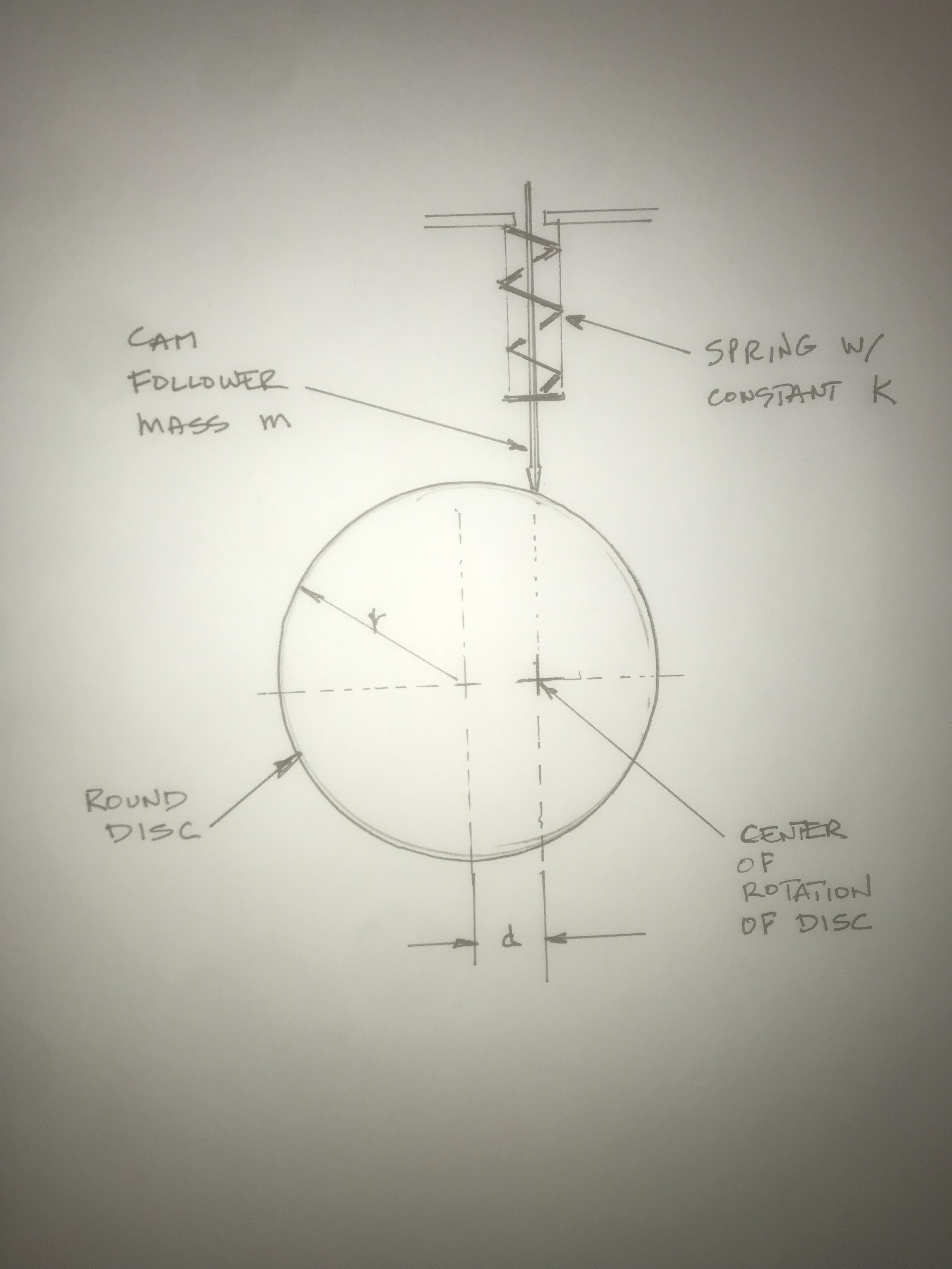

fizzy Posted December 21, 2022 Posted December 21, 2022 1 hour ago, tomek said: Go ahead. Quote Consider: A round disc radius r is rotating clockwise about a point distance d from the disc center. A cam follower is touching the disc at it rotates. K, m, d, r and any other pertinent info is given (metric). Question: What is the max rpm of the disc before the cam follower leaves the surface of the disc. Quote

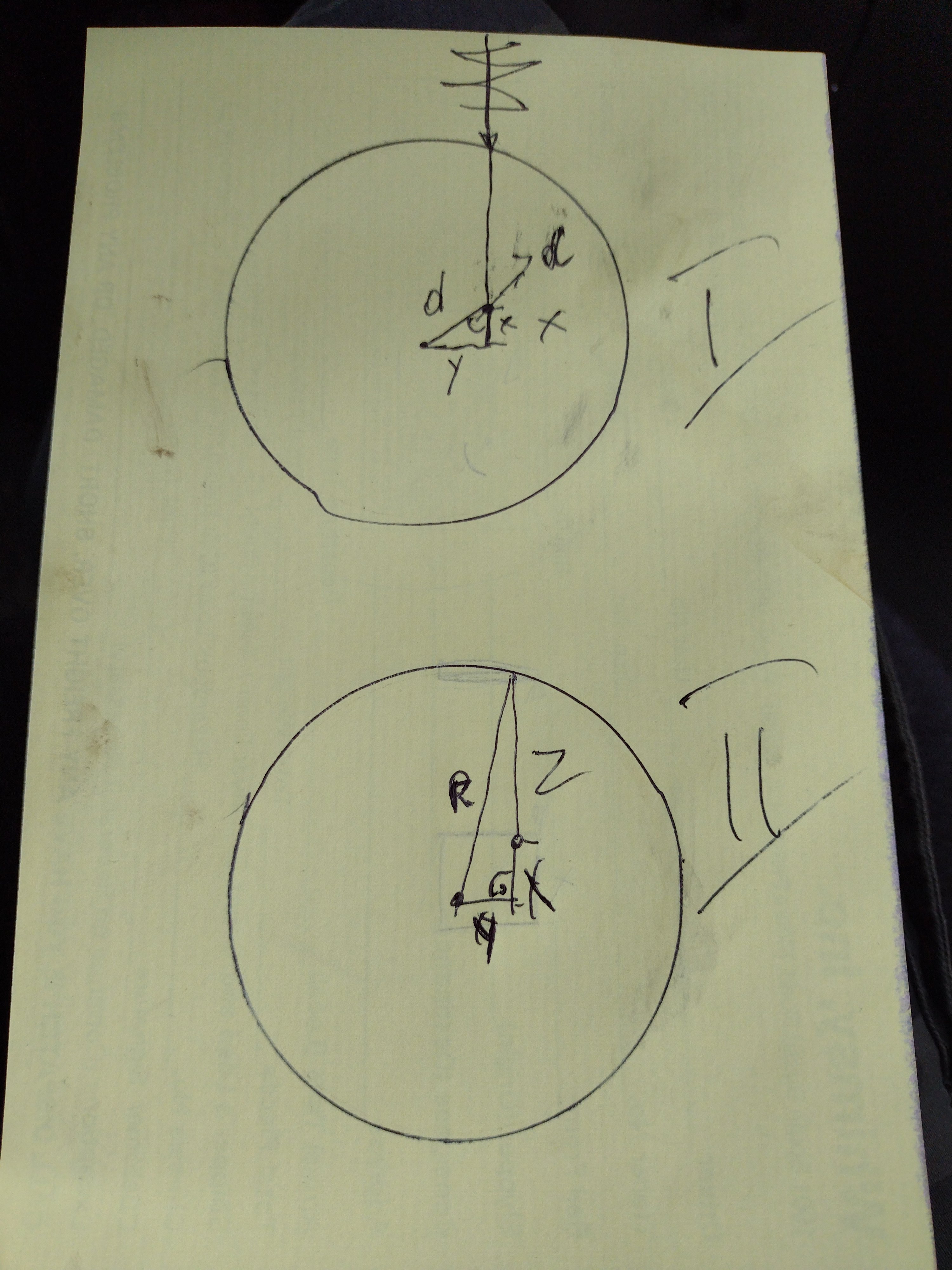

tomek Posted December 21, 2022 Author Posted December 21, 2022 1 hour ago, fizzy said: Consider: A round disc radius r is rotating clockwise about a point distance d from the disc center. A cam follower is touching the disc at it rotates. K, m, d, r and any other pertinent info is given (metric). Question: What is the max rpm of the disc before the cam follower leaves the surface of the disc. That would be fairly easy. First we would have to create calculus for the movement of the rod. It can be easily done by creating two geometric equations. We know d and the angle of rotation of the cam. So we can find x and y. From second one we can calculate z , or essentially the movement of the rod. Pretty much done. Quote

fizzy Posted December 21, 2022 Posted December 21, 2022 1 hour ago, tomek said: That would be fairly easy. First we would have to create calculus for the movement of the rod. It can be easily done by creating two geometric equations. We know d and the angle of rotation of the cam. So we can find x and y. From second one we can calculate z , or essentially the movement of the rod. Pretty much done. "Pretty much done" No. That is the very first step of many many steps. I will say you are pointing in the right direction, so, good job. This section of the test gave 60mins, or actually, 4 hrs to do any 4 out of 8 questions. I guess this was the easiest as I remember doing it first. 🍺 Quote
tomek Posted December 21, 2022 Author Posted December 21, 2022 3 minutes ago, fizzy said: "Pretty much done" No. That is the very first step of many many steps. I will say you are pointing in the right direction, so, good job. This section of the test gave 60mins, or actually, 4 hrs to do any 4 out of 8 questions. I guess this was the easiest as I remember doing it first. 🍺 I mean, last time I had to deal with things of that nature was in mid 80's so don't expect me to remember advanced math. But coming up with mathematical equation for the movement of the rod vs. cam angle is the main thing here. Maybe, maybe after completing it would be clearly apparent at what angle of rotation the acceleration is the greatest. Maybe. Back when I was at peak form it would take me about 10-15:minutes to deal with it. Now, 4 of those would be entirely different story, we all know after extended period of intense thinking brain starts to smoke, and becomes useless.😁 Quote
fizzy Posted December 21, 2022 Posted December 21, 2022 6 minutes ago, tomek said: I mean, last time I had to deal with things of that nature was in mid 80's so don't expect me to remember advanced math. But coming up with mathematical equation for the movement of the rod vs. cam angle is the main thing here. Maybe, maybe after completing it would be clearly apparent at what angle of rotation the acceleration is the greatest. Maybe. Back when I was at peak form it would take me about 10-15:minutes to deal with it. Now, 4 of those would be entirely different story, we all know after extended period of intense thinking brain starts to smoke, and becomes useless.😁 But coming up with mathematical equation for the movement of the rod vs. cam angle is the main thing here. yes then: Differentiate the formula of position to get the formula for velocity. " " " " velocity to get the formula for acceleration set this formula against the potential acceleration generated by the spring. In all my years working, I never ever had to do any calculus. Very little math really, compared to the stupid amount I had to learn. 1 Quote

jon haney Posted December 22, 2022 Posted December 22, 2022 18 hours ago, fizzy said: But coming up with mathematical equation for the movement of the rod vs. cam angle is the main thing here. yes then: Differentiate the formula of position to get the formula for velocity. " " " " velocity to get the formula for acceleration set this formula against the potential acceleration generated by the spring. In all my years working, I never ever had to do any calculus. Very little math really, compared to the stupid amount I had to learn. Related to the actual Question: (What is the max rpm of the disc before the cam follower leaves the surface of the disc?) I believe we would need to know spring rate, starting seat pressure, effective mass of the follower/spring combo, and any friction of movement of the follower. As Tomek would say, Fun stuff. Quote
fizzy Posted December 22, 2022 Posted December 22, 2022 1 hour ago, jon haney said: Related to the actual Question: (What is the max rpm of the disc before the cam follower leaves the surface of the disc?) I believe we would need to know spring rate, starting seat pressure, effective mass of the follower/spring combo, and any friction of movement of the follower. As Tomek would say, Fun stuff. Per my post "K, m, d, r and any other pertinent info is given (metric)." On the actual test they expected an actual rpm result. I don't remember the actual numbers but I can make some up if you want to grind it out.🍺 Quote
jon haney Posted December 22, 2022 Posted December 22, 2022 26 minutes ago, fizzy said: Per my post "K, m, d, r and any other pertinent info is given (metric)." On the actual test they expected an actual rpm result. I don't remember the actual numbers but I can make some up if you want to grind it out.🍺 That's okay. My college era math skills are mostly gone, too. Was just pointing out other factors that would affect a real world result. I always laughed at all the text book problems that would state: "assuming an ideal gas" or "assuming constant temperature". Quote

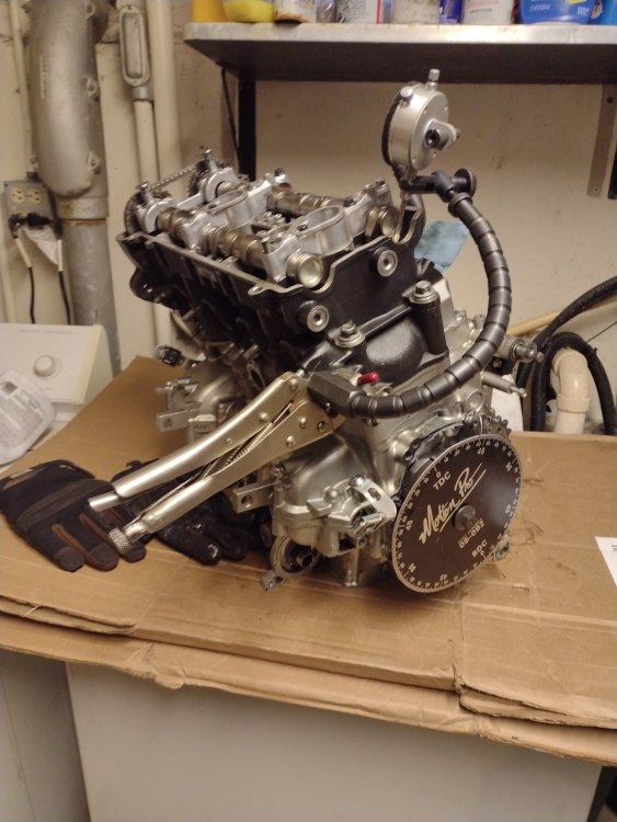

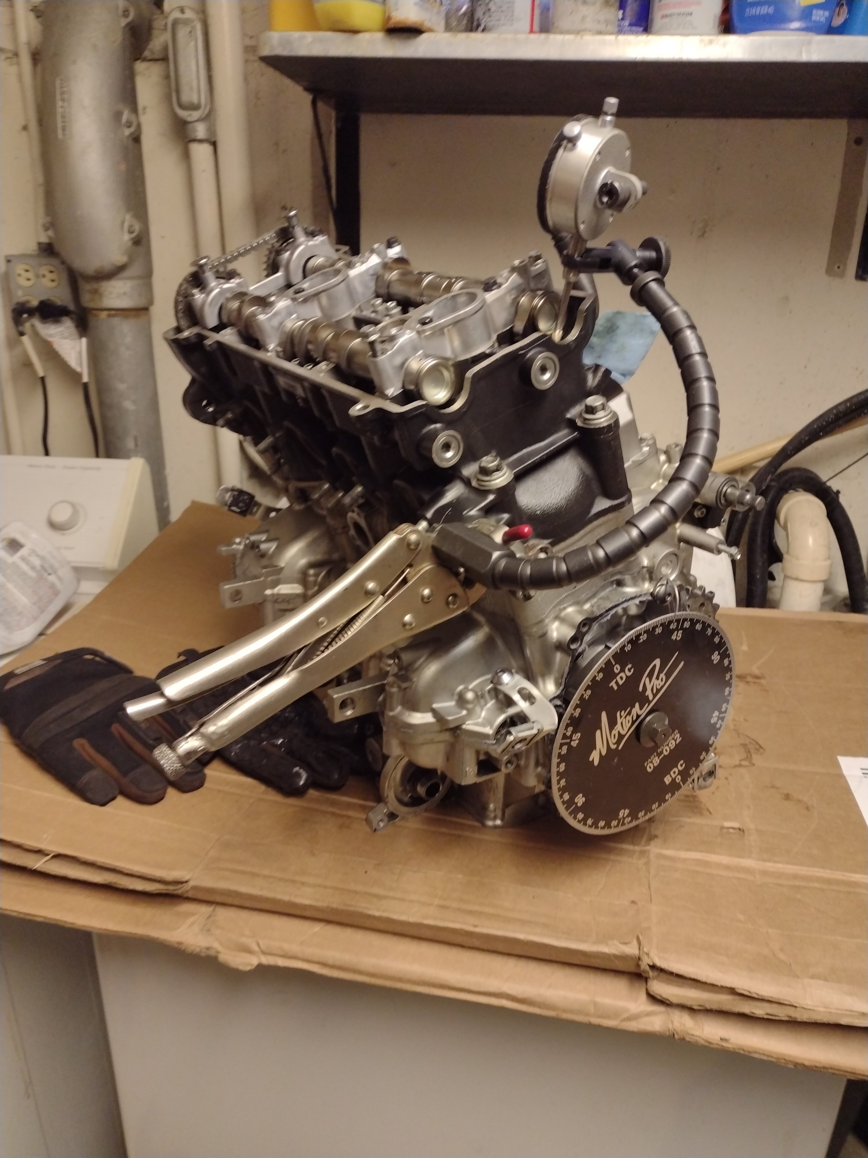

tomek Posted December 24, 2022 Author Posted December 24, 2022 (edited) Yep. Two clueless never know when to shut up. ignorant on this particular subject morons showed up. As I predicted. Lol. That's why there won't be built thread. Don't blame me. I'm not gonna deal with one or both of them doing their idiotic best to fuck up my posts. Been there, not doing again. Btw, it is almost done. New valve job by KWS, Kent cams, cams have been degreed, valve clearance adjusted, piston to valve clearance checked. Waiting for main bearings. One looks like squirrel took a bite of it. No clue why. Decided to replace all of them. Only 85 bucks. Edited December 24, 2022 by tomek Quote
tomek Posted December 24, 2022 Author Posted December 24, 2022 (edited) I moved engine to laundry room. Too cold in garage. Kent cams have this nice future allowing to use 24 mm wrench to hold or move cams when adjusting timing. Makes the process so much quicker. Edited December 24, 2022 by tomek 1 Quote

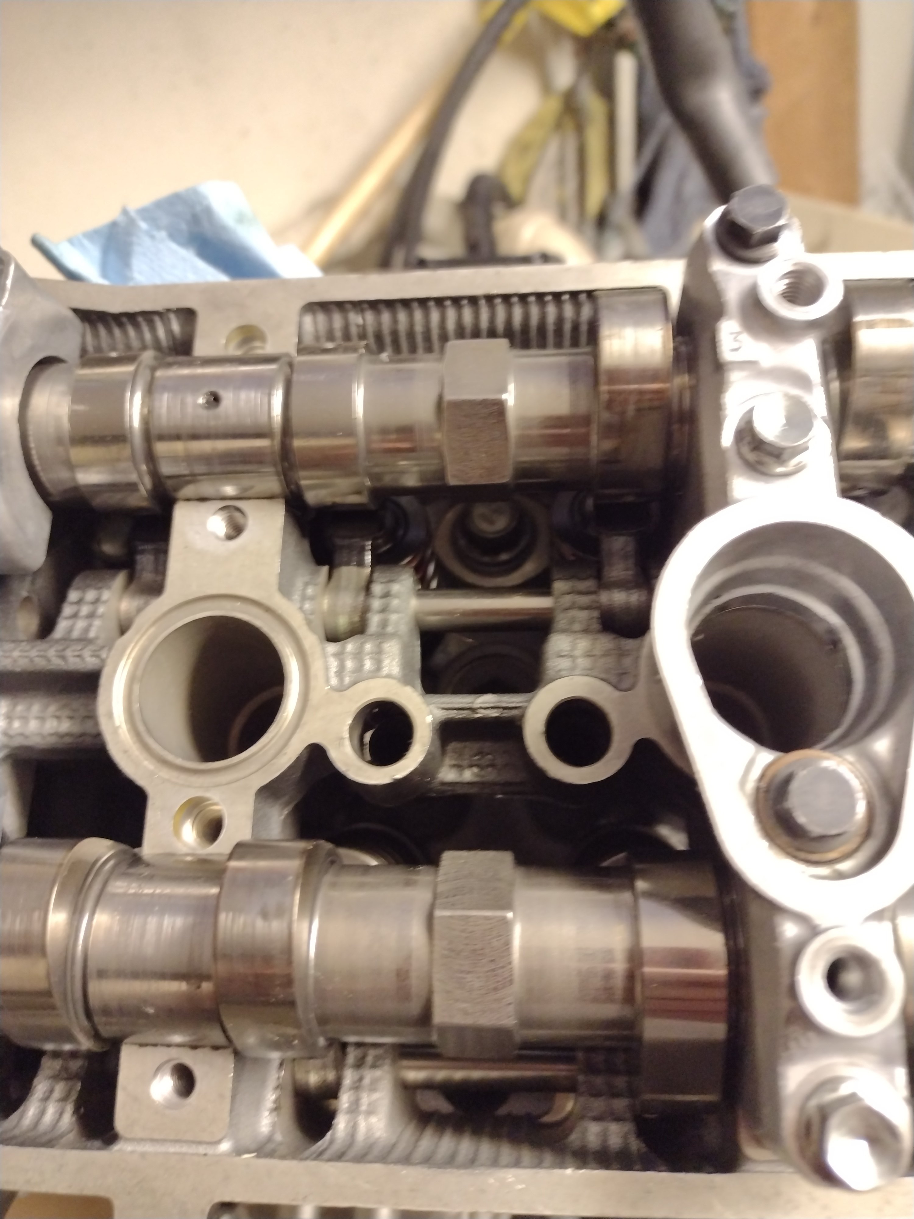

tomek Posted December 24, 2022 Author Posted December 24, 2022 Check out assymetrical profile of camshafts. According to our Cuban experts, higs school dropouts clueless about basic physics, it is all Bull Shit marketing. Lol. Kent and OEM have similar profiles, more lift in case of aftermarket. Quote
