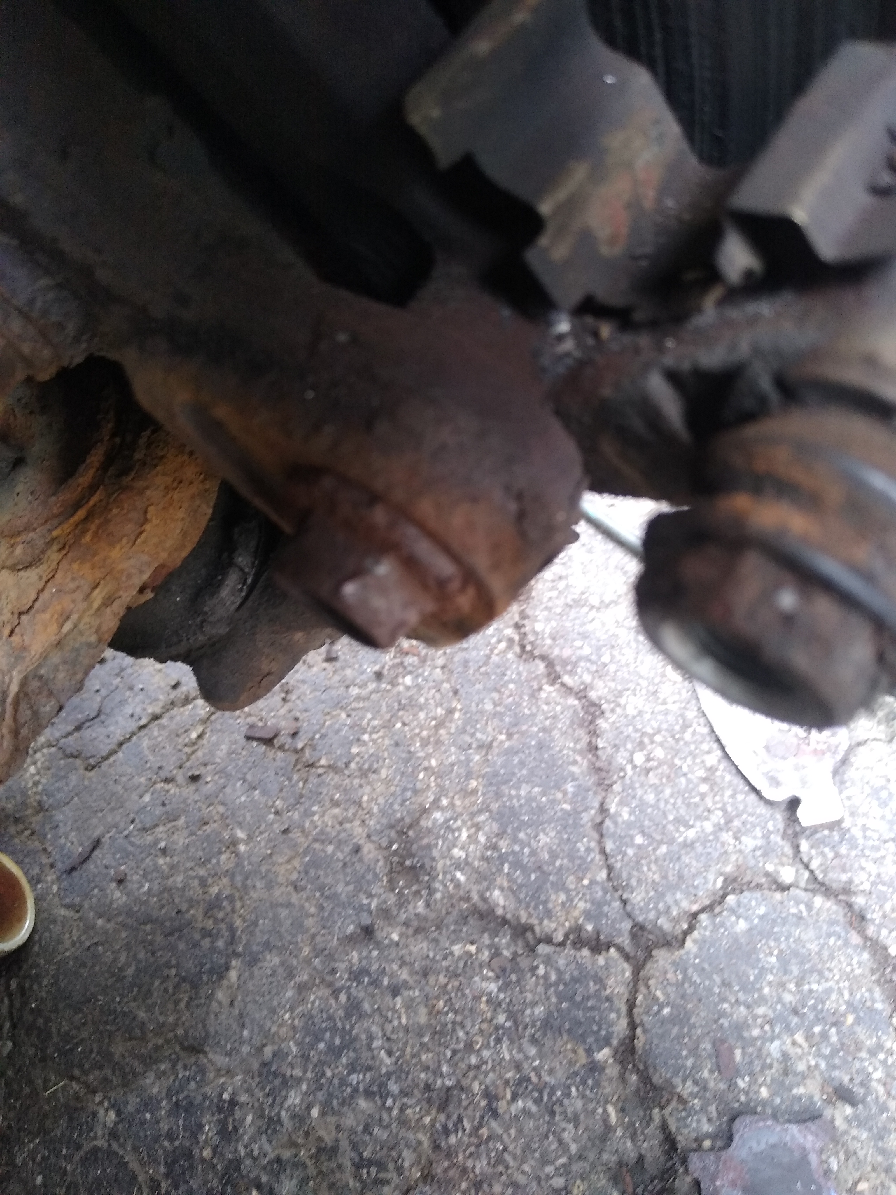

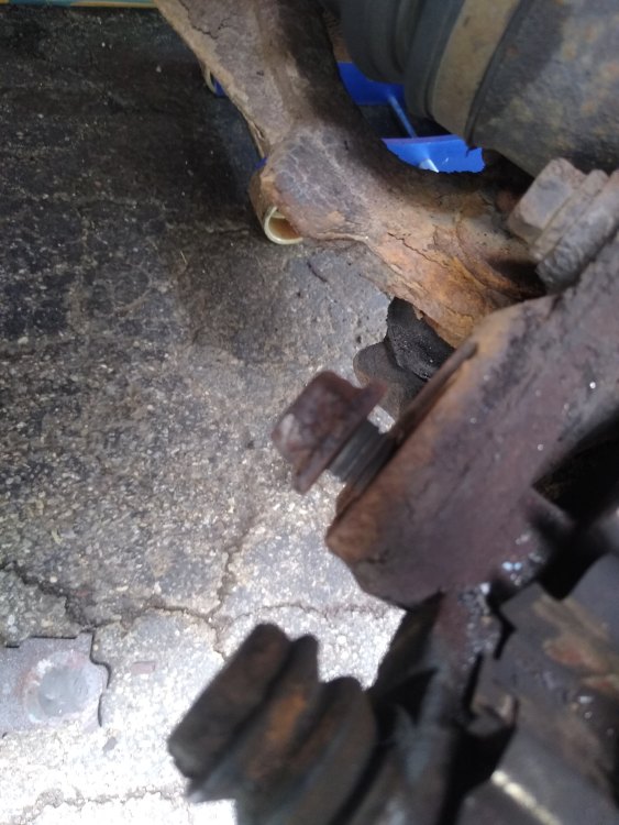

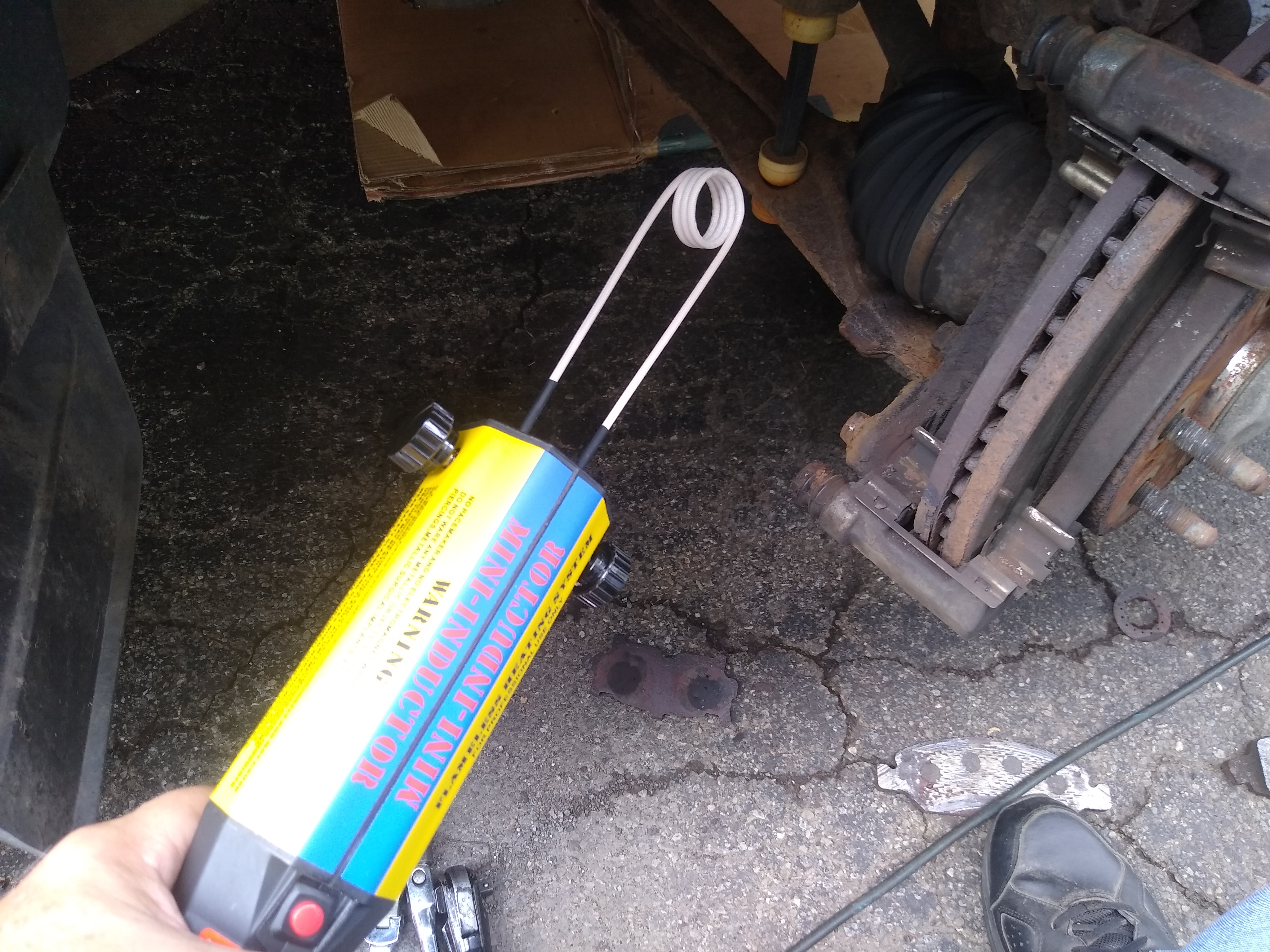

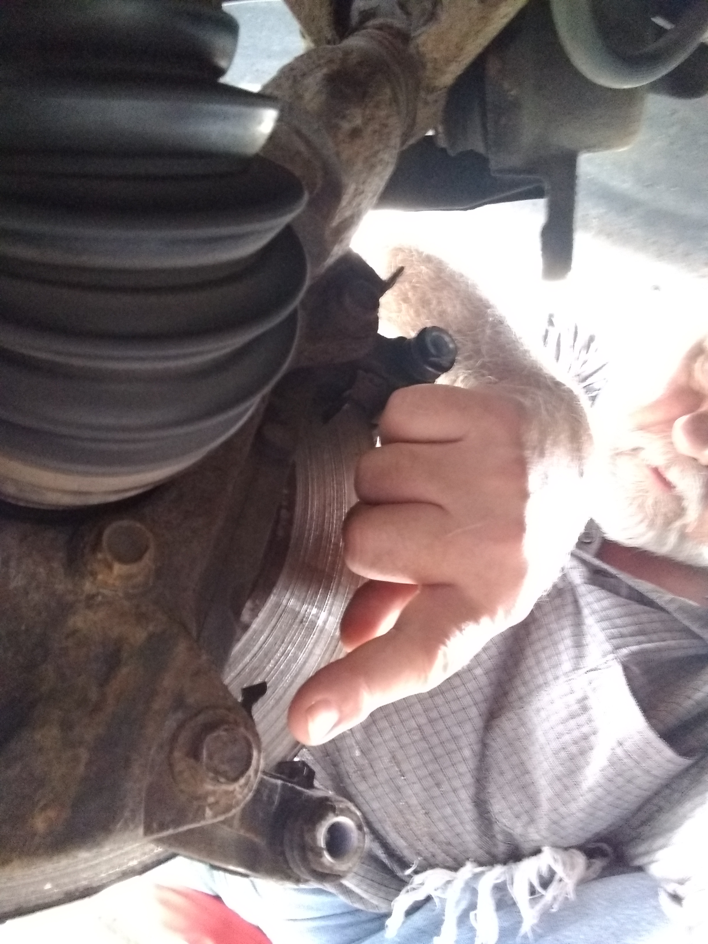

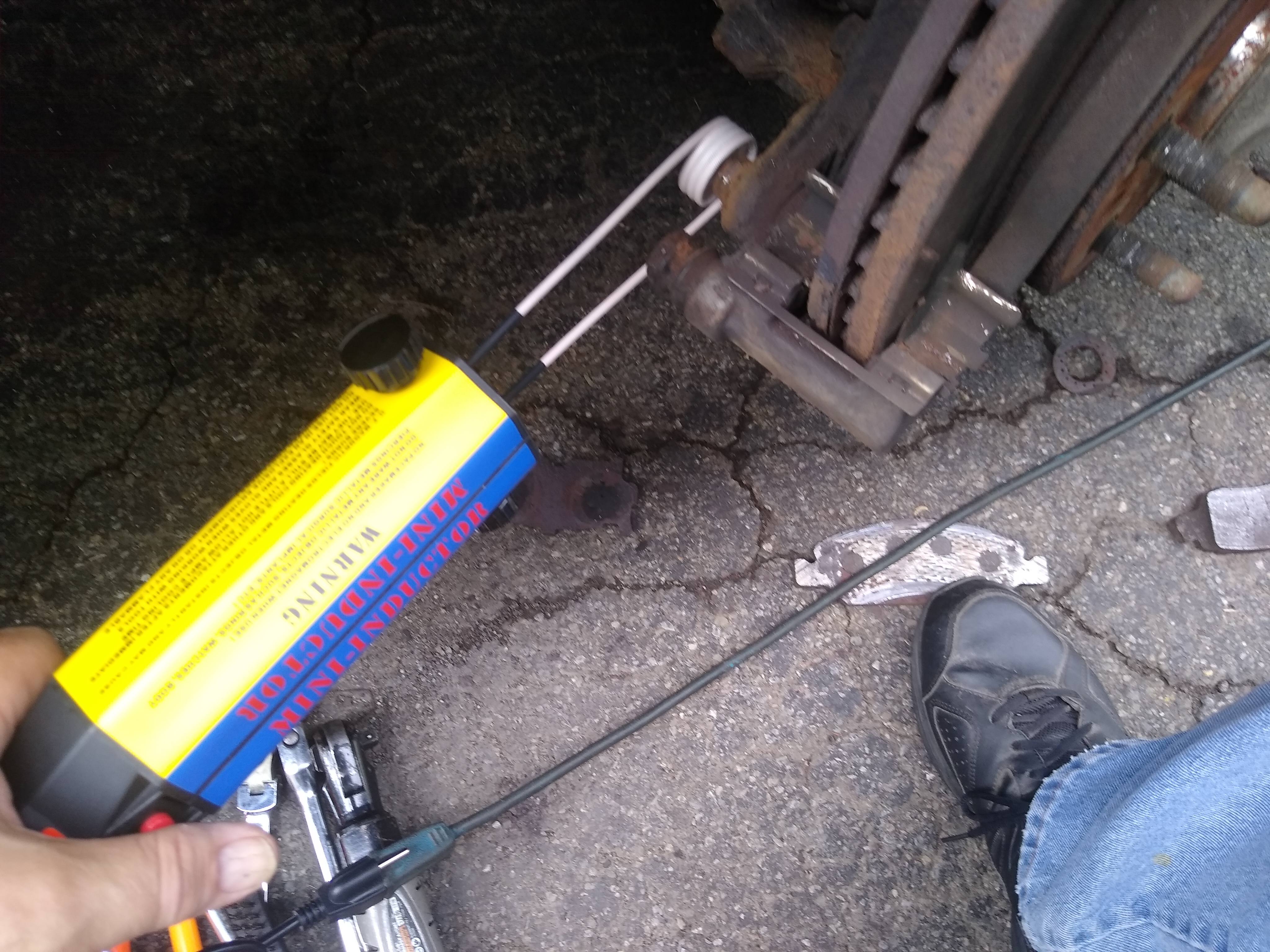

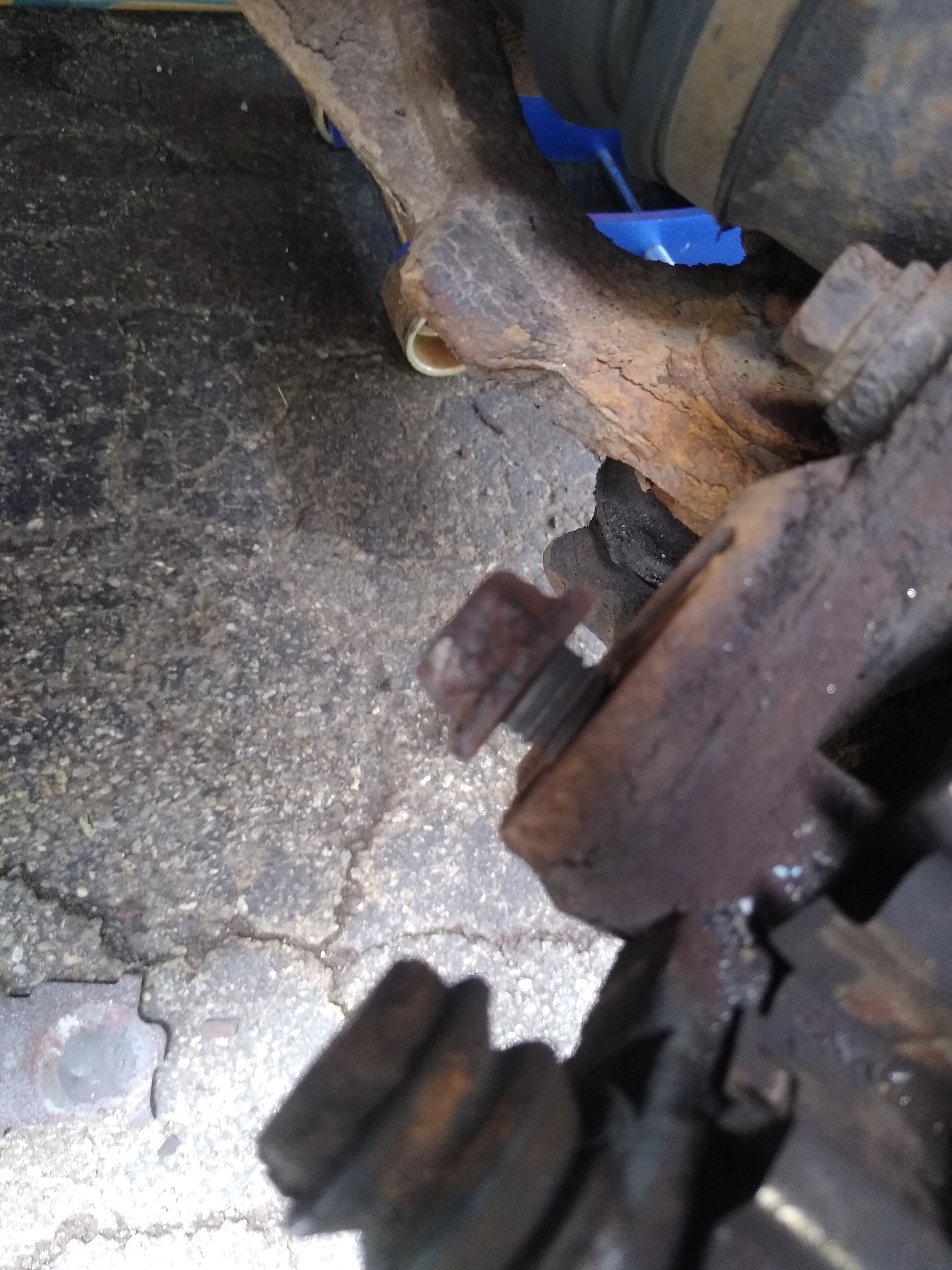

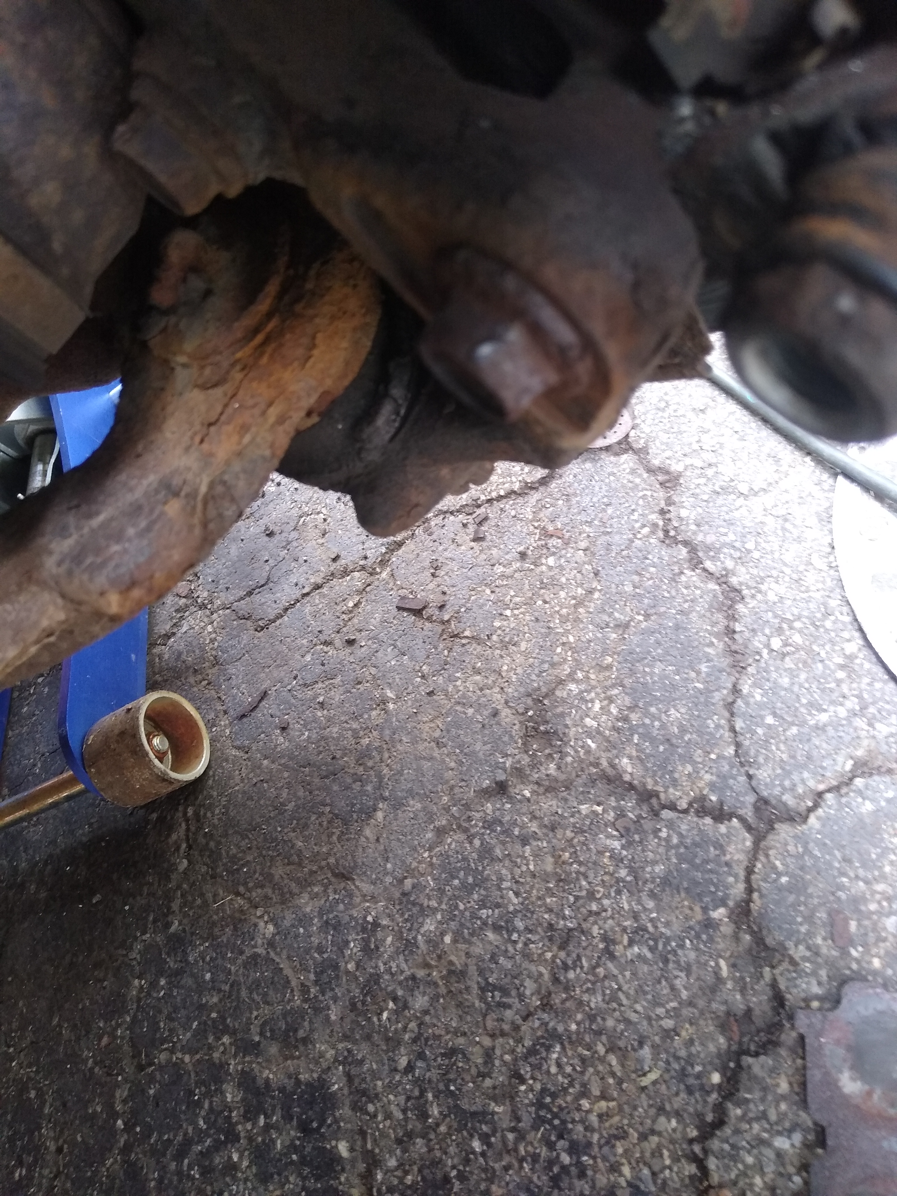

rockmeupto125 Posted August 9, 2022 Posted August 9, 2022 Okay, it's time for a little story. Blue truck makes a grindy noise. Can't be positive if its the fenortinny rod bushing or the reciprocating gungulator shaft union, but both are on infinite back order so I decided to just change the brakes and rotors because they don't seem as smooth as usual and I'm almost out of brake fluid. One side is a 15 minute job if you know where in my garage the correct sockets are. I don't, so 45 minutes into an easy job, I come to a dead stop with a pair of exponentially torque resistant bolts. Progressing rapidly through 3/8ths to 1/2 inch, 16 inch breaker, 6 point wrench with hammer, 24 inch breaker, 24 inch with torque multipliers (jack handle, then 4ft fence pipe), it was decided this task needed to escalate aggressively. The 95 degree ambient temp was certainly not enough, so we were going to need more heat. Now if you've seen my garage, you'll appreciate that when I say it would take an hour to get my tanks outside, I mean it. That's another hour in the heat, so forget that. A MAPP torch would work, if I could only find mine. And there's also the consideration of heating components that I might not want to have to replace. Here's one of those bolts. The other looks quite similar. So I grab a suspiciously clean box off my shelf. It's clean because I put it there only a few days before this. I used a blade to get through the super grip tape used for boxes intended for international shipping. And oh my goodness, what is this? Maybe an oboe! Correctly played, it can make people leave their seats. Maybe it will do the same with bolts! The bubble wrap goes to the lady. As suspected, she is cheaply and easily pleased. But, no oboe. Instead, this pleasantly tinted box holds a special tool indeed...a space age item called an induction heater. Been wanting one for a while, and now that money is becoming quickly worthless, this was getting to be at an attractive price. It's a 1000 watt unit, whatever that means, and came with several heating coils in different configurations, as well as the requisite paperwork. Which was quickly man-processed. So I placed an appropriate coil in the screw fastening blocks, plug it in, and approach the insolent bolt, heeding the instructions not to dry fire the device, but to only activate it under load. I place the coil around the bolt, and fire it off. A fan comes on, and an LED. After 30 seconds of therapy, the bolt looks like this. I again approach the bolt...... And after a second 30 second therapy session, the bolt now looks like this. Quote

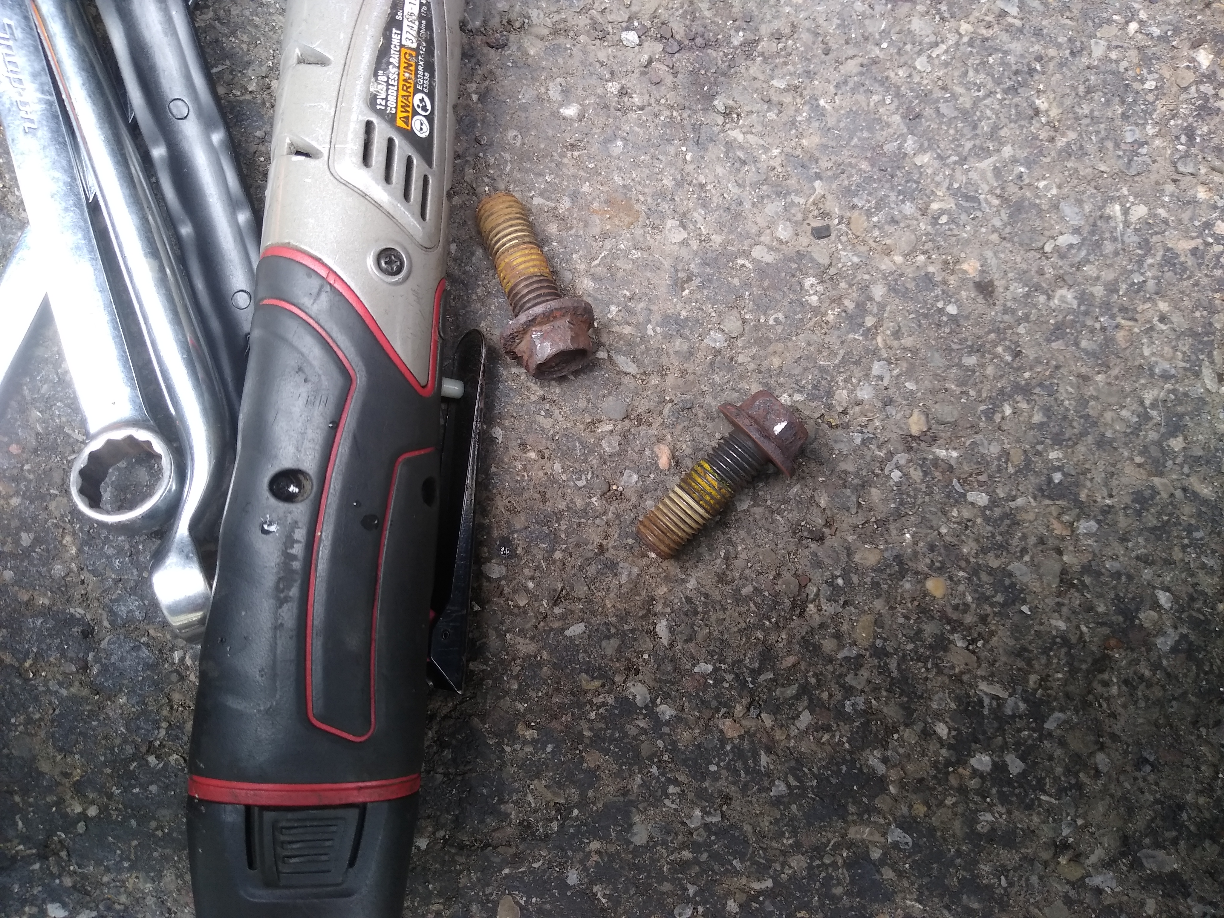

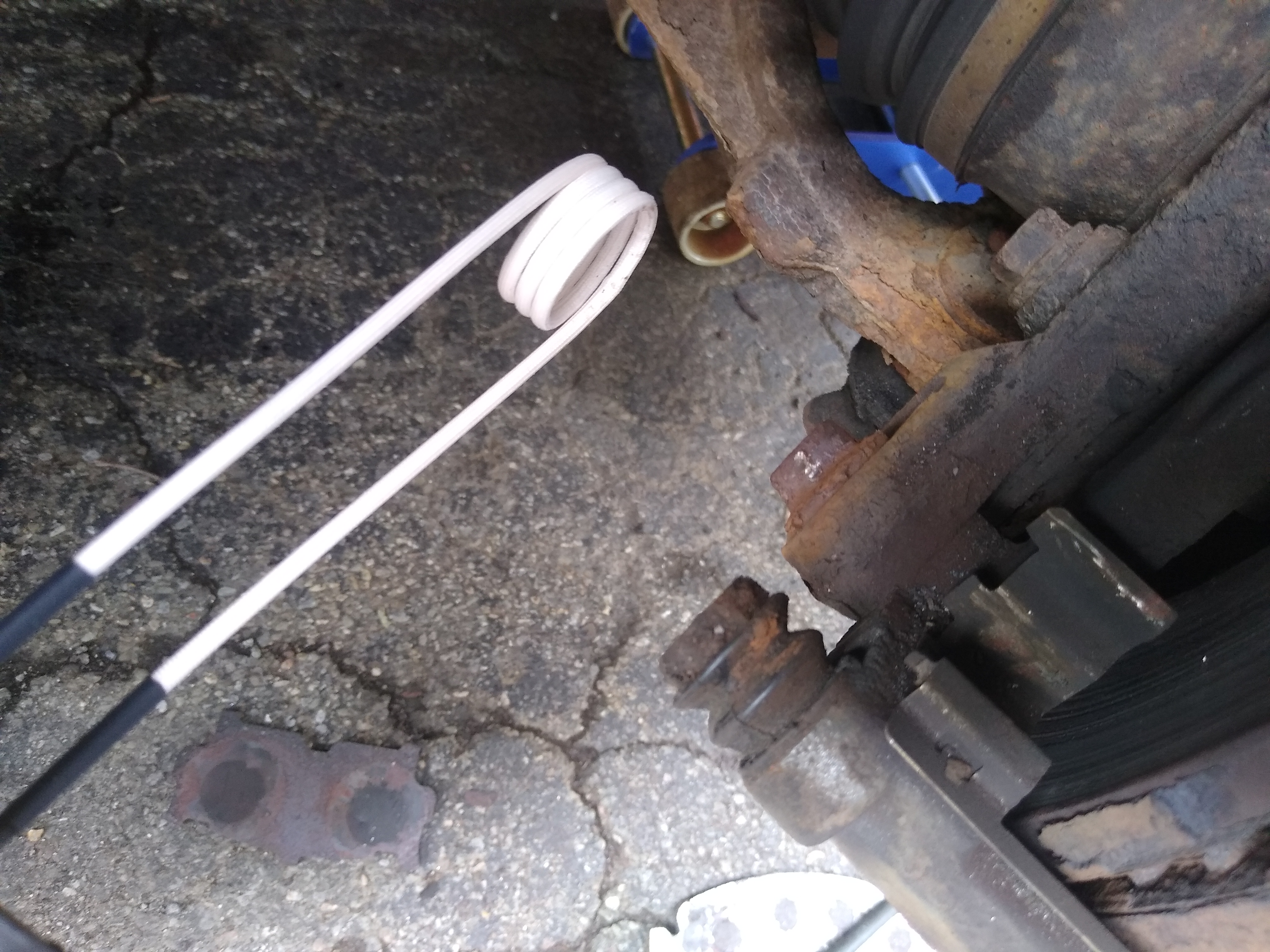

rockmeupto125 Posted August 9, 2022 Author Posted August 9, 2022 After 2 more 30 minutes second treatments, the bolt continues to appear undisturbed, but there is some significant heat coming off it. Of course, I neglected to drag out my digital thermometer. Next, time, I assure you. A little tug with a 24 inch breaker bar and the bolt readily loosened. The exact same process worked for the second bolt. After a half turn, I was able to spin these guys out with my 3/8ths electric ratchet. And would you look at that...over 200k miles and these little wretches still have the factory threadlocker on them. Those caliper mounts weren't coming off without a fight. A brief application of T30 bit on the rotor and it's FREE, FREE from its prison of the last 11 years. Does anyone know how much a Silverado 1500 brake rotor weighs? Steel toed shoes are a good thing. That I'm not wearing. After an hour break to ice my foot and cool off, and then see if my toe bent in the right direction, the whole thing went back together pretty readily. And my shiny new brake rotor a couple days later when I remembered to take a picture. The grinding went away, so I don't have to go to the junkyard looking for backordered parts. I went anyway, but that's another story. So, bottom line. I got a new 1000 watt induction heater to try out. Never used one before. I don't know how hot it got, and there's no way to prove that using it is what allowed me to remove the bolts. Scientifically, I've made no progress. And from a user perspective, there was a noise, I spent several hundred dollars, now there is not a noise and I got my brake fluid back. I walked with a limp anyway, so there really wasn't a change there. 3 2 Quote

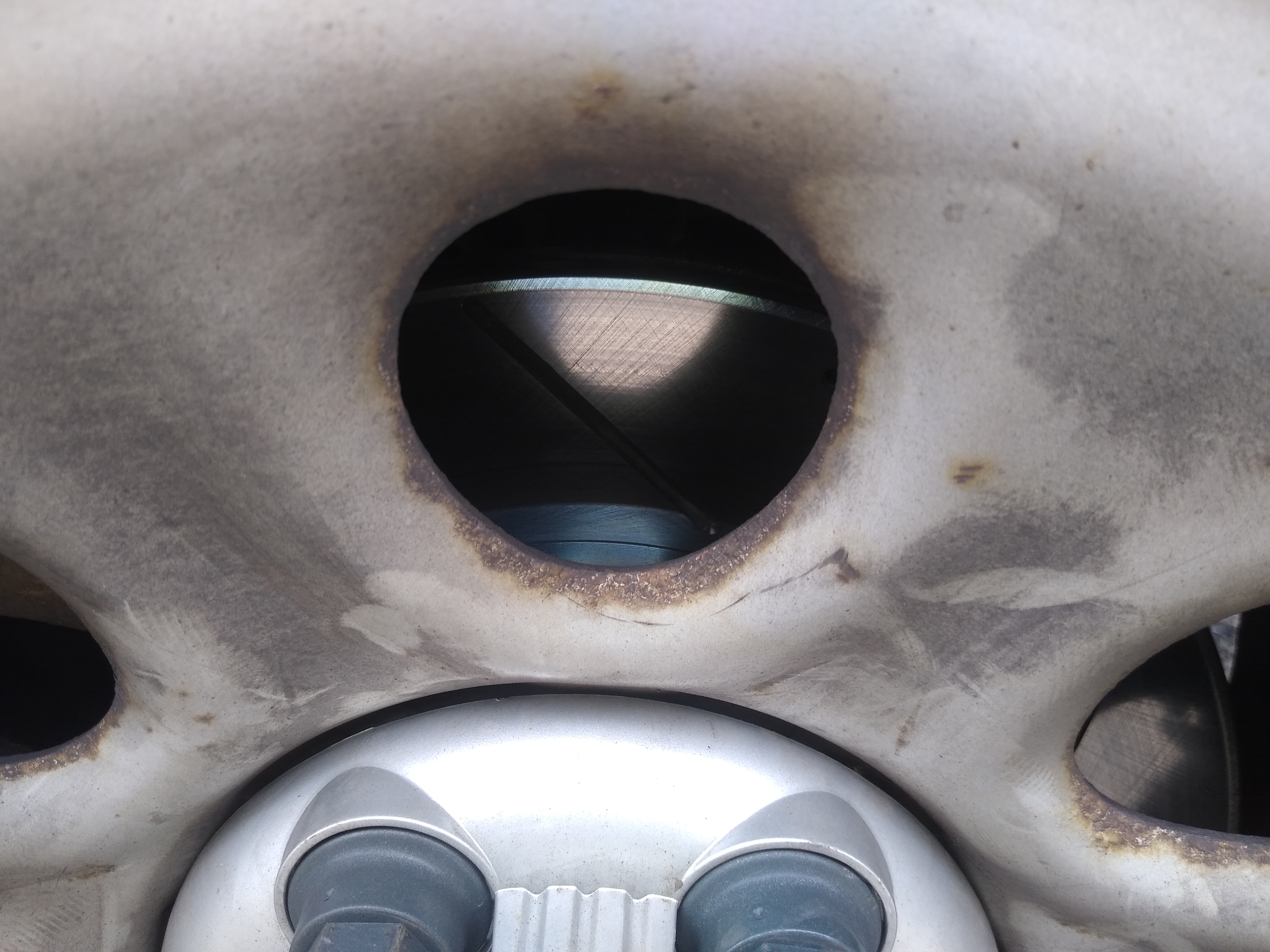

Furbird Posted August 10, 2022 Posted August 10, 2022 Photo #1 is why I don't live north of I-20 or within 10 miles of saltwater. All y'all Yankees need to MOVE. Quote

XXitanium Posted August 10, 2022 Posted August 10, 2022 9 hours ago, Furbird said: Photo #1 is why I don't live north of I-20 or within 10 miles of saltwater. All y'all Yankees need to MOVE. ...or outlaw salt on roads? 2 Quote
rockmeupto125 Posted August 10, 2022 Author Posted August 10, 2022 11 hours ago, XXitanium said: ...typo, or was it that much time? Inquiring minds want to know. Not a type, dumb fingers. Edited and thanks for the proofread. The unit will supposedly kick out on overheat, and directions (yes, I did read them) suggest a maximum of 120 second therapy sessions before allowing the unit to cool down. 7 hours ago, superhawk996 said: I can't tell you how many times I've loosened a bolt that "there's no way to loosen" without employing the fire wrench. There's a bunch of stuff that can loosen a stuck bolt that many people don't try. I've also had many that looked like there was nothing wrong and I had to drill/cut them, most commonly in aluminum or stainless. Same here, but the deciding factor to go big in this case was the rapidly deteriorating integrity of the bolt's drive face after multiple failed attempts to reef it off. Incidental factors included accessability, lost time, and it was too physically hot to work outside for more than 15 minutes at a time. 1 Quote
superhawk996 Posted August 10, 2022 Posted August 10, 2022 Generally, there's no harm in using some heat, and having this non fire hot wrench it would be my go-to. Those caliper mount bolts can be a bitch even without rust, I've used my 3/4" dr. impact on a few. Quote

rockmeupto125 Posted August 11, 2022 Author Posted August 11, 2022 I think geography plays a big part in how bolts get seized up. Granted, they all have the same threadlocker on them from the factory. Fur uses BG products and I still have some on the shelf, good stuff. But rust is a whole different ball game combined with salt and multiple heat cycles. Heating the bolt melts the threadlocker. It also heats the surrounding material, which then also expands. Net result is a larger gap, and a better chance of removing the bolt. Quote
