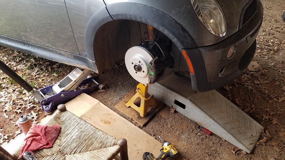

superhawk996 Posted December 31, 2019 Author Posted December 31, 2019 (edited) That's sketchy looking. Since the floor jack probably can't roll under load it'll try to pull the car as it raises and the pad could slip out from under it. If it's lifting on a fold/pinch weld like most cars use for the stock jack it's likely to bend and flatten it. There's double back-up against falling, but those back-ups look a bit sketchy too. It's a brake job so unlikely to pose a threat of serious injury/death if it falls, but there's potential to do damage to the car. Putting the jack on a thick hard board long enough so it can roll as it lifts would help with that part, or use the factory jack. Move the jack stand to something non-suspended and set the car on it so that it's loaded rather than the car having to fall onto it. With most cars you're safe putting a stand where the lower control arm attaches to the car, or a crossmember, I don't know that car's undersides. With the stand where it is, and it appears to not be in contact with the car, the dropping motion and suspension movement combine to increase the chance of the stand slipping out or trying to fall over if the jack failed. Edited December 31, 2019 by superhawk996 Quote
