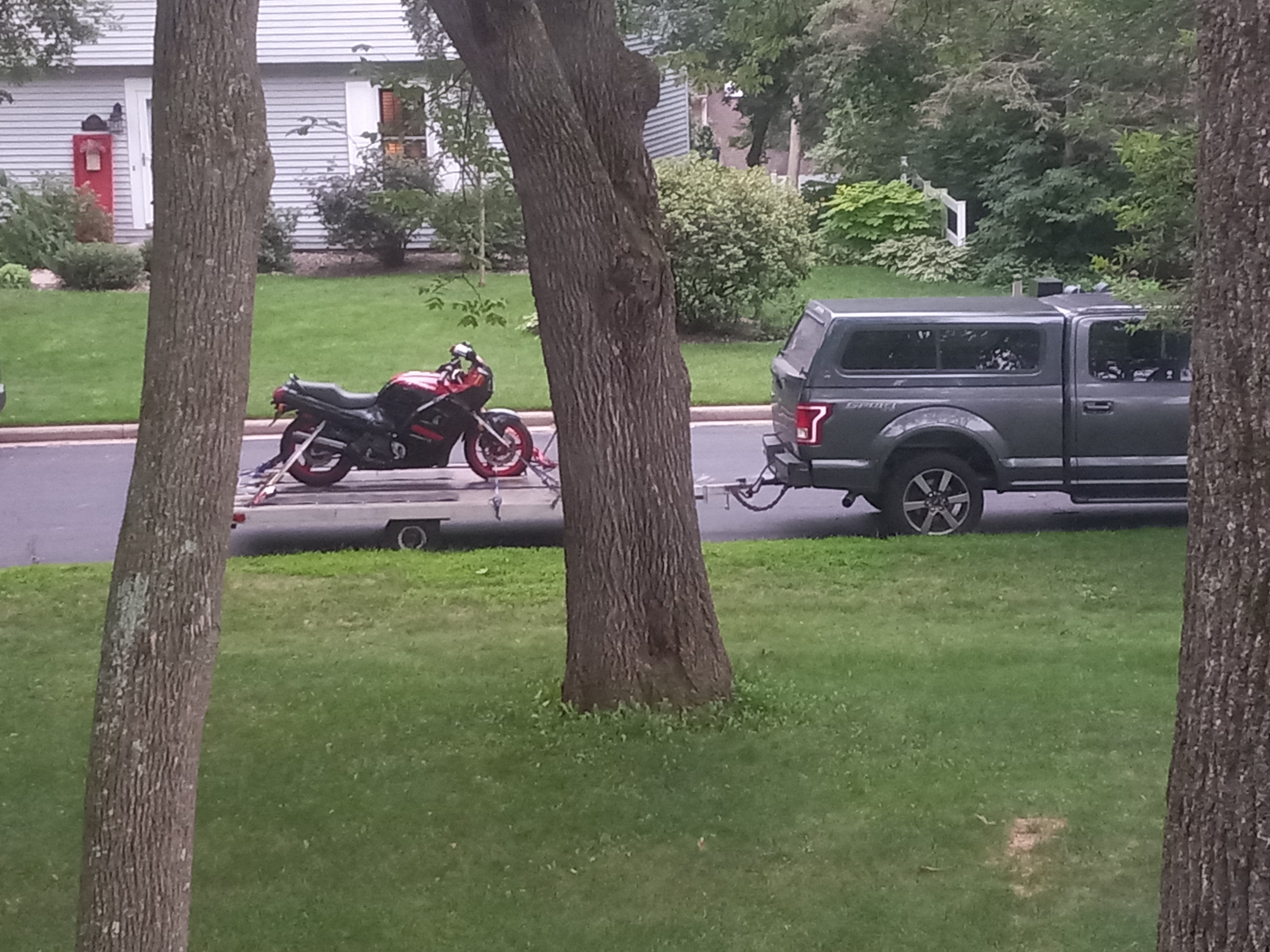

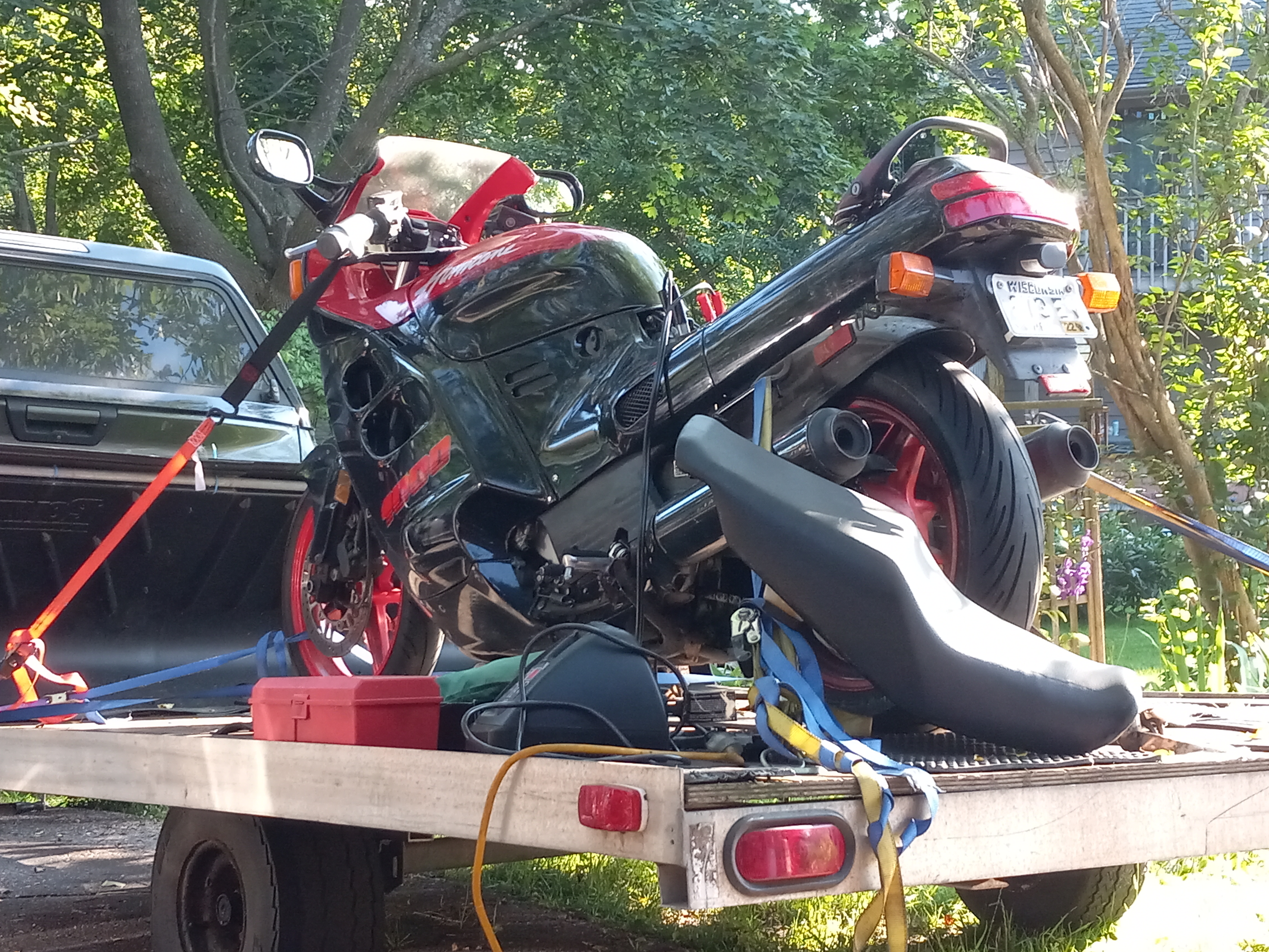

XXitanium Posted August 15, 2022 Posted August 15, 2022 How much juice does it take to turn a Honda 1000cc motor's starter? The Hurricane did not start earlier this month. Went to help son no. 1 move back to southern WI. We stayed with no.3 and picked it up. I tried some rudimentary diagnostics. The battery, charged as I understand, was at 10.5V, that's too low, but the solenoid should at least click?T he horn was very faint when I pushed the button. The headlight was dim. He had been riding it. He stopped, parked it, came back and got this no-start. As I understand it he pushed it a mile to his house after that. First, trythe smart charger... Quote

XXitanium Posted August 15, 2022 Author Posted August 15, 2022 (edited) 6 hours ago, tomek said: I'd like to point it is possible to bump start carbed inline 4 bike. My son and I have both pushed started this bike. He didn't explain why it didn't work the last time it was a very hot day in Milwaukee. I have a charger with the engine start feature it pushes 85 amps. The bike did try to start a little bit. But not a real healthy starter noise. I put the trickle charger on it tried it at noon it went a little more. Now after work I got it to go. The testing panel on the charger says 12.7 amps, charger off, no load Edited August 16, 2022 by XXitanium Quote
