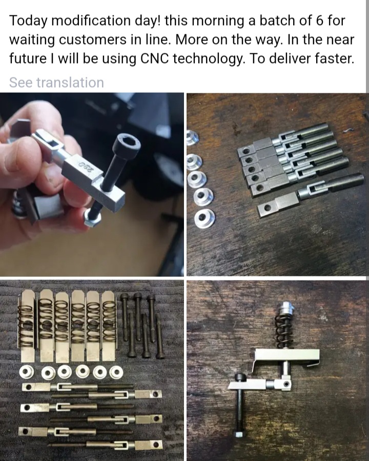

XXitanium Posted September 20, 2022 Author Posted September 20, 2022 This will abate that low end rattle. Apparently it also helps with starting and cam timing. https://m.facebook.com/1527216750923732 https://m.facebook.com/story.php?story_fbid=pfbid02NxBtE5QD6EqF89j6uJxnffjaMn2JMonViLdNcCELNikYQgrRpy1gNoTb9us34veVl&id=1527216750923732 About 160.00 for parts right now. Al at the shop figured about 2 hours labor. I rode it up the block a week ago. It's starting quite well. Quote
XXitanium Posted September 20, 2022 Author Posted September 20, 2022 The XX has CCT issues after some miles? . Quote
