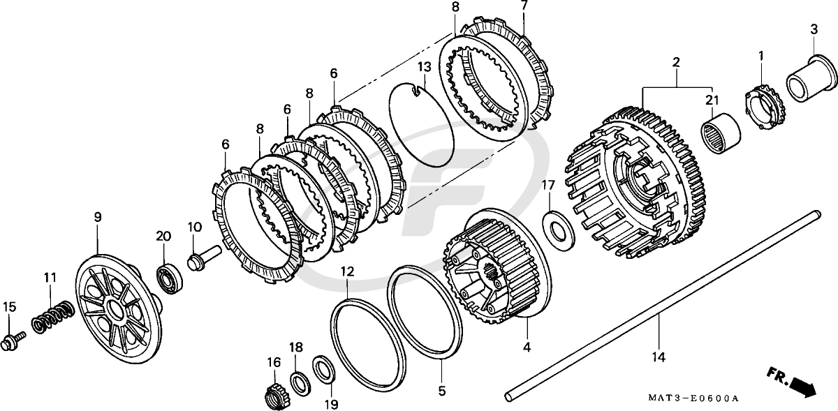

fizzy Posted August 21, 2024 Posted August 21, 2024 (edited) Pulled my 1997 BB clutch apart to free sticking plates. Noticed that the "clutch center clip" is missing, part number 13 below. This part was deleted on FI models, among a few other changes to the clutch. Question, what does this part do? Is it important that I install a new one? According to the manual they are one time use only? Other than sticking, clutch seems ok. P/N: CLIP, CLUTCH CENTER 22431MAT000 https://www.fowlersparts.co.uk/main/img/assemblies/large/d71f7bbe6366ad6e87e82b7b26f4b3c3.png?6 Edited August 21, 2024 by fizzy Quote

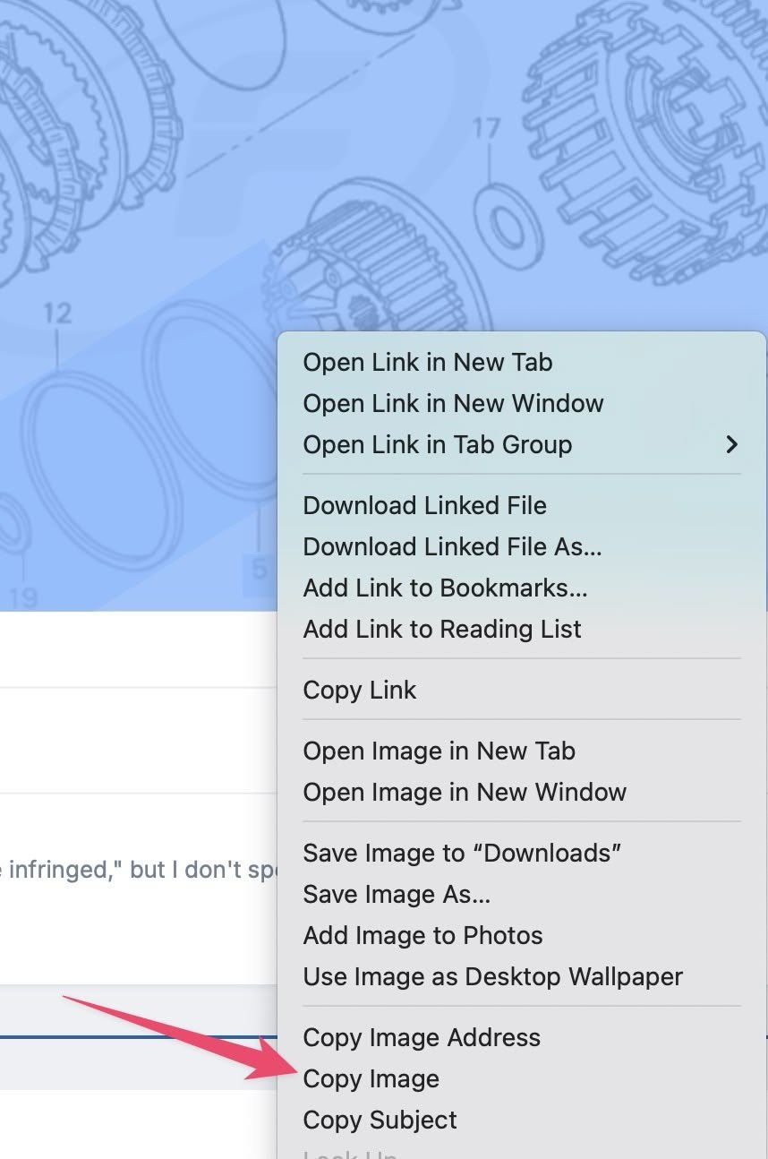

SwampNut Posted August 21, 2024 Posted August 21, 2024 You can't deep-link to that image. Here's a copy. Quote
SwampNut Posted August 21, 2024 Posted August 21, 2024 10 minutes ago, fizzy said: Thanks. What did I do wrong? Nothing that would be obvious if you don't work in tech and web services. You linked to the image, but the site has protection against that. They don't want you "stealing" the resource of serving embedded images. I did this... Then pasted the actual image here, not the link. So now it's served directly from our forum server, not the original link server. That part is curious. Some sort of plate separator? Quote
jon haney Posted August 21, 2024 Posted August 21, 2024 (edited) Fizzy, that is called a "anti-judder spring". It's supposed to make the clutch engagement smoother at higher RPM (hard launch). Stock Suzuki GS models (I think) had something similar. Unless you're wanting to drag race, should be able to live without it. My 99 did not want to launch over 3500 RPM without "grabbing and bucking" (Judder). I had Brock Davidson make me a prototype of his clutch cushion that he was selling for the Hayabusa. Worked like a charm. There is an old thread in here where I tried to do a group bye for these, because Brock wouldn't make more unless he got an order for 5 minimum. All but one member backed out, so it didn't happen. Edited August 21, 2024 by jon haney 2 1 Quote
fizzy Posted August 21, 2024 Author Posted August 21, 2024 16 minutes ago, SwampNut said: Nothing that would be obvious if you don't work in tech and web services. You linked to the image, but the site has protection against that. They don't want you "stealing" the resource of serving embedded images. I did this... Then pasted the actual image here, not the link. So now it's served directly from our forum server, not the original link server. That part is curious. Some sort of plate separator? I just edited original post, attempting to follow your suggestion. See result. Anyhow, thanks for the assist. Quote
fizzy Posted August 21, 2024 Author Posted August 21, 2024 5 hours ago, jon haney said: Fizzy, that is called a "anti-judder spring". It's supposed to make the clutch engagement smoother at higher RPM (hard launch). Stock Suzuki GS models (I think) had something similar. Unless you're wanting to drag race, should be able to live without it. My 99 did not want to launch over 3500 RPM without "grabbing and bucking" (Judder). I had Brock Davidson make me a prototype of his clutch cushion that he was selling for the Hayabusa. Worked like a charm. There is an old thread in here where I tried to do a group bye for these, because Brock wouldn't make more unless he got an order for 5 minimum. All but one member backed out, so it didn't happen. Ok, thanks for the info. Based on that, I am not going to worry about it being left off. I don't see drag racing in this machine's future. 🍺 Quote
