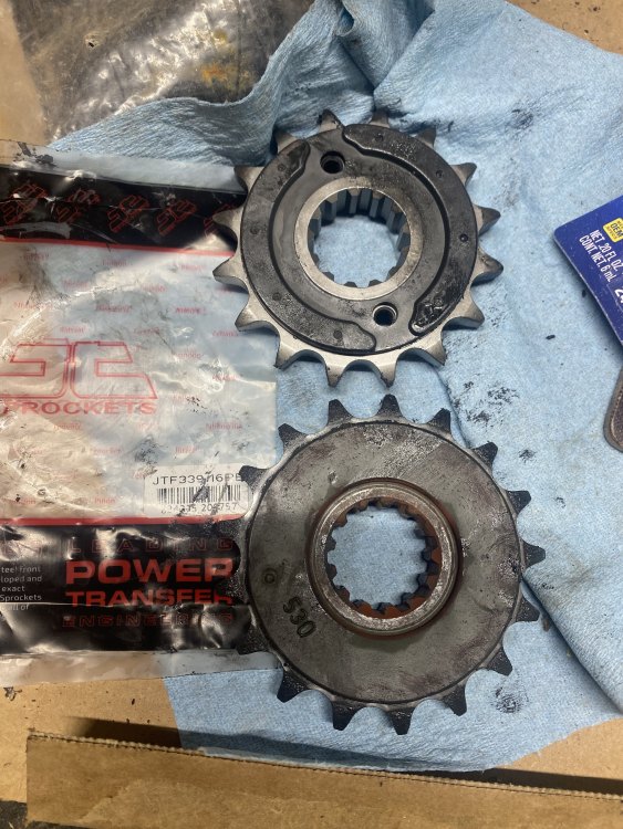

RXX Posted August 17, 2024 Posted August 17, 2024 So I got the new sprocket and am about to install it. I noticed there are 2 threaded holes in it. There are none on the original. I guess they are mounting bolts for some kind of sensors. I will assume it is safe to install as is? Quote
superhawk996 Posted August 17, 2024 Posted August 17, 2024 16 minutes ago, RXX said: So I got the new sprocket and am about to install it. I noticed there are 2 threaded holes in it. There are none on the original. I guess they are mounting bolts for some kind of sensors. I will assume it is safe to install as is? Missing sensors, perfect. Now you'll have lights on the bike to match your car. My guess is that they're for bikes that use a retainer plate instead of a shaft nut. Some Harleys use threaded holes for retainer bolts to keep the shaft nut from coming loose, I don't know if other brands do that. They look to be fairly different in design so make sure the off-set is the same, that's the only potential problem I'm seeing. 1 Quote
CALCXX Posted August 17, 2024 Posted August 17, 2024 The offset was my first thought also. I would slide the stock sprocket back on and measure from the sprocket to the case and do the same with the new sprocket. The old sprocket has a raised center. Quote
ironmike Posted August 17, 2024 Posted August 17, 2024 I remember aftermarket sprockets with similar threaded-holes designed/intended for the application of generic puller assemblies--no idea if that's the intention here. 1 Quote
