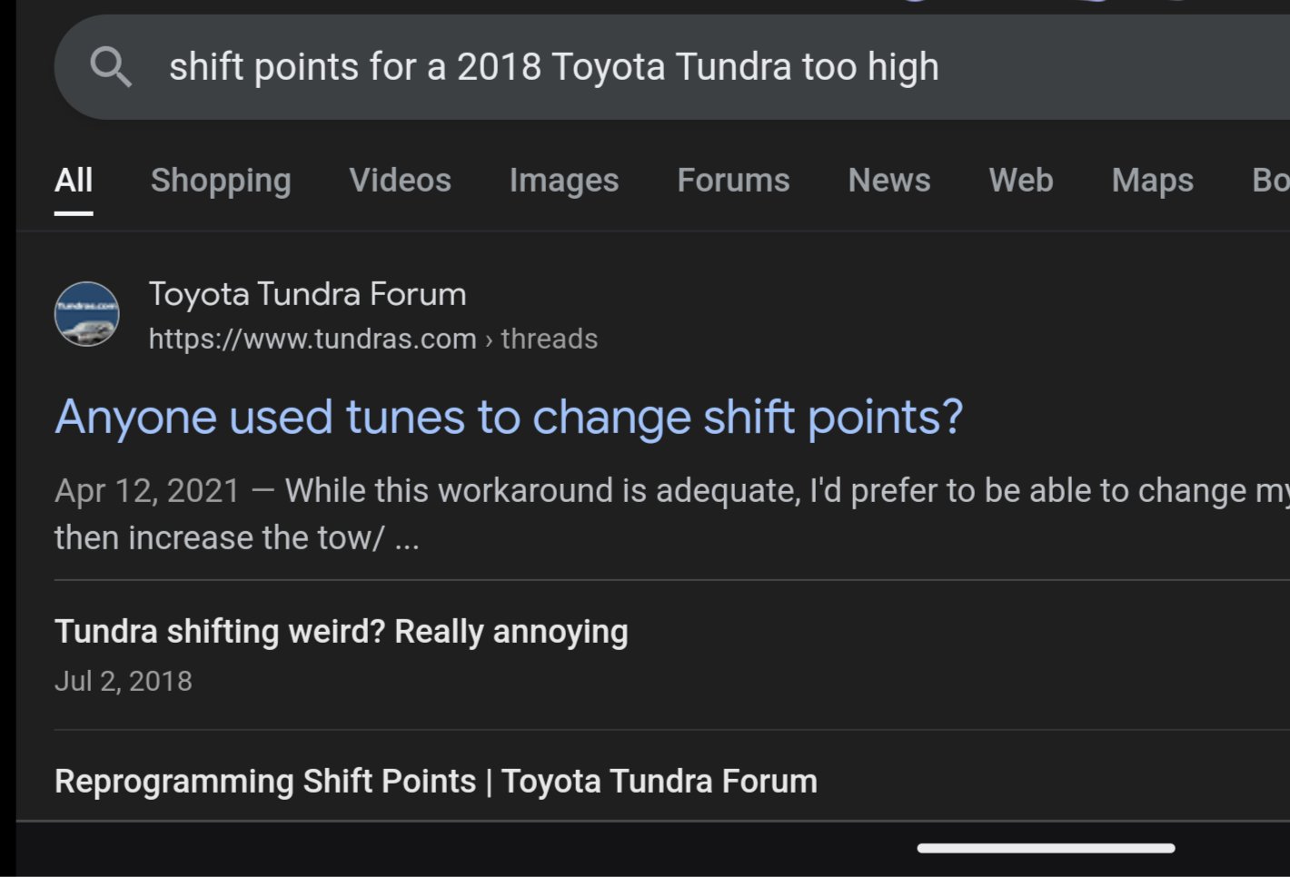

XXitanium Posted June 9, 2024 Posted June 9, 2024 My brother's 2018 V8 I browsed through a few Tacoma forums. Nobody said it eas a real problem, but quite a few of them were discussing it. Both of us think it is over-revving through shifts, especially in lower gears starting out. He says it isn't as bad once it warms up. My ear couldn't hear it There is a temp sensor - on the transmission I think? The forums were talking about mapping too. Quote
XXitanium Posted June 9, 2024 Author Posted June 9, 2024 I mean I could not hear the difference between cold and warm. I didn't state that very clearly. Quote
XXitanium Posted June 9, 2024 Author Posted June 9, 2024 We drove around in his truck for a few hours over the weekend, so I did hear what I thought was revving too high. Maybe it's a gearing thing? Quote
