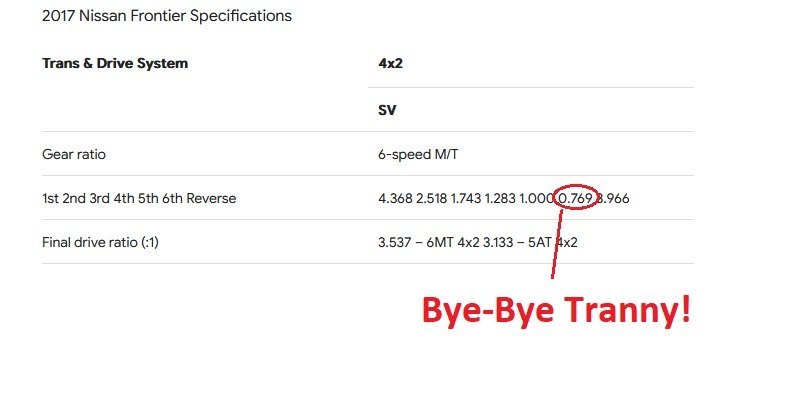

jon haney Posted June 9, 2024 Author Posted June 9, 2024 9 hours ago, Furbird said: Now that we have the Paul Harvey version... ... we have Titan parts in a Frontier AND a gear ratio change. (#sarcasm in case you can't pick up on that as a lot of people on here CAN'T SEEM TO DO!!!) I can't help you. Neither can any of my Nissan tech guys. They absolutely will not do anything aftermarket unless it's Stillen or Nismo stuff (plug-and-play). I installed cruise controls back in the late 90's/early 00's but that all tied in to factory VSS signals or we strapped magnets onto driveshafts. Factory cruise controls vary in how they operate, and when you change gear ratios, 6th gear could "believe" that the wheels are spinning because of driveshaft speed compared to wheel speed due to the variance because you changed the ratios. Or that you are skidding (wheel speed is too slow compared to driveshaft speed.) I'm not saying that is 100% how it works, but since you changed all that and that is when it started, that is what it sounds like to me. Driveshaft speed vs wheel speed has changed and the computers are shutting down the cruise control. Fifth gear may still be within some factory variance but sixth is outside of that and it's preventing it. I had a single ABS sensor go out on my old Charger patrol car and it took out my cruise control. So a single failure when you have 20+ computers in a car can cause all kinds of havoc. I'm sure somebody has done this in a Frontier forum and has an easy fix for this. Probably something stupid like "use sensors out of a Versa" or something out of left field. Then again you might be fucked and have to go with a stand-alone cruise control and wrap the driveshaft like it's 1985. BTW, why did you go with highway gears in a 4X4? LOL gas mileage, that's what Prius' are for 😂 Why? I don't off-road much, so I put smaller, sportier tires on, and now RPM towing in 5th is fairly high. On rare occasion (big tailwind), I can pull in 6th. Was trying to lower RPM a little in 5th. Better gas mileage not towing is additional benefit. Front axle has no electrics, and neither does the driveshaft. Not sure about trans. I'm sure it's the wheel speed sensor(s), but they are $100 each aftermarket, and there is right and left. Which ever I buy, it will be the wrong one. Was hoping for more insight before spending $200. Quote
tomek Posted June 9, 2024 Posted June 9, 2024 CC most likely does not know what gear you are, but in 6th, and only in 6th, sees axles spinning faster ( in relation to engine rpm) vs. what it should be with 3.69 gears, so it concludes speed signal is wrong and cuts off. Me thinks. Quote

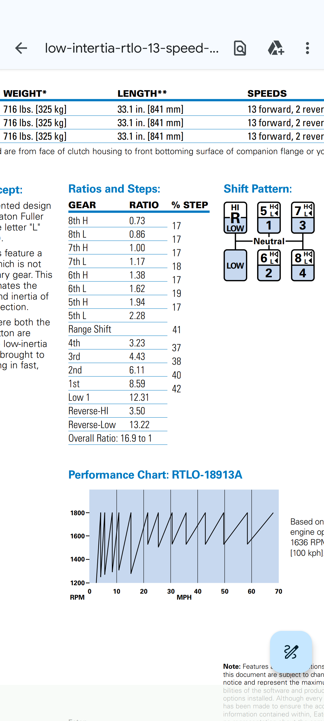

tomek Posted June 10, 2024 Posted June 10, 2024 (edited) 1 hour ago, Furbird said: Towing in overdrive is a BAD IDEA. Period. Regardless of vehicle. You should contact, in alphabetical order, Freightliner, International, Kenworth, Mack, Peterbilt, Volvo and Western Star ASAP. They are clueless idiots. Because, typically, top two ratios on their transmissions are overdrive. Top gear on 13 speed is double overdrive. Lol. 13 speed ratios. Edited June 10, 2024 by tomek Quote
Zero Knievel Posted June 10, 2024 Posted June 10, 2024 You do realize that tractor trailers are designed to do that, right? Consumer vehicles aren’t, and put any tractor trailer on an incline and see how much they need to downshift. OD gears are fine for level ground, downhill grades and minor elevations. 1 Quote
tomek Posted June 10, 2024 Posted June 10, 2024 (edited) 3 hours ago, Zero Knievel said: You do realize that tractor trailers are designed to do that, right? Consumer vehicles aren’t, and put any tractor trailer on an incline and see how much they need to downshift. OD gears are fine for level ground, downhill grades and minor elevations. You are an certified idiot. But please do share your tractor trailer experience with us. As for downshifts it depends. With 600 hp engine and relatively light load you can make Independence Pass in Colorado without downshifts, or maybe just one. But 12th or 17th gear (18 speed tranny) would still be overdrive. Edited June 10, 2024 by tomek Quote
