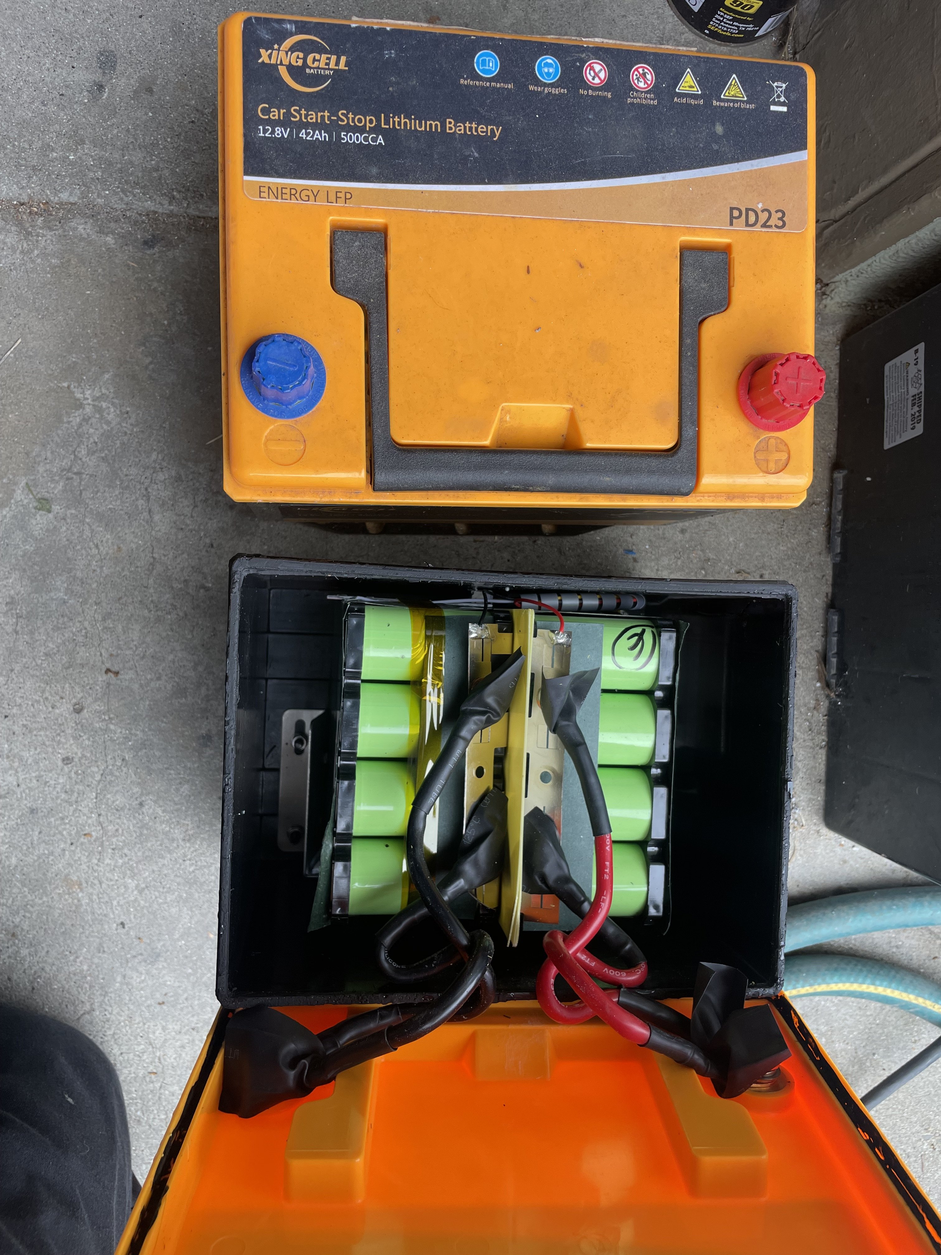

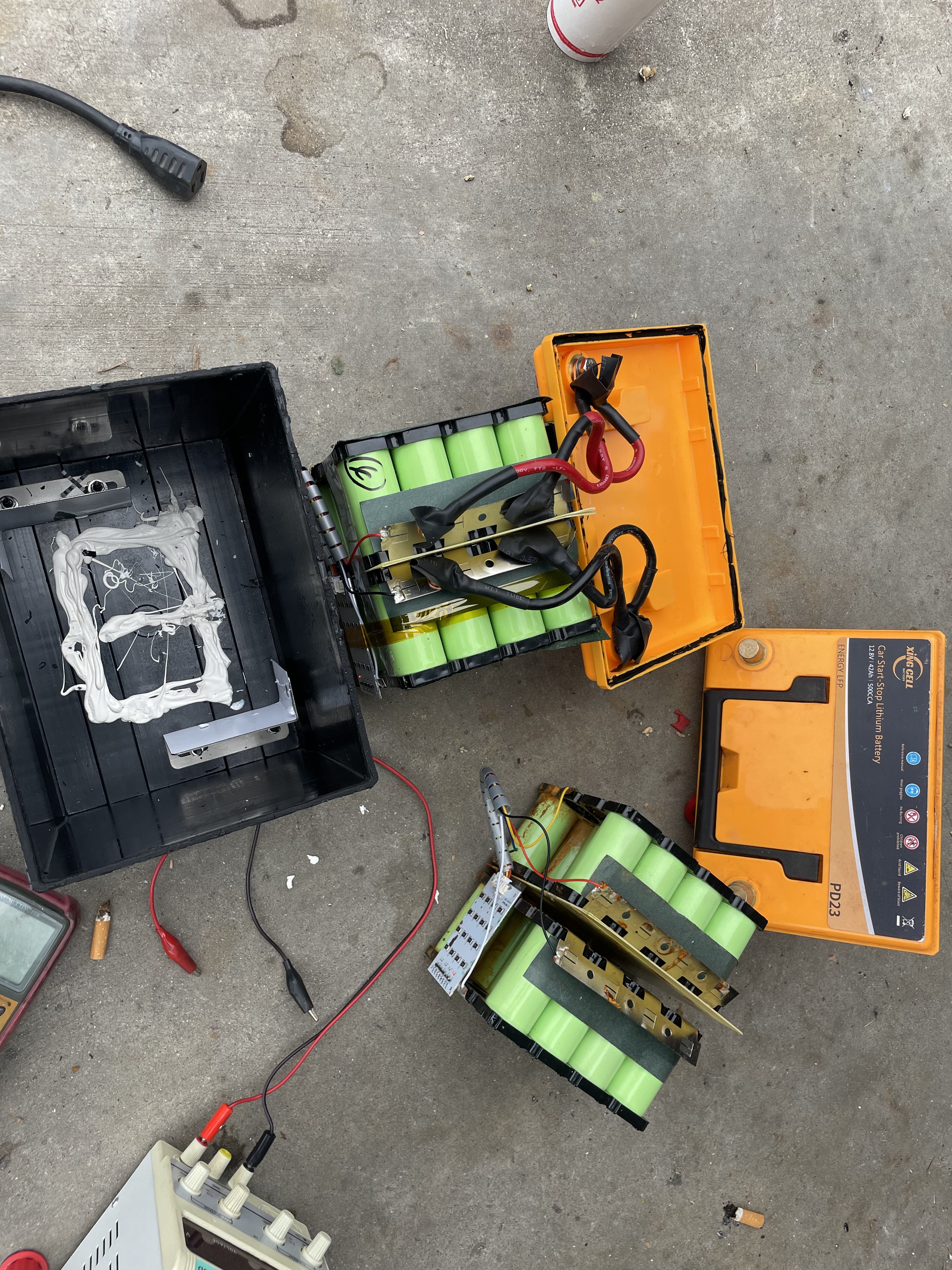

superhawk996 Posted May 29, 2024 Posted May 29, 2024 Photos of the internal beauty. 4 groups of 7 cells and a small circuit board. I don't know what the board is supposed to do, but it has tiny LEDs that I've seen light up red when a group of cells went way high or way low. Quote

xrated Posted May 29, 2024 Posted May 29, 2024 6 hours ago, superhawk996 said: I have a pair of Xing Cell brand car size batteries that my friend bought that I think are garbage. I don't know what the quality of the cells is, no markings on them makes me think generic crap. There's no BMS which scares me away from using them. On a 6a charger one group of cells went over 4 volts while another was around 3.2v. The 4+ was still rising when I killed the charger. Is this as dangerous as I think it is? Potential for fire, or just potential death of the cells? Is there a cheap BMS you would recommend for using them as starting batteries? The case is car sized, the bundle of cells inside is about the size of a Harley battery, maybe a bit smaller. They measure 500CCA on my simple tester and a little lower on my better tester which analyzes them with a load and with charging current. I tried them in a boat with a 3 liter 4 cylinder inboard and my 6 cyl. 3.2L. Porsche and they cranked about as expected for 500CCA. I later discovered the lack of a BMS, I'm glad I didn't leave either one in the vehicles for actual use. Not having a BMS for them would be a no go for me...Dead Stop! The group of cells that went to 4 volts is likely toast. If they are in fact LFP chemistry, they are "safer" than Li-ION battery as far as fire/explosion but I'd never try to use them without a BMS. The DALY brand BMS that I bought is one of the cheaper ones out there and IIRC, the 200A Smart version that I bought (smart meaning BlueTooth equipped to communicate with the DALY app.) was still over $100. You would obviously need something much larger for a BMS for starting a car/truck. If the battery was "newish" it might be worth buying a BMS for it, but considering it is not, plus you know that at least one set of cells has been WAY overstressed with 4+ volts, I don't think I'd be doing it. And the small internal printed circuit board could possible be a balancer board....but that is just a wild ass guess on my part. Quote
superhawk996 Posted May 30, 2024 Posted May 30, 2024 5 hours ago, xrated said: And the small internal printed circuit board could possible be a balancer board....but that is just a wild ass guess on my part. Maybe. When I opened the second battery the 4 groups of cells were nearly perfectly balanced as far as resting voltage, but as soon as I started charging one group of cells went way higher than the others, I stopped and didn't do any more investigating. It sounds like the smart thing is to drop these in the trash can and forget they existed.....which means I have to test/torture them to learn more first. Quote
xrated Posted May 30, 2024 Posted May 30, 2024 8 hours ago, superhawk996 said: Maybe. When I opened the second battery the 4 groups of cells were nearly perfectly balanced as far as resting voltage, but as soon as I started charging one group of cells went way higher than the others, I stopped and didn't do any more investigating. It sounds like the smart thing is to drop these in the trash can and forget they existed.....which means I have to test/torture them to learn more first. LOL........"test/torture" comment. Have fun testing/learning. I remember back when I did the initial, and so far the only top balance on my cells after I built them and can remember thinking......this is the true test of the "quality" of my build, the cells, and all my newly made connections. With a bit of tweaking, my final top balance resulted in in three of the four cells hitting the 3.65 and the other hitting 3.64. After pulling the balance charger off of the battery and letting it rest, all four cells were the exact same voltage. Even today, two plus years later, after a full charge on the battery (I use 14.2 volts as the max, not 14.6) I will see them settle down and usually end up with .002 volts to maybe .003 volts differential between the highest cell and the lowest cell reading. That number is perfectly acceptable and personally I would not get too concerned unless the differential voltage gets somewhere north of .050 volts while they are charging, and/or doesn't drop down to .010 volts after resting. Like I stated above, mine usually hit the .002 to .003 volts after a charge and then a resting period. I usually check that out after about 4 hours of resting after a charge. Quote

superhawk996 Posted May 31, 2024 Posted May 31, 2024 15 hours ago, xrated said: Any LFP battery worth it's weight in salt would have a BMS AND a low voltage cutoff as part of that same BMS. LFP lower cutoff should never allow a cell to go below 2.5V or 10 volts for the battery. They are recoverable at that point, but if for some reason the BMS's LV cutoff failed to stop the LV, it's almost certain the cell(s) would be ruined. And the opposite of that is the High Voltage cutoff. It should stop any cell to not go over the 3.65 volt level or 14.6 volts for the battery. The NOCO I had in the Harley definitely had a low cut-off, and it seemed to be very conservative, but I didn't have a voltmeter on it when it cut. The Battery Tender brand I've had in the Birds either doesn't have a low cut or it's low enough that the battery is obviously low before it cuts. Quote
