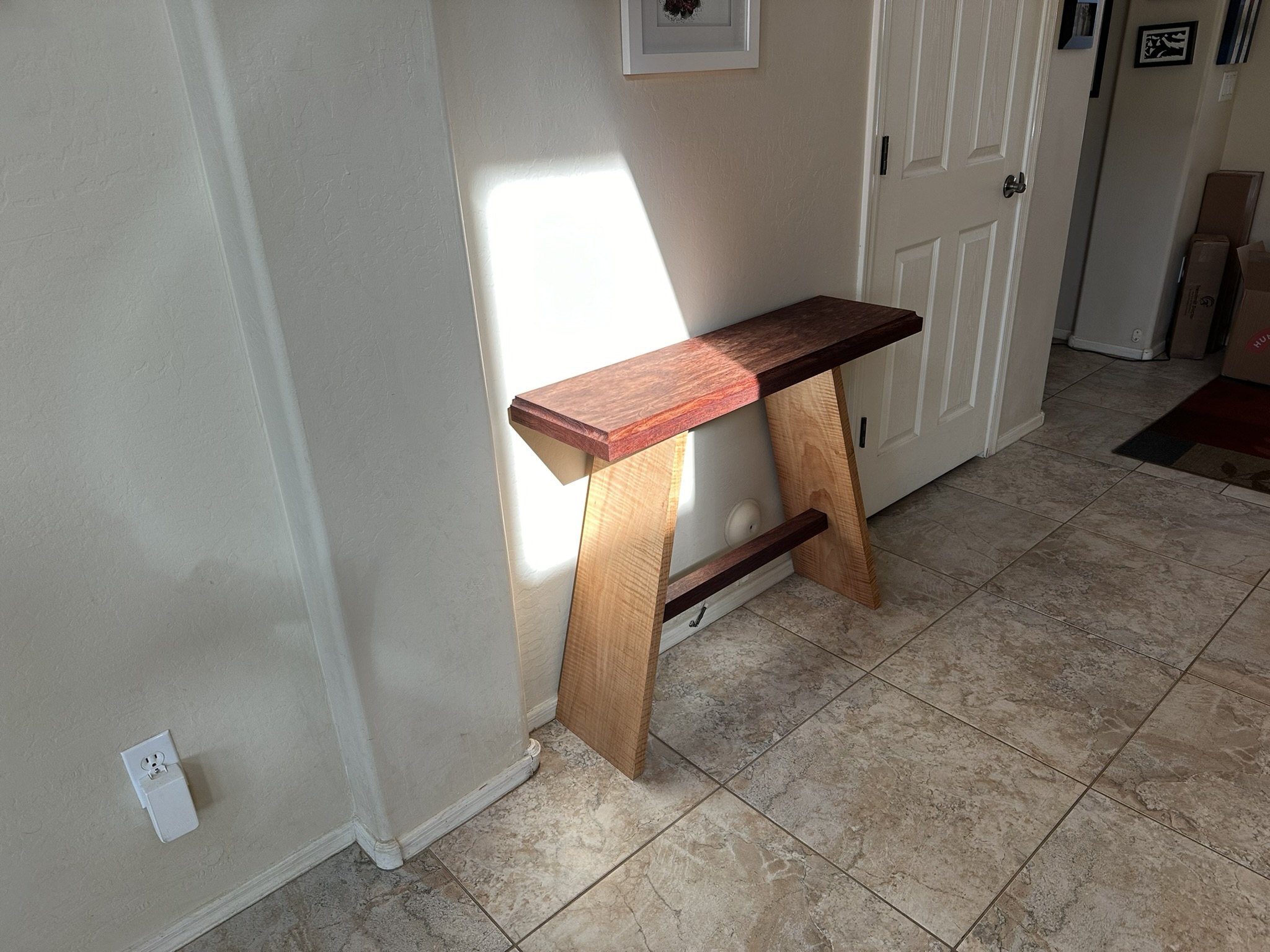

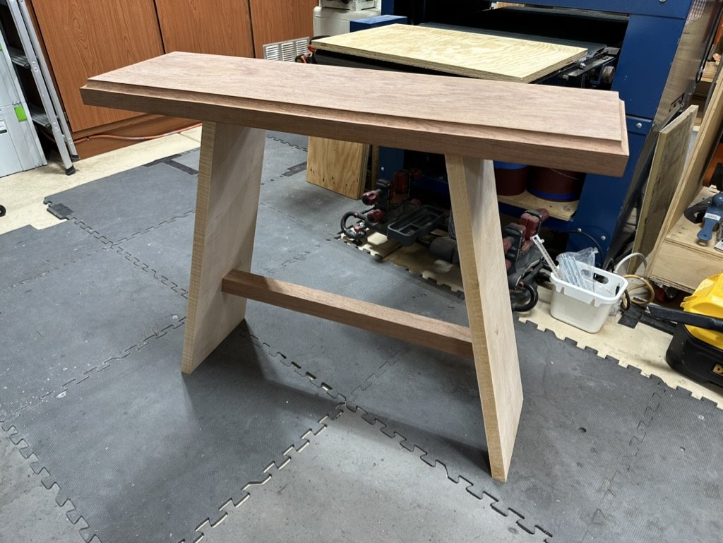

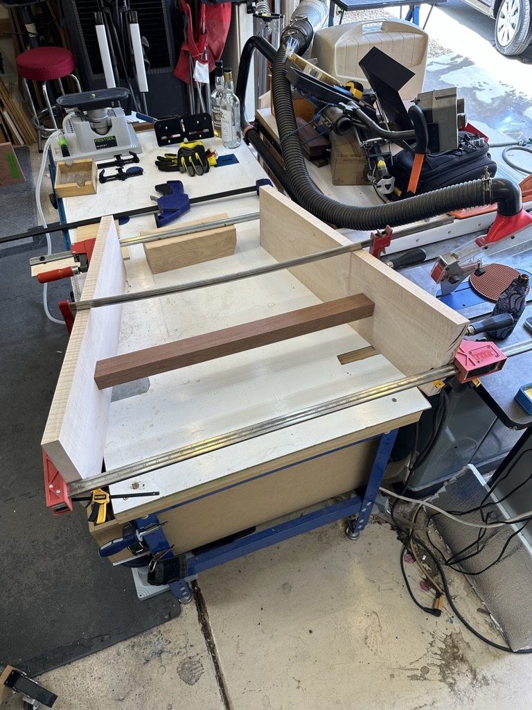

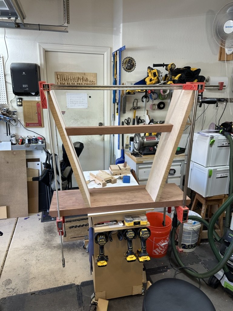

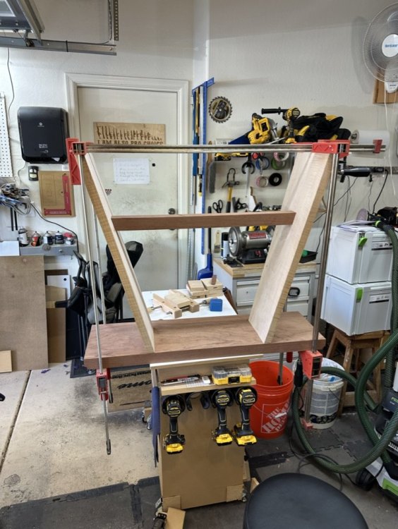

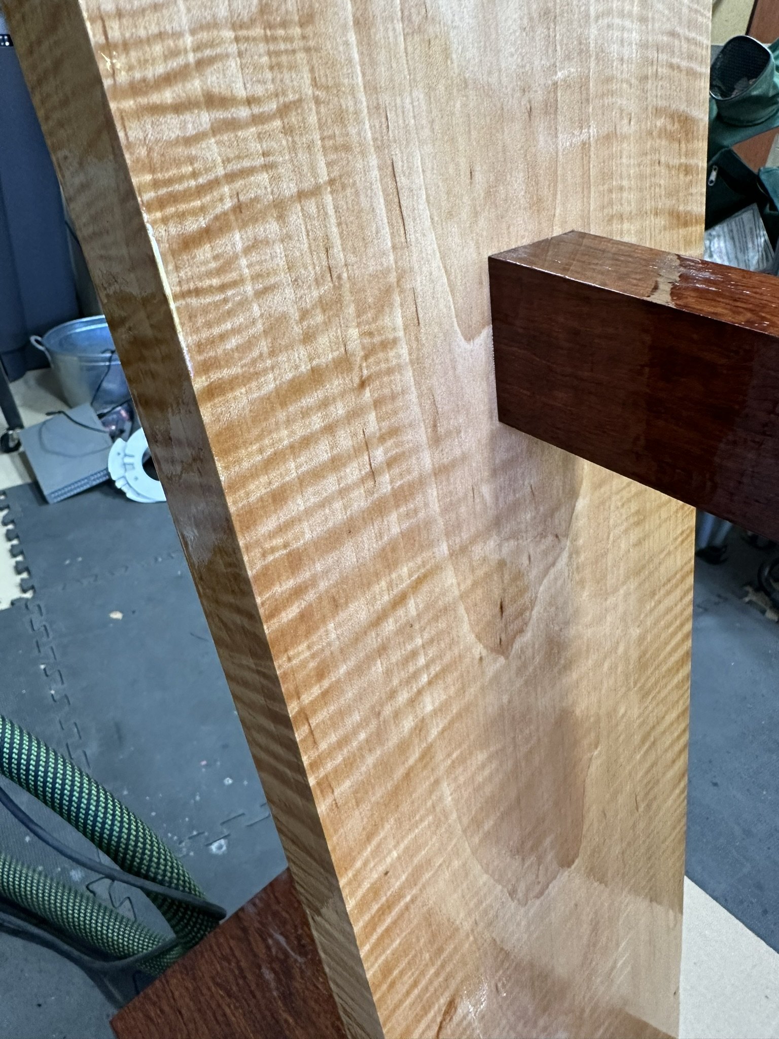

Flame/tiger maple and bubinga.  First I milled it rough, and it warped and did all the shit that wood does on its own.  Then I finish machined it, and it rained for a week.  And it re-warped.  So I let it dry for a long time, and it spent some time clamped flat.  Machined again.  Then I couldn't really work out the joinery plan for the odd angles, so it waited around until I got a killer joinery tool (Festool Domino).  Glued it up, and have been letting it sit while it's just too fucking hot out.  Decided I really need to start on the finishing, since the oil will take weeks to cure before I can spray lacquer over it.  Which will need to be done when it cools off some or it will just flash in the air while being sprayed.  But this way I can do a few oil coats over a long time which is always better.

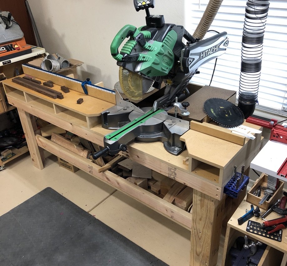

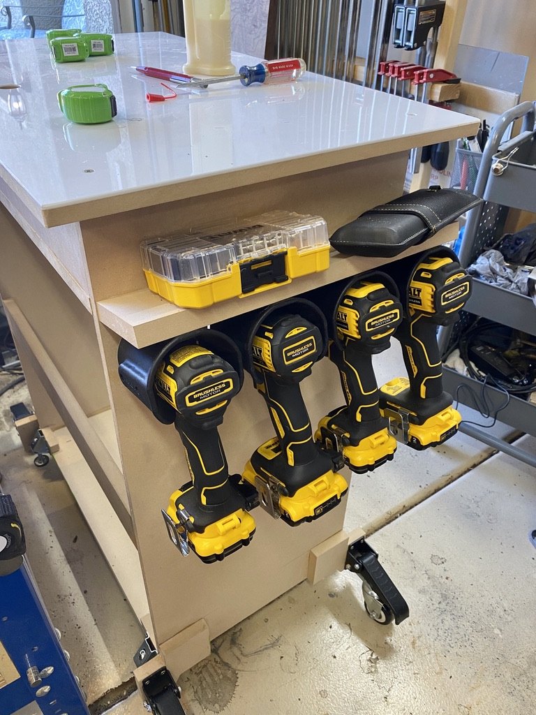

MDF is everyone's favorite jig material because of the steadiness.  My huge miter station is made of it and no matter what, dry or monsoon, it's dead flat forever.  Same with my workbench.  It's not pretty, and woodworkers take pride in making beautiful hardwood worktables.  Fuck that.  Cheap and stays flat is my choice.
MDF everywhere.

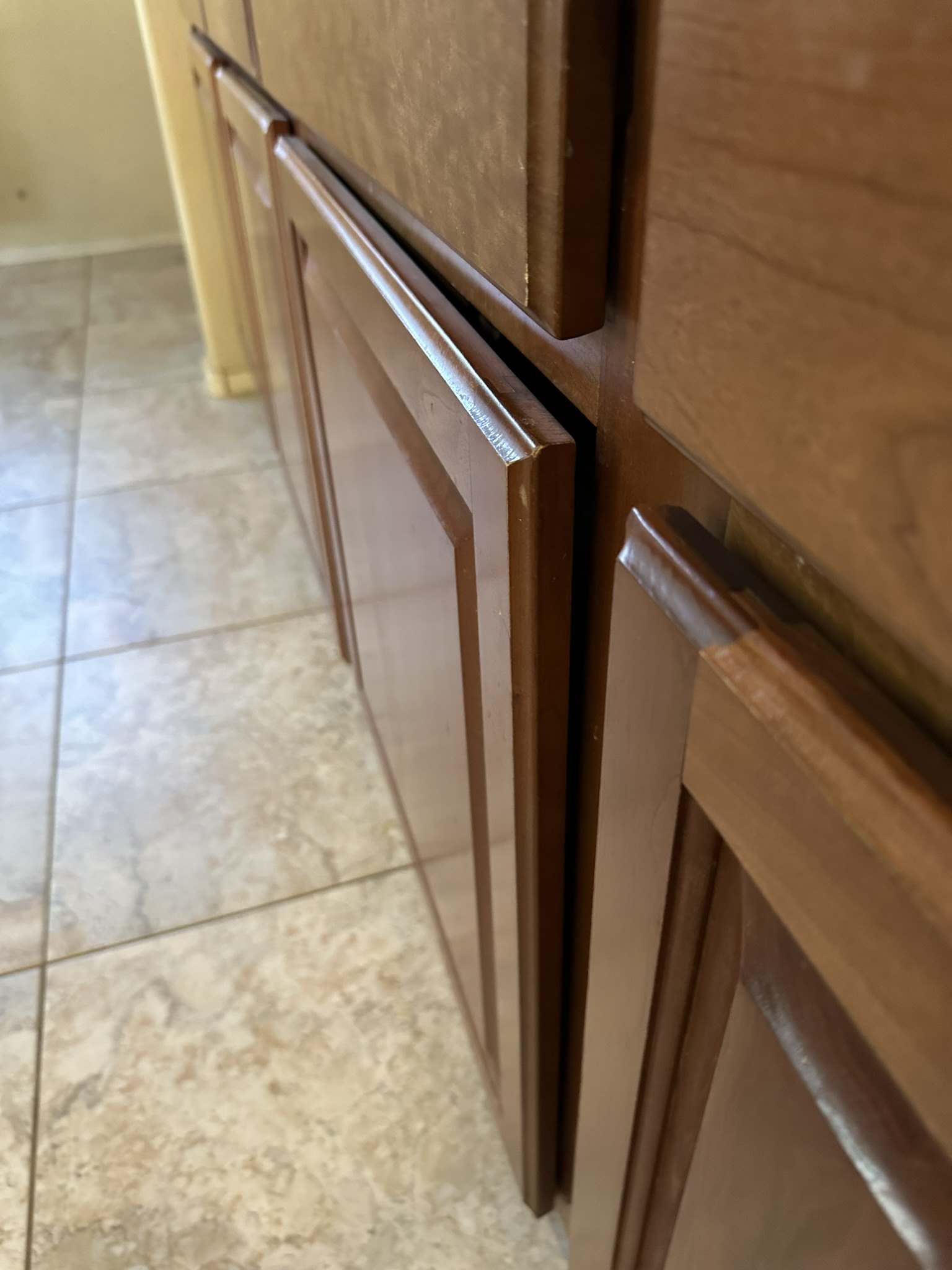

And not to beat up the point even more, but, I have several kitchen cabinet doors that are no longer flat.  They've always been inside.  I have several spare doors in the garage, and they are flat.  You never know.  And that's just some basic cheapass oak shit.

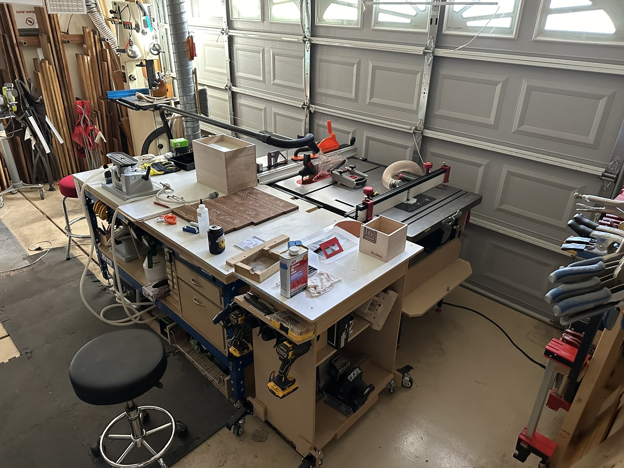

 The table saw is unusable with the door closed.  The bandsaw is only usable for small pieces if it's closed.
Because of room?
I don't experience any of these issues.  MDF and particle board will swell here if you're not careful.  You put that in a car (aka car stereo, which I did for nearly a decade) and let that thing sit with the windows down around here for just ONE NIGHT.  That box will swell up and if it was a tight fit between the fender wells, it'll bend sheet metal.  Particle board is far more susceptible to humidity than that, and certainly so to straight up wetness.  I've got wood out in the garage that I've cut that's been sitting for years standing on the end grain and never warped, cracked, split, or had any of the issues you are talking about of various species, thickness, and length... but it's all because it's humidity controlled.
Dust control is completely separate issue, and I understand you have a system in place for that, which I don't.  However, the relative humidity is high enough that it's really not that bad to begin with here so that may be the difference.  However, staining in uncontrolled humidity is also a recipe for failure as well, and someone as experienced as you should know not to leave unprotected wood in a non-controlled environment if you are in the process of working with it.  At least that's the way I was always told.

That's really cool, I dig the angles and mixture of woods.
If it rains tomorrow, will it just warp a bit or explode? 🤣

Right, imagine how much shop I'd lose to be able to put a board through this with the door closed.  The rest of the tools are already organized to "nest" their in-feed and outfeed for space.  If I had to walk between the door and TS with even just a 4' board, I'd lose the workbench plus walkway behind it.  And the work table doubles as the outfield for it, plus that little side rolling cart is a feed table when in the low/lock position.  The BS has maybe 2' of outfeed at most with the door closed.

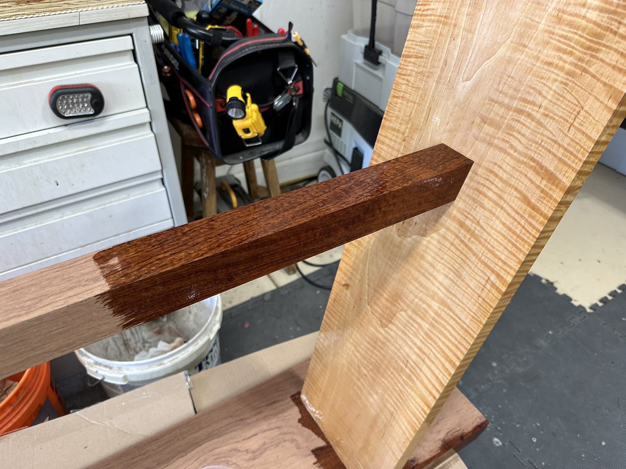

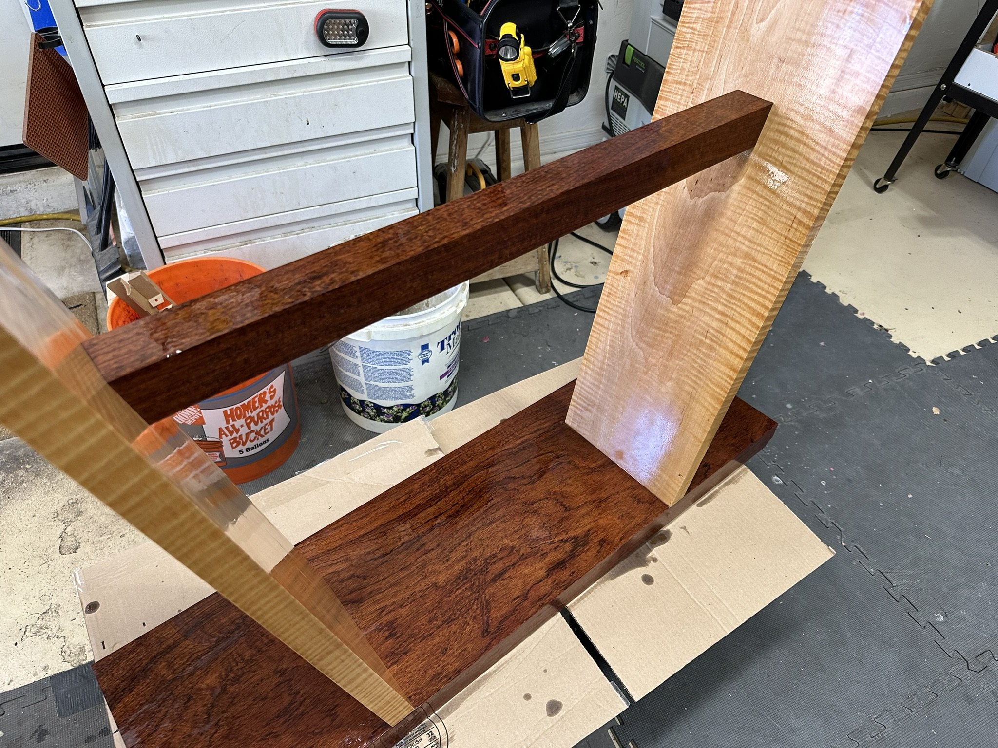

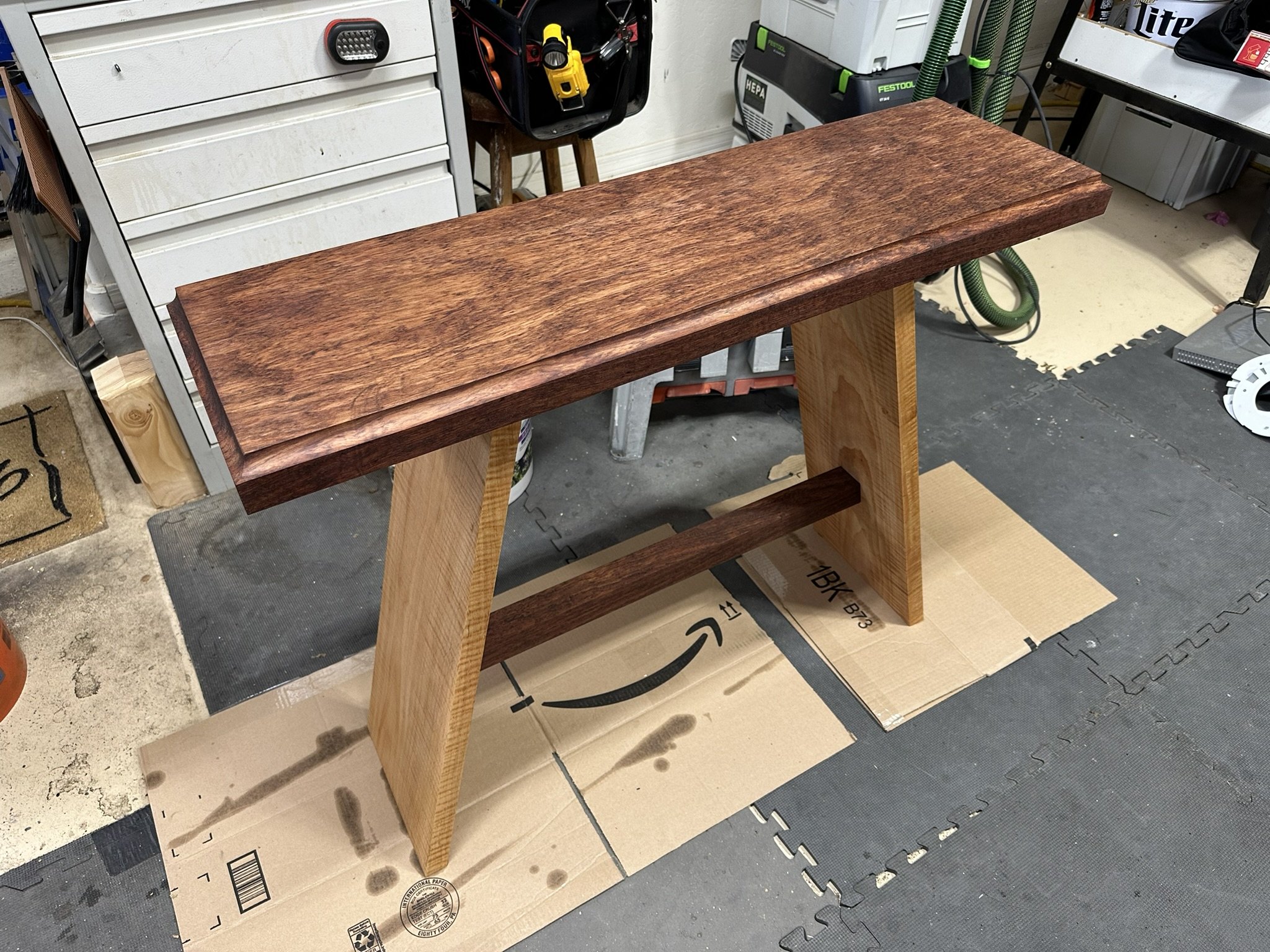

LOL, it has survived unfinished and assembled through some rains.  I like to have it out after assembly unprotected for a while to let it once again settle in, and it's been as solid as...metal....
The oil darkened it way more than expected, we'll see how it looks in the long run.  The other bubinga/maple pieces have only lacquer, which has much less darkening, at least up front.  Now to apply patience, and have an annoying half-done thing in the shop that's always in the way.

Again, the top thing I see is simply internal stress.  And pretty much all woodworkers agree on that.  The flame/tiger maple legs on that bench have been in this shop since 2011, and in the previous shop for a couple years before that.  Cut them, and...they twist.
I just realized something idiotic.  I had meant this to be against a wall, in our entry hallway.  But didn't account for baseboards.  Duh.  Sigh.

This door has been in a controlled environment for 17 years.

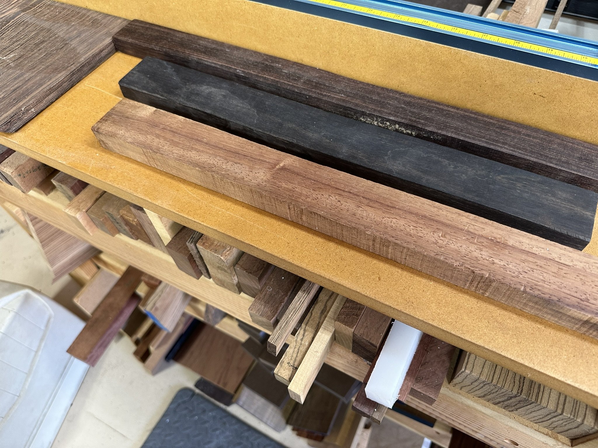

These and many others came from Arkansas, where they were stored semi outdoors (shed), and have been stored in AZ in a garage.  No issues.

A very nice but simple design, looks good.  Two questions, how are the legs attached to the top and with the top touching the wall, with use aren't you afraid it will rub the paint?
The problem is that it's NOT touching the wall, because of the baseboards.  I want it to be.  How would a table rub the paint, and why would I care?  I guess the answer is no.  Never considered it.  I consider wall paint to be an expendable wear item and I touch it up regularly.
I'd rather have it not touch the wall to save the finish on the table.  If it gets a little wear on the bottom edges of the legs, that's OK; that's not nearly as noticeable if it were ever moved.
It can't go anywhere other than against a wall or something else, it would look retarded.  The legs are flush and straight on the back, angled and inset front.  It will go against the wall, I just need to decide exactly how.  Cut the baseboard...cut the legs around the baseboard...dunno.
You guys sound like Dave and modifying cars.  I'd rather have everything be perfect and deal with the consequences than worry about some potential minor issue.

Also, your bench looks really nice and the tiger maple legs are the tits.
