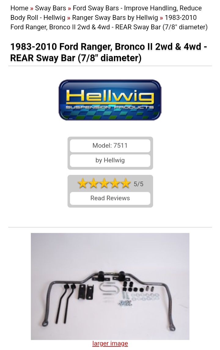

XXitanium Posted December 4, 2022 Share Posted December 4, 2022 ...xonsider? https://www.sdtrucksprings.com/index.php?main_page=product_info&products_id=5774&zenid=d95f939d486db1823aa69d31de5cd4b3 Quote Link to comment Share on other sites More sharing options...
Zero Knievel Posted December 4, 2022 Author Share Posted December 4, 2022 I’m only using the truck to haul stuff. I’ve noticed a fair bit of sag as of late when loaded. 1 Quote Link to comment Share on other sites More sharing options...
superhawk996 Posted December 5, 2022 Share Posted December 5, 2022 20 hours ago, XXitanium said: ...xonsider? https://www.sdtrucksprings.com/index.php?main_page=product_info&products_id=5774&zenid=d95f939d486db1823aa69d31de5cd4b3 Adding a rear sway bar willy nilly, especially to a pickup, is dangerous. Quote Link to comment Share on other sites More sharing options...
blackhawkxx Posted December 5, 2022 Share Posted December 5, 2022 4 hours ago, superhawk996 said: Adding a rear sway bar willy nilly, especially to a pickup, is dangerous. Zero does nothing willy nilly. 😉 Quote Link to comment Share on other sites More sharing options...
XXitanium Posted December 5, 2022 Share Posted December 5, 2022 OK Google.... "Why is adding a rear sway-barto a truck dangerous?" https://bobistheoilguy.com/forums/threads/why-dont-pickup-trucks-have-rear-swaybars.238360/page-2 ...well, that didn't give me one clear concise answer.... Quote Link to comment Share on other sites More sharing options...
superhawk996 Posted December 5, 2022 Share Posted December 5, 2022 5 hours ago, blackhawkxx said: Zero does nothing willy nilly. 😉 Not in the traditional sense because he'll over analyze the fuck out of it, but the final decision is often no better than a willy nilly shot in the dark. 1 Quote Link to comment Share on other sites More sharing options...
superhawk996 Posted December 5, 2022 Share Posted December 5, 2022 5 hours ago, XXitanium said: OK Google.... "Why is adding a rear sway-barto a truck dangerous?" https://bobistheoilguy.com/forums/threads/why-dont-pickup-trucks-have-rear-swaybars.238360/page-2 ...well, that didn't give me one clear concise answer.... The best way I can think to describe it: Lets assume you have a car/truck with perfect handling. If you add a sway bar to the front it will increase the tendency to understeer, meaning that when you hit the traction limit in a curve the front of the car will try to go straight. This is pretty easy to control. If you add it to the rear it'll wanna oversteer, back end sliding out in a turn, much harder to control. Cars are generally set up to understeer because it's safer. Pickups generally have a tendency to oversteer from the factory and the rear bar will increase that. Quote Link to comment Share on other sites More sharing options...
XXitanium Posted December 5, 2022 Share Posted December 5, 2022 Yeah, OK like my old Mustang with air-shocks, I lived it. Not good. Quote Link to comment Share on other sites More sharing options...
