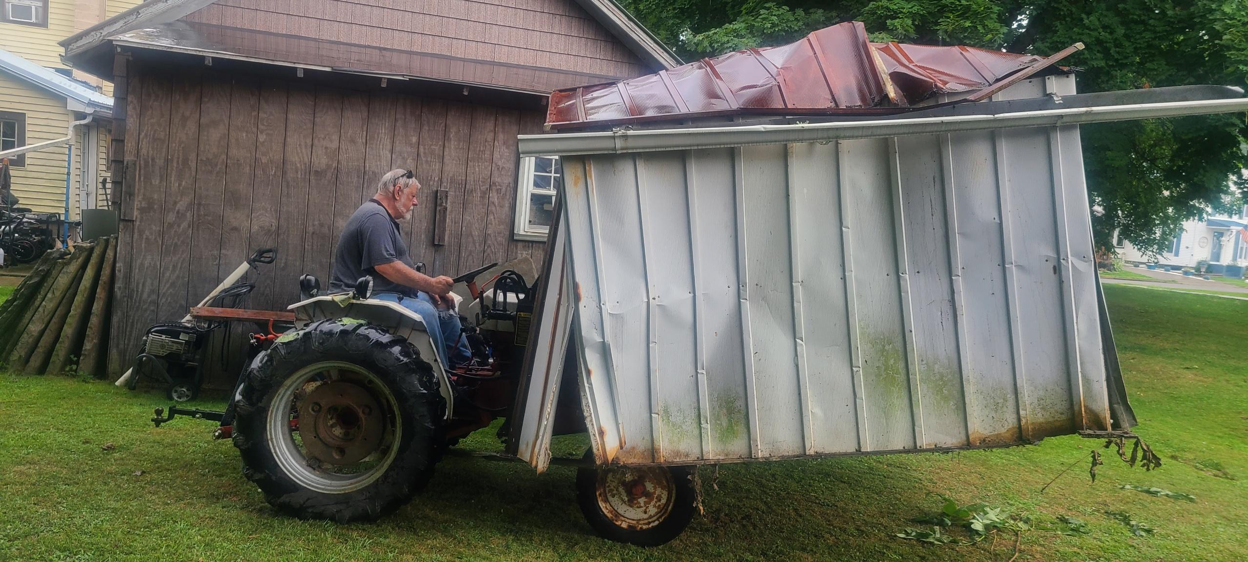

blackhawkxx Posted July 29, 2022 Posted July 29, 2022 What did you do with it, mash it up and recycle or set it out by the road for someone to steal? Quote
