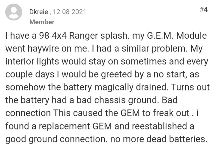

XXitanium Posted July 1, 2022 Posted July 1, 2022 General Electrical Module? https://www.ranger-forums.com/general-technical-electrical-18/electrical-problem-1998-ranger-3-0-a-167462/ My wife and I replaced ours a few years ago. We saved hundreds of dollars, but it took a good deal of time. Quote

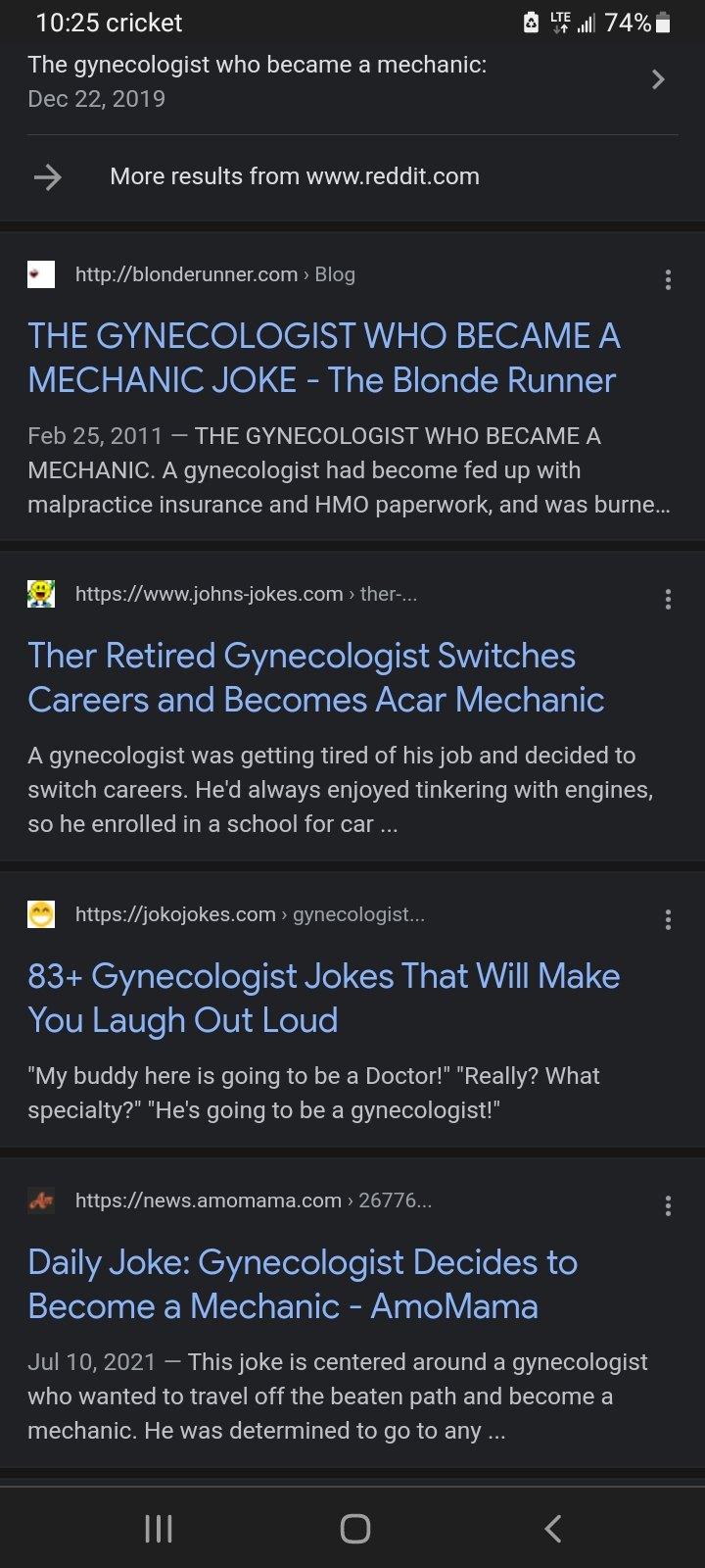

XXitanium Posted July 3, 2022 Posted July 3, 2022 http://blonderunner.com/2011/02/the-gynecologist-who-became-a-mechanic-joke/ Quote
SwampNut Posted July 3, 2022 Posted July 3, 2022 Gynecologist becomes a boat mechanic. Did it all through the outdrive. Quote
