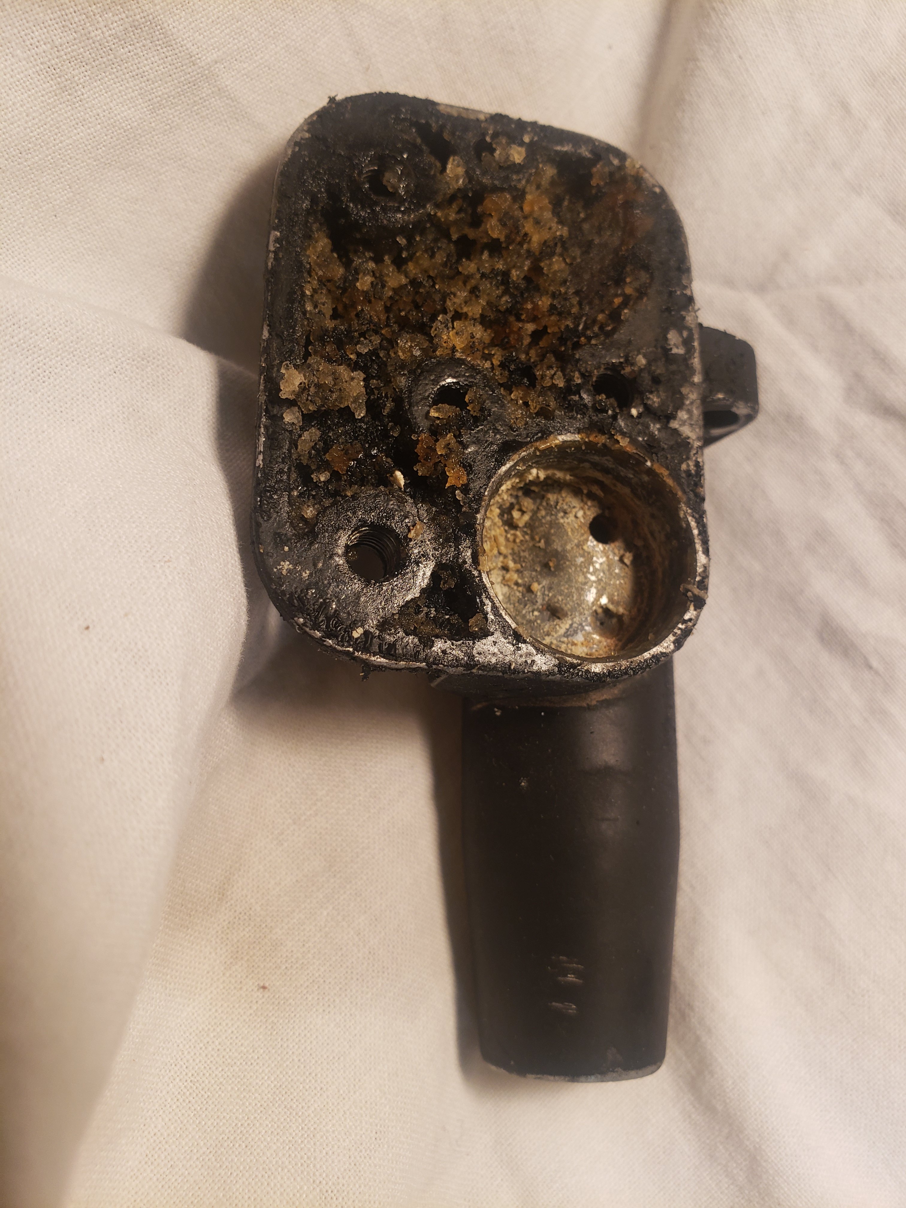

The front twin calipers lock up, it takes time so it's a gradual thing. When they do lock the only way to move the bike is to open both bleeds.
When I do that it's good for a few times using the brake, then it locks again.
Where is the problem?

Most likely front master cylinder. Both brake calipers would no go kaput at exactly same time.
 There is really, really small fluid pressure relief hole at the bottom of reservoir. There is one more, much bigger feed hole. 5 bucks says relief hole is clogged.
What happens fluid can't return freely to master cylinder, brakes drag, heat builds up, fluid expands, pressure builds up, brakes lock, etc.
Anyway, that would be my first line of attack.

All good advice.

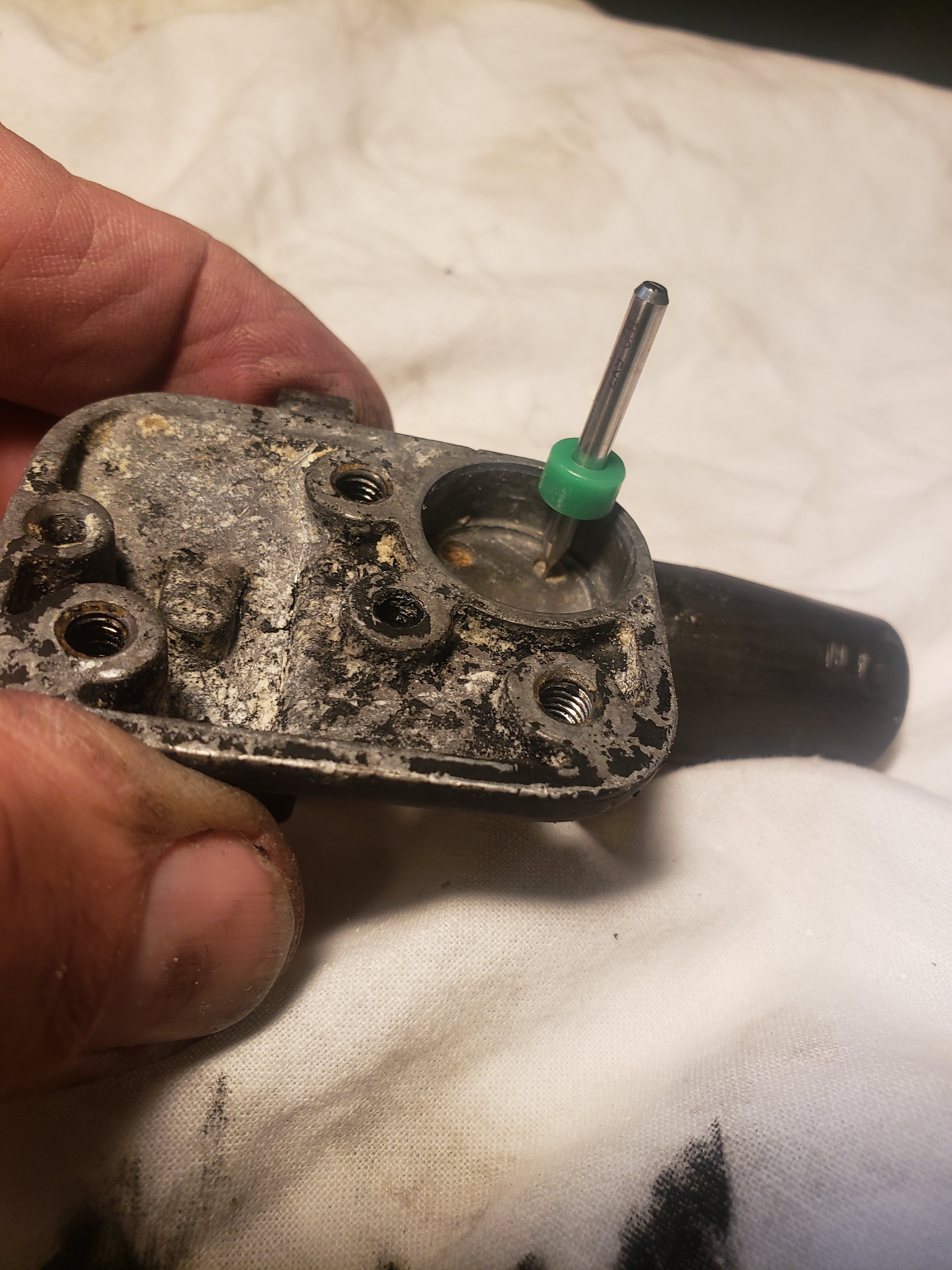

The Master is the culprit.
So corroded the return bleed needed to drilled out so, tomek is spot on.
Makes the case for regular maintenance.
