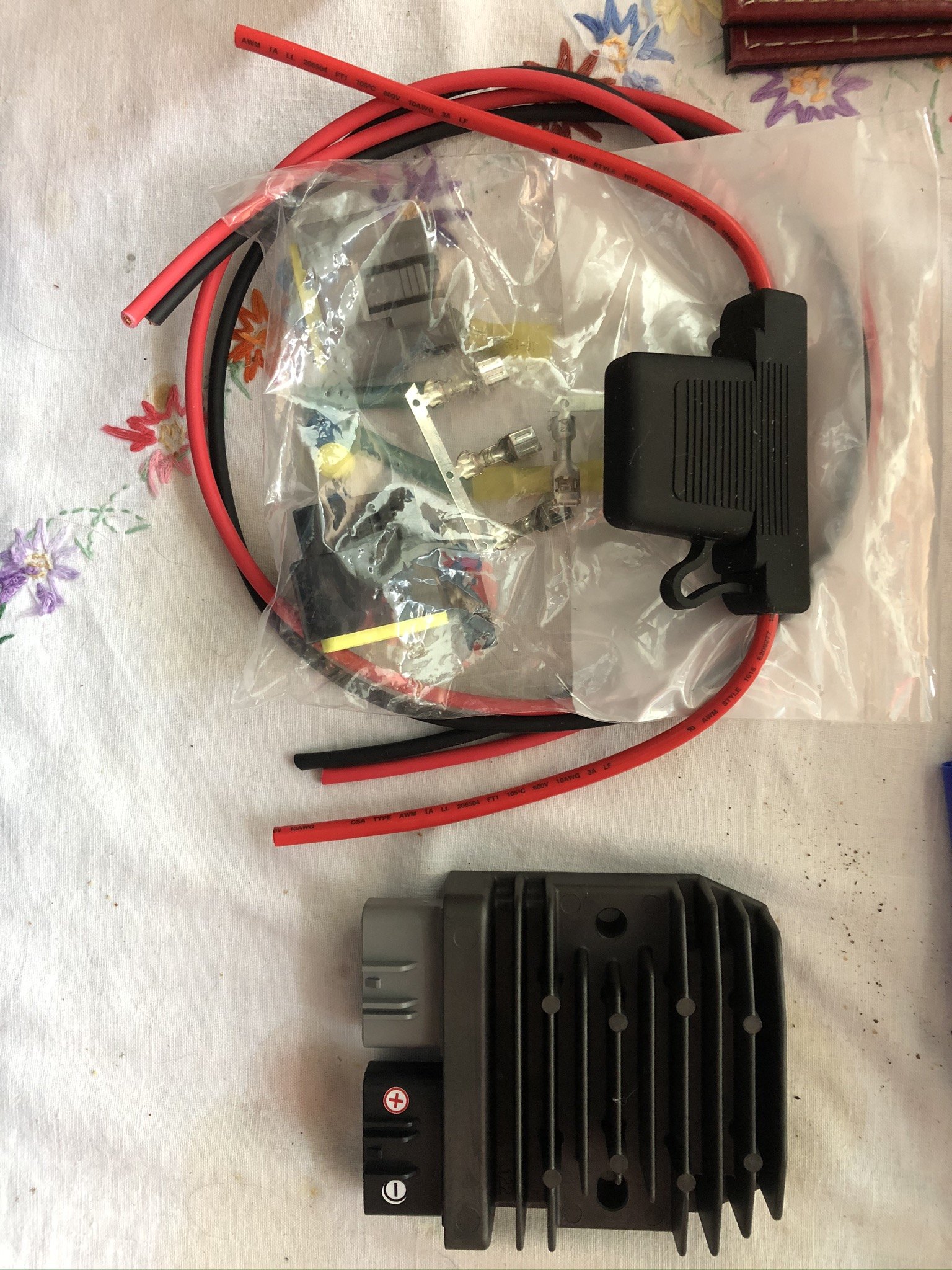

So apart from brake disks, the last big purchase of the project has now arrived...

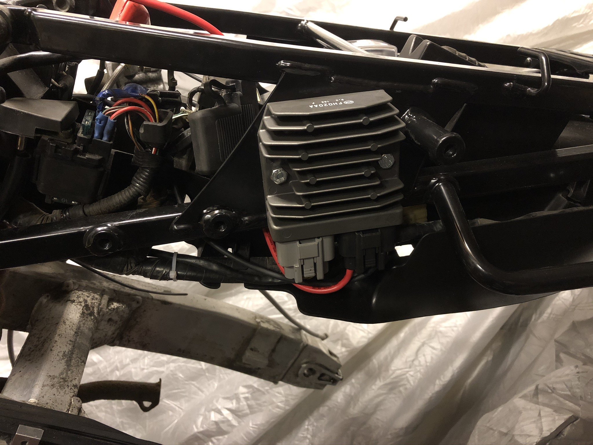

That ladies and gents, is the shindengen mosfet reg rec.  Coupled with the shiny new electrosport stator, it should keep me free of major electrical gremlins for some time.

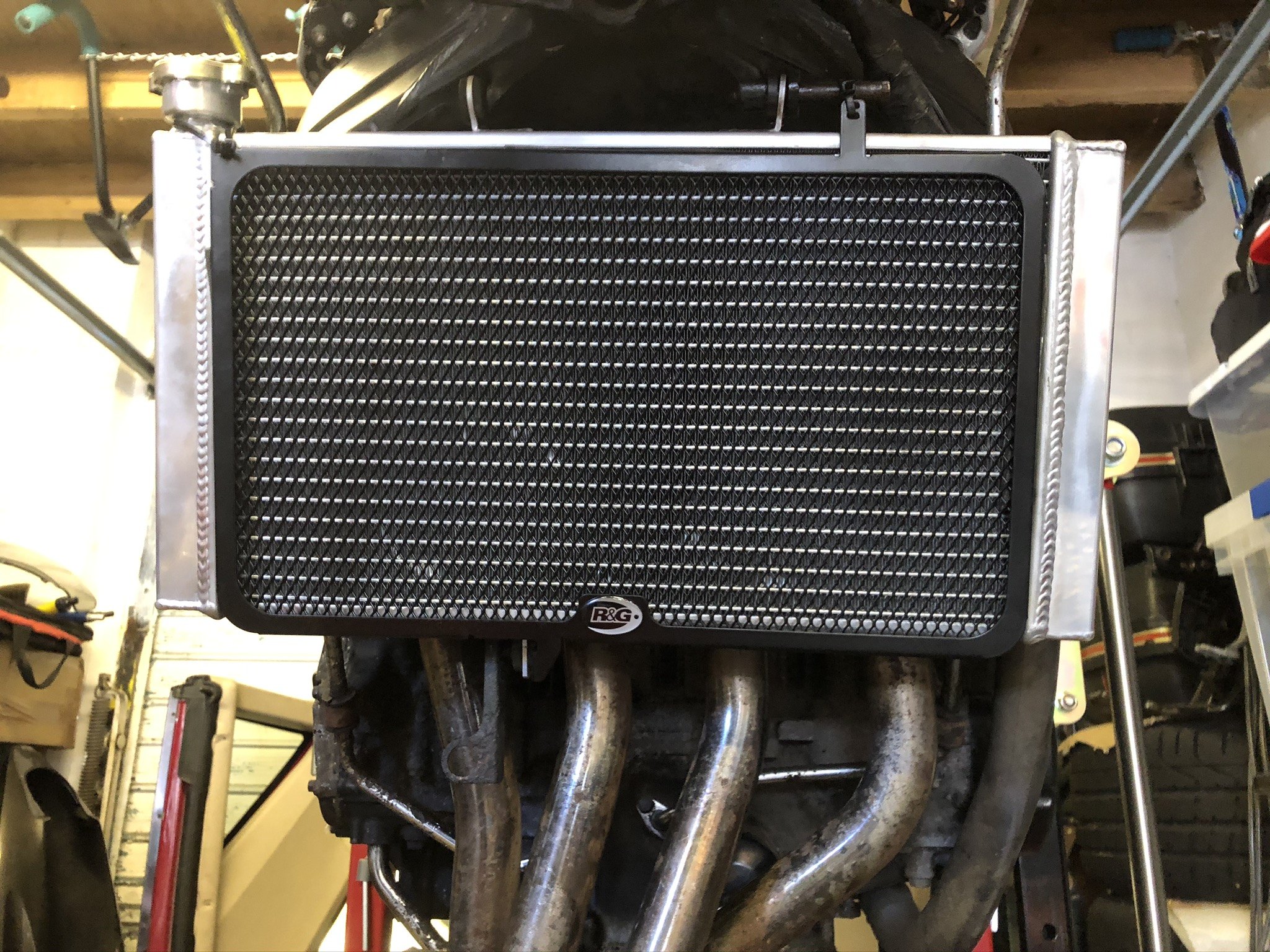

So I got some time on the bird this weekend, finally removed the exhaust so I could drill out the snapped bolt for the lower radiator bracket.  Once that was done, many hours, I ended up using a helicoil to rethread.  Have mounted the new 2 row radiator and the new R&G guard which doesn't sit quite right on this radiator.  I think it's OK though :).
They look great to me and your SL isn't too shabby either.

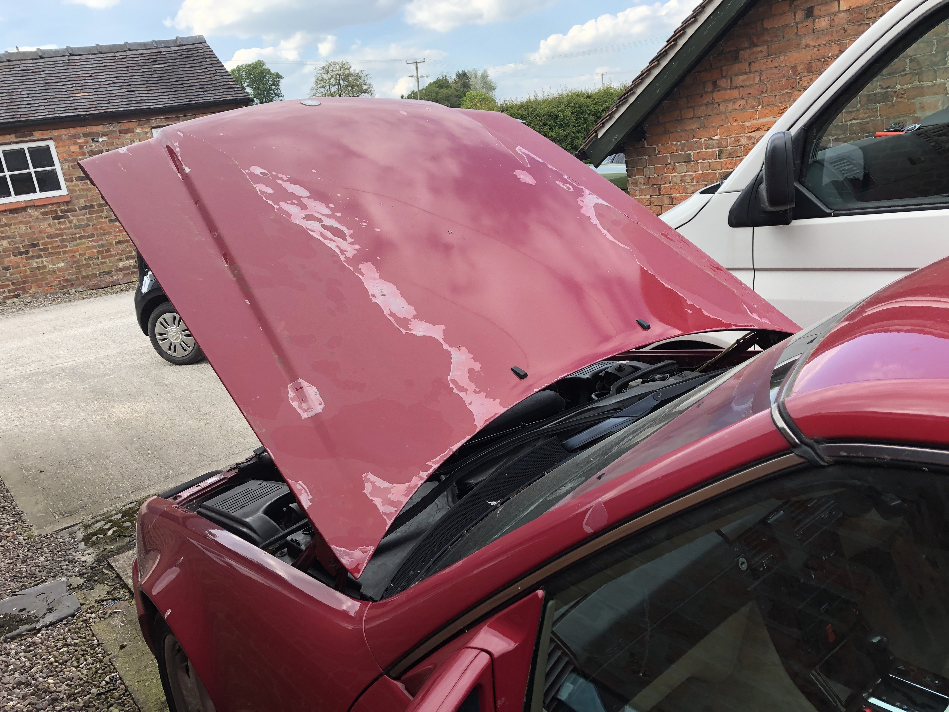

The SL came to me as a project last year, cost a massive £600.  Bodywork was awful but the engine was sweet.  Straight-six and smooth as a babys backside.  Couldn't get the original 7 slat grille as Mercedes no longer make them.  Same part number gives you the 6-slat from the later cars so that's what I bought.

So, a quick update.  Heven't had a lot of time recently but did a little bit of cleaning of plastic stuff, also fitted the new Shindengen Mosfet RegRec and sited the secondary fusebox.

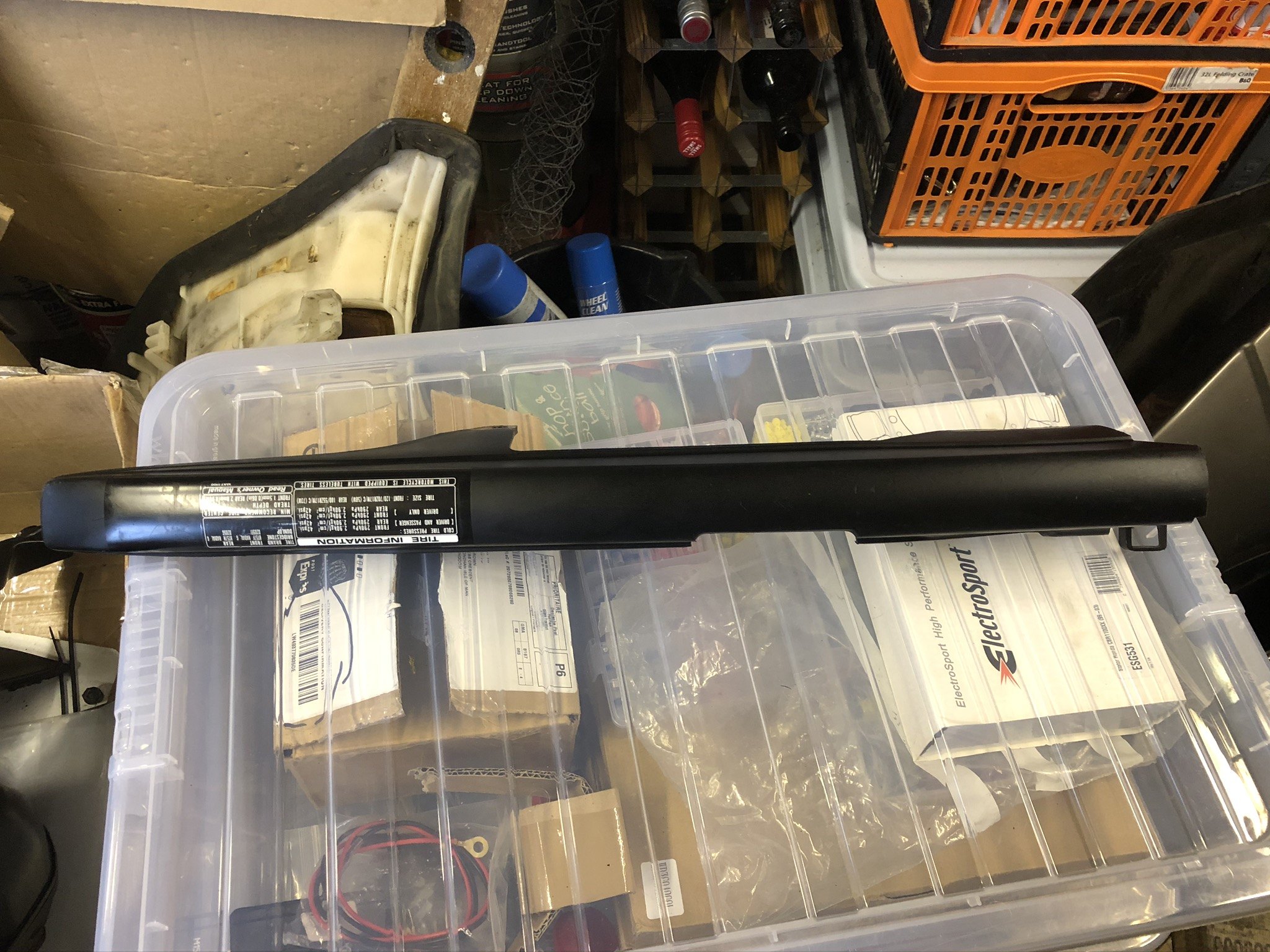

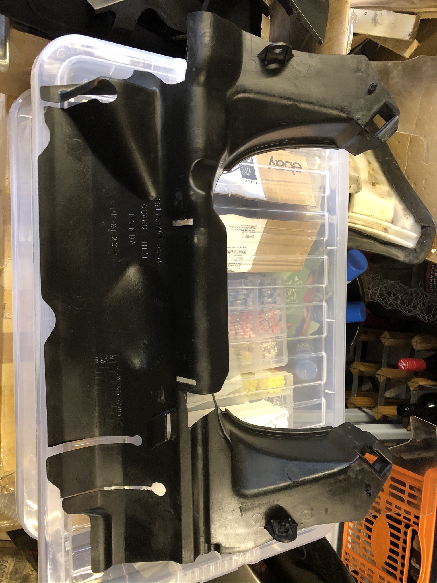

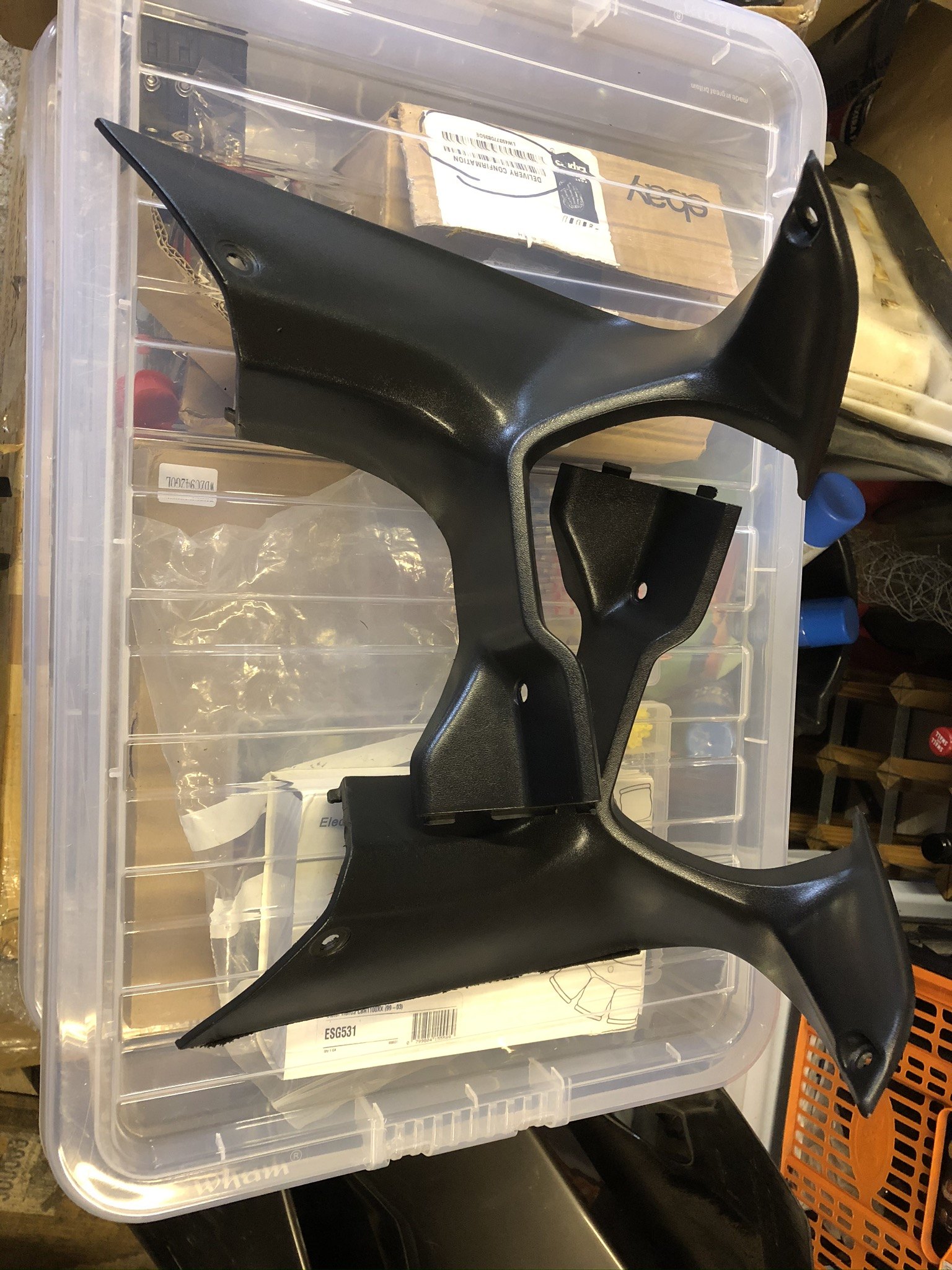

Piece from below clocks

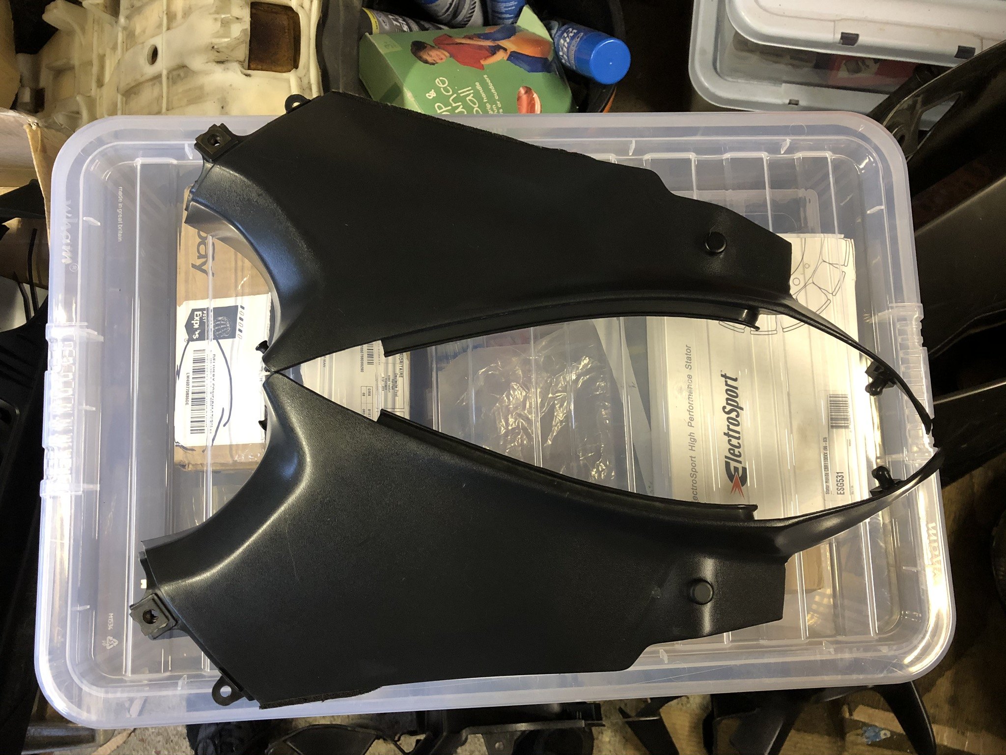

Spare clock infills.
Lower infills.
Chain Guard

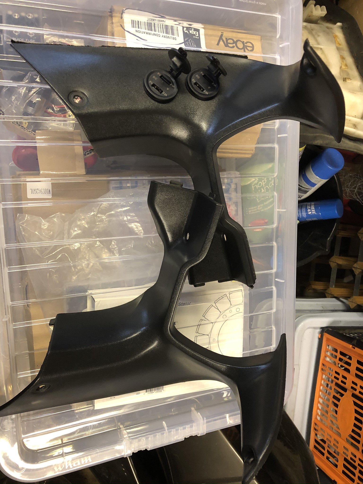

Accessory infills :)  - There will be a single one of these dual USB with voltmeter sockets and a waterproof accessory socket.  New accessory socket hasn't arrived yet and I wanted to have something filling the hole 🤣

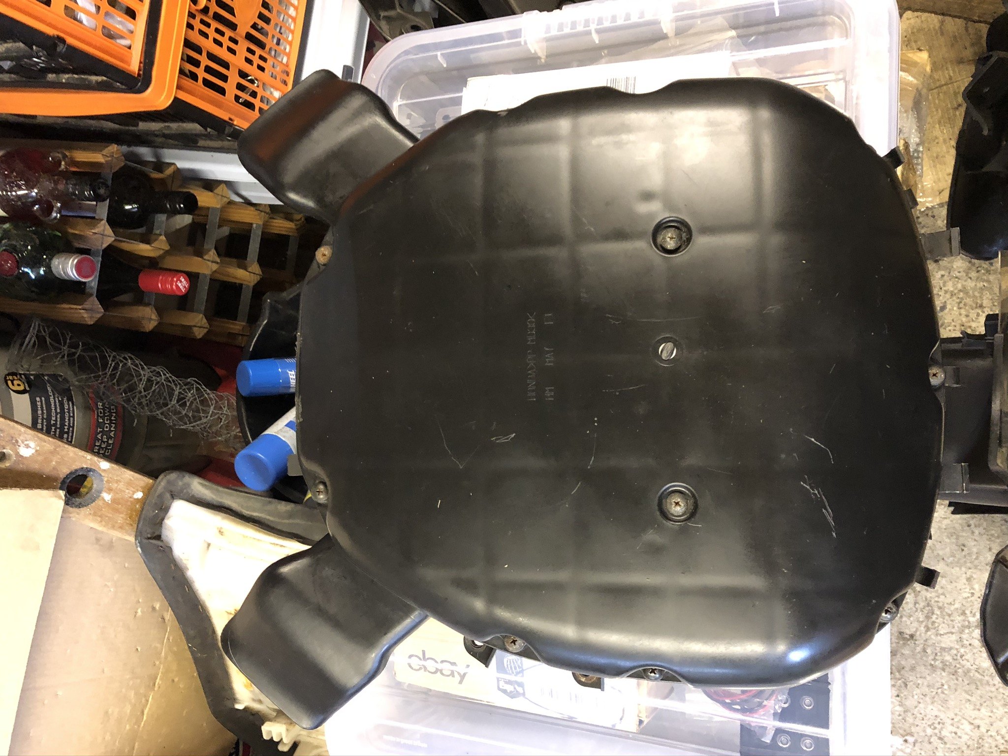

Airbox, complete with new HiFlo airfilter and standard honda secondary sponge filter (those are inside :) )
Shindengen FH020AA Mosfet RegRec.  Yes I know, the starter solenoid wiring is a mess and there's still some frame cleaning to do.  This rebuild is only going so far 😂, want to be able to ride her sometime soon.

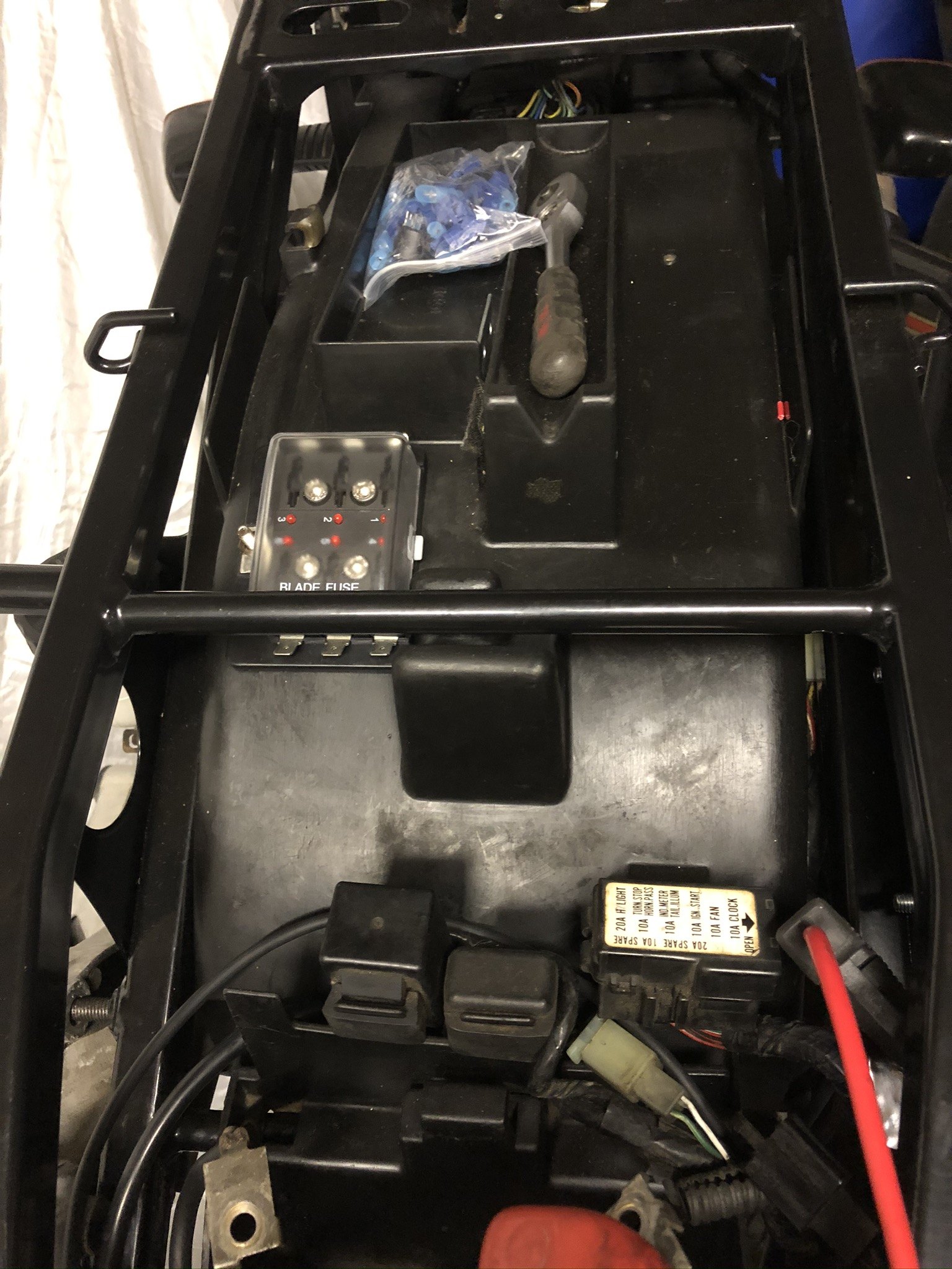

Secondary fusebox site.  New box has LED's to indicate blown fuses.  Currently plan to run 2 x accessory sockets, camera's, and heated grips from this all as separate circuits.  Have a brand new Electrosport stator for the injection model fitted so plenty of extra juice for my carbie.
Now that is a good idea that more things should have.  Did you use anything special to clean the plastics?
Sometimes the simplest ideas are the best.  I got it from AES UK
Cleaned the plastic using Armor-All exterior trim wipes that I got from costco in the UK last time I was there, cheap but effective.
"Standard Honda secondary sponge filter"...what is that?  The stock filter isn't a sponge so I assume you grafted something together...?  I looked at a photo of the BB filter on HiFlow's site and it looks nothing like the stock filter.  If the photo is of what they sell for the BB and not some generic photo, I'd be highly concerned.  Changing the size/shape of the filter can have a drastic impact on the airbox's tuning.
From his description I thought he'd rigged up some kinda two stage filtering.
6 hours ago, rockmeupto125 said:
17254-MAT-000 sub filter for the vent from the valve cover.
When I went to change mine a few years ago, it crumbled in my hand.  I mean it turned to dust.
They pretty much always get overlooked, I had one on my VFR which is why I checked for the bird.  Don’t really want chunks of greasy foam in my carbs really.
