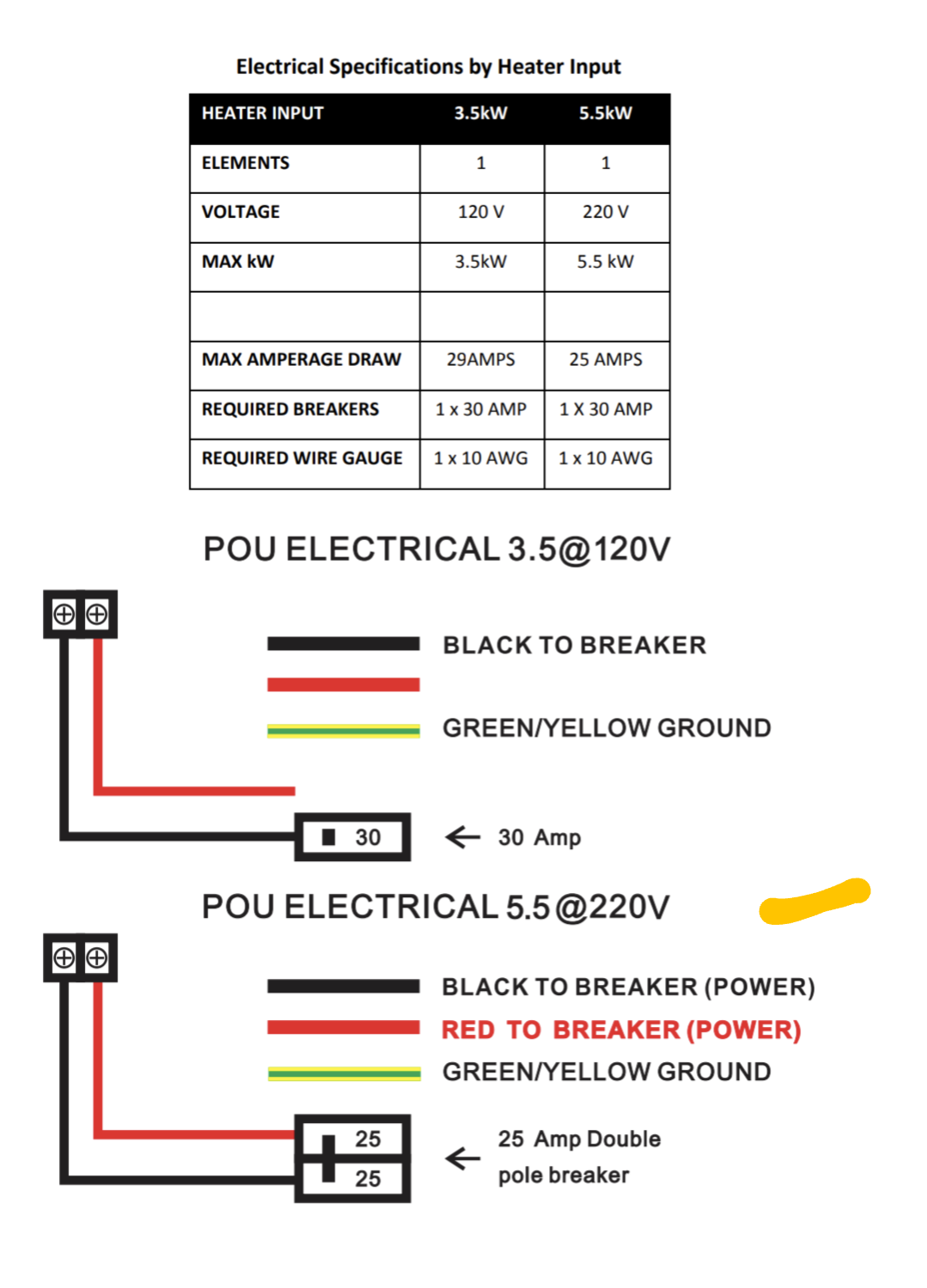

XXitanium Posted September 7, 2023 Author Posted September 7, 2023 The breaker popped a second time. I left it off. If I go get the RMTEX-06, it's 240V. I'm already wired correctly. If I throttle it down with a mixing valves will it use a little less electricity, but not trip the breaker? ...it shouldn't... Quote
blackhawkxx Posted September 7, 2023 Posted September 7, 2023 16 hours ago, SwampNut said: You can have my excessively hot water when you pry it out of my burnt fingers. You live on the sun, why do you want excessively hot water? Quote
CALCXX Posted September 7, 2023 Posted September 7, 2023 (edited) Anytime it's heating, it will draw the same amount of current. 10ga wire minimum. Your guide shows a 1P 30a breaker for the 220v 06 model. You don't have 220v on a 1-Pole breaker. The guide is a little misleading. Europe. You can;t get 220v on one phase using the neutral at your house. You would have to wire 1 Line directly hot instead of the neutral. Don't do it. Baseboard heaters were allowed to do that in the sixties. NEC put a stop to that bullshit. Neither the 04 and 06 have a thermostat. You need to rethink this application. If you have 10ga wire in the wall, connect one Line to a 30A 1P breaker, one line to neutral for 120v. Since you don't have temp control, you can do the mixing valve thing or buy one with a thermostat. Bill, don't run it anymore until this is corrected. The 220V 1ph is Europe. That can be confusing. In the U.S., and in fact everywhere in North America, the standard voltage is 110 V (with a frequency of 60 Hz) rather than the 220 volts used in Europe. The 06 model will not help your situation. Edited September 7, 2023 by CALCXX Quote
XXitanium Posted September 7, 2023 Author Posted September 7, 2023 Yeah, somebody tried to save a couple bucks and combine the 4KW with the 6KW installation manuals. If I'm looking at this right the 6KW can be hooked to American 240 single phase, (2) -120 volt hot legs. Quote
XXitanium Posted September 7, 2023 Author Posted September 7, 2023 I think that manual is a lawsuit waiting to happen. 1 Quote
XXitanium Posted September 9, 2023 Author Posted September 9, 2023 I found a 6kW for $40 less than the 4kW on line. I still need to get a mixing valve. Quote
CALCXX Posted September 21, 2023 Posted September 21, 2023 (edited) Bill, the guide is misleading. Remember, your name plate says 120v. You don't have 220v on 1 phase. Nameplate is everything. Ask your home insurance agent what he thinks about supplying 220v to this 120v rated appliance. Edited September 21, 2023 by CALCXX Quote
XXitanium Posted September 21, 2023 Author Posted September 21, 2023 No, I bought a 240V unit. The 120V is getting pulled when I get time. The breaker is off till then. Quote

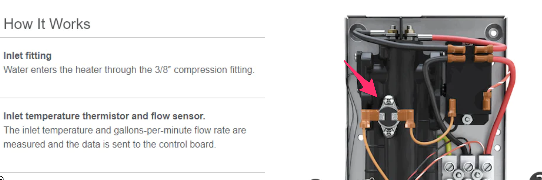

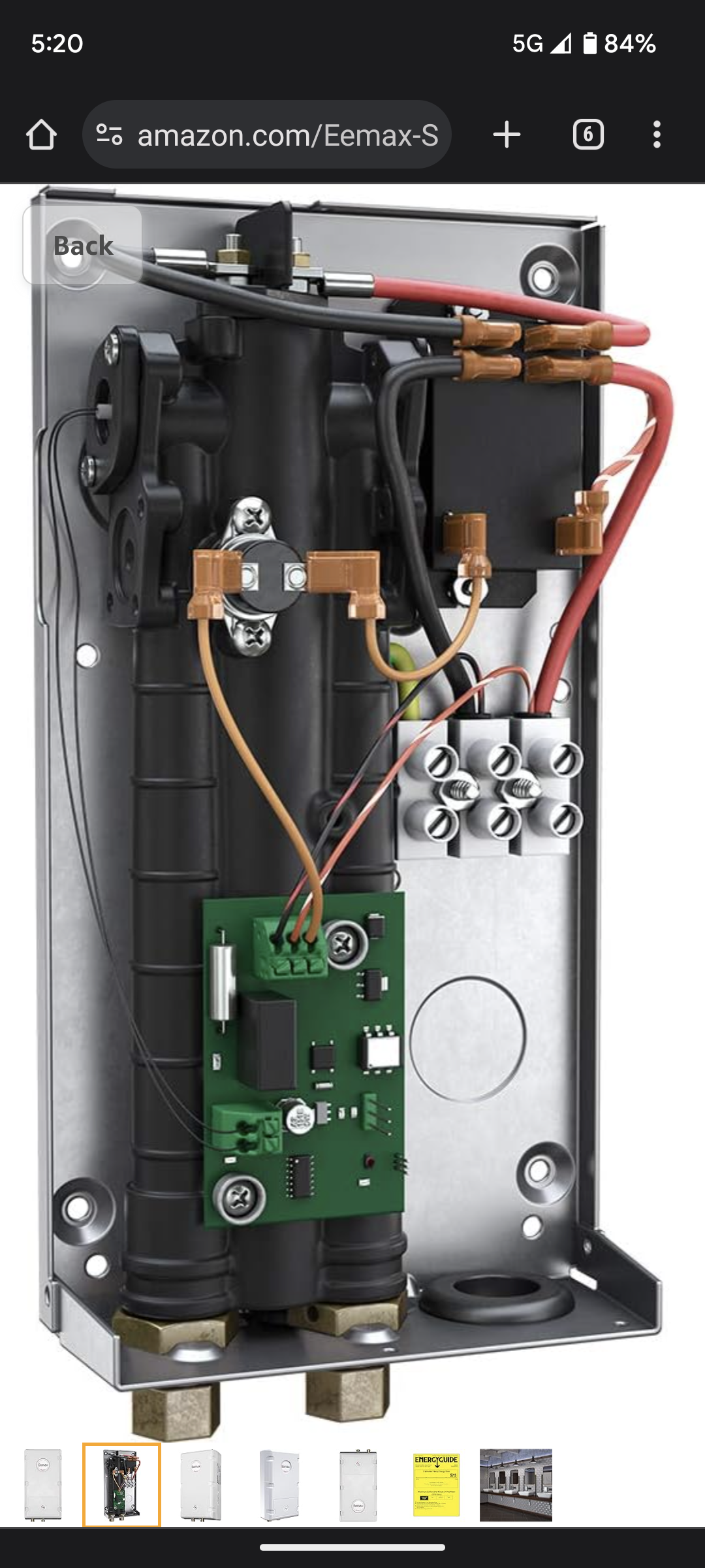

XXitanium Posted October 3, 2023 Author Posted October 3, 2023 It isn't adjustable. ...not like your home tank water heater. https://www.amazon.com/Eemax-SPEX35-FlowCo-Kilowatt-Electric/dp/B07MMDH6PJ#immersive-view_1696371592525 The sensor - I'm making an educated guess, is the black round jobber with two leads. It's probably controlled via a circuit. An electronics expert could probably figure out how to adjust it. Quote
SwampNut Posted October 3, 2023 Posted October 3, 2023 Not adjustable, ever, unless you can change the laws of physics affecting a bimetal strip. It's not a sensor, it's a simple click switch. They are all over your kitchen. Quote
