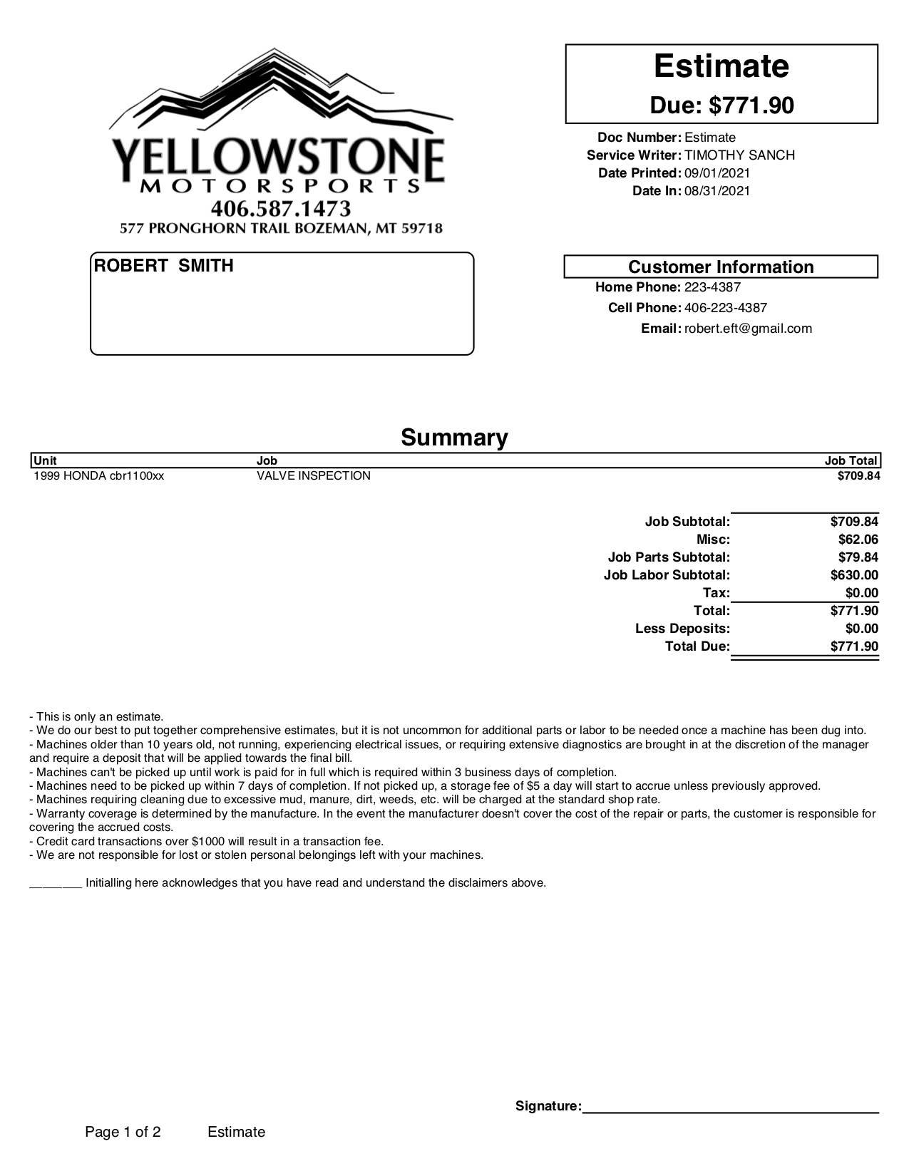

OMG Posted September 1, 2021 Share Posted September 1, 2021 (edited) 99' bird with 65K so I'm thinking this winter might be time to have a look at valves. I stop at the Honda shop and ask if anyone has adjusted valves on a Blackbird. I get a somewhat blank look and he asks me what brand bike is that. I'm not kidding. Then I find out the oldest guy in the shop was born in 82'. It takes the service manager more than a half hour of looking at books so I leave and have them mail me an estimate, here it is. I can do it myself 'if' I can get shims. Edited September 2, 2021 by OMG Quote Link to comment Share on other sites More sharing options...
