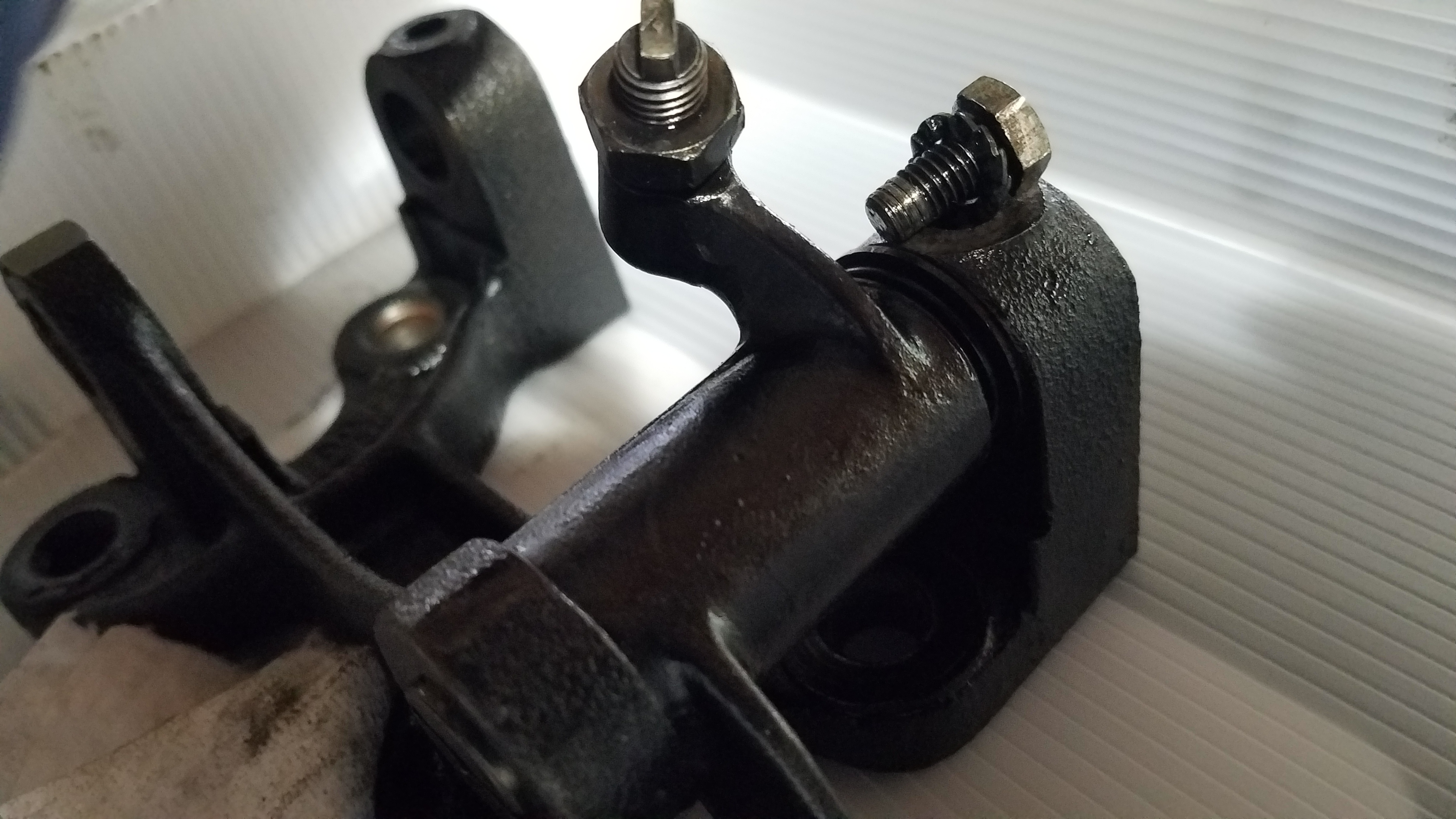

RXX Posted June 1, 2021 Author Posted June 1, 2021 Not an auspicious beginning to engine inspection. Quote
rockmeupto125 Posted June 2, 2021 Posted June 2, 2021 That'll buff out. Are the case threads damaged? Tap and die is your friend. Quote

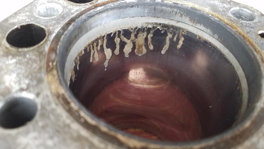

RXX Posted June 2, 2021 Author Posted June 2, 2021 1 hour ago, rockmeupto125 said: That'll buff out. Are the case threads damaged? Tap and die is your friend. One of my next purchases is a quality metric set. Or at the very least find the missing sizes from the set I inherited from dad. In the meantime, I pulled a cylinder and there is considerable flaked chrome in the bore. Another known issue of these old bikes. Quote
XXitanium Posted June 2, 2021 Posted June 2, 2021 Are those jugs sleeved? (Old Hondas could be re-sleeved) Quote
tomek Posted June 2, 2021 Posted June 2, 2021 11 hours ago, RXX said: One of my next purchases is a quality metric set. Or at the very least find the missing sizes from the set I inherited from dad. In the meantime, I pulled a cylinder and there is considerable flaked chrome in the bore. Another known issue of these old bikes. Millennium Technologies from the land of cheese is your friend on chrome issue. Quote
RXX Posted June 2, 2021 Author Posted June 2, 2021 13 hours ago, XXitanium said: Are those jugs sleeved? (Old Hondas could be re-sleeved) No. Chrome-plated. Poorly. 3 hours ago, tomek said: Millennium Technologies from the land of cheese is your friend on chrome issue. Yeah, that looks great, thanks! Nikasil cylinder replacements seem to be the norm for this sort of thing, but it looks like the older bikes are SOL and newer cylinders that have to be machined to fit. Again, I would like to keep as much original as possible, and the original jugs would give me great personal satisfaction. And they look to be very reasonably priced. Quote
