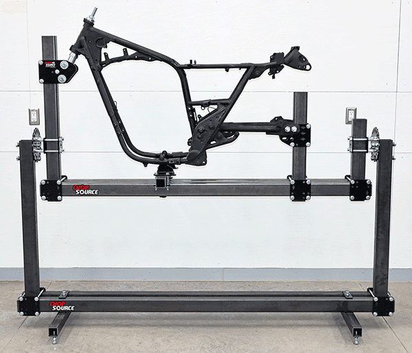

XXitanium Posted July 9, 2024 Posted July 9, 2024 I was thinking about how to make transmission work easier. The lower support on this seems to be in the way? https://tcbros.com/products/diy-frame-jig-rotisserie-stand-by-chop-source Quote
superhawk996 Posted July 10, 2024 Posted July 10, 2024 I don't understand "making transmission work easier." That device is for working on an empty frame, or at least one without a front or rear end in place. Quote
XXitanium Posted July 10, 2024 Author Posted July 10, 2024 My CBX is popping out of 4th gear. I considered removing wheels, bolting the bike in, removing the tank, draining the oil, and flipping it upside down to access the transmission. It's probably not that easy? Quote
XXitanium Posted July 10, 2024 Author Posted July 10, 2024 Yeah, literally just fir building frames... Quote

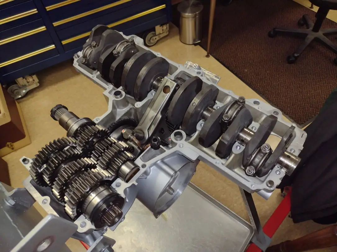

CALCXX Posted July 10, 2024 Posted July 10, 2024 (edited) Bill, i don't understand. The CBX motor "hangs" in the frame. No cradle downtubes. Just dro the motor. Can't remember if the CBX has a cassette gearbox Anyhow, bent shift fork is a possibility that with contribute to "rounding off" the engagement dogs. I undercut the engaement dogs 5 degrees total 2 1/2 er side on my turbo bike and it never let go again. Think positive. If you have to slit the cases, you will get a good look at the main bearings also. lasti gauge is your friend. Edited July 10, 2024 by CALCXX Quote

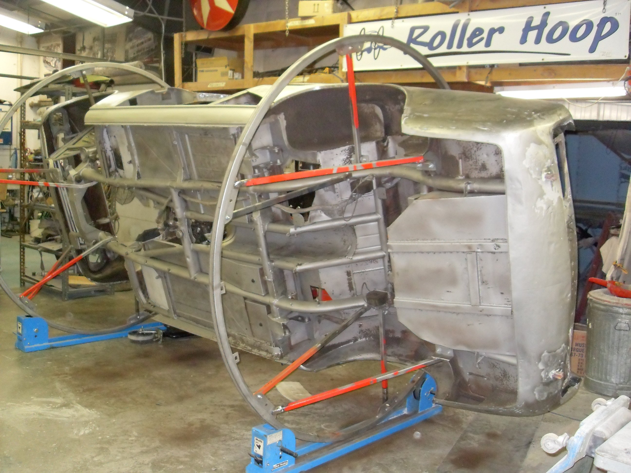

tomek Posted July 11, 2024 Posted July 11, 2024 You could remove whatever you can, and then just flip it and let it rest against the wall, etc. Secure to the wall. It would be criminal not to check main and, if accessable, rod bearings. I would not fuck with plasti gauge, if signs of wear at uncomfortable level replace them going by numbers of crank and cases. I had to fix 6th gear on my VFR1200. Engine removal being V4 is epic, biblical and monumental pain in the ass to the square. 4 times amount of work vs. inline 4. Essentially you have to lift off the frame of the engine, and reverse it on installation. You gotta remove front forks, driveshaft, rear pain in the ass headers. Basically bike has to be strip down to the frame except gauges, triple tree and rear subframe. In retrospect bike flip would be much, much quicker. 1 Quote
XXitanium Posted July 12, 2024 Author Posted July 12, 2024 On 7/10/2024 at 2:25 PM, CALCXX said: ... lasti gauge is your friend. P - does not stand for Park. The gears are on two transmission shafts and the idler for the output. Quote
