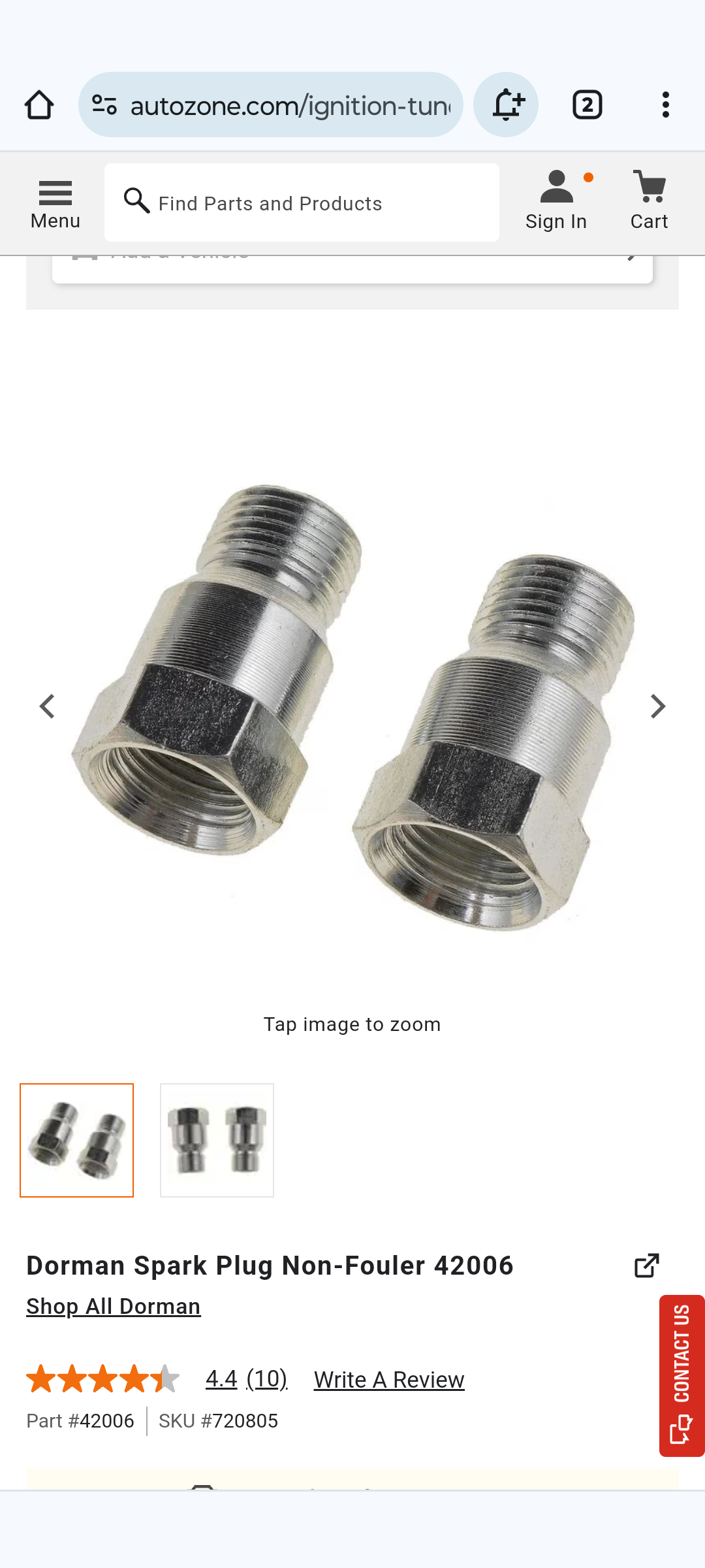

tomek Posted May 19, 2024 Posted May 19, 2024 12 minutes ago, RXX said: I will pull the codes today. I don’t look at the check engine light anymore. I put an aftermarket manifold and cat on it last year and the rear O2 sensor does not play nice. I currently have 5 lights that stay on. Spacer for rear O2 would, probably, fix your engine light. Goes between pipe/cat and 02 sensor. Quote
superhawk996 Posted May 20, 2024 Posted May 20, 2024 Spacer as shown, or "MIL eliminator" which is a simple electronic fooler. What I usually do is cover some of the holes that let exhaust into the sensor. I've never researched how much of it to cover, I usually do about 3/4 of it, maybe more. A dot of weld on each hole with the mig welder, or use a spring type hose clamp and grind off the tabs so it'll fit in the hole. Quote
RXX Posted May 20, 2024 Author Posted May 20, 2024 (edited) 22 hours ago, tomek said: Spacer for rear O2 would, probably, fix your engine light. Goes between pipe/cat and 02 sensor. https://www.racdyn-usa.com/PROD/130+10+10+013.html Didn’t help. I can get my ECU flashed as part of a tune that will get rid of it. $800or yellow light???? Edited - I spoke with tech support at Racing Dynamics. It is their product and they sold me a bung that said should work but no guarantees. I have been dealing with this since I replaced the manifold/cat. I am sort of resigned. My air bag, ABS, TPI, DCS have all been on for 2+ years. I do not need dash lights. Edited May 20, 2024 by RXX Quote

tomek Posted May 20, 2024 Posted May 20, 2024 19 minutes ago, jon haney said: So, let me get this straight. This little O2 bung device is supposed to fool your O2 sensor into believing the catalytic convertor is doing it's job properly? Yes, the idea is to keep the tip of O2 sensor out of exhaust steam. Usually it works, at least on older generation vehicles. Quote
tomek Posted May 20, 2024 Posted May 20, 2024 Btw, curious in what position RXX installed that thing. Less exhaust gasses getting there, the better, I guess. Quote

SwampNut Posted May 20, 2024 Posted May 20, 2024 2 hours ago, jon haney said: This little O2 bung device is supposed to fool your O2 sensor into believing the catalytic convertor is doing it's job properly? Well, not exactly. The higher flow is fooling the O2 sensor and making it think something is out of order (it sort of is). The spacer reduces the sensor's perceived flow and puts it back in normal range. Quote

jon haney Posted May 20, 2024 Posted May 20, 2024 23 minutes ago, tomek said: ECUs are touchy about O2 replacement sensors. Aftermarket is hit or miss. Did you get OEMs? As the rest of your post, spacers are practically free, so it is just labor, although it could be a bitch on some cars. Nothing to lose, just try it. We do have emission test in Illinois. Once every two years. OBD only. No visual or sniffer. One of the cats in my Volvo is weak, I would get check engine light. Installed spacers( inline six, two downstream cats), it cured CAT codes, although now sometimes lean condition code pops up, but only if you do 80 mph or better for more than 15 minutes or so. City driving it will disappear. So you know what not to do before testing. 😆 As a matter of fact I passed emission test today. 211 k miles. Xc70 3.2 atmo. Original cats and sensors. Getting another new to me XC70 with 45 k miles. Turbo inline 5. Not from OEM, but Denso's, which I believe is what Nissan sells. No emissions test here. Just want to prevent that false code. Quote
tomek Posted May 21, 2024 Posted May 21, 2024 Well, I'd definitely try O2 spacers. It is just couple bucks. Quote
superhawk996 Posted May 21, 2024 Posted May 21, 2024 I've heard of people stacking two spacers to solve the problem. 1 Quote
RXX Posted May 21, 2024 Author Posted May 21, 2024 6 hours ago, superhawk996 said: I've heard of people stacking two spacers to solve the problem. So I should try that? Quote
superhawk996 Posted May 21, 2024 Posted May 21, 2024 5 hours ago, RXX said: So I should try that? I would, or install the electronic fooler if space is limited. I've also seen 90 degree adapters to deal with space issues. Something else to keep in mind is that if the wires are oily/grungy the sensor can read wrong and might show a dead cat even if it's good. This probably isn't the perfect textbook way to explain it- the sensor uses outside air to function and it does it by breathing through the wires. Way back they had a sample tube/breather hole in the sensor's body. I believe this is why the spacer works, even tho the sensor tip is still seeing pure exhaust, the spacer changes the percentage of outside air to exhaust. Restricting the exhaust while keeping the same amount of outside air is kinda like leaning out the mixture that's acting on the sensor making it think the exhaust is cleaner. If it can't breath it'll show the opposite, a richer/dirtier mixture. 1 Quote
