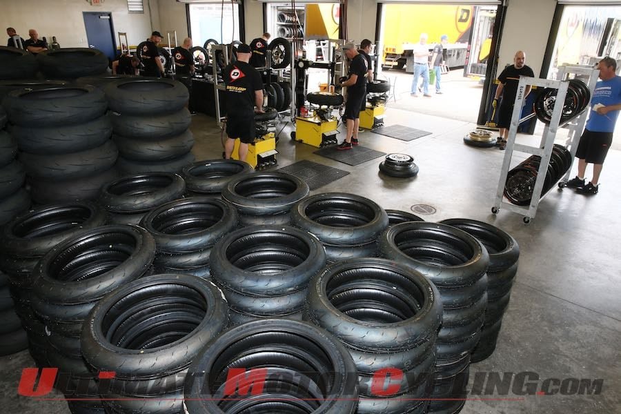

 Also, tell you bro to stop fricking out about tires not being dynamically balanced. Here is picture of Dunlop crew changing tires during Moto America races. Further on the left are tire balancing stations. Static. Those bikes go 190 mph and have rear tires of 200/65-17 size.

I've seen photos of MotoGP guys static balancing in the pits which implies that it's good enough.  With such a skinny wheel, it would be interesting to know if it'll get offset weights.  I've read that shops use machines just because it's faster and easier.  If you get a chance, talk with the shop about it and see if they'll give you any useful info about static vs. dynamic.  With a machine, I believe the proper terms will be single plane and dual plane balancing.
I kinda did.  Keep in mind that there are things the racers do that aren't good for the street, and it's possible that their wheels and tires are more perfect than what we buy.  But I have a hard time imagining how their balancing technique wouldn't translate well to street riding.  Next time I'm at a dealership I'll try to remember to see if new bikes are single or dual plane balanced.
