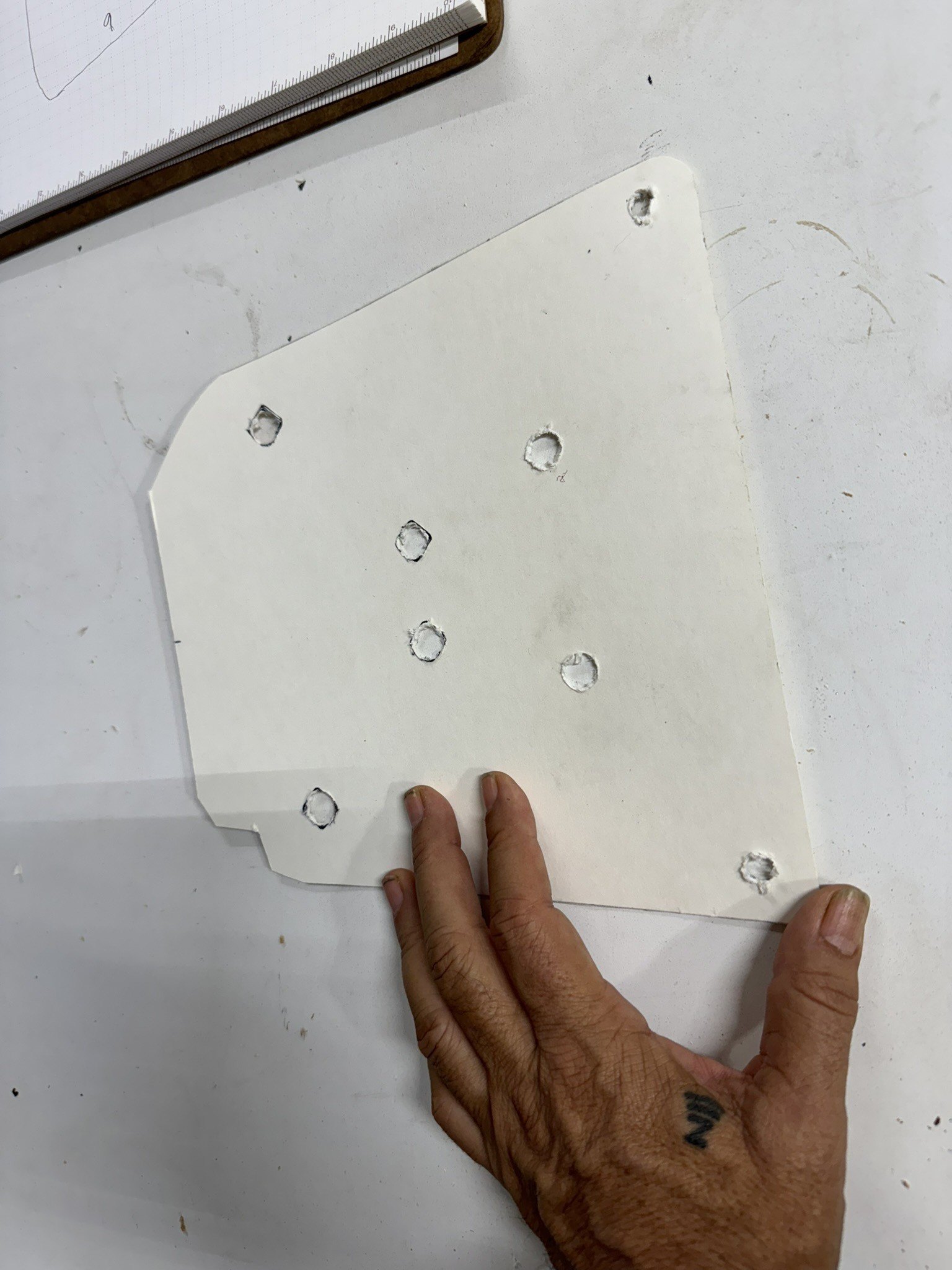

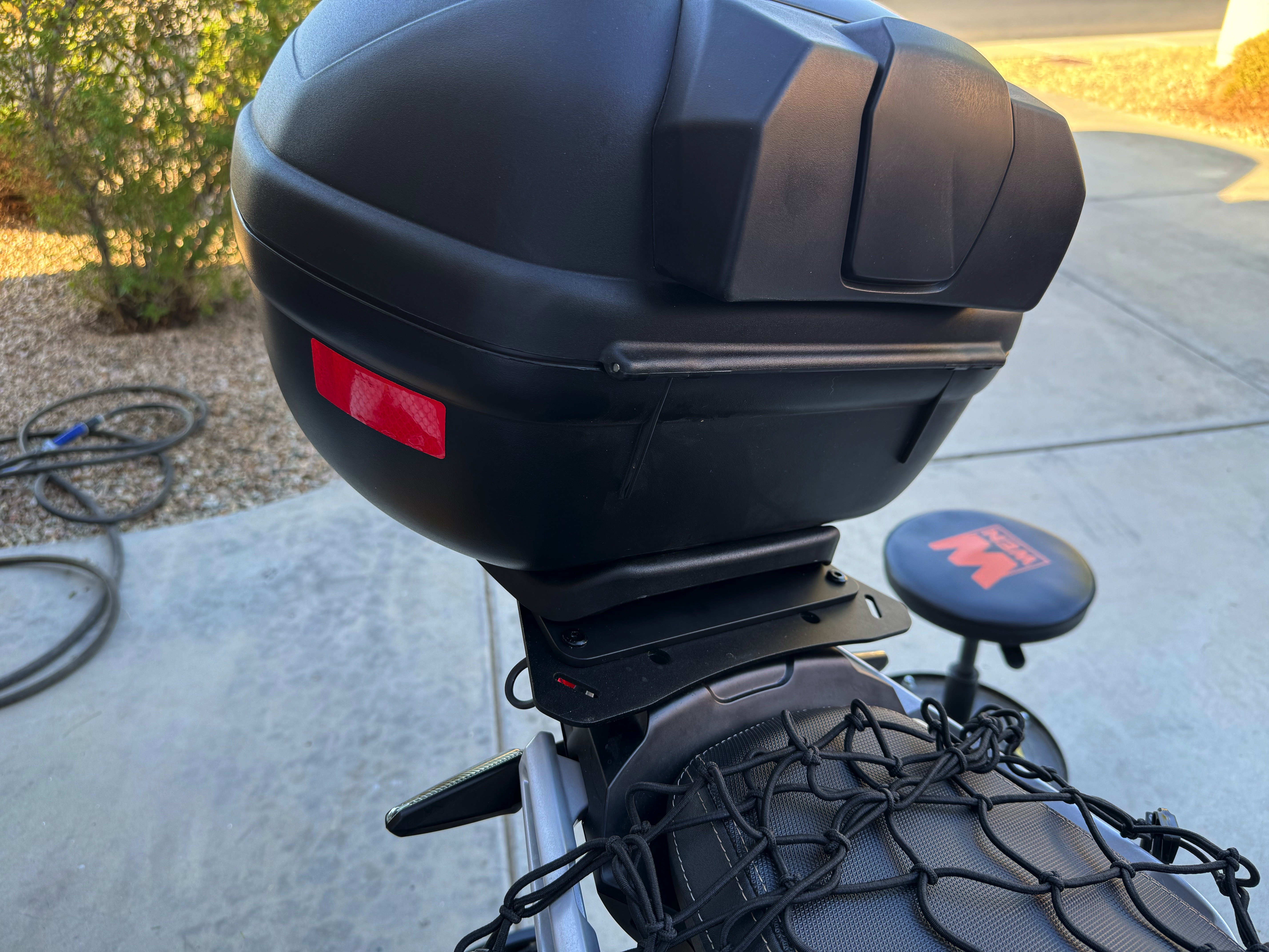

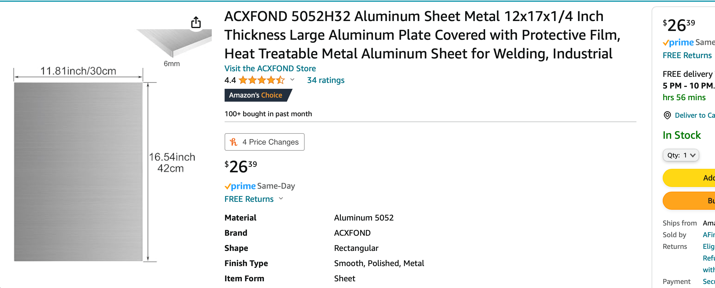

SwampNut Posted October 23, 2023 Share Posted October 23, 2023 German word for brazier, I know. The way that my top case attaches to the OEM plate leaves a lot of plastic hanging unsupported, so it bounces a lot. I saw it when I swapped bikes and rode behind my own, and I noticed this on Joe's XX too. Now I can't unsee it, and it bothers me a lot. Perhaps unwarranted, or perhaps a real potential problem, particularly since I'll put 30 pounds of groceries in it and I think it's rated for like 15 pounds. So.... Yes, 1/4 is probably overkill, which is always the right amount of kill. When it arrives, my inclination is to cut it on the table saw. Lots of people say it's great for that. I have a variety of blades, none of which are "perfect" for it, but I think close enough. I think the 80 tooth (8 tpi, 10" blade) fine-cut is my best choice. Quote Link to comment Share on other sites More sharing options...
IcePrick Posted October 23, 2023 Share Posted October 23, 2023 1 hour ago, SwampNut said: German word for brazier, I know. The way that my top case attaches to the OEM plate leaves a lot of plastic hanging unsupported, so it bounces a lot. I saw it when I swapped bikes and rode behind my own, and I noticed this on Joe's XX too. Now I can't unsee it, and it bothers me a lot. Perhaps unwarranted, or perhaps a real potential problem, particularly since I'll put 30 pounds of groceries in it and I think it's rated for like 15 pounds. So.... Yes, 1/4 is probably overkill, which is always the right amount of kill. When it arrives, my inclination is to cut it on the table saw. Lots of people say it's great for that. I have a variety of blades, none of which are "perfect" for it, but I think close enough. I think the 80 tooth (8 tpi, 10" blade) fine-cut is my best choice. Plasma works on aluminum, it leaves an edge that looks like it was sandblasted with heavy grit. I'll be interested in hearing what your table saw does with it, I think metal saws run at much lower RPM and have blades designed for the task. But we work with the tools we have (unless a new project is just an excuse for a new tool, it's not even a secret of mine anymore). Quote Link to comment Share on other sites More sharing options...

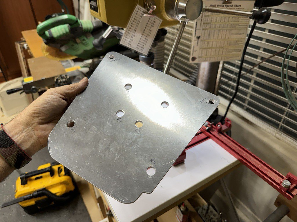

SwampNut Posted October 23, 2023 Author Share Posted October 23, 2023 17 minutes ago, IcePrick said: Plasma works on aluminum, it leaves an edge that looks like it was sandblasted with heavy grit. My last attempt at using my small plasma on 1/4 aluminum was not good, because it loses heat so fast. The edges of this will be somewhat visible so I'd like them to be clean, and also minimize hours of cleaning up edges. I'm even thinking about edging it on my carbide-equipped jointer, but that's more sketchy, maybe. Aluminum table saw blades have slightly different tooth shapes, and do run slower. Yet, the only "don't do this" I could find about using a wood saw was from...the maker of aluminum saws... So far I can't find anything saying I will die. Edit to add: It will be clamped on my Incra miter sled, and fingers far from the cut and the piece. Quote Link to comment Share on other sites More sharing options...

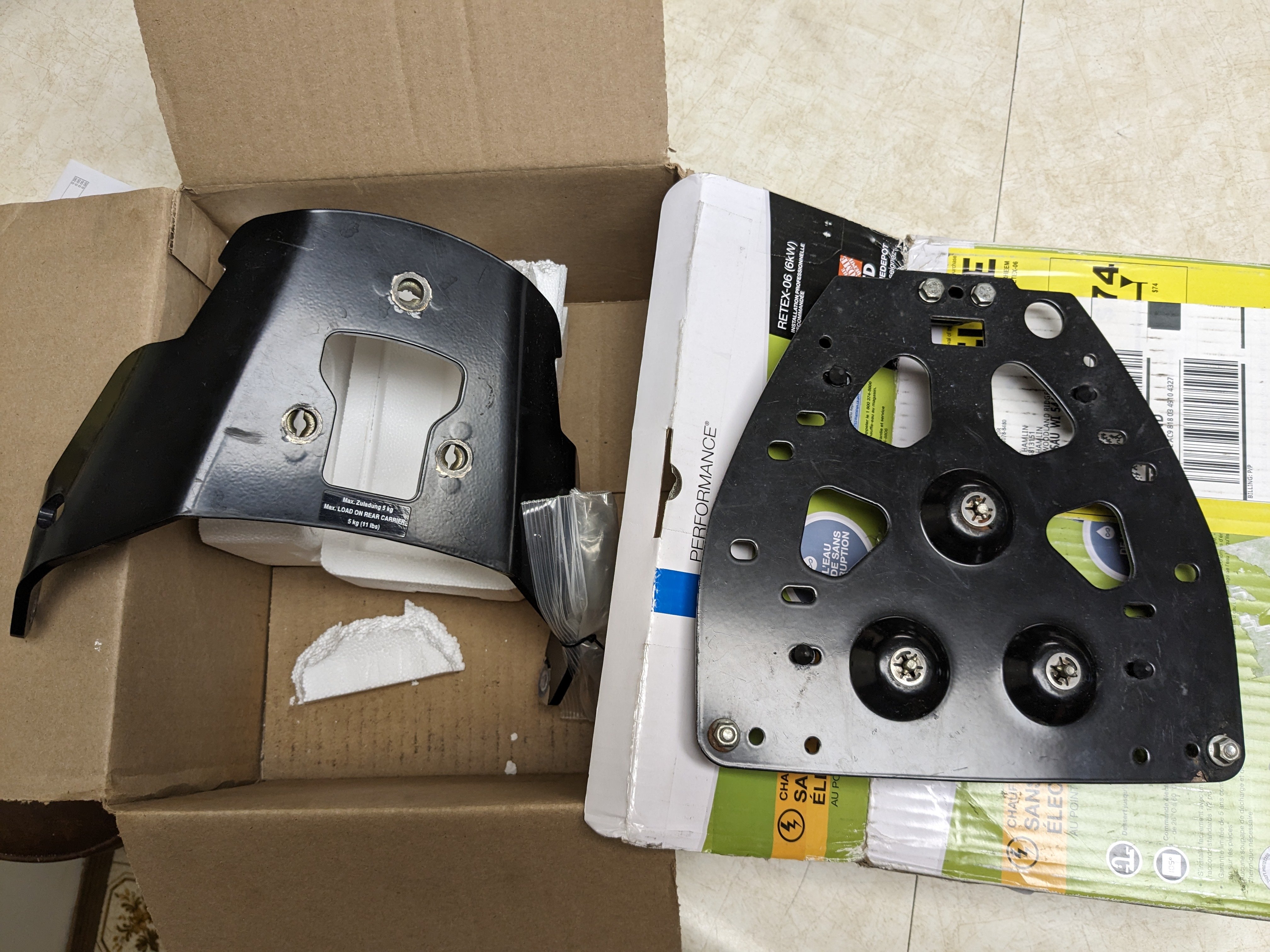

XXitanium Posted October 23, 2023 Share Posted October 23, 2023 (edited) So, if I interpret this correctly, you're making something that is part of a Givi wing rack and they're normal assembly? Edited October 23, 2023 by XXitanium Givi is not spelled h e a v y Quote Link to comment Share on other sites More sharing options...

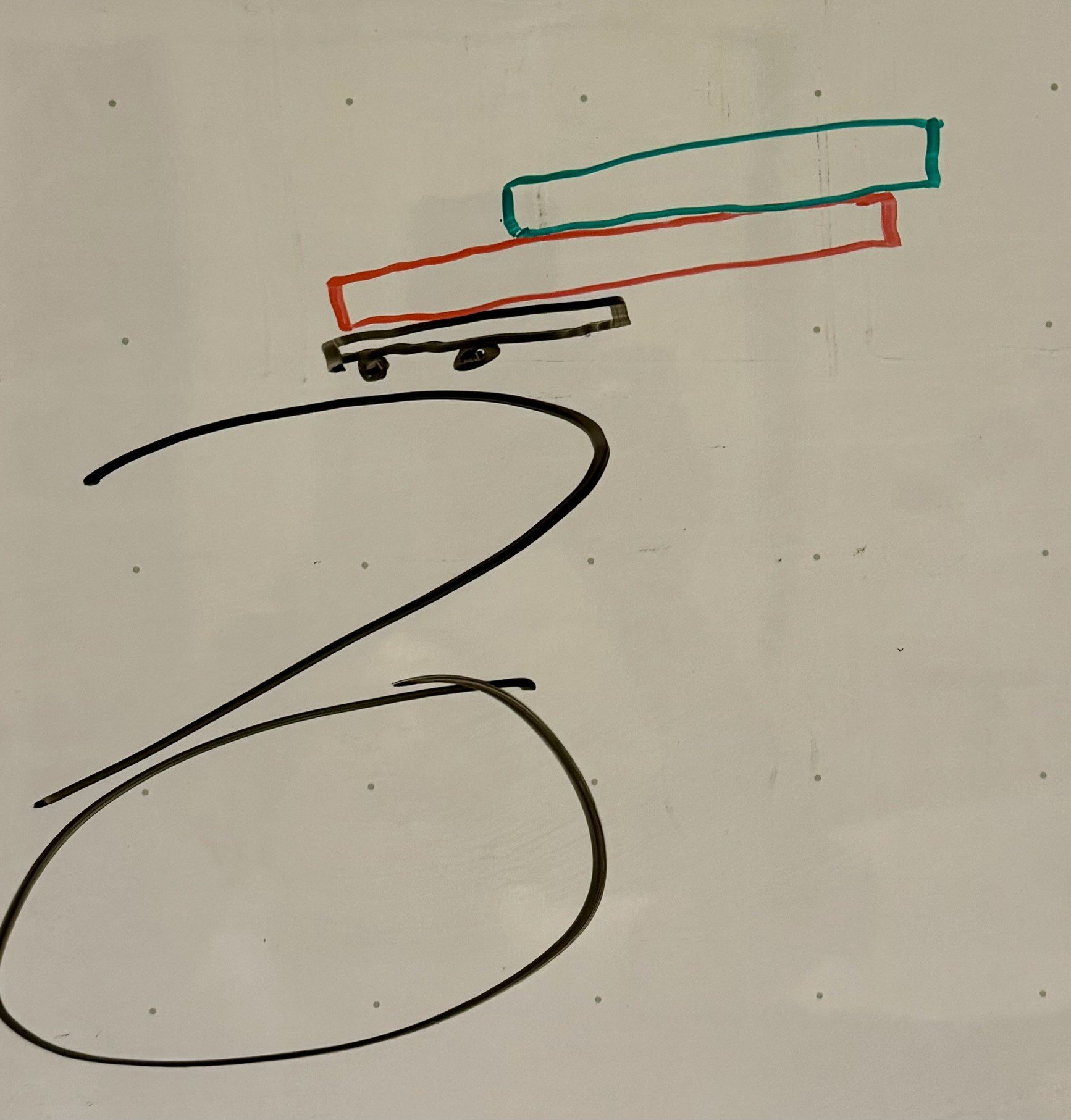

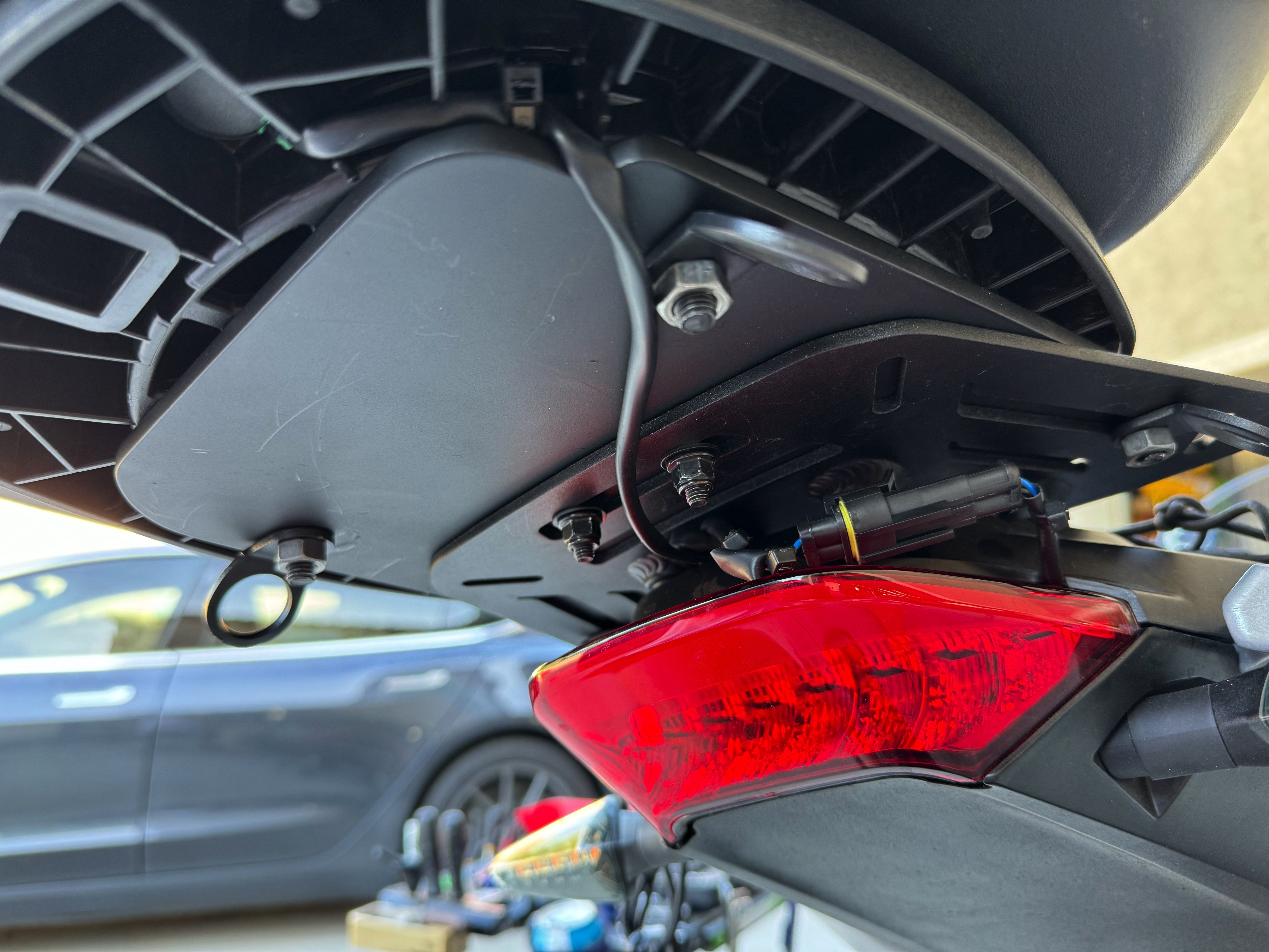

SwampNut Posted October 23, 2023 Author Share Posted October 23, 2023 1 minute ago, XXitanium said: part of a heavy wing rack and they're normal assembly? Sorry, no idea what that means. I'm putting a plate between the OEM mount, and the Givi quick-release mount plate. The Givi part is only about 1/3 attached to the bike plate, by the time you account for space for the backrest and the passenger's back armor. It has to be way back. Green is the plastic Givi plate, black is the bike and its steel plate. Red is what I am making and adding to stop the plastic flex. Quote Link to comment Share on other sites More sharing options...

jon haney Posted October 23, 2023 Share Posted October 23, 2023 3 hours ago, SwampNut said: My last attempt at using my small plasma on 1/4 aluminum was not good, because it loses heat so fast. The edges of this will be somewhat visible so I'd like them to be clean, and also minimize hours of cleaning up edges. I'm even thinking about edging it on my carbide-equipped jointer, but that's more sketchy, maybe. Aluminum table saw blades have slightly different tooth shapes, and do run slower. Yet, the only "don't do this" I could find about using a wood saw was from...the maker of aluminum saws... So far I can't find anything saying I will die. Edit to add: It will be clamped on my Incra miter sled, and fingers far from the cut and the piece. I have cut a lot of aluminum on my old craftsmen table saw (I think it's older than me), including air-craft T-bar. Use a carbide-tipped blade, feed very slow, and you'll be fine. Dang sure wear safety glasses. Those chips go everywhere. Quote Link to comment Share on other sites More sharing options...
SwampNut Posted October 23, 2023 Author Share Posted October 23, 2023 2 minutes ago, jon haney said: Dang sure wear safety glasses. You misspelled arc flash suit and Nomex. But yeah, I'll have the full face grinder shield on. I've run very small and thin aluminum before, this is just my first one of substance. 1 Quote Link to comment Share on other sites More sharing options...

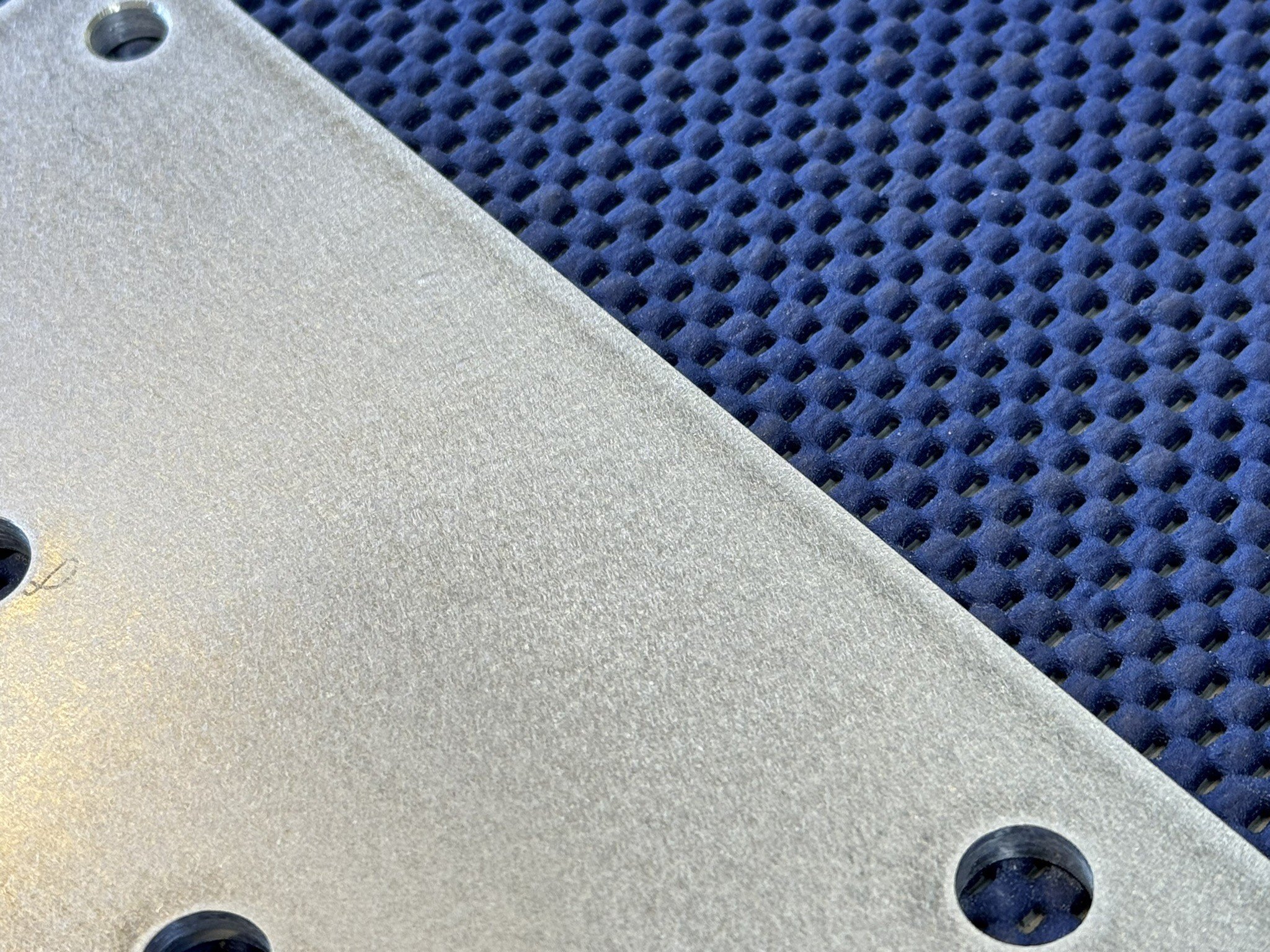

SwampNut Posted October 24, 2023 Author Share Posted October 24, 2023 Cutting aluminum on wood tools is easier and safer than cutting exotic hardwoods. Aluminum doesn't have a grain, and doesn't warp as you cut it. Totally drama free. 3M Cubitron disks on my RO sander worked well to clean up edges, but it certainly put a hurt on the disk faster than wood. I don't know if it's wear or clogging, but I suspect that cutting aluminum oxide (self forming on the sheet) with aluminum oxide crystals on the disk is going to cause wear. I wonder how a carbide disk would do. The Woodslicer blade on the bandsaw also cut so easily, and predictably, to make the curves and small cutouts for the tail light wiring. 2 Quote Link to comment Share on other sites More sharing options...
SwampNut Posted October 24, 2023 Author Share Posted October 24, 2023 Oh...safety. FULL FACE SHIELD!!!! Hearing protection? Nah. It's oddly not loud. Oh, and I used an 80 tooth 10" ultra fine cut blade, probably from Freud. Probably a plywood blade, not sure (the markings come off when they get sharpened and I neglected to mark it permanently). Quote Link to comment Share on other sites More sharing options...
SwampNut Posted October 24, 2023 Author Share Posted October 24, 2023 A couple of very interesting things: The vac gets all the aluminum sanding dust. There was non at all on the floor under it. The amount of bending that happens at the cut line is surprising. At least, I think it's why there's a "shadow" in the sanding results all around the cut. Not just the stamped edge, but the carbide-cut edges too. It's even more visible in person. Quote Link to comment Share on other sites More sharing options...
ironmike Posted October 24, 2023 Share Posted October 24, 2023 (edited) Hmm, is there sufficient heat generated by the cutting to contribute to the shadowing as well as the bending? Edited October 24, 2023 by ironmike Quote Link to comment Share on other sites More sharing options...
SwampNut Posted October 24, 2023 Author Share Posted October 24, 2023 Good question, I have no way to know. There's no noticeable heat, touching it right after cutting, but aluminum dissipates heat so fast. Quote Link to comment Share on other sites More sharing options...

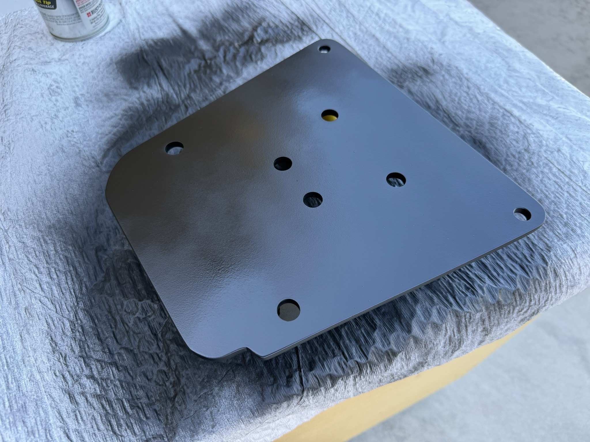

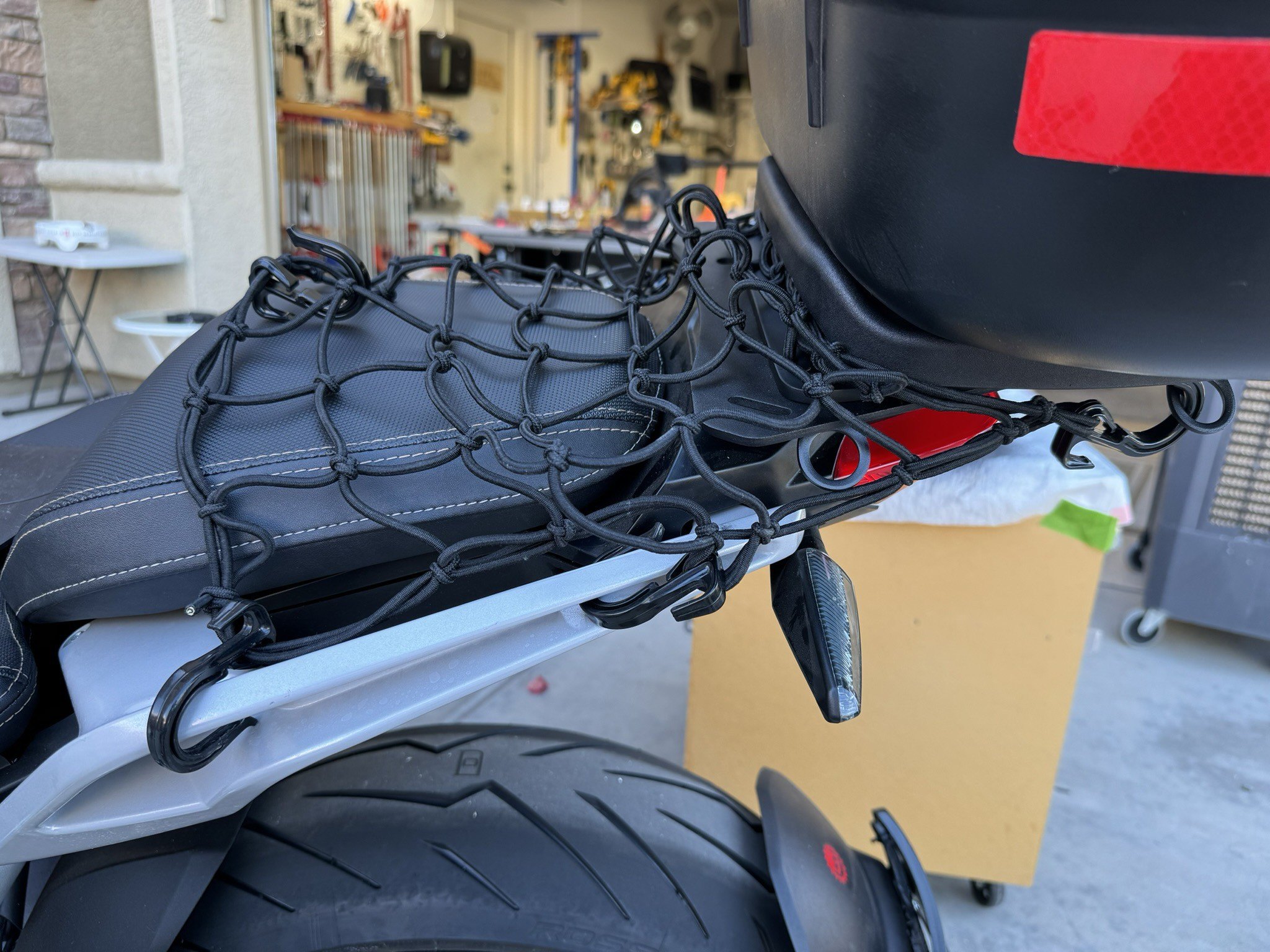

SwampNut Posted October 25, 2023 Author Share Posted October 25, 2023 4 hours ago, blackhawkxx said: Yes, right at the end of the cut you can see the front edges come together. Rookie move, for fucking sure. I am surprised at how fast those Cubitron disks eat metal in a plane RO sander, and cleaned it up. I think my plate looks better than the OEM plate. Smoother to the touch for sure. Also, these cheap little hook things are so useful for my bike usage, daily driver, groceries, errands, whatever. 1 Quote Link to comment Share on other sites More sharing options...

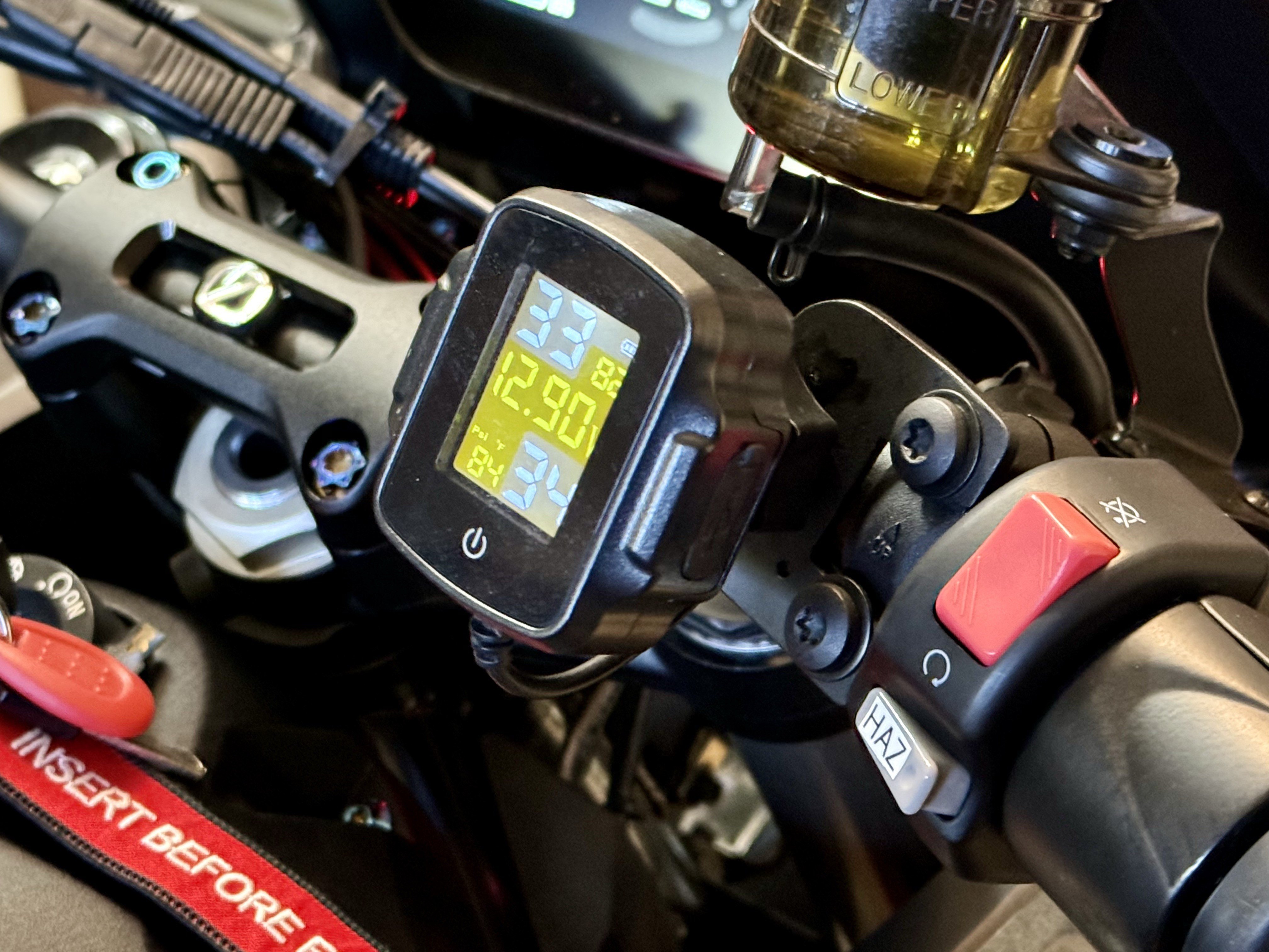

SwampNut Posted October 26, 2023 Author Share Posted October 26, 2023 I got inspired to make a decent bracket for the TPMS. It came with a horrible piece of shit that broke on its own. 1 1 Quote Link to comment Share on other sites More sharing options...
