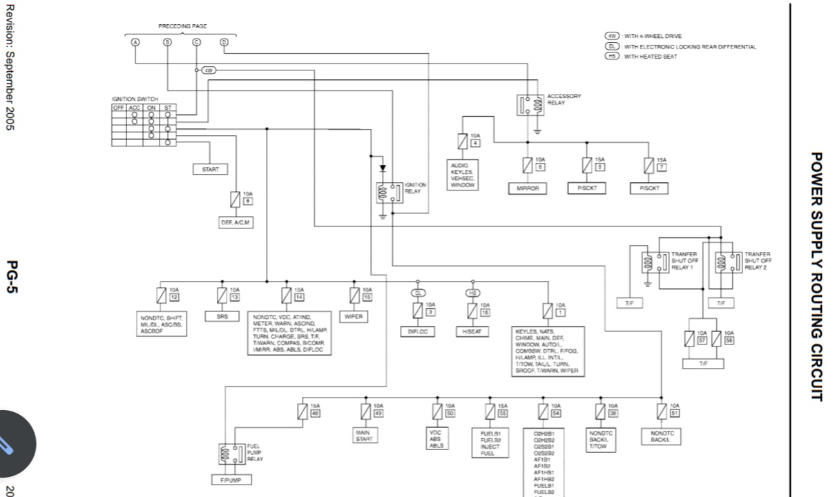

XXitanium Posted October 18, 2022 Share Posted October 18, 2022 4 hours ago, jon haney said: Another mentioned corroded fuel pump relay. Are there duplicated relays? My old F-250 had mutiple of the same relay part number. Maybe you could maybe swap them around? How much does a new relay cost? 2007 is only 15 (16) years old... Quote Link to comment Share on other sites More sharing options...

superhawk996 Posted October 19, 2022 Share Posted October 19, 2022 3 hours ago, XXitanium said: Are there duplicated relays? My old F-250 had mutiple of the same relay part number. Maybe you could maybe swap them around? How much does a new relay cost? 2007 is only 15 (16) years old... I think the relay is part of an integrated circuit type thing, I don't know what Nissan calls it, but many manufacturers have chosen to fuck us like that decided to go this route. 1 Quote Link to comment Share on other sites More sharing options...

XXitanium Posted October 19, 2022 Share Posted October 19, 2022 https://www.clubfrontier.org/threads/fuel-pump-relay-location.32760/ 2006, 2007? . Quote Link to comment Share on other sites More sharing options...

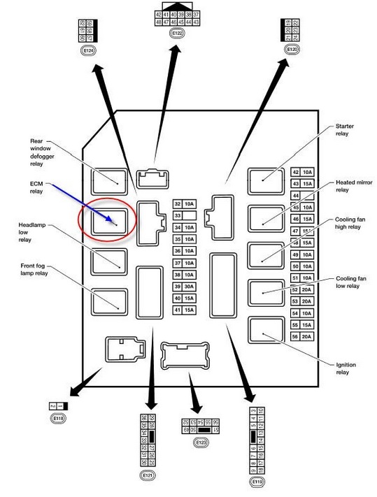

Furbird Posted October 19, 2022 Share Posted October 19, 2022 Quote Link to comment Share on other sites More sharing options...
Furbird Posted October 19, 2022 Share Posted October 19, 2022 Not fuel pump relay, ECM relay. Call the dealer, see if it has an open recall, it may be free! Quote Link to comment Share on other sites More sharing options...

jon haney Posted October 20, 2022 Author Share Posted October 20, 2022 22 hours ago, Furbird said: Not fuel pump relay, ECM relay. Call the dealer, see if it has an open recall, it may be free! Will do. Yes, the battery cable ends have been replaced with the lead style (like from the 70's). Not sure if did it, as this truck was my father-in-law's that he purchased new. Also, I charged the battery last night with a very old, heavy, but functional charger, and then put my tester on it. It read 12.75 volts (engine off). Then hit it with the 50 amp test load and it indicated "weak", so going to start with a new battery, and then some of the other stuff mentioned. I'm curious to know how lead terminals can be a problem, if you keep them cleaned? Quote Link to comment Share on other sites More sharing options...
