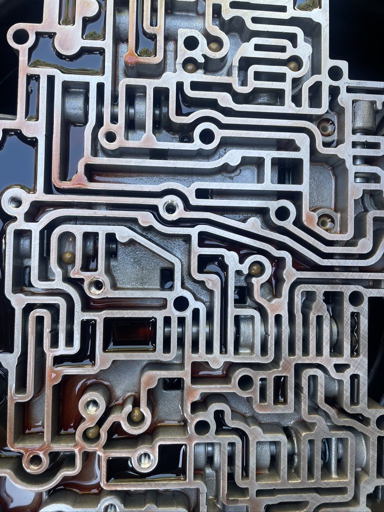

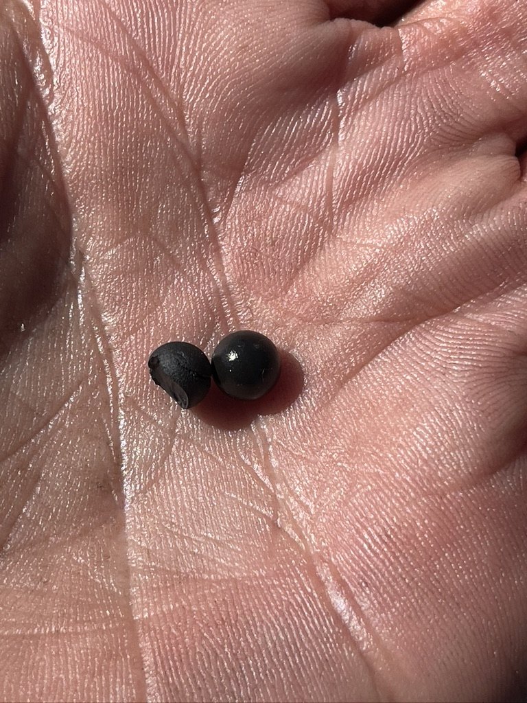

First time I opened one I didn't know about the balls and they all spilled out, luckily I had a manual that showed where they're supposed to go. They used to be steel, now some use plastic. 99% sure that the fluid change was unrelated to the failure. He did some hard switchback hill climbing right after I worked on it which may have contributed to the demise. The fan clutch was barely working and the engine overheated, which means the trans probably did too. The symptoms started right after that drive. The ball was probably going to fail anyway, but the high heat probably killed it a little sooner. I replaced the fan clutch today also, along with a few other things. I dumped all the fluid. Getting it out without contaminating it is difficult, and the change only replaced 4 or 5 quarts from the 13-14 it holds. After this job it got 10.5 quarts so it's mostly new fluid now. Even tho drain & fills only replace a small amount of the fluid, doing it regularly is enough to keep the trans happy. I like this customer a lot, we became friends shortly after I started working for him. He drops a vehicle off and lets me treat it as I would my own, when it's done he brings cash and beer and we hang out.

I'm just writing this as an excuse to write that title. Guy's '06 F-150 started acting up shortly after I changed the trans fluid. While accelerating from a stop it would bog down, then shift hard. When coming to a stop it would sometimes shudder and buck. On my test drive it stalled when shifting from R to D. I felt that the torque converter clutch was engaging when it shouldn't, then verified it with my scanner. My initial guess was that the clutch solenoid was leaking causing the clutch to engage, he gave the go ahead to replace it. After some research I decided to dig further. Most valve bodies, maybe all, have a few check balls, balls floating in a channel or hole that act as check valves. They're usually steel, but this one uses plastic balls. This uses 8 balls, 7 of them looked good, the one in the clutch circuit, not so much. I replaced them all, and the solenoid. The solenoid is $40 and I already had it so it seemed like a smart thing to do. I'll be finishing it today and hopefully it'll be a happy tranny again.
