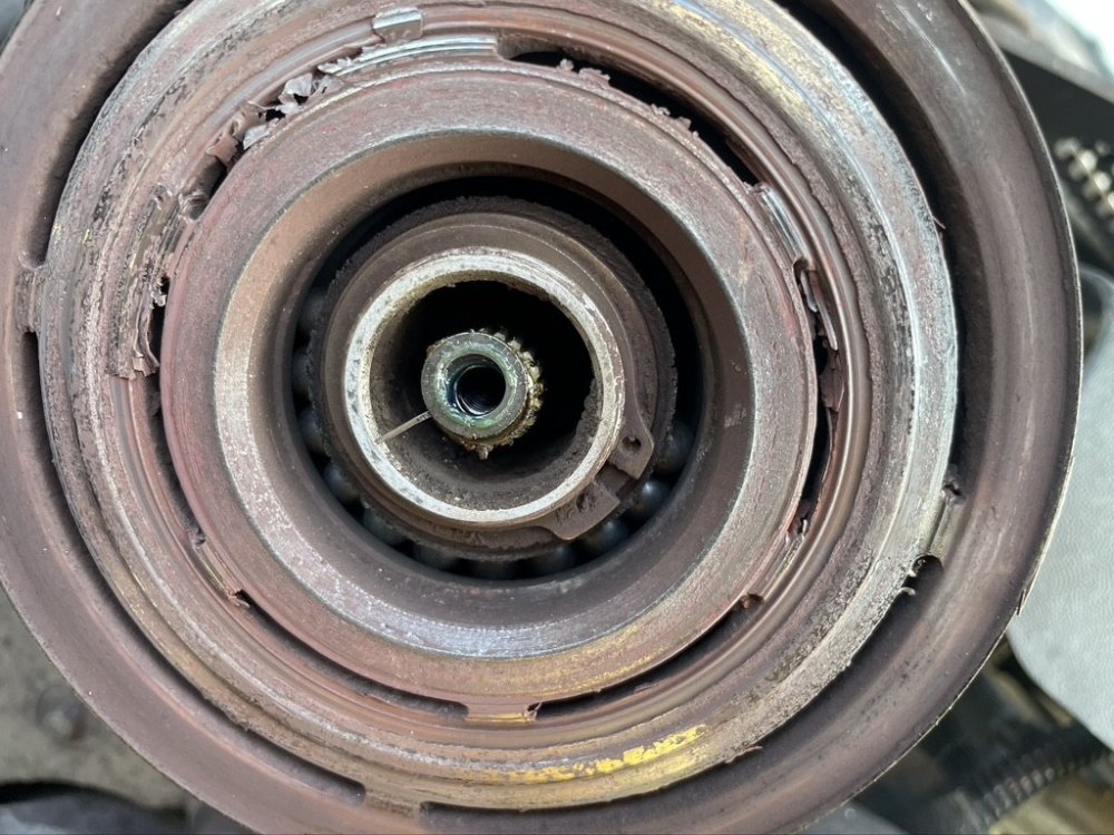

And I wound up replacing the compressor. The clutch I ordered was the wrong size. Ordering the right one online would take about a week to arrive and I didn't want to have it down that long. A clutch from the local parts store was $105, whole compressor was $170 so I went that route. One of the idler pulley bearings sounded a bit dry so I put some oil into it to make it happy for now, but will order a new one.
Wear, or too much air gap, is always the cause for one not engaging when hot. Heat increases resistance so it decreases the magnetivity and eventually it can't pull the clutch plate because it's too far away. The quick fix is to give it a tap with the AC on to get it to grab, but next time it cycles off you're stuck again. The longer term fix is to reduce the gap, I've done this on a few. If you take the center screw off and remove the plate there's a shim/small washer between the plate and compressor clutch. You can sometimes just remove it, but sometimes that'll make it too tight and you'll need a thinner shim.
It's Ford brand so it might have been original.
I coulda just re-greased the bearing, but I decided to splurge on a new clutch kit. It's a two row bearing, one row was empty. After pulling it off the rest of the balls fell out. It was so screwed up that I assumed the snout of the clutch was going to be damaged from the bearing overheating/slipping on it, but it's fine so the compressor will live on.

When the compressor fails, no biggie, you just loose AC. In this case the pulley bearing appears to be fucked up. When it's rattly/crunchy and shooting sparks out of it that's usually a bad sign. Luckily the engine is so rattly I can't hear the pulley from inside so all's good. And after oiling it the smell of molten metal went away.

Q: How long after your AC clutch/pulley starts showing signs of issues does it take a total shit? On my way to AZ Thursday the AC suddenly stopped working right after my second stop to change a trailer tire...ugghh. It was only about 105 degrees 😑 Next day it seemed to be working fine so I figured I'd overcharged it and when the temp got high enough it was kicking off the clutch. Today on my way home as the temps hit about 100-102 it stopped again so I planned on letting some refrigerant out at my fuel stop. I popped the hood with the engine running to see if the clutch was cycling and it wasn't, but it was making a fun show of noise and sparks, even with the AC off. I dribbled some oil into both ends hoping it would help get me close enough to home for my free towing coverage and motored on. The temp got to 115 according to the gauge, but it didn't actually feel as horrible as it sounds. I made two more stops along the way, one to swap a front tire that was threatening to come appart, and I dribbled a bit of oil into the pulley each time. No idea if it got to where it needed to be to help anything, but I figured it would't make things worse....other than maybe catching fire then the insurance company would have to deal with it. It made it home, really surprised the bearing didn't seize/disintegrate along the way. The other front tire started wobbling not terribly long after the first one, it also made it home. Cheap tires, not a lot of miles, but 7 years old; I guess it's time.
