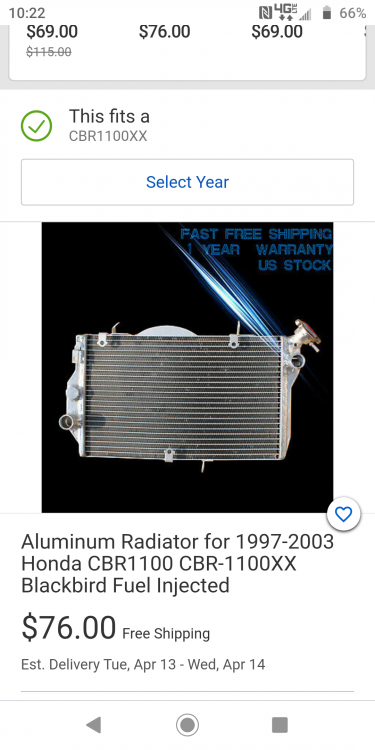

tomek Posted April 7, 2021 Posted April 7, 2021 17 hours ago, XXitanium said: If anyone cares to suggest options, please chime in. Get brand new chinesium radiator from ebay, amazon, etc. They are less than 100 bucks. You can get 8 of them for that quote. The radiator shop will most likely use chinesium core anyway. I would not bother with used oem unit, it is at least 17-18 years old. https://www.ebay.com/itm/Aluminum-Radiator-for-1997-2003-Honda-CBR1100-CBR-1100XX-Blackbird-Fuel-Injected/393236966315?fits=Model%3ACBR1100XX&hash=item5b8ebfebab:g:2KsAAOSwUphgAM9a Quote

JaBr Posted April 9, 2021 Posted April 9, 2021 I paid £45 for a brand new 2 row alloy radiator on eBay, yes it's a china job, but it's way better than the knackered unit I replaced. Even if I only get a few years out of it I'm happy. Being 2 rows it's also better than the standard cooling. Quote
superhawk996 Posted April 11, 2021 Posted April 11, 2021 On 4/9/2021 at 12:49 PM, JaBr said: Being 2 rows it's also better than the standard cooling. You assume. Maybe it is better and maybe it's way shittier. I've seen a few examples of radiator 'upgrades' that were actually a downgrade and had to be replaced immediately because they wouldn't cool enough. If you've already put enough miles on in hot weather to prove that it's an improvement, or at least an adequate replacement, please share your experience and a link for those needing to replace theirs. 1 Quote
tomek Posted April 11, 2021 Posted April 11, 2021 On 4/9/2021 at 2:49 PM, JaBr said: I paid £45 for a brand new 2 row alloy radiator on eBay, yes it's a china job, but it's way better than the knackered unit I replaced. Even if I only get a few years out of it I'm happy. Being 2 rows it's also better than the standard cooling. If inlet and outlet are in stock locations it cannot be possibly 2 row. I've seen pics of those alleged 2 rows on ebay. Those are clearly single pass units. Two row rad would have in and out on the same side. If they are on opposite ends they are single. Or even triple. All that applies to rads with horizontal tubes. Quote

tomek Posted April 11, 2021 Posted April 11, 2021 1 hour ago, superhawk996 said: The number of rows has absolutely nothing to do with the positioning of inlet/outlets regardless if they have vertical or horizontal tubes. I was thinking about passes. Lol. I looked at the pic of rad on ebay and realized it cannot be possibly dual pass. That was before my second coffee for the day. Apologies. And yes, all marketing claims have to be verified. Let's say thicker rad is suppose to cool better but perhaps is is gonna choke the airflow thru the core and the end result will be not so great. Same with dual and triple pass. It depends on water pump capabilities and so on. Quote
superhawk996 Posted April 12, 2021 Posted April 12, 2021 I had a passing thought that you were thinking passes instead of just rows. And to add to the rest of all this, a wide single row might do better than two narrower rows. Material type and thickness, row spacing, heat sinking.... There's just no way to say that a two row is better than a one. A friend of mine recently had me replace the radiator in his Cherokee XJ with an all aluminum "high performance" rad thinking it would be an improvement. From looking at it I had serious doubts and told him he should just return it, but he was convinced it was great so I installed it. It overheated constantly. I replaced it with a cheapo stock replacement plastic/aluminum rad from Oreilly and all was good again. Quote
