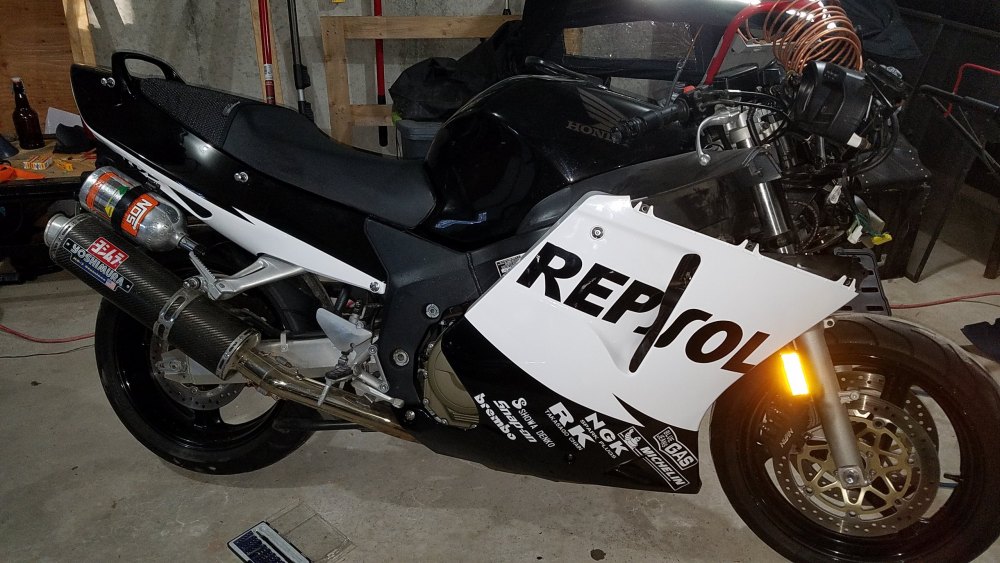

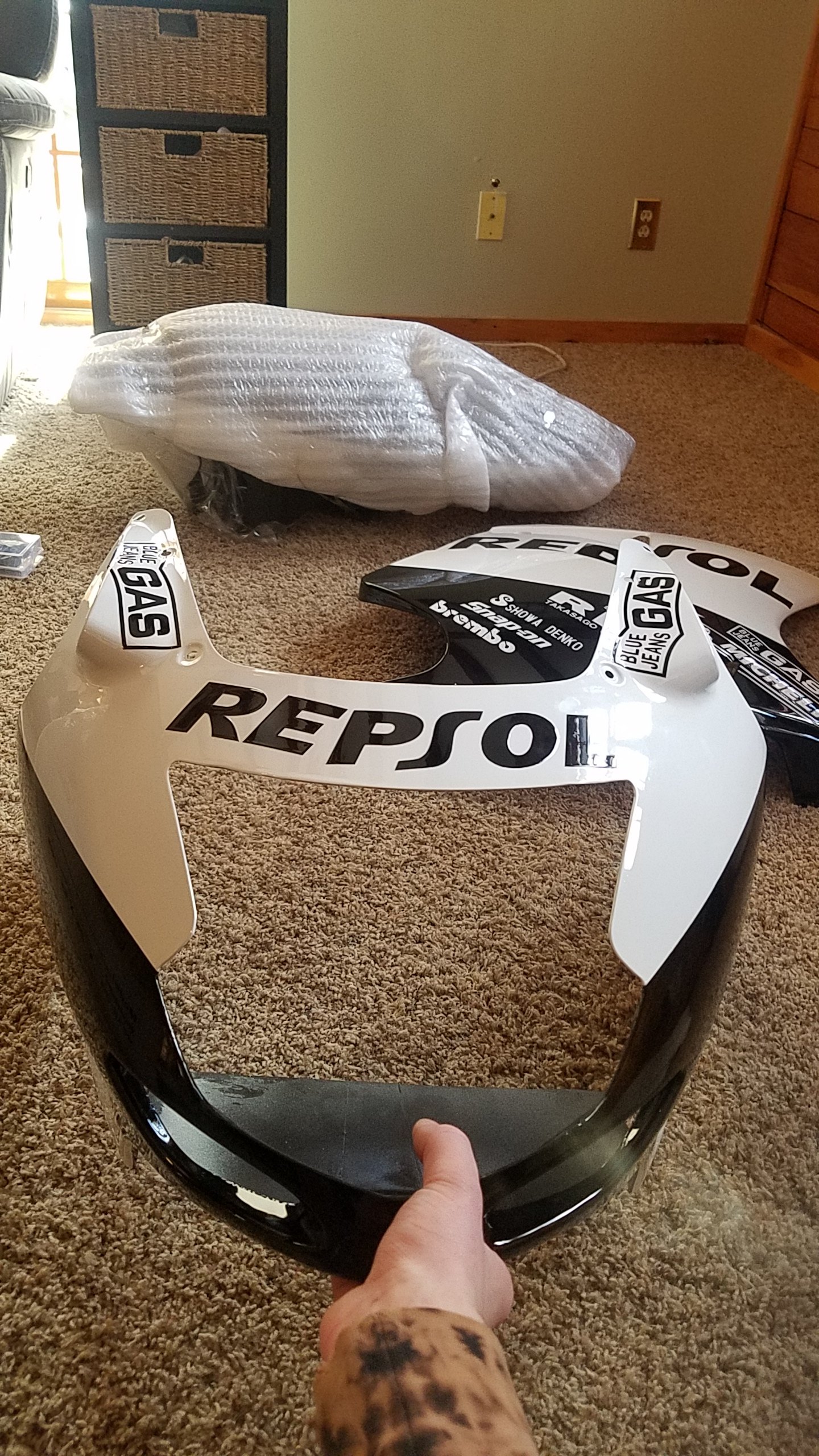

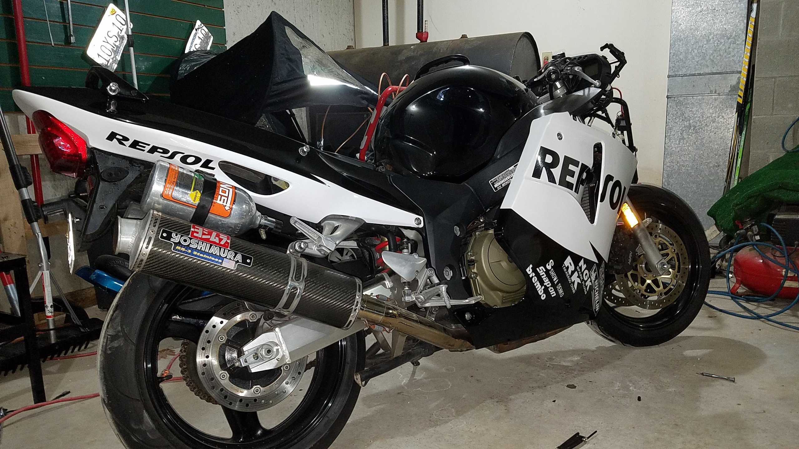

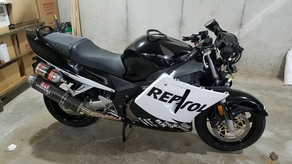

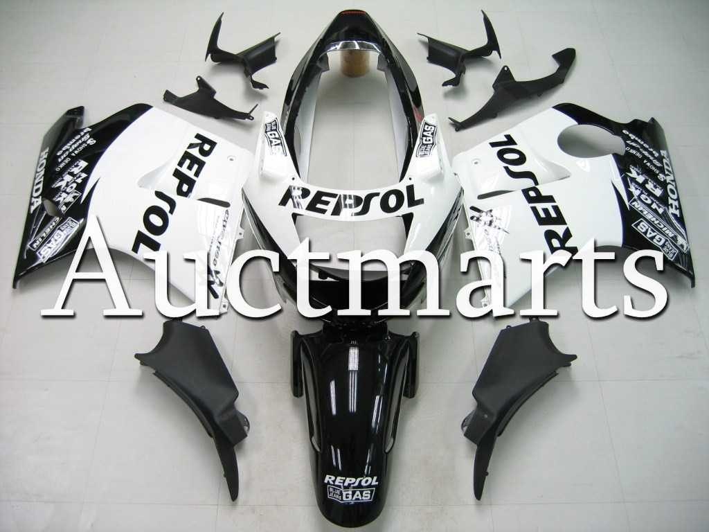

Crashedbirb Posted January 29, 2020 Posted January 29, 2020 (edited) So I've been working in my blackbird ever since I got in an accident in August, i finally got around to buying new fairings and i loved the look of the Repsol Black/White ones auctmarts did. I ordered them and the whole process took around 3 weeks, when they sent me the photo showing them completed before being sent out I noticed the Repsol on the nose was crooked but assured me that it wasnt. So I let it be and to wait for them to come in. They came in 2 days ago and I'm a little annoyed since everything else looks great. I'm in love with them except for the crooked repsol on the nose is bothering me horribly, I contacted them and they said it isnt a work of art and can't be perfect. I'll stick with them since I already paid and returning would cost nearly $200 I dont have. I wonder if i could sand the clear coat, remove the stickers, apply a new one and clear coat over it again. Edited January 29, 2020 by Crashedbirb Typo Quote

Zero Knievel Posted January 29, 2020 Posted January 29, 2020 Yeah...sale photo looks like decal was cut with a curve to fit (or a lot of care was used in application) and yours was cut straight and cut to fit. If you’re good with sanding and painting, I suppose you could redo it as long as you find someone willing to recut that decal so it fits properly. At least white is an easy color to match. Quote

superhawk996 Posted January 29, 2020 Posted January 29, 2020 5 hours ago, Crashedbirb said: Fuck you, your manager, your handle grips, and the blind fuck that put this decal on, just send me what you advertise. I would state it more nicely since the next step would probably be to open a dispute. The Repsol in the ad photo is not only straight, it's larger. I'd go with either size but I think the larger one looks better, but maybe only because it's not fucked up. They fucked up, you specifically questioned that fuck up before they sent it, they said it wasn't fucked up so there's no reason you should have to pay for them to fix their fuck up. Since you said "white is easy" I assume you're either real good at this kinda stuff or naive, because you're questioning it I'm leaning towards the latter. I don't know that I'd be able to fix it well so I wouldn't accept it. If you know you can fix it and feel that fixing it is less hassle then I get it. If you're only going that route because you think you have no option other than paying $200 to get it corrected you're probably wrong. Once you work on it I'm guessing you'll have no recourse, unless you communicate that first and they agree. Quote

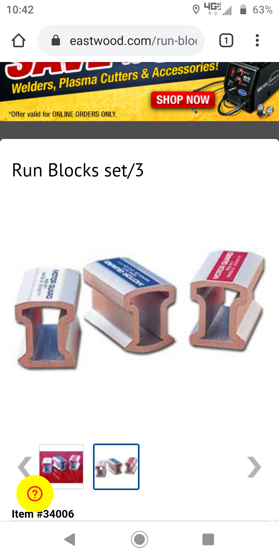

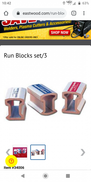

tomek Posted January 29, 2020 Posted January 29, 2020 (edited) If you wanna remove that sticker and clear coat it later here is what you gotta do. Btw, removing stickers first and then trying tp get rid of the clear coat edge is, well, retarded. Get some sort of sanding block, something like in the picture. Mix some warm water with soap and throw couple sheets of wet or dry 600 sand paper in it for 10-15 minues. Cut each sheet into 4 pieces. Wrap sand paper around your sanding block, and start sanding along the edges of each sticker. Keep things wet. Stop when the edge of the sticker starts to disappear. You have to be very careful not to overdo. Remove the sticker. Hopefully it will come off nice and clean. Edited January 29, 2020 by tomek Quote
