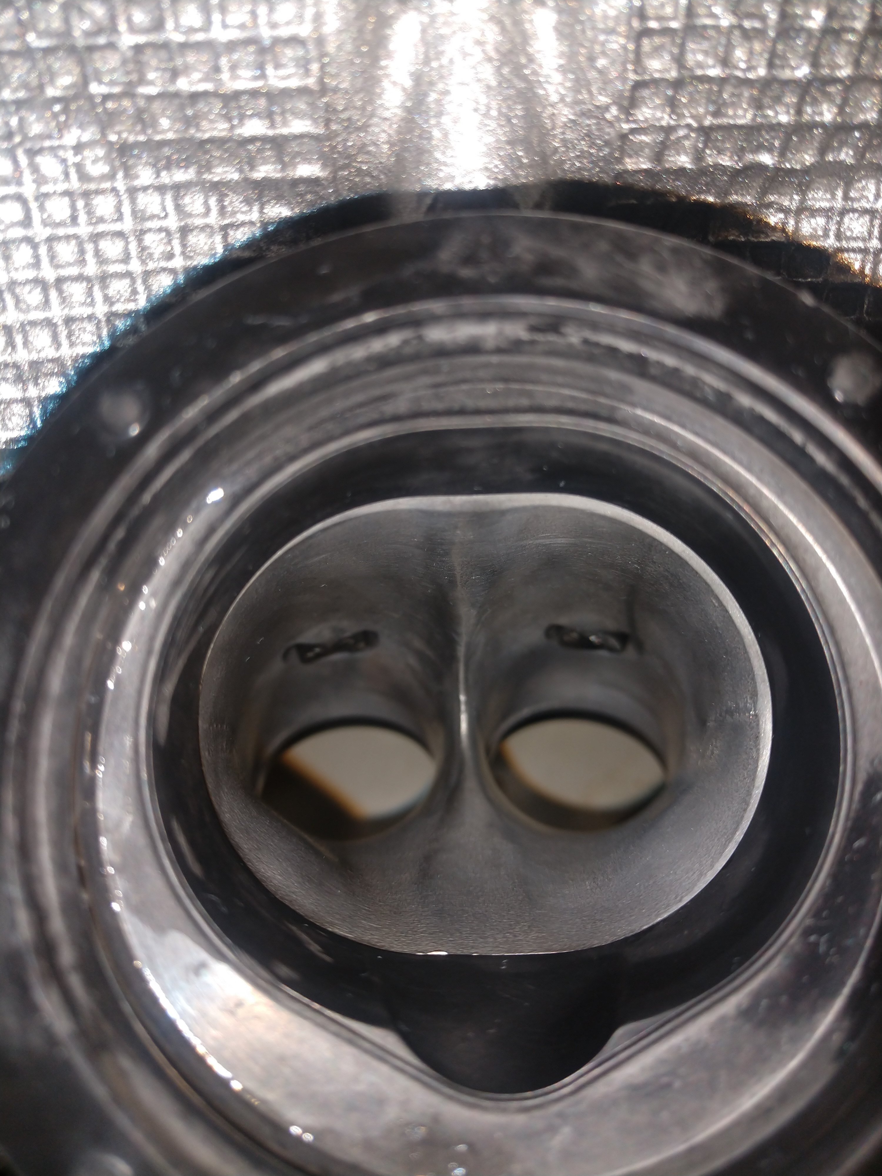

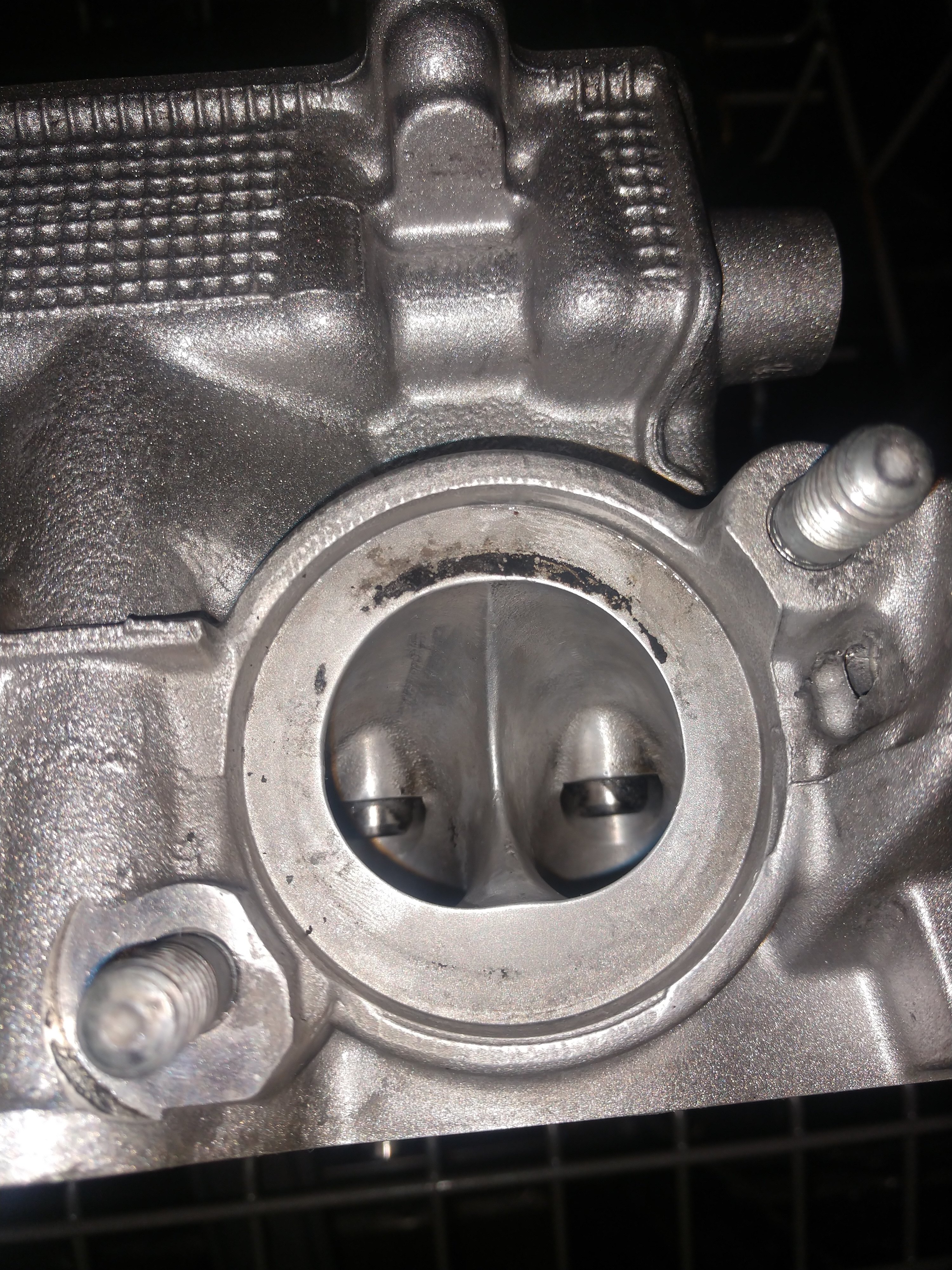

tomek Posted February 1, 2020 Author Posted February 1, 2020 (edited) The head is done, getting final wash in, well, dishwasher. Nothing major was done, just sharpened dividers and blended valve guides on intake side. Intakes and exhaust were kind of polished with equivalen of 600 finish. On exhaust side the idea is to eliminate or slow down carbon build up. Before someone points out need of much corser finish on intake walls, it was true for carb and street engines to enhance fuel evaporation. But that is race only, late generation fuel injection engine. If it is less then 70 deg I won't ride it. Interestingly enough exhaust ports are smaller vs 2004-2008 r1 even though the cylinder bores are 2mm bigger. About 6 hrs of labor, should be good for about 2.65 hp gain.😁 Edited February 1, 2020 by tomek 1 Quote
blackhawkxx Posted February 1, 2020 Posted February 1, 2020 It might just be the camera angle but in the first pic the empty stud hole doesn't look round. It would be cool to have your own dyno and test before and after mods. Quote

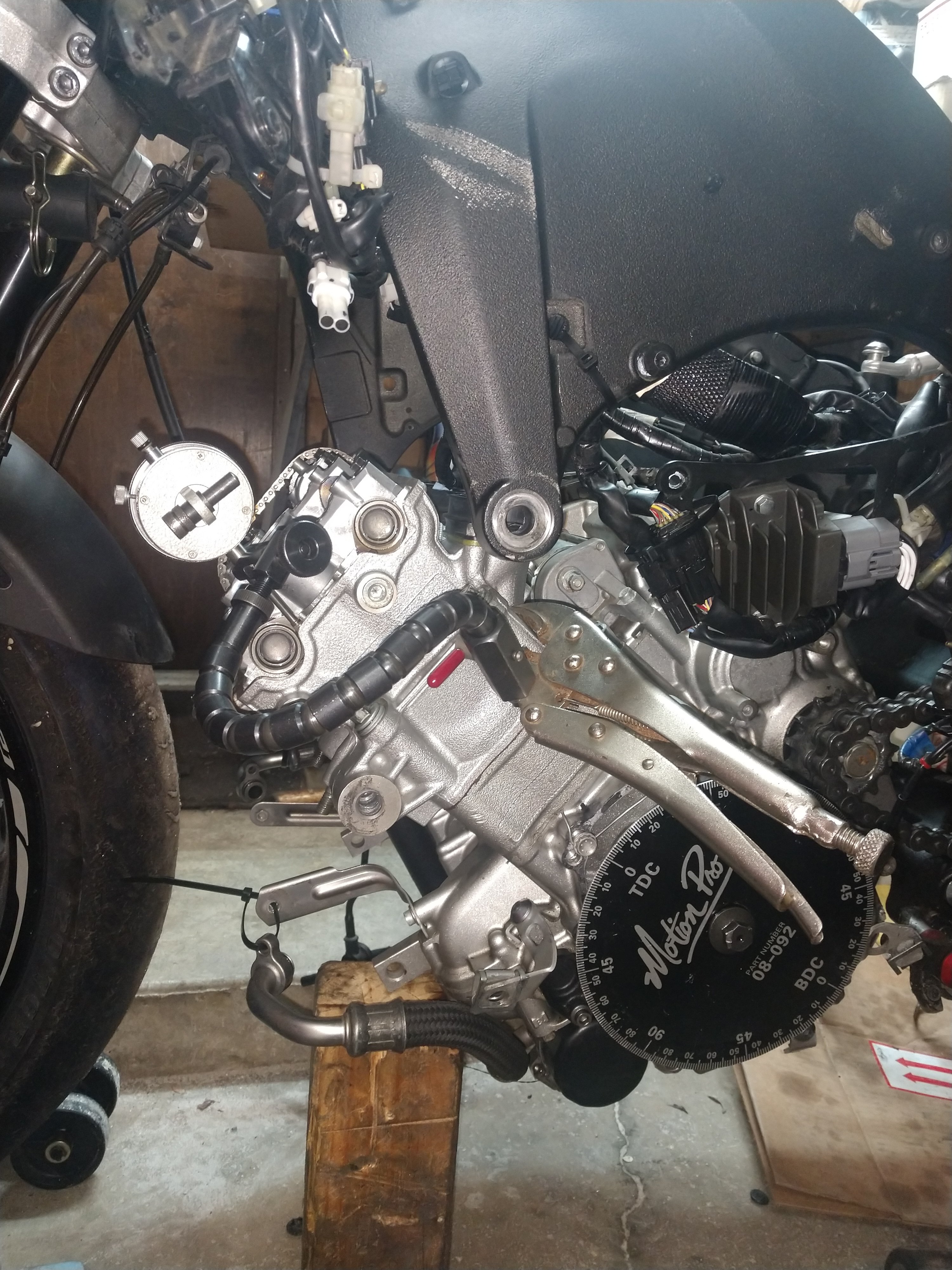

tomek Posted February 6, 2020 Author Posted February 6, 2020 Slow progress, but progress. Dropped head and checked cam timing. It has not moved since last time. I run them in 2 degree retarded position. In 2 deg advance there was too much drive upsetting punch around 11 k rpm, but it would fall on its face over 13 k. Now it is nice and flat, and pulls all the way well into 14 k plus. horsepower in the can. maxima 530rr oil. Good for dyno proven 2-3 hp. Got deal on 5 gallons bucket. Quote

tomek Posted February 15, 2020 Author Posted February 15, 2020 We all know that`s slapper trolling, 5 years old transmitting from their mother`s basement behave like that. But it also could have been legit question. No, there was not plastic floating around the engine waiting to block oil pick up. However there where tale tale signs of cam chain on rather loose side. Manual tensioner. I`ve never had those issues on conventional inline 4s, but on cross-plane crank 4 cam lobes are not symmetrical. There are really strong pulses in cam drive and apparently chain has to be really tight. How tight ? I don`t know. Would have to ask Graves or Attack Racing. Anyway, I waved surrender flag, mourned over 0.264 hp loss due to increased friction, and reinstalled OEM tensioner. Quote
