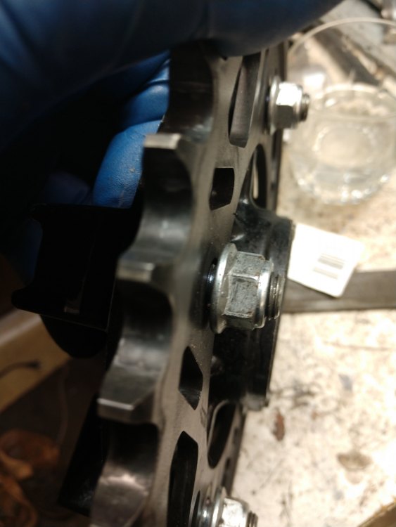

tomek Posted January 21, 2020 Author Posted January 21, 2020 (edited) From wtf department. Backed out sprocket studs. never seen anything like that before. I mean tire has two days, so it happened recently, there is no way I would have missed that when fresh rubber was put on. Post mortem revealed no oem treadlock. Weird. Edited January 21, 2020 by tomek Quote

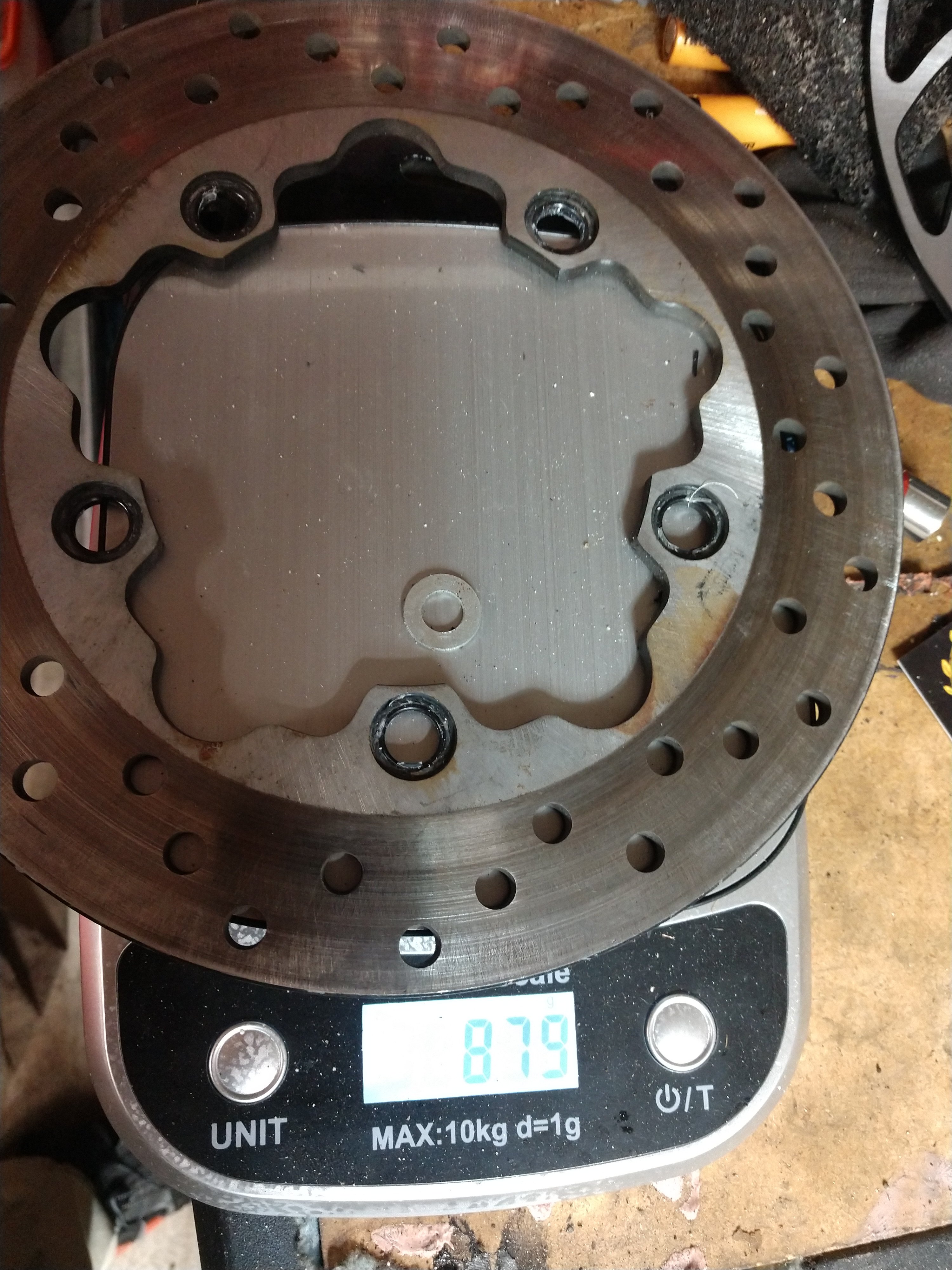

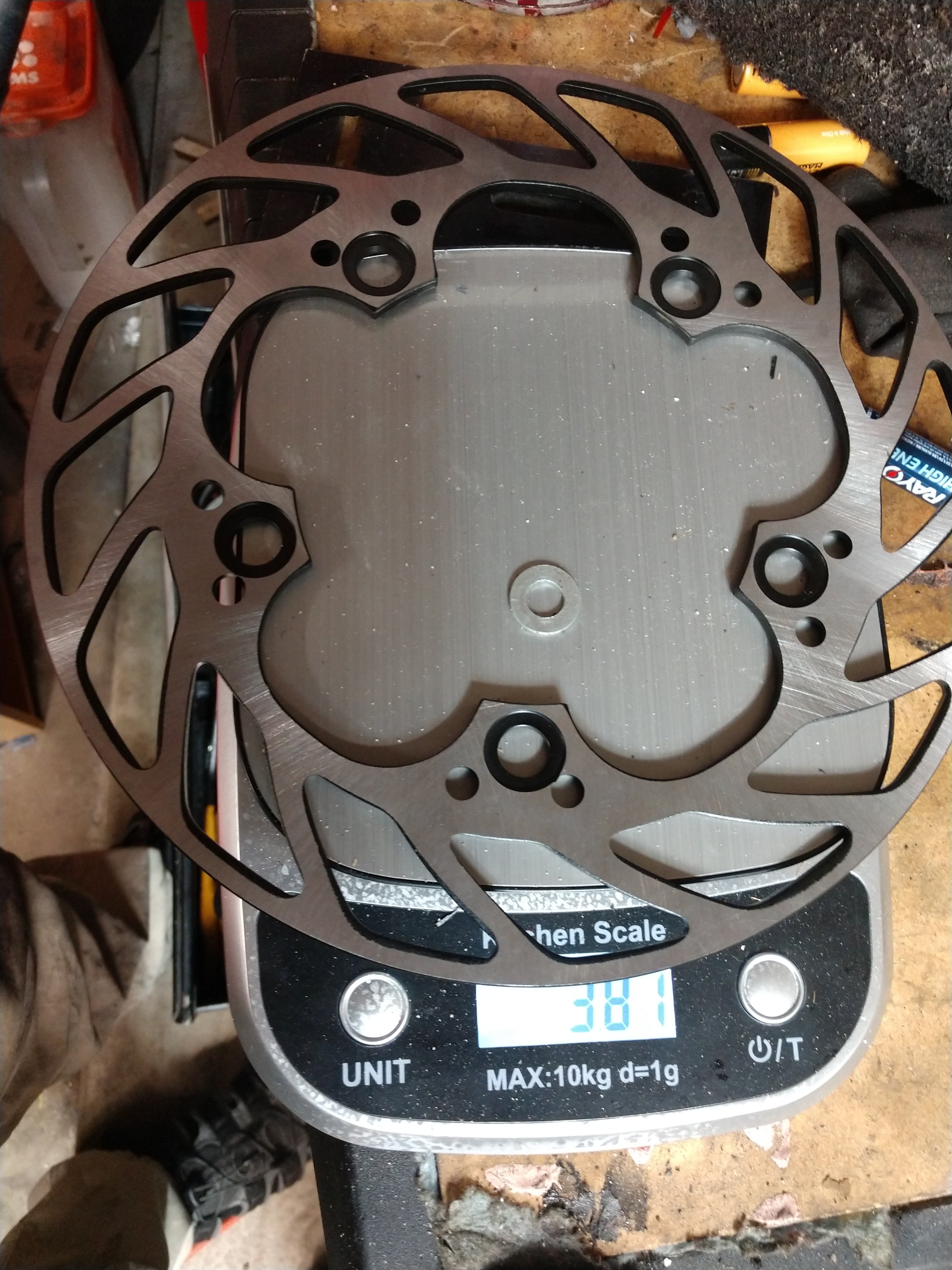

tomek Posted January 21, 2020 Author Posted January 21, 2020 Real weight savings vs. fake like supersprox. i use rear brake about 1-2 times per year, so who cares what is there. Cool 1.1 pounds lighter than stock. Quote

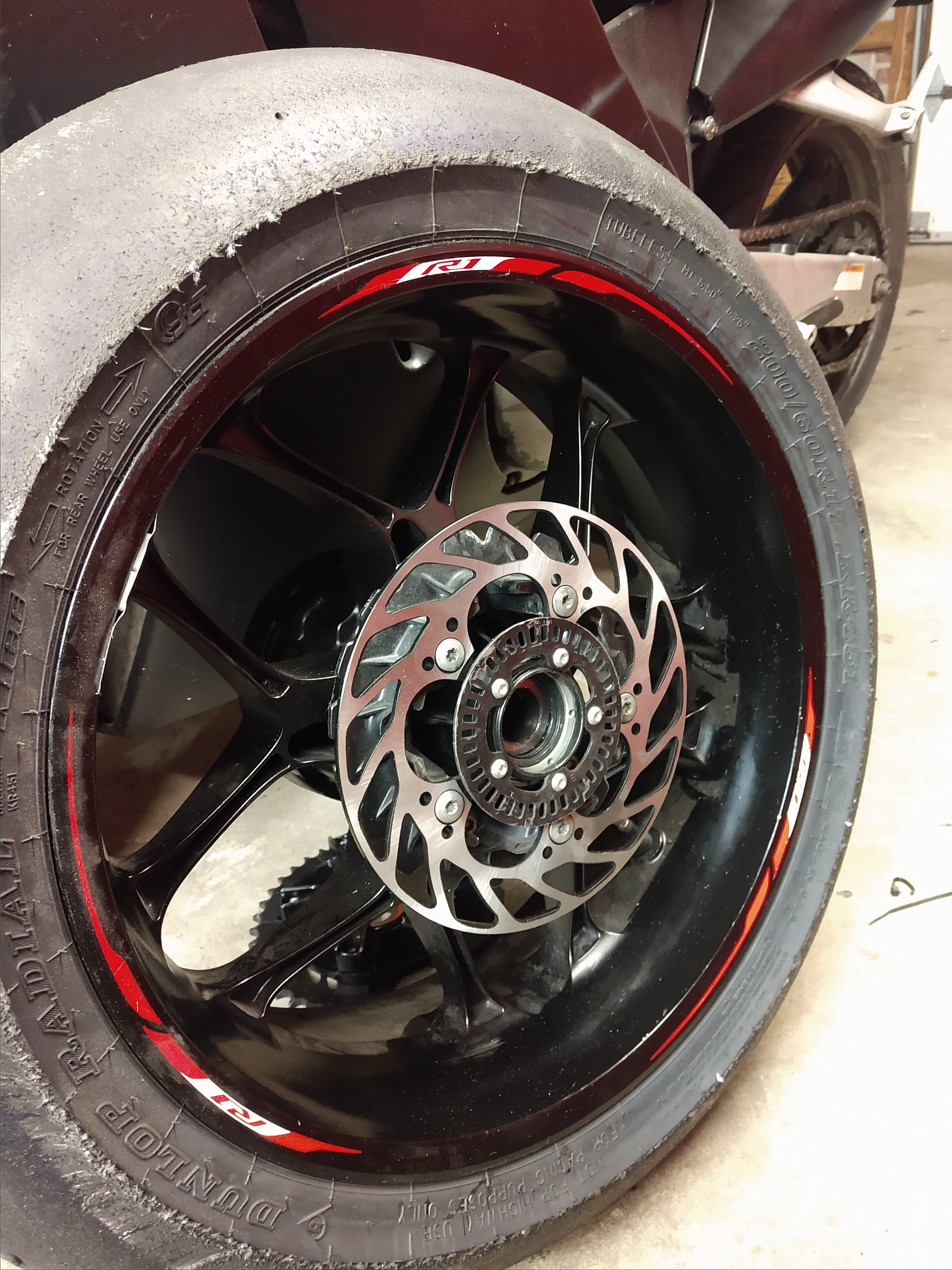

tomek Posted January 21, 2020 Author Posted January 21, 2020 And it looks like that mounted on the wheel. Pure porn. 1 Quote
superhawk996 Posted January 21, 2020 Posted January 21, 2020 It's sexy and scary looking. I know you don't normally use it, but I'd love to know how it compares in braking. Quote
jon haney Posted January 21, 2020 Posted January 21, 2020 1 hour ago, superhawk996 said: It's sexy and scary looking. I know you don't normally use it, but I'd love to know how it compares in braking. It doesn't, but if you're hard on the fronts, the rear is likely off the pavement anyway. My guess is, it also allows greater control of rear trail-braking. See these skeleton rotors on a whole lot of drag bikes. Quote
superhawk996 Posted January 22, 2020 Posted January 22, 2020 Do you think it would be viable for a street bike that's not used much? I assume the only issues would be that it won't last long and that it could overheat fast in heavy use, but it's so far from a 'normal' rotor that I don't know what to expect from it. Quote
blackhawkxx Posted January 22, 2020 Posted January 22, 2020 10 minutes ago, superhawk996 said: Do you think it would be viable for a street bike that's not used much? I assume the only issues would be that it won't last long and that it could overheat fast in heavy use, but it's so far from a 'normal' rotor that I don't know what to expect from it. Why would you want it for street use? Just for looks? On the tire, I have never seen a rotation direction arrow point both ways but than I never had a bike slick. Quote
superhawk996 Posted January 22, 2020 Posted January 22, 2020 Just now, blackhawkxx said: Why would you want it for street use? Just for looks? Pretty much. The weight loss is a nice bonus. Quote
