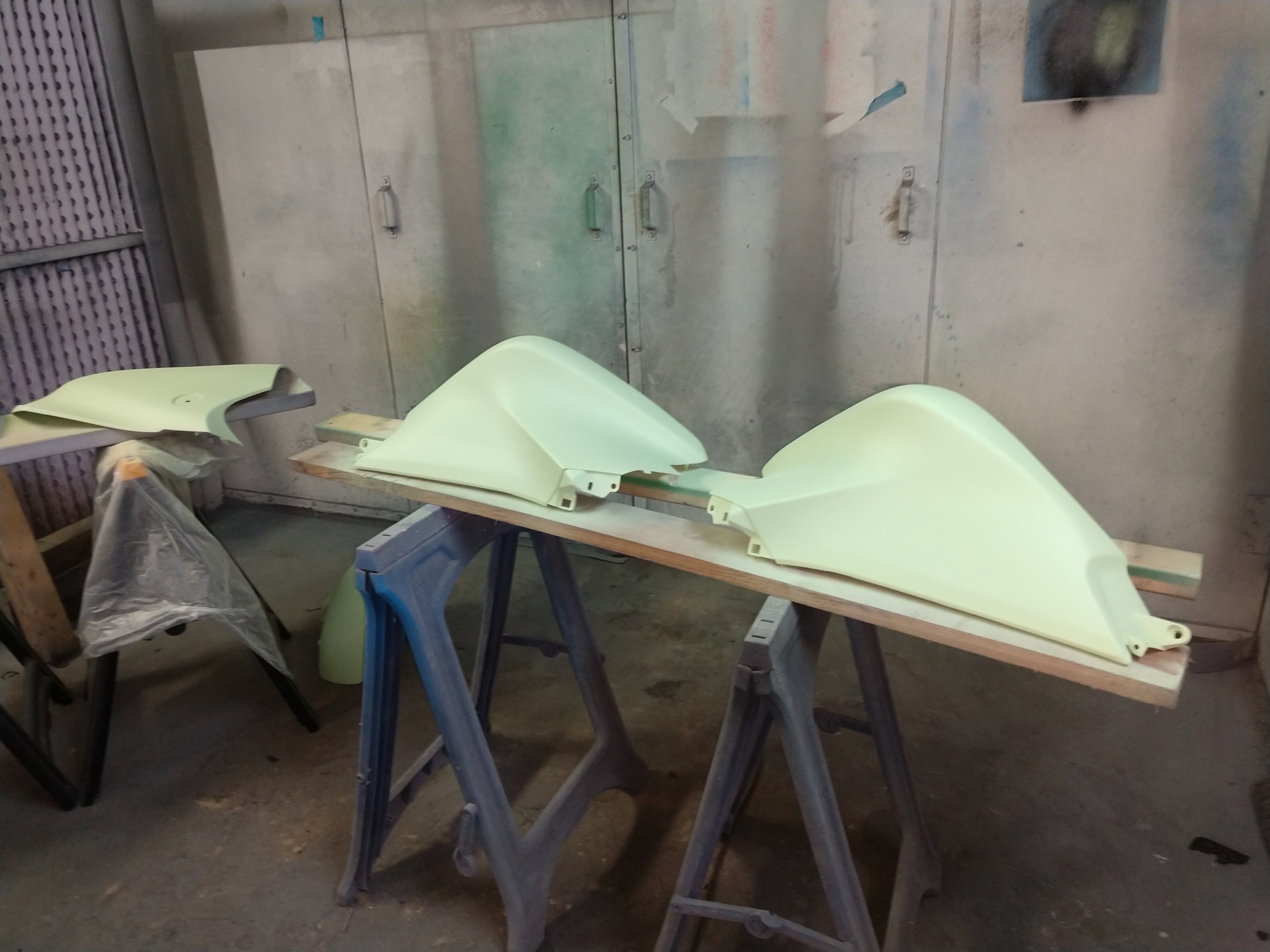

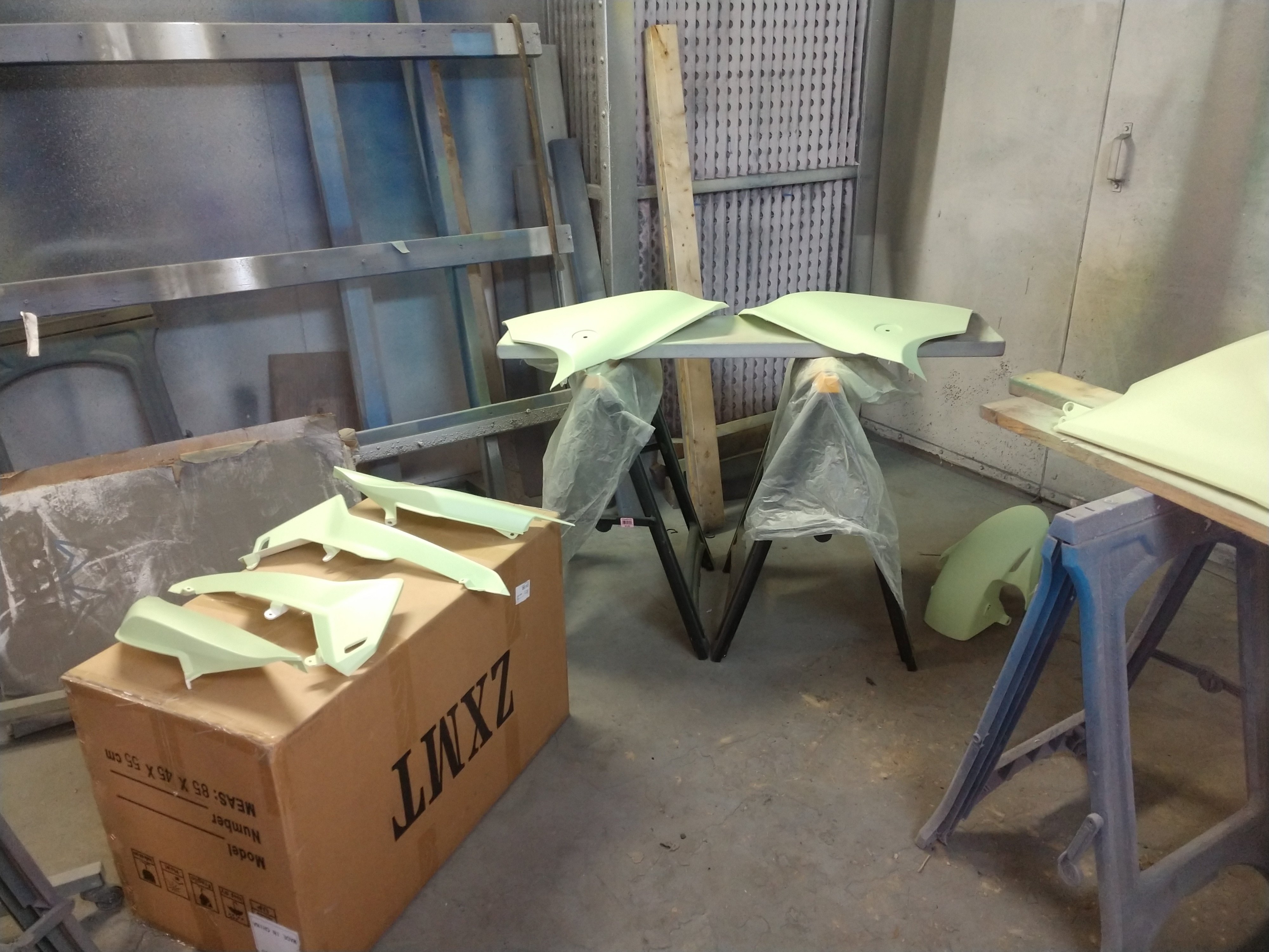

Well, the project has not been abondoned. Finally have pulled my head of the ass and primed ebay plastics. I've used POS- according to one expert here- House of Kolor kp2cfa primer. Devillbiss finishline primer gun, 1.8 mm tip, 30 psi at the gun with trigger pulled.
It is gonna be two color paint job, silver will be replaced with HOK platinum pearl, red - custom kandy mix of oriental blue and teal over silver base. There will be graphics under candy.
3M has very nice line of sand papers- cubitron. It is the shit, lasts very long and cuts extremely well. Time saver, I've used 320+ grid for primer.
Those 4 large pieces (sides and tank covers) were laying as in  pictures. Small ones, I grab them by mounting tab, etc. and just spray like that. It was just primer, so some dust and  finger print on hidden area won't matter.
It is gonna take more way careful arrangement to color and clear coat.
I don't like to hang fairings because they won't stand still - the mixture of paint and air hits them pretty hard. When shooting pearls, candies and metallics proper 6 inches gun to the painted surface is absolutely critical.
I usually  run thick wire between tabs on the back side and use it as a grab handle.

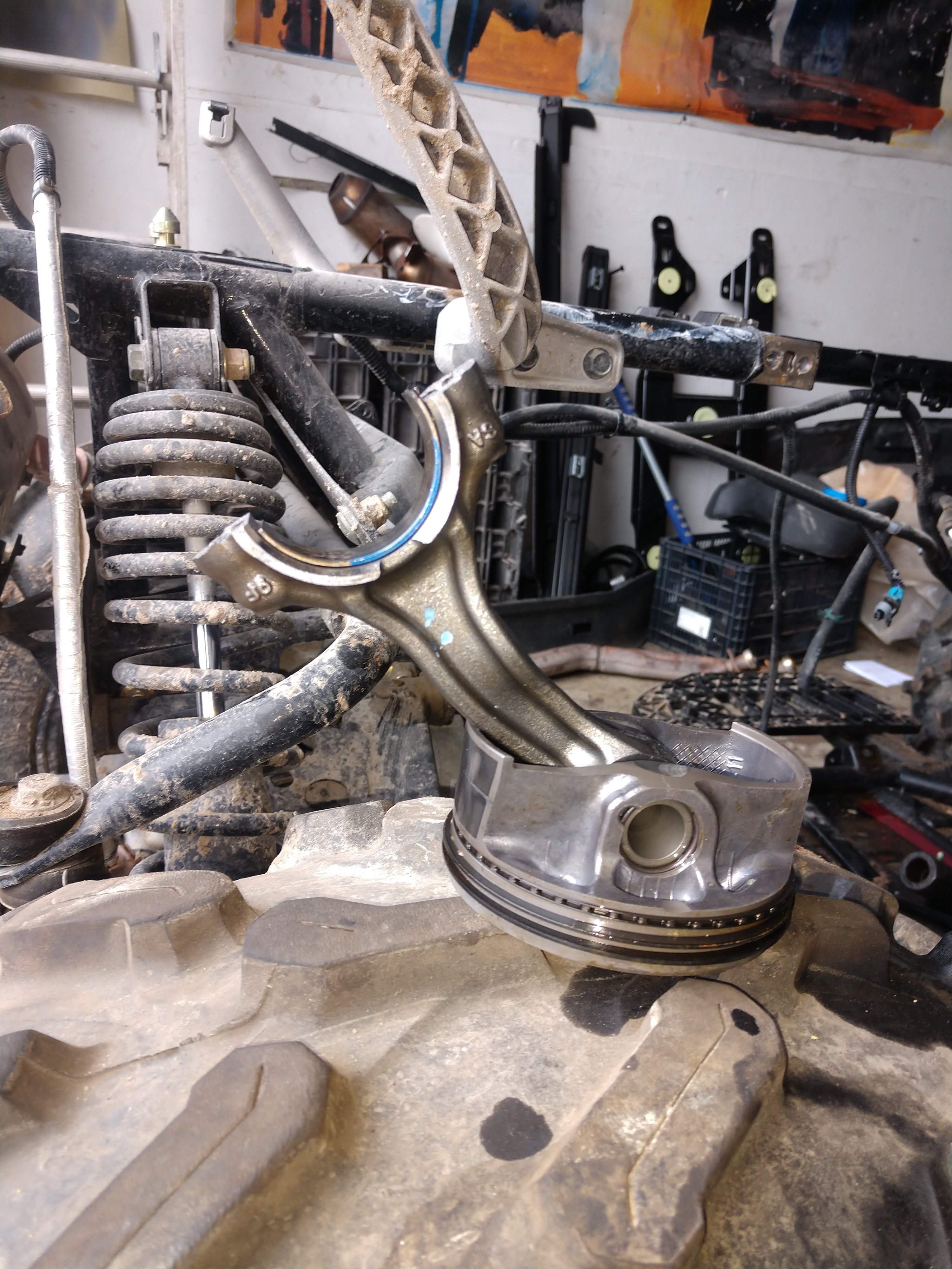

Spray booth is not quite free. I have to deal now with this.😁
Keep updating with the paint stories.  A paint booth is a great help even if it cost you some work.  I painted a truck in my garage one time, never again.
BTW- a Cuban could straighten that rod. 😁
