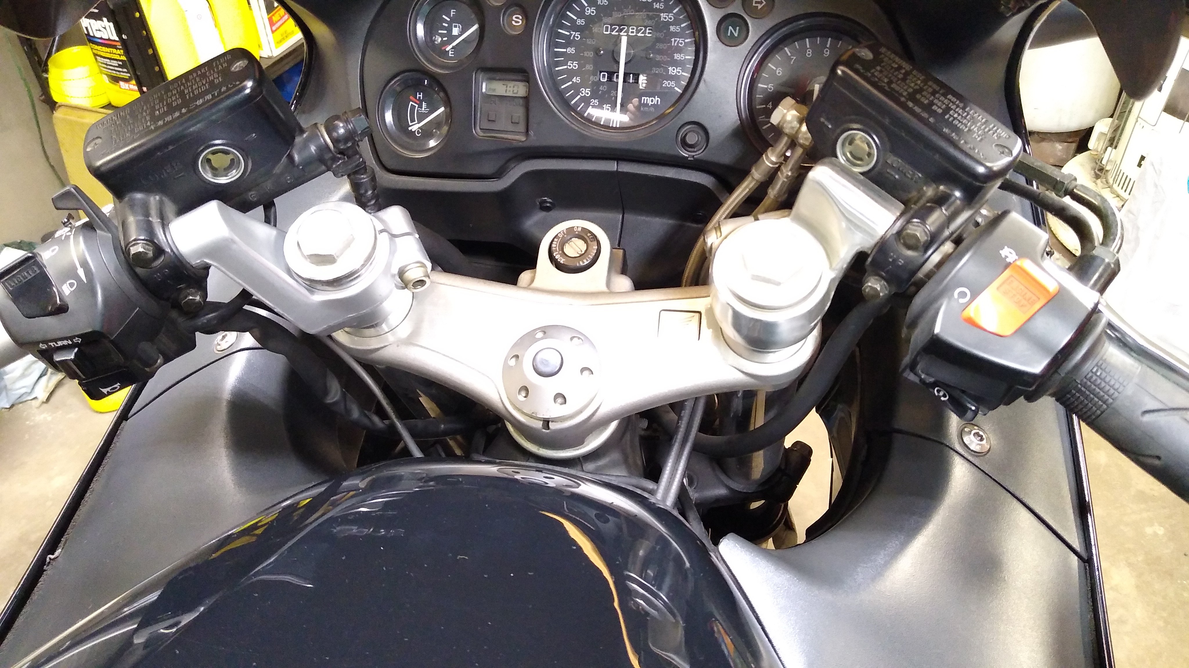

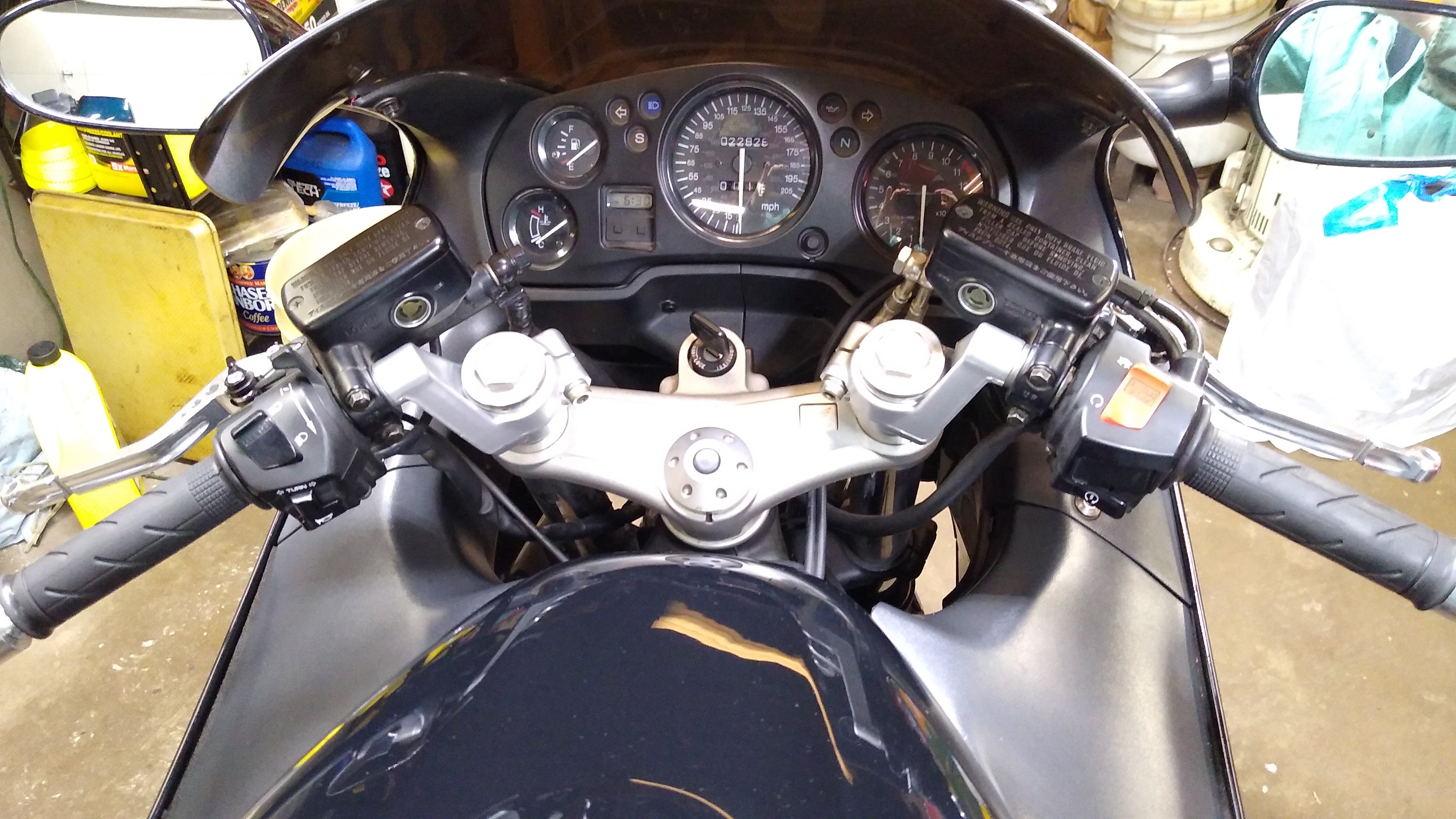

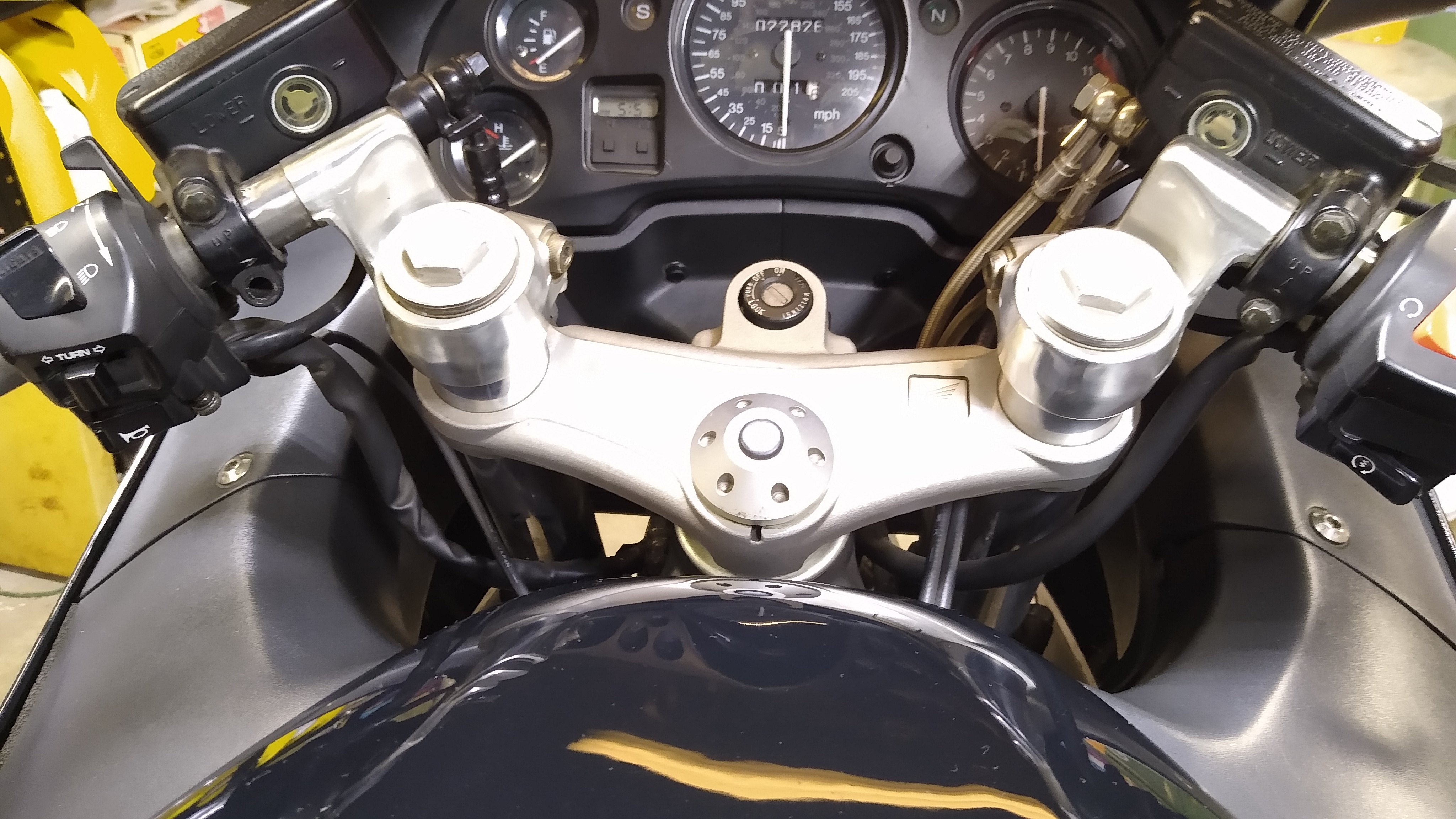

blackhawkxx Posted November 1, 2019 Posted November 1, 2019 The actual install is easy (getting the bar weights out was a little bit of a pain) but the details of getting everything just how you want is another thing. My bike is lowered a inch so that made some things harder. The clutch hose is at max stretch, I will see how it goes but I may be able to gain a little more reach or replace with braided. Where the terminals for the brake light go on the master is really tight but should work. My brake hoses is OK because they are braided and the bike being lowered helps reach. The weather went from super nice Tuesday to crap into the near future so don't look for a ride report until next year. Blackbird bars, just started to remove: One of each: Almost done: 1 Quote
rockmeupto125 Posted November 1, 2019 Posted November 1, 2019 For the clutch, I just take the bolt out of the block next to the steering head. Never noted any difference except I got another inch and a half to work with. 1 3 Quote
superhawk996 Posted November 1, 2019 Posted November 1, 2019 The bike being lowered doesn't reduce the reach of wires/hoses, installing the bars away from the top clamp did that. Quote
blackhawkxx Posted November 1, 2019 Author Posted November 1, 2019 17 minutes ago, superhawk996 said: The bike being lowered doesn't reduce the reach of wires/hoses, installing the bars away from the top clamp did that. On a stock Bird, are the bars near the top of the fork tubes? So the bars stayed in the same place but the bike moved away from them while lowering. I was obviously trying to keep the bars as high as possible. Quote
superhawk996 Posted November 1, 2019 Posted November 1, 2019 I totally understand wanting to get them high. Also, know that I wasn't criticizing you for saying that lowering the bike is what caused the reach problem, just correcting it. It's not a big deal, but someone reading it might think that just lowering causes a problem with the wires/hoses reaching. Quote
