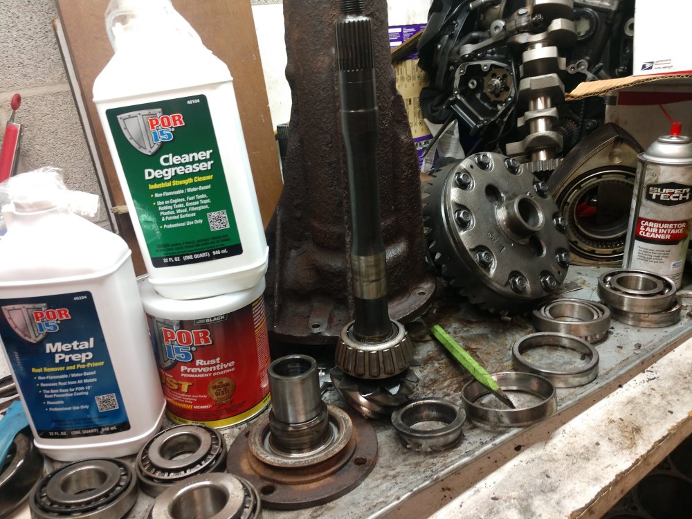

tomek Posted October 23, 2019 Author Posted October 23, 2019 Work bench mess. Im gonna por15 cast iron housing and whatever suspension parts, etc. Quote

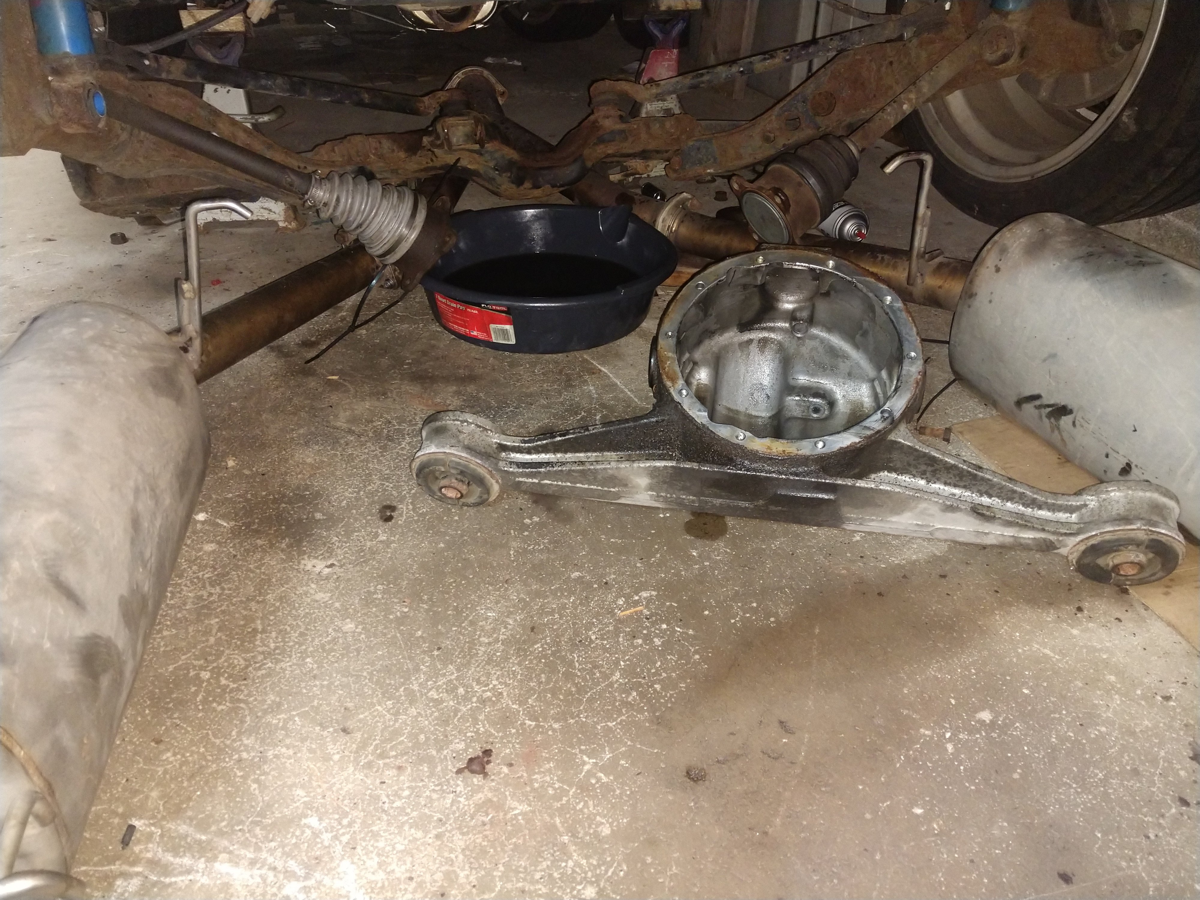

tomek Posted October 23, 2019 Author Posted October 23, 2019 Under the car mess. If weather sucks on Saturday I should be able to put everything back together. If it is nice it is gotta wait. Quote
Furbird Posted October 23, 2019 Posted October 23, 2019 Good grief, could they make the pinion shaft any longer?!? Any reason it's set up like that and not shorter with a longer driveshaft? That car isn't that big, a few more inches and they could have just bolted it directly to the trans! 1 Quote
superhawk996 Posted October 23, 2019 Posted October 23, 2019 I don't see any acetone on the bench; how you gonna clean them parts?!? 😁 Quote
tomek Posted October 23, 2019 Author Posted October 23, 2019 No idea. Next gen rx7 had similar engine block and transmission, longer driveshaft and way more compact differential assembly. superhawk and slapper, both of you are on lifetime ignore, don't waste your time posting. Quote
