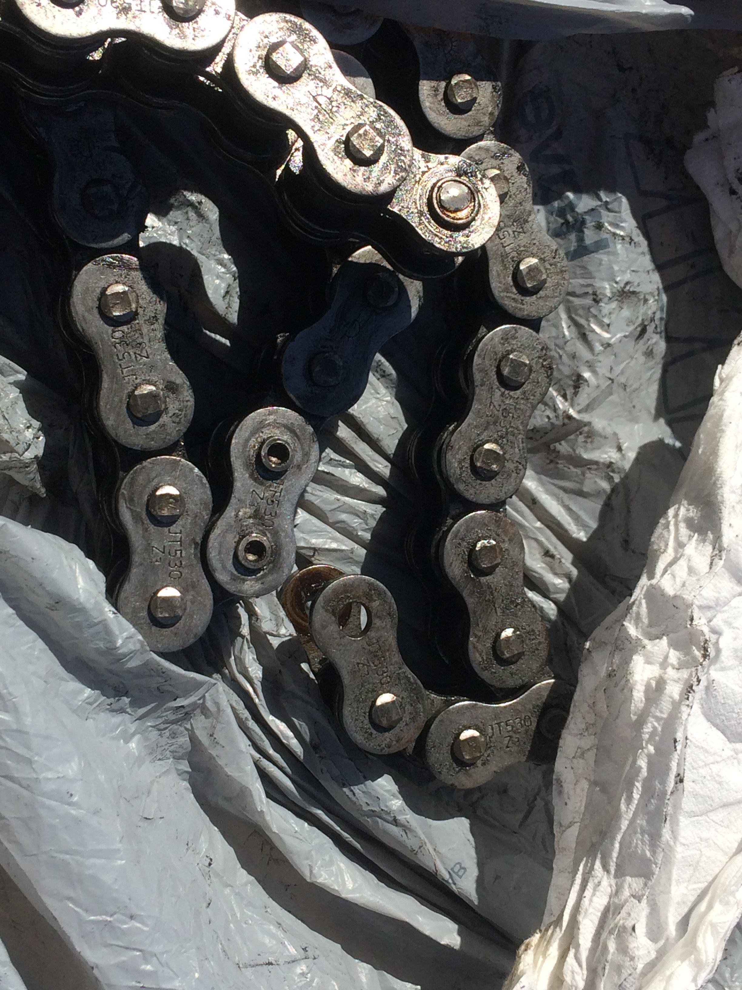

ptxyz Posted September 26, 2019 Author Posted September 26, 2019 (edited) preliminary investigation reveals a sheared factory pin! i'm somewhat relieved it wasn't my master link installation... oh, and it appears to be a jt z3 chain... Edited September 26, 2019 by ptxyz Quote
Furbird Posted September 26, 2019 Posted September 26, 2019 That is fluke of all flukes. I ran a 12/49 combo with a slick on the dragbird and never broke a chain. Definitely a factory flaw. 2 Quote
SwampNut Posted September 26, 2019 Posted September 26, 2019 I would at least make a warranty claim. Quote
tomek Posted September 26, 2019 Posted September 26, 2019 1 hour ago, ptxyz said: preliminary investigation reveals a sheared factory pin! i'm somewhat relieved it wasn't my master link installation... oh, and it appears to be a jt z3 chain... 5 bucks says something got between chain and one of sprockets. Inspect both sprockets. Btw, 16/43 is r1 gearing. 525 chain. 1 Quote

superhawk996 Posted September 27, 2019 Posted September 27, 2019 A 16T adds a bit of pull, the slip & grab of the tire shock loaded it, but I think there was a defect, or maybe it got damaged at some point. If you weren't at full power in first gear we can eliminate the 16T as being a factor. If you were in a higher gear and not near full power the shock load probably would't be as hard as a drag race launch with a sticky tire. I don't know what their warrantee is, but they at least need to know about this in case they've switched materials or there's a new process or something that went bad. Quote
superhawk996 Posted September 27, 2019 Posted September 27, 2019 Whats visible looks weird, not what I'd expect. Is it sticking out on the other side? Quote

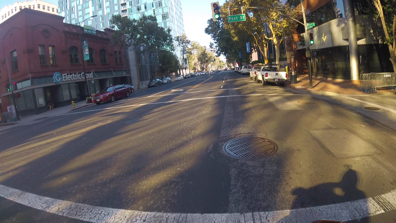

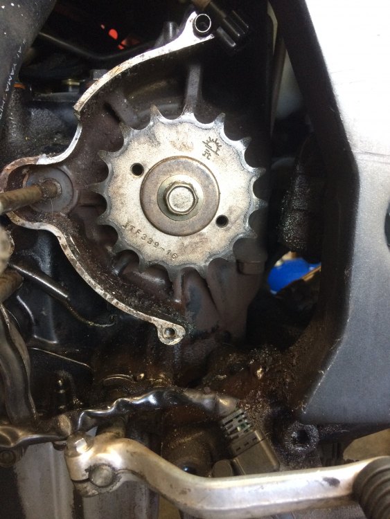

ptxyz Posted September 27, 2019 Author Posted September 27, 2019 (edited) had a close look at the rear sprocket, only damage i can see is from the chain getting caught up between it and the swingarm (locked my rear wheel, that was fun...). sprockets and chain were replaced back in may, not sure of the exact mileage but, not more than a few thousand. one trip to laughlin and 20 mile round trip commutes (shared duty with my klr). watched my gopro footage and don't see any debris on the pavement leading up to this. haven't yet noticed any missing fasteners or debris from me that might have caused this, i'll get a look at the front sprocket this weekend. i'm hoping i just have to replace the chain. other side of the pin looks just like the visible side. appears to be a pretty clean shear. so far, i'm inclined to believe it was the shock of regaining traction suddenly that caused a defective pin to fail. here's a screen grab from my gopro showing that slippery manhole cover... how fortunate work is only about 50-60 yards beyond! "why the hell is that idiot pushing his bike down the sidewalk and through the crosswalk?!" Edited September 27, 2019 by ptxyz Quote

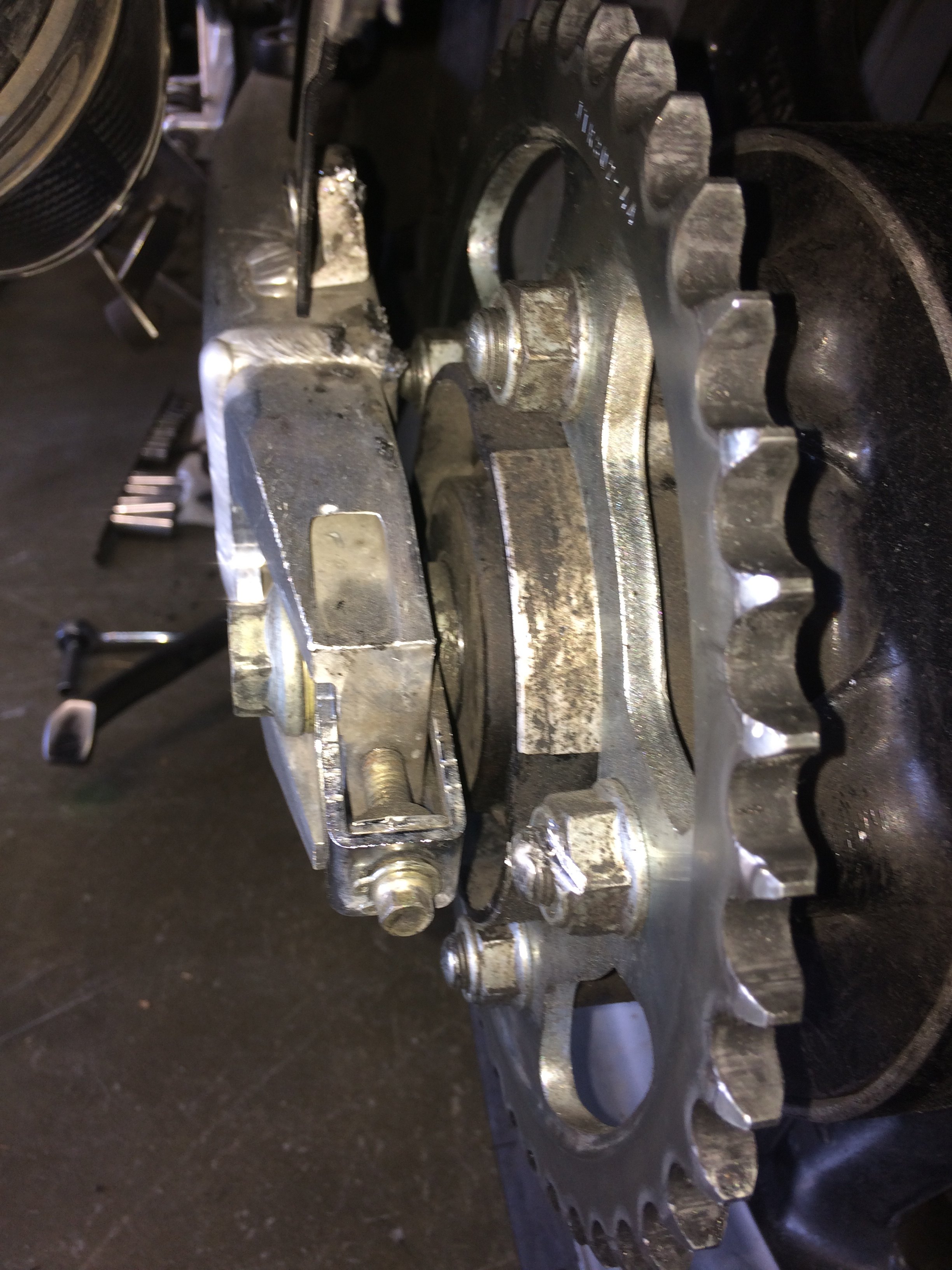

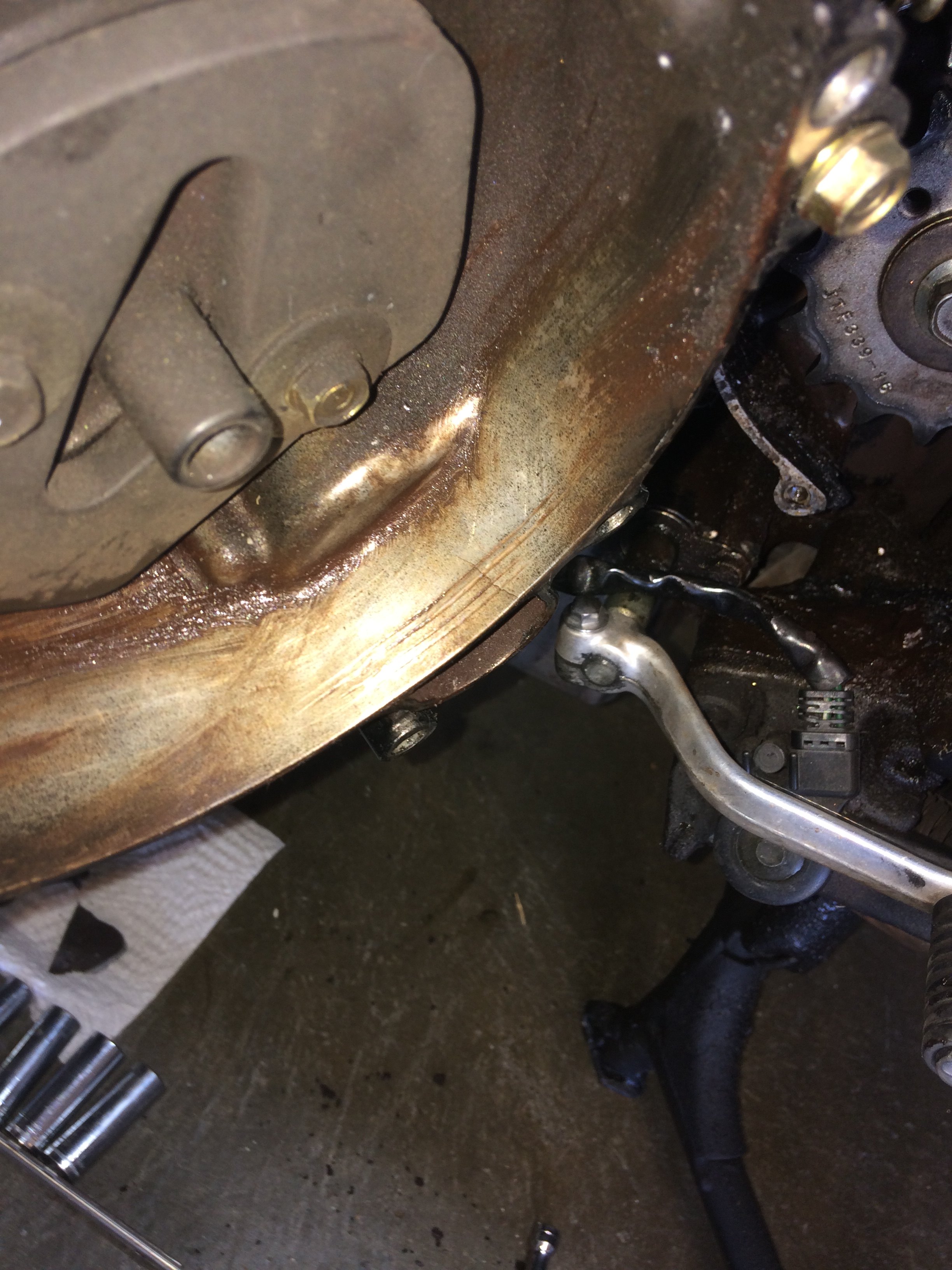

ptxyz Posted September 28, 2019 Author Posted September 28, 2019 just got a better look at the damage... sorry, the rear sprocket damage is kinda blurry. you can see a gouge in the swingarm and one of the nuts. marks from the chain on the sprocket cover's inside. chunk where one of the cover bolts goes broke it's threads out... does the community think the remaining 2 bolts will hold? don't see damage to the sprockets. i'm debating just getting a new good quality chain or should i replace the sprockets too? if i go the later route, i'm thinking spring for a supersprox rear and oem front (17/47). this jt front has a bit more play than i'd like... Quote

jcrich Posted September 28, 2019 Posted September 28, 2019 Lol I do not think you have much choice unless you are going to get a piece welded back on there. Torque them to spec and Blue Loctite them or drill the bolt heads and safety wire them. And clean that sprocket recess out. 😀 Quote
blackhawkxx Posted September 29, 2019 Posted September 29, 2019 And clean the clutch pushrod also. You could try JB Weld, don't think that there would be anything to lose. Quote

jon haney Posted September 30, 2019 Posted September 30, 2019 JB weld is way over-rated, and would never last for this application. I would definitely file a warranty claim, and if you bought the chain and sprockets as a kit, ask them to replace the sprockets, too. There is no way a pin should shear that easily on such a newish chain, even if it was a 520 chain. On the cover, as long as the bolts that hold the clutch slave cylinder are okay (the long ones), you should be fine. Unless, you break another chain, of course. Consider yourself lucky to not have to replace the engine cases. I think that steel spacer Honda uses behind the cover was a good idea, and probably saved you from a much more emotional post. Quote
