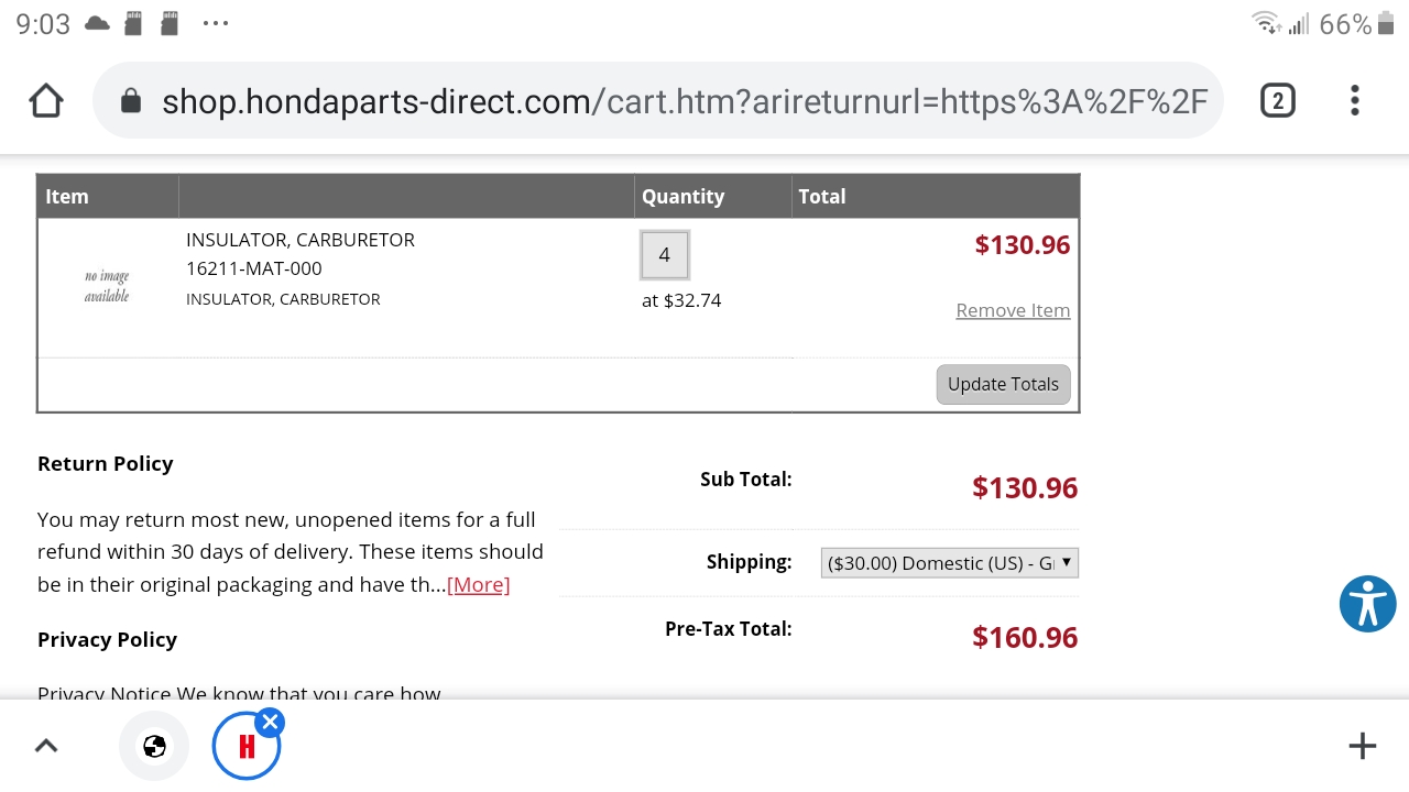

12 hours ago, blackhawkxx said:
I am surprised, it looks as it is available.  #6  I don't know if they are $32.74 for 4 or each?
While $33ea seems a hair steep, I can't imagine them being $8ea.  If they are I'll take a set just in case.
