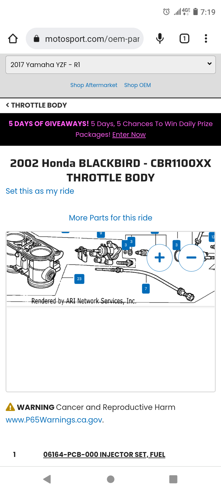

tomek Posted November 14, 2022 Posted November 14, 2022 (edited) Perhaps something as simple as idle speed adjusted too low, that's why I asked. Cold start mechanism. That thing by #3, with pushrod sticking out. You may wanna remove it and clean it very well. Btw, "7" is idle speed adjustment cable. Edited November 14, 2022 by tomek Quote
