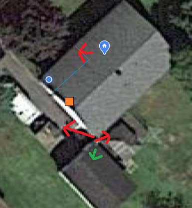

JoWhee Posted May 30, 2020 Posted May 30, 2020 TL;DR any suggestions for a home camera setup? So with the whole lockdown and people losing their minds, someone has been knocking on doors randomly in my hood, egging houses cars etc. I know it's mostly kids/teens and harmless but annoying. I'm thinking about getting a 4-6 camera setup, I was looking at the lorax brand in costco, it's got 6 cameras, and a 1TB HD for storage. I didn't get it because it gets bad reviews. I'd prefer local storage rather than cloud, because I'm a cheap fuck and I don't want to pay a subscription. A doorbell camera wouldn't work for me due to placement. I've got 120V at one corner of the house to catch the driveway and the side door, 120V in the garage for duh the garage. I'd have to get up into the attic to wire a camera up for the front door, not a big deal. Wireless transmitting would be best for me. Probably 4k cameras as opposed to 1080. My budget is around $500 ($350 USD). I haven't made up my mind about anything yet, just looking for opinions on brand, technology, etc... And because I'm a little obsessive, here's a drawing the orange box is my router, and where I'd put the camera NVR/hub the green camera would be in the garage the others would be outside, under a soffit. Quote

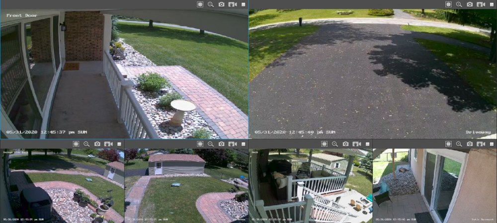

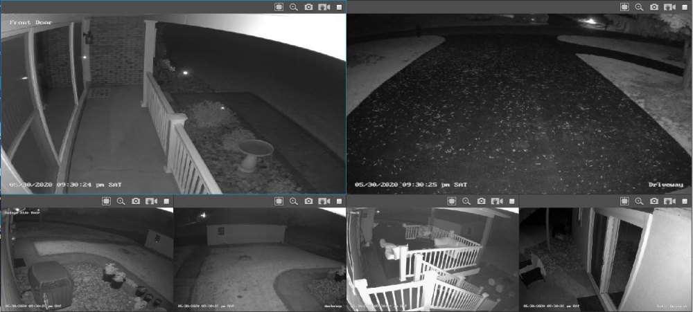

Biometrix Posted May 31, 2020 Posted May 31, 2020 (edited) I put in Reolink system from Amazon. Love it! It came with a 8 Channel Network Video Recorder with a 2TB drive. It's a PoE system so the cameras are powered through the network cables. I ran CAT 6 to 6 cameras that look at every door, my workshop and my driveway. The cameras are 5MP Super HD 2560x1920. I can view them through the NVR, my desktop computer or my phone. All local storage, no cloud, no monthly fees. The NVR with four cameras was on sale for $349 and I bought two more at about $49 each. I think the regular price for the NVR with 4 cameras was about $399. Spent another $100 or so on the CAT 6 cable (I put my own RJ45 connectors on). It actually comes with the network cables but they are only about 50 ft long and some of my runs were closer to 100-120 feet. Here's a shot of the night vision mode I just took. Except for the landscape lights out front it is pitch dark here right now. In the daytime the color and clarity is very good to excellent. I think they have a 4K system now and they also have quite a few different cameras to choose from. Edit: Added a daytime shot and a digital zoom of my mailbox from the driveway cam. Edited May 31, 2020 by Biometrix Added photos Quote

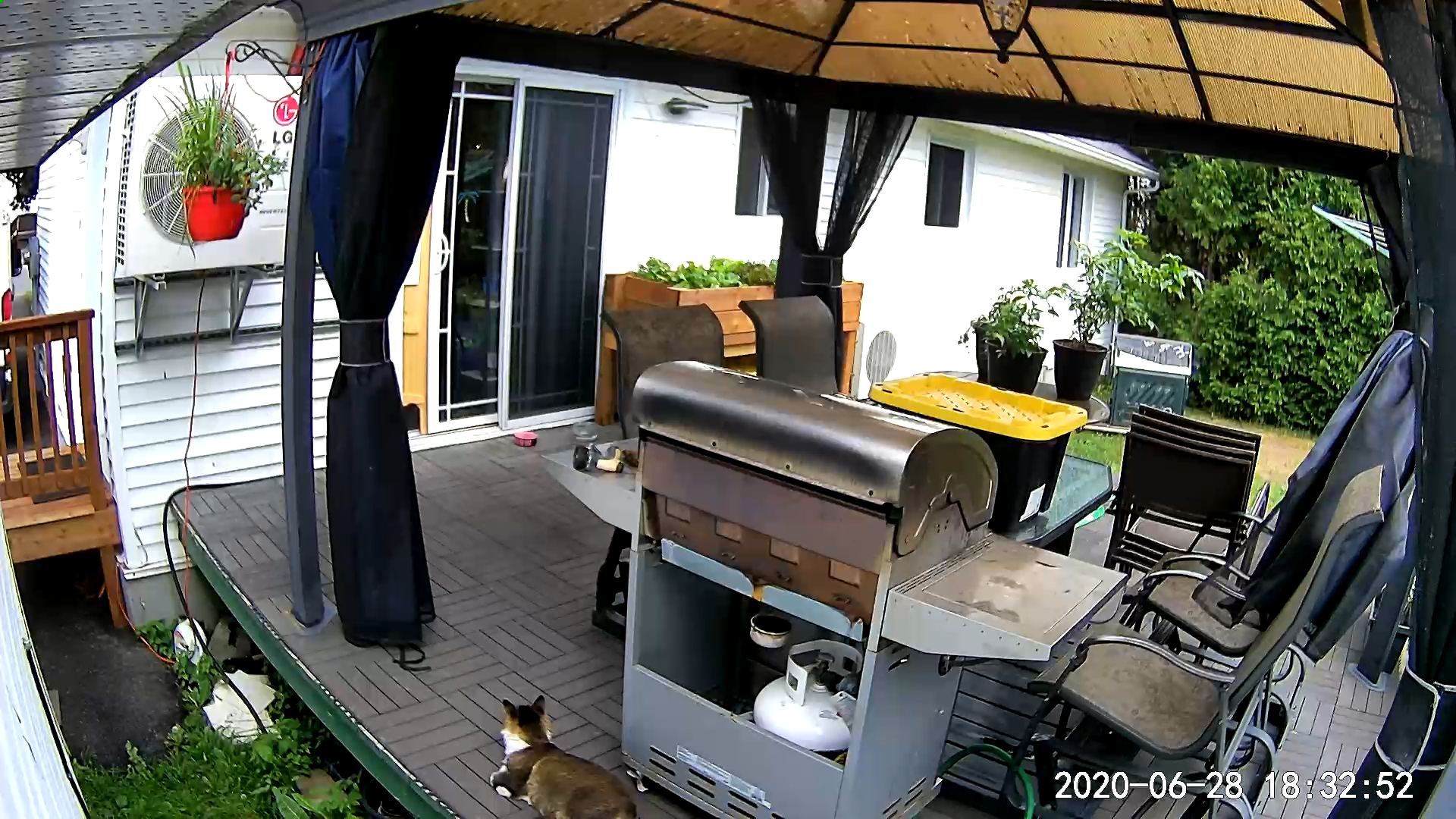

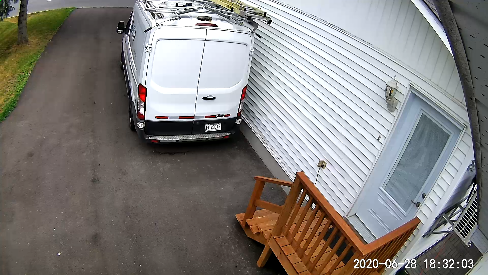

JoWhee Posted June 28, 2020 Author Posted June 28, 2020 I bought 3 of their regular cameras, 2 are all setup, the other requires me to get into the attic to wire up power, and I’m not doing that until it’s under 100 degrees in there. Quote
