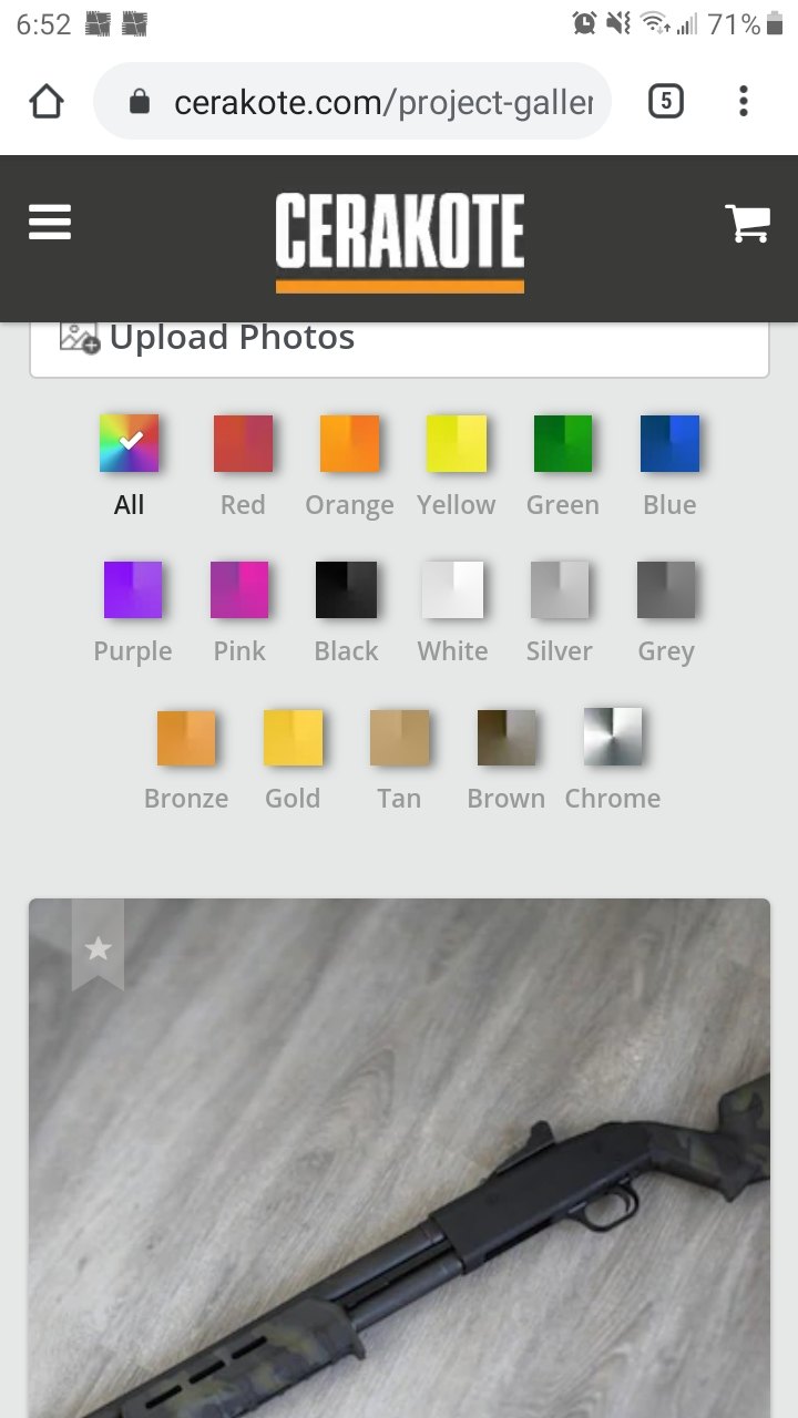

XXitanium Posted March 19, 2020 Posted March 19, 2020 The FNG offered cerakote...? https://www.cerakote.com/project-gallery I have some fishing equipment that got a little pitted in the spring thaw a few years back. .300WM.. I used to neck down .30-06 for my .308 quite a bit. It's plentiful. Can you find a donor cartridge? Quote
