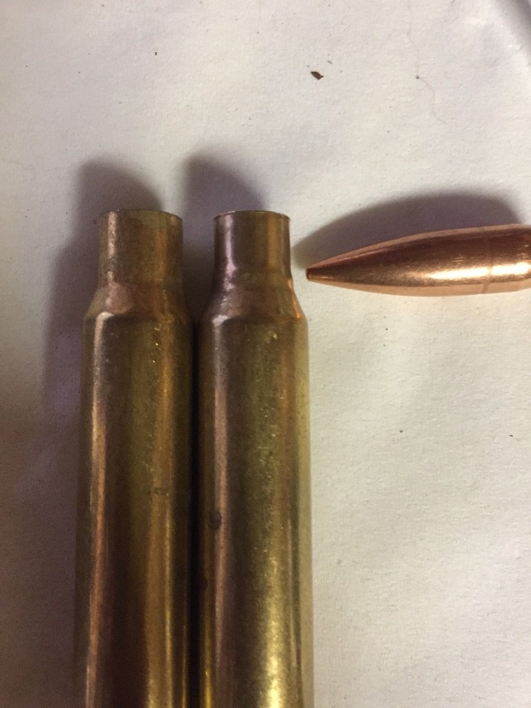

superhawk996 Posted April 5, 2020 Author Posted April 5, 2020 Here's two .338WinMag cases, the one on the right has been necked down for the Norma's .308 bullet diameter. The little 'bulge' where the bullet is pointing shows how much longer the Norma chamber is. When it's fired in the Norma the whole front of of the case starting with the big shoulder area will stretch forward just past where that little bulge is (about 1/8") then it'll be properly sized for the chamber, as long as I load it hot enough. Seems kinda nutty, but it's a fairly common thing done with many cartridges, it's called "fire forming". Every case is fire formed a little every time you shoot a 'normally' sized case since they're always a bit smaller than the chamber, this will just be a more extreme forming. Quote
