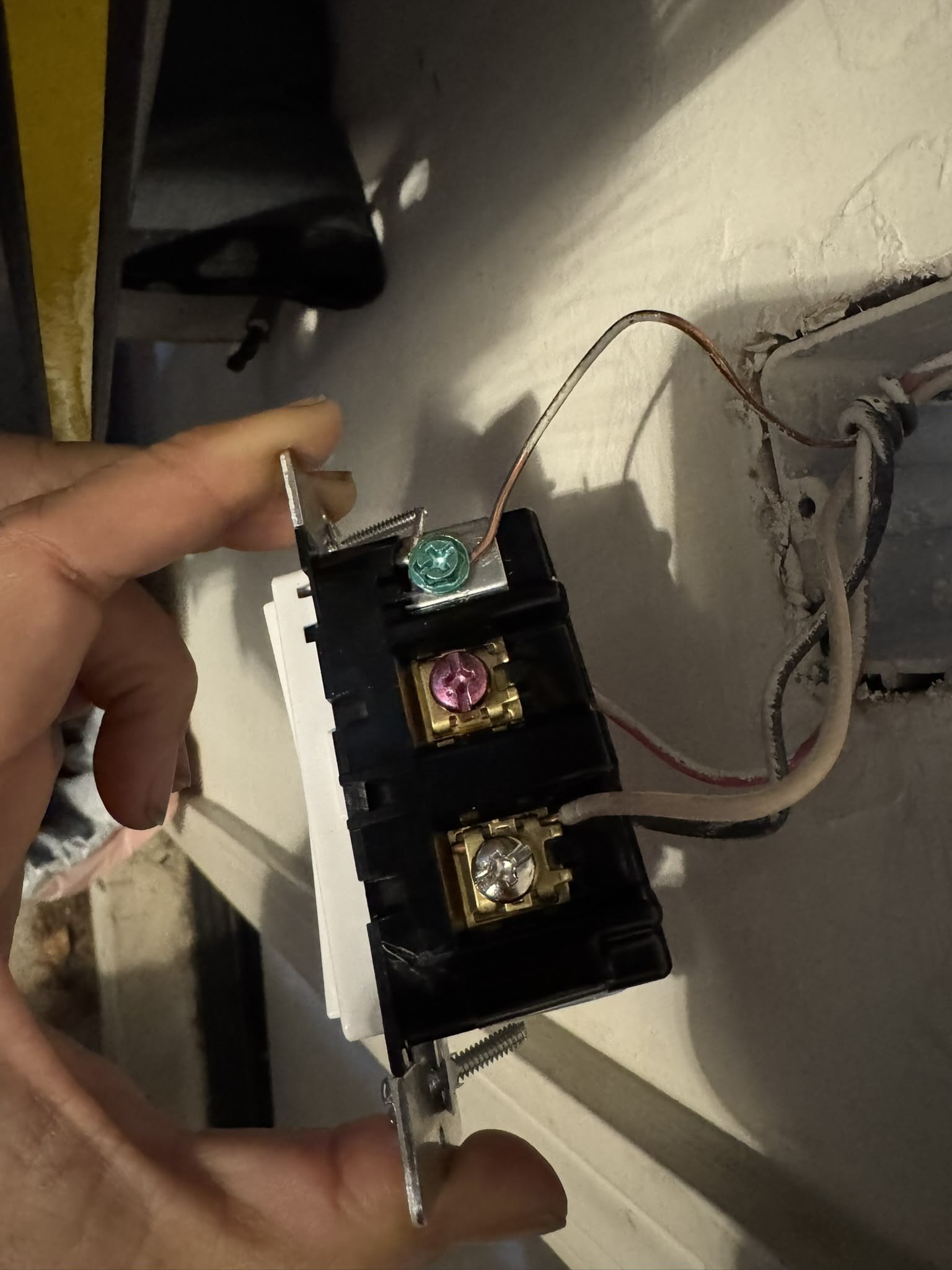

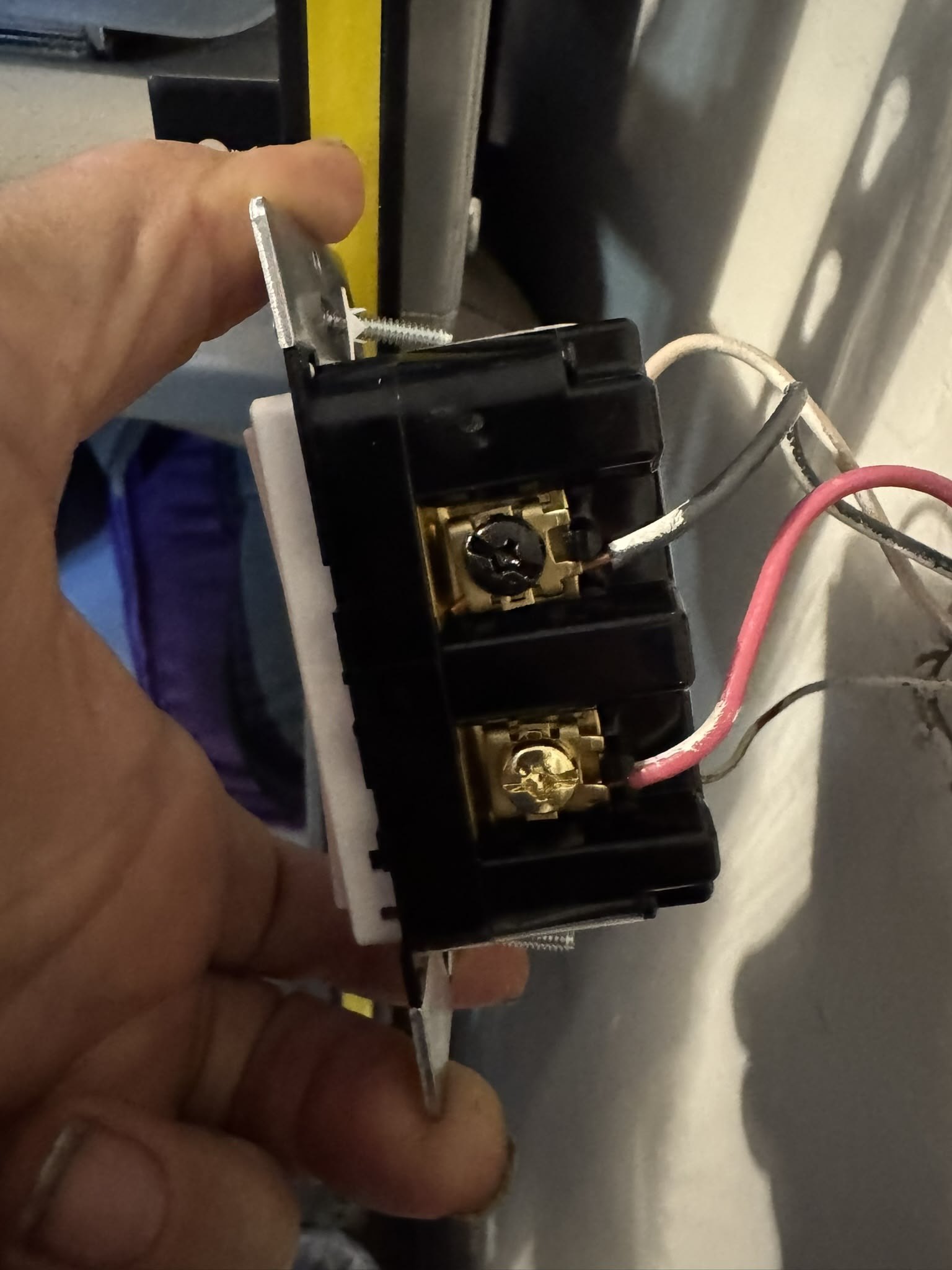

SwampNut Posted January 27 Posted January 27 When the fuck did it become OK to run travelers that are white? Â Not red/yellow?? Â I metered it 57 times and re-read the documentation as many times to be sure. Â And it still creeps me out to land a white on a red and black. Â WTF? Â Also the new switches have the funky lever locks. Â No screws and no push-in with a self lock. Â Ok, sounds good, but...why is the hot now labeled "COMMON?" Â Da fuck? Â What did I miss? Â Quote
SwampNut Posted January 27 Author Posted January 27 You open a box and you have black...white...red...cool...another WHITE WHAT? Â Quote
xrated Posted January 28 Posted January 28 (edited) On 1/26/2025 at 9:09 PM, SwampNut said: When the fuck did it become OK to run travelers that are white?  Not red/yellow??  I metered it 57 times and re-read the documentation as many times to be sure.  And it still creeps me out to land a white on a red and black.  WTF?  Also the new switches have the funky lever locks.  No screws and no push-in with a self lock.  Ok, sounds good, but...why is the hot now labeled "COMMON?"  Da fuck?  What did I miss?  Here is a page that may explain it a bit for you. And something to keep in mind, on the three way switch itself, the terminal that is marked as "common", refers to that TERMINAL.....as opposed to the other two terminals (not counting the ground) which are the switched legs for the travellers.  https://www.electrical101.com/3way-switch-wiring-using-nm-cable.html  And as you can see in the picture to the right of that page, if the incoming line comes into where the actual fixture is located (as opposed to a switchbox), then the white wire can be used as the hot wire feeding the downstream switches...BUT....it is supposed to be marked clearly with BLACK TAPE and that should be at both ends of that cable run. Edited January 28 by xrated 1 Quote
SwampNut Posted January 28 Author Posted January 28 Yeah, I've seen taped wires a lot. Â My house...not done. Â It was a rush job in the idiotic boom of 2005. Â Quote
xrated Posted January 28 Posted January 28 3 hours ago, SwampNut said: Yeah, I've seen taped wires a lot.  My house...not done.  It was a rush job in the idiotic boom of 2005.  In the industrial and commercial electrical industry, phase marking tape is used a LOT. An example is point A to point B via a run of conduit for a 3 phase device. So you pull in three Black conductors in the conduit but you mark them with phasing tape before pulling them in the pipe. Leave one of them black, then mark the other two, one with yellow, one with brown. If the run is long enough, many times we would set up three spools of Black wire and phase mark them. On shorter runs, where you can cut off the amount you need from one spool, you just cut three runs and mark them after each one is cut...then pull them in.  And I agree, somebody skipped an important step when they were doing yours and left the tape marking off. Quote

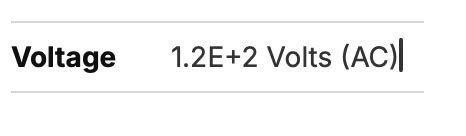

xrated Posted January 29 Posted January 29 1 hour ago, SwampNut said: Um, WTF spec is this? Â Â Beats the shit outta me....never seen that before. Quote

CALCXX Posted February 3 Posted February 3 (edited) On 1/28/2025 at 4:53 PM, xrated said: Beats the shit outta me....never seen that before. Me either? wtf? Sounds like an automotive thing to me😆 Edited February 3 by CALCXX Quote

fizzy Posted March 3 Posted March 3 On 1/28/2025 at 11:00 PM, SwampNut said: Um, WTF spec is this?   Mathematically, E may mean "10 to the power of". So this would be 1.2 x 10^2 = 1.2 x 100 = 120   +2.....move decimal point 2 places right.       -2......move decimal point 2 places left. Quote
