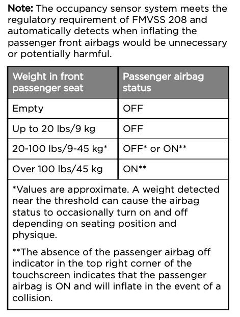

SwampNut Posted August 3, 2024 Posted August 3, 2024 Before I file an NHTSA complaint, I'm wondering if anyone else has experienced airbags turning off for passengers in the 100-110 pound range. Quote
Biometrix Posted August 3, 2024 Posted August 3, 2024 When my kids were smaller the passenger airbag light in my wife's Avalanche would toggle on/off sometimes but that was a 2002 and I would expect that the sensors would have gotten better by now. 100lbs seems right at the threshold for activation weight. Do you have any seat covers or pads on the seat? Do you know whether it will go on if your passenger bears down at all on the seat? My understanding is that there can be multiple sensors (like up to eight) in the seat to detect the weight so one or more could be faulty. Until it's fixed you could have your passenger sit with a 40lb. bag of sand or cat litter in their lap... Quote
SwampNut Posted August 3, 2024 Author Posted August 3, 2024 No seat covers or anything, and it happens mostly if she's leaned a bit back and/or slouching. So the ACTUAL weight on the sensor is under 100, but that should be accounted for. No other car does this. The official answer was the whole 100 pound thing, and "sit up straight like mom told you." She can give the seat a bounce and it turns the warning off/airbag on. It seems to have a single sensor, and mostly near the back. I think it's bad design, and am pretty sure I'll file a complaint. At least they solved the practical problem of hiding the AC controls when there was no passenger. Quote

superhawk996 Posted August 5, 2024 Posted August 5, 2024 I have the opposite complaint, the airbag turns on for parts or other cargo well under 100lbs. 1 Quote
Zero Knievel Posted August 5, 2024 Posted August 5, 2024 They introduced the feature so air bags wouldn’t deploy unless someone was in the seat due to the expense in repairing them. My ‘98 Mazda has an on/off switch for the passenger airbag. I suppose they went to a pressure switch so the driver didn’t have to remember to turn it back on. 1 1 Quote
blackhawkxx Posted August 5, 2024 Posted August 5, 2024 1 hour ago, Zero Knievel said: They introduced the feature so air bags wouldn’t deploy unless someone was in the seat due to the expense in repairing them. Or maybe they didn't want the air bag blasting a child? 1 Quote
superhawk996 Posted August 5, 2024 Posted August 5, 2024 2 hours ago, blackhawkxx said: Or maybe they didn't want the air bag blasting a child? Exactly. Many older cars/pickups have a switch so you can safely carry an infant/small kid. I think the switch was a requirement in vehicles that didn't have a back seat option for car seats. I'm pretty sure weight sensors eliminated the manual switch. In some cars the weight sensor tunes the deployment speed of the airbag, maybe all cars these days. 1 Quote
SwampNut Posted August 5, 2024 Author Posted August 5, 2024 11 hours ago, superhawk996 said: I have the opposite complaint, the airbag turns on for parts or other cargo well under 100lbs. Yeah, in every other car (BMW, Tesla, Smart, etc) we needed a fake seatbelt activation latch for Arlo and even heavy groceries (he's 53 pounds). So now that's another question; are there two sensors, or two triggers? One for seat belt ding and one for airbag? It seemed to be one and the same in all other cars. She always latches it if the dog is in the front seat, and the back seats do NOT cause it to give the seat belt warning in the Rivian, but did in the Tesla. Quote
SwampNut Posted August 8, 2024 Author Posted August 8, 2024 Well, I've started a shitstorm. Can you believe that people are afraid to make a stink at the risk of "upsetting" the car service center/manufacturer? But they will join my #MeToo movement. I have a CA lemon law/class action attorney's attention. I know it's very unusual for me to start some shit. Also the number of people who say "doesn't happen to my wife" and then I ask "is she fat?" LOL....!!! Moriah is in the bottom 5th or 3rd percentile of weight, but I can still make the joke. 1 Quote
superhawk996 Posted August 10, 2024 Posted August 10, 2024 Assuming they're 'smart' airbags; being that it barely detects Moriah means that they might under-weigh all passengers and skew the deployment speed. The driver's side could have the same issue, but that side is always on so you wouldn't have an indication. Quote
