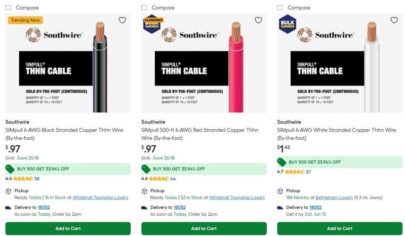

SwampNut Posted June 13, 2024 Author Posted June 13, 2024 WTF, why is the black so much more??? I'm supposed to run red/black #6 and green #8, but... Quote
blackhawkxx Posted June 13, 2024 Posted June 13, 2024 52 minutes ago, SwampNut said: WTF, why is the black so much more??? Reparations? Sorry. 2 1 Quote
IcePrick Posted June 13, 2024 Posted June 13, 2024 (edited) Reparations? Dang, gotta be quick around here. Edited June 13, 2024 by IcePrick 2 Quote

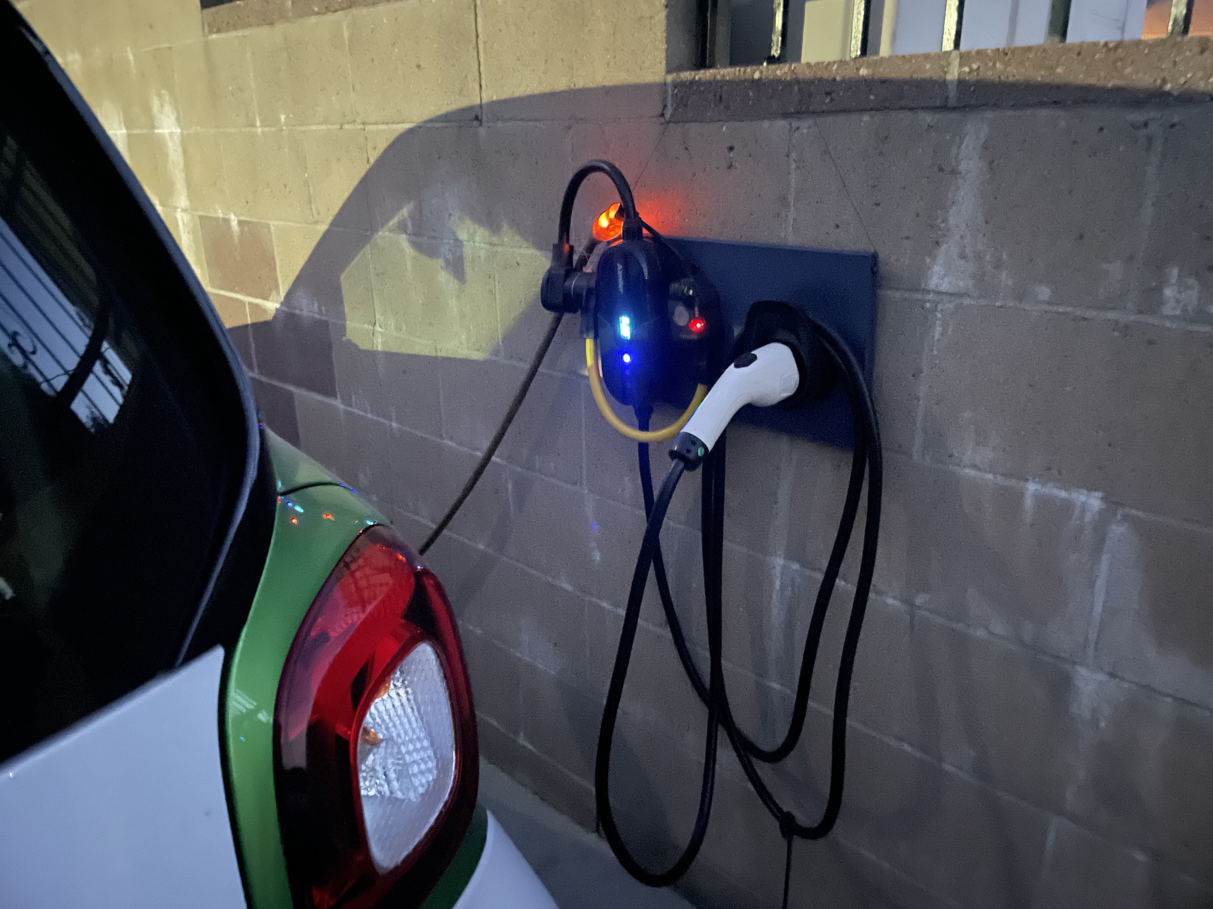

SwampNut Posted June 13, 2024 Author Posted June 13, 2024 2 hours ago, rockmeupto125 said: I assume your connectors only support #6 conductors. It's a wide range, I think 4 to like 12 or 14. The EVSE can be programmed for the max load, as can the car. So you could do 4 aluminum to get 60a, or do 14 and just get 12a, etc. I wired it temporarily using a piece of SJOW 12 and an L6-20 where my bandsaw goes, fit fine. This will go to its own breaker in the main panel outside, the EVSE will be on the wall a few feet from the panel. Luckily the parking and panel are super close. Looks like there's no disagreement here on the THHN 6, but google led me to too many people whining about it and saying 4. I was pretty sure it was BS. I have been charging with the portable cord on the L6-30 for my welder. Going to upgrade to dedicated, partly because I got a free EVSE. The Zero charges on plain household power, small battery. Quote
SwampNut Posted June 13, 2024 Author Posted June 13, 2024 13 hours ago, blackhawkxx said: Reparations? Sorry. Fuck this, if the store price really is this, I will buy two reds and flag one with tape. Not like it matters with two hots and ground. Quote

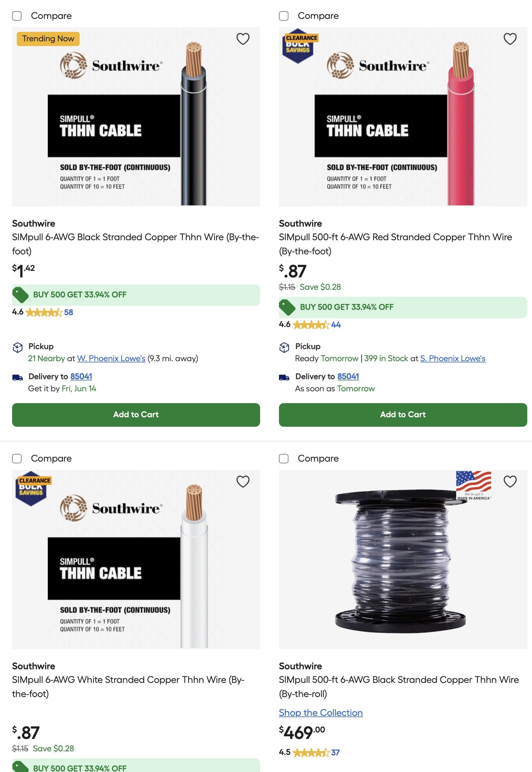

SwampNut Posted June 16, 2024 Author Posted June 16, 2024 All of the colors were the same price in store, and less than shown online. 1 Quote

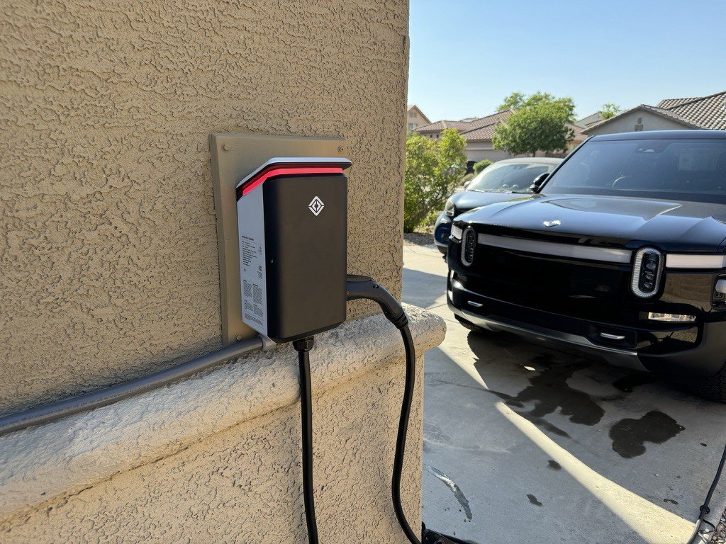

blackhawkxx Posted June 16, 2024 Posted June 16, 2024 Looks like a professional install. Can't help to think about a post here a while ago about some lady trying to charge at a someone's home charger. 1 Quote
SwampNut Posted June 16, 2024 Author Posted June 16, 2024 Thanks! I had help from an actual pro in commercial/heavy industrial. I am considering adding it to the app for neighborhood charging so anyone can use it, but I live so far out of the city that I don't imagine it's of any use. Quote
