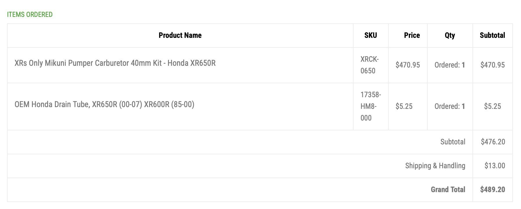

SwampNut Posted February 13, 2024 Posted February 13, 2024 I am giving up on it. My priorities would be reliable and easy starting. Don't care about MPG or max power. Mikuni TM40: Inexpensive, generally easy to tune, not the most powerful or best MPG. XRsonly.com sells it as a kit with the adapter and multiple jets, but shows out of stock. I can get the carb and jets from other sources, but still also need an airbox adapter. @IcePrick has one on his XR400 and likes it a lot. This is valuable info and makes it my top choice. The forums seem to just see this is a good solid carb nothing that stands out. Lectron: Expensive. First-kick starts. Hard to tune sometimes. Works at any altitude even laying on its side. Edelbrock: Some love it and some hate it, inexpensive, can be tweaky to tune at first. Quote

SwampNut Posted February 13, 2024 Author Posted February 13, 2024 Weird, they recommend the 40mm for the 650R and 42mm for the much lower powered L model. Quote
IcePrick Posted February 13, 2024 Posted February 13, 2024 Just now, SwampNut said: Weird, they recommend the 40mm for the 650R and 42mm for the much lower powered L model. It's about double the weight, takes more gas to drag that around. Quote

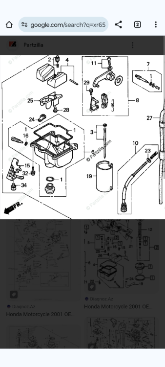

tomek Posted February 15, 2024 Posted February 15, 2024 (edited) Whatabout float valve, whatever proper name? Looks like worn out parts 2 and 4. Probably too much side to side movement, something touching something and it gets stuck, overflows, etc. But, yea, new carb is probably good idea. Edited February 15, 2024 by tomek Quote
superhawk996 Posted February 15, 2024 Posted February 15, 2024 5 minutes ago, SwampNut said: Rubber also, but it likely was aftermarket. I had this from Walt, but then thought, the rubber should seal... That's a bummer. It's seems like when carbs act like that the only fix is a new one. As a last ditch effort, I take a q-tip and cut the stalk at a sharp angle and chuck it up in a drill. Spray the float seat with wd40 and place the sharp tip into the seat hole and polish it with light pressure for a few minutes or until the stalk breaks. If that doesn't fix it, new carb time, or if the seat is replaceable, new needle and seat time. Very similar to what the YT guy told me, except he uses a pencil in a drill followed by a Q-tip in drill with polishing compound. Quote
superhawk996 Posted February 15, 2024 Posted February 15, 2024 1 minute ago, tomek said: Whatabout float valve, whatever proper name? Looks like worn out parts 2 and 4. #2, what I called the needle, has been replaced. The only thing that goes wrong with floats is that they can perforate/crack and fill with gas, but then you get a consistent over-fill. Not in the photo, and unavailable according to Carlos, is the seat and that's what we've been discussing polishing. I never got a good look at it and didn't suspect it because they "never" wear out, but apparently it's a thing with this carb. And I just realized that others probably never wear out because they're an easily replaced wear item that comes in most rebuild kits so they're rarely all that old. This one appears to be pressed in where others are threaded and have a hex or flats to grab with a wrench. Quote
tomek Posted February 15, 2024 Posted February 15, 2024 So you guys got new needle but old seat. And seat is pressed in. Kinda like throwing new valve on not refinished seat in cylinder head. Not ideal. Was it leaking with old valve? Maybe run some fine valve lapping compound? Quote

superhawk996 Posted February 15, 2024 Posted February 15, 2024 1 minute ago, tomek said: So you guys got new needle but old seat. And seat is pressed in. Kinda like throwing new valve on not refinished seat in cylinder head. Not ideal. Was it leaking with old valve? Maybe run some fine valve lapping compound? It was leaking, but it had some stuff in it that I suspect was particles off the petcock rubber so I figured it would be fine once that was replaced and it was cleaned out. Before learning of the seat issue we had planned for Carlos to give it to me because I had to experiment and find out WTF was going on. Fine lapping compound is my plan, maybe followed by polishing compound, unless he decides to do the experiment instead. If I can grab the old needle in a drill I'll use that for the polishing to know that the angle is correct. Quote

superhawk996 Posted February 16, 2024 Posted February 16, 2024 8 hours ago, tomek said: I'd examine bowls for signs of float making contact with it. I suspected that because the 'toe' of the floats looked really close to the bowl. There were no marks on the bowl or floats, but I tweaked them a bit to make extra clearance just to be sure. Quote
