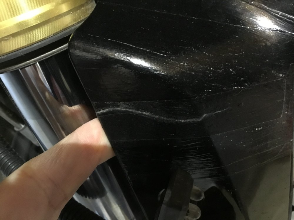

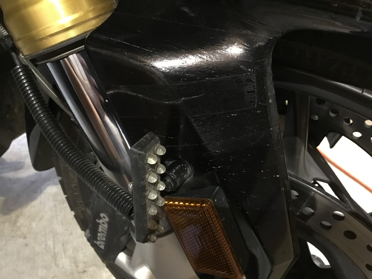

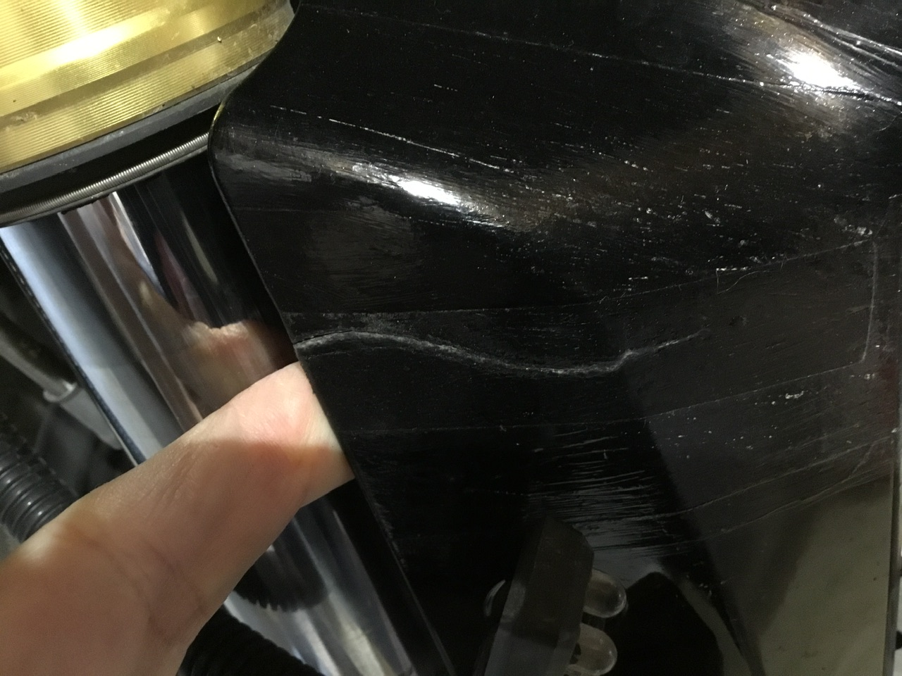

Zero Knievel Posted January 1, 2023 Author Posted January 1, 2023 57 minutes ago, XXBirdSlapper said: Post a picture of the fender. I fixed this before with plastic weld and a strip of fiberglass (on the inside). I noticed the crack returning this year and added a strip of electrical tape to ensure it doesn’t get worse. Taking the photos now, while the crack seems to remain separated, the fender does not flex too much…indicating that the fiberglass/plastic weld on the back is holding strong. If my past research is right, I might have to drill a hole where the crack terminates then carve out enough plastic to widen the crack so plastic weld can get in and bind the two edges together…then sand and paint. Quote

Zero Knievel Posted January 2, 2023 Author Posted January 2, 2023 5 hours ago, XXBirdSlapper said: Fiberglass mesh can be effective but more critical is the glue/bond strength and equally glue stiffness IMHO. With what I now see, it appears my repair held very well but I didn’t get the crack to bond because there was no space for the glue to get in between the pieces. Quote
