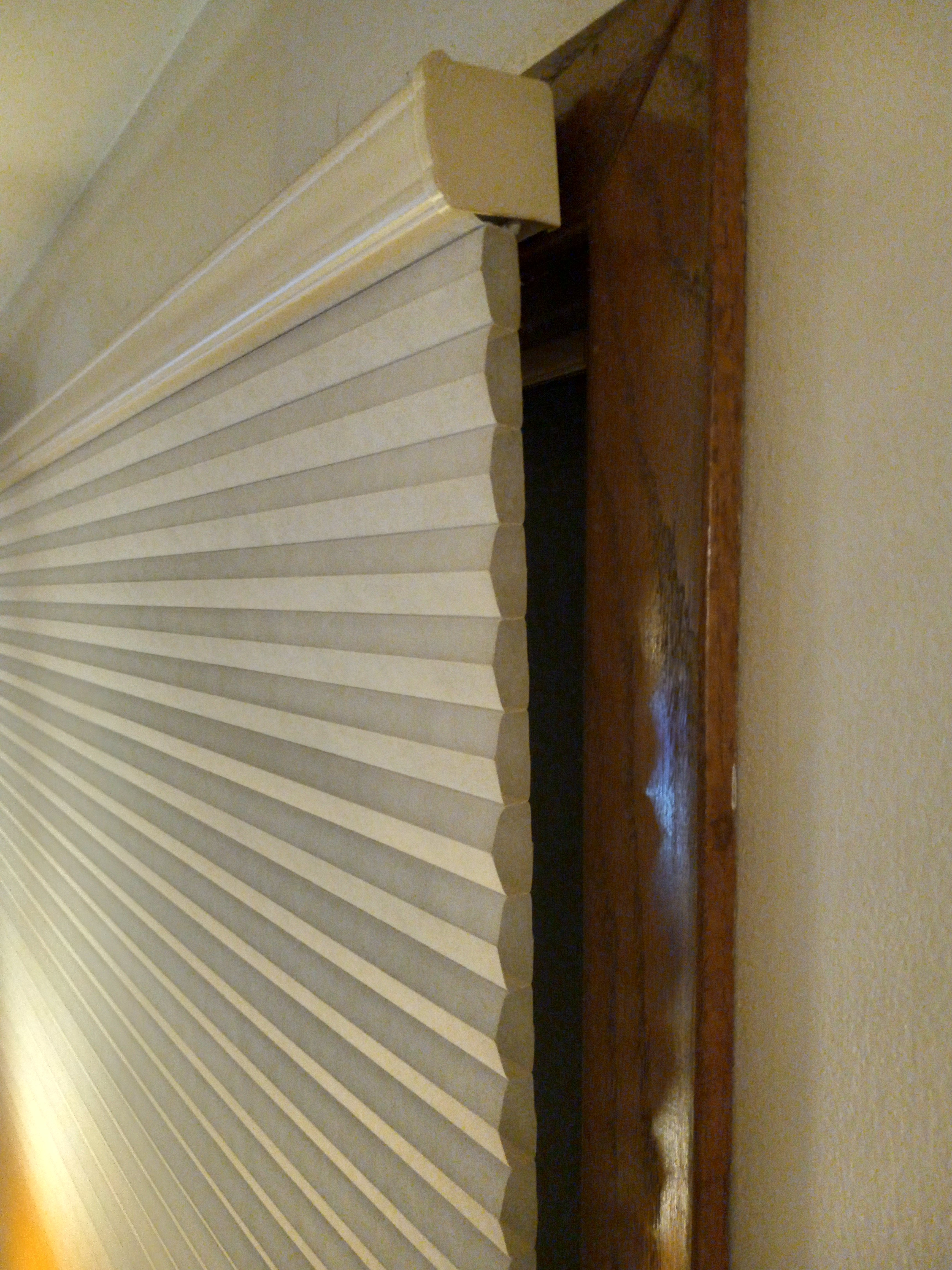

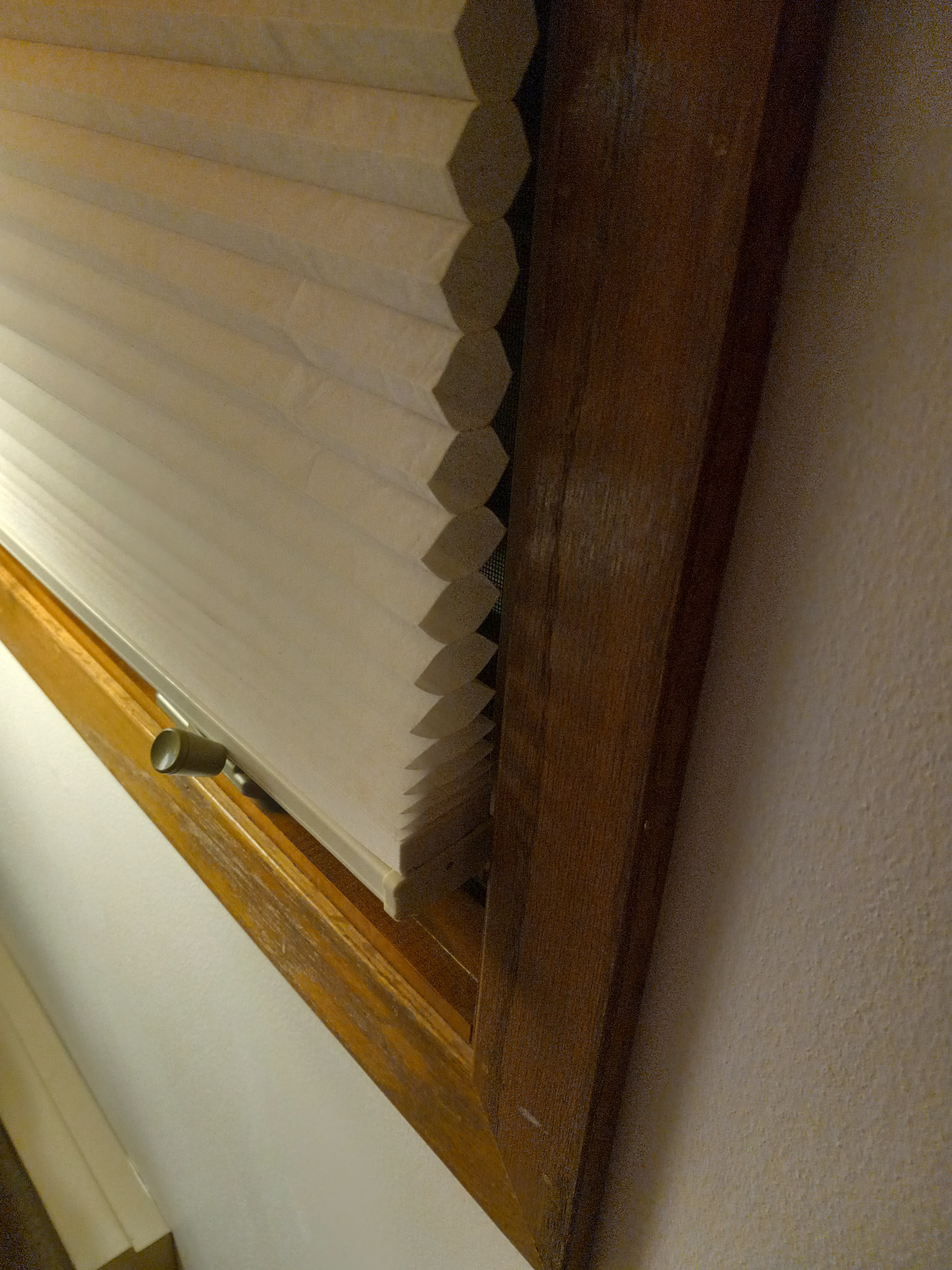

XXitanium Posted February 13, 2022 Posted February 13, 2022 We went with pleated insulating blinds. On 2/5/2022 at 5:21 AM, Zero Knievel said: Outside glass pane 34.3 F. ...how did you "attain" that number please? Quote
